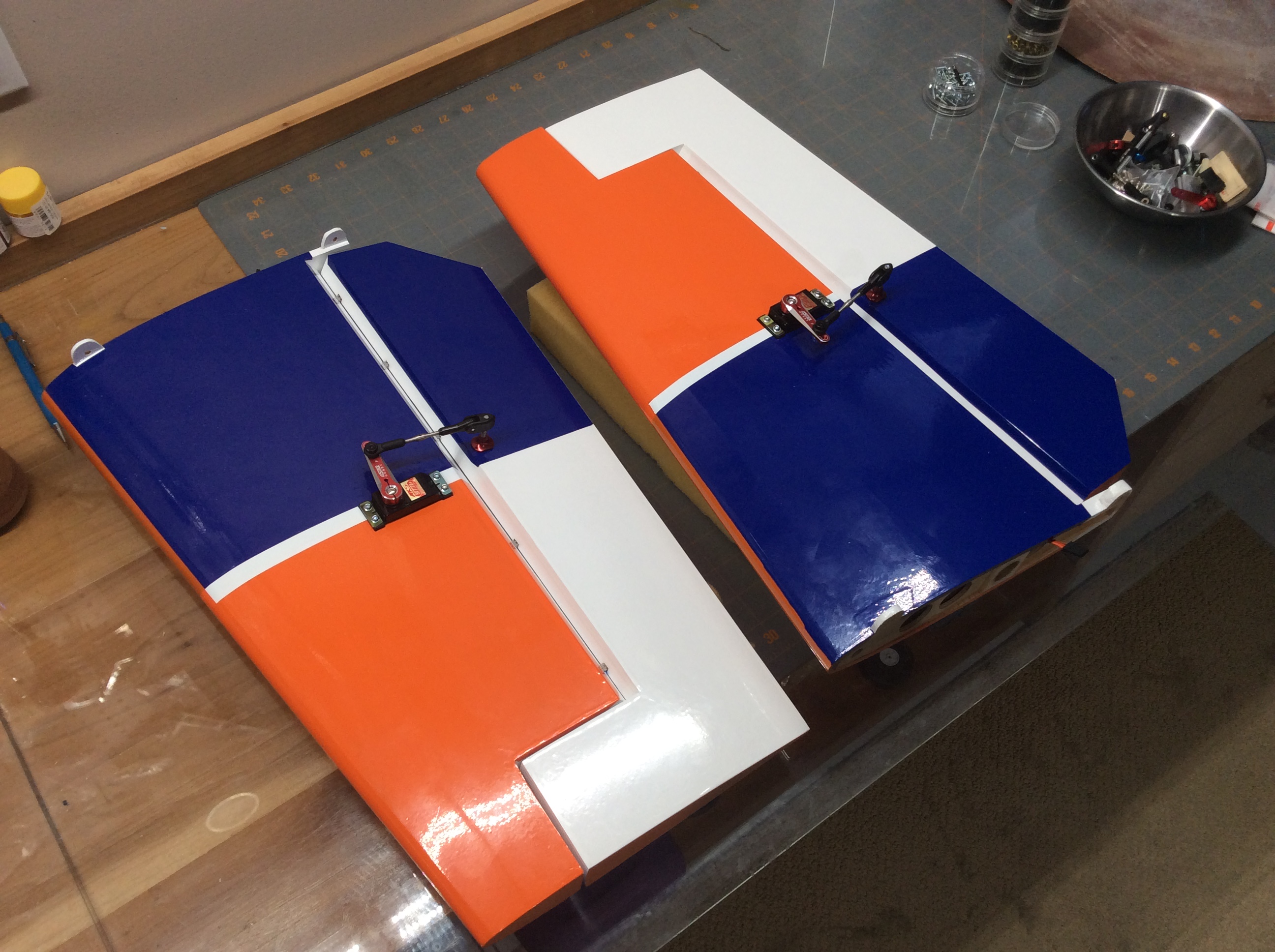

The stabilizer has a plywood plate on the end with two tabs sticking out below that matches to threaded holes on the fuselage to bolt the stabilizers to the fuselage.
The wing has some extra plates added to the #1 rib and the fuselage has also extra plywood plates add so that from the inside of the fuselage I can thread a 1/4 inch bolt into the wing and pull up against the fuselage.
Ok the stabilizers are done covered, hinged and the servos installed, just have to do the fine adjustments when it is all put together.
@TonyHallo look at the picture below and you can see the bolting tabs.

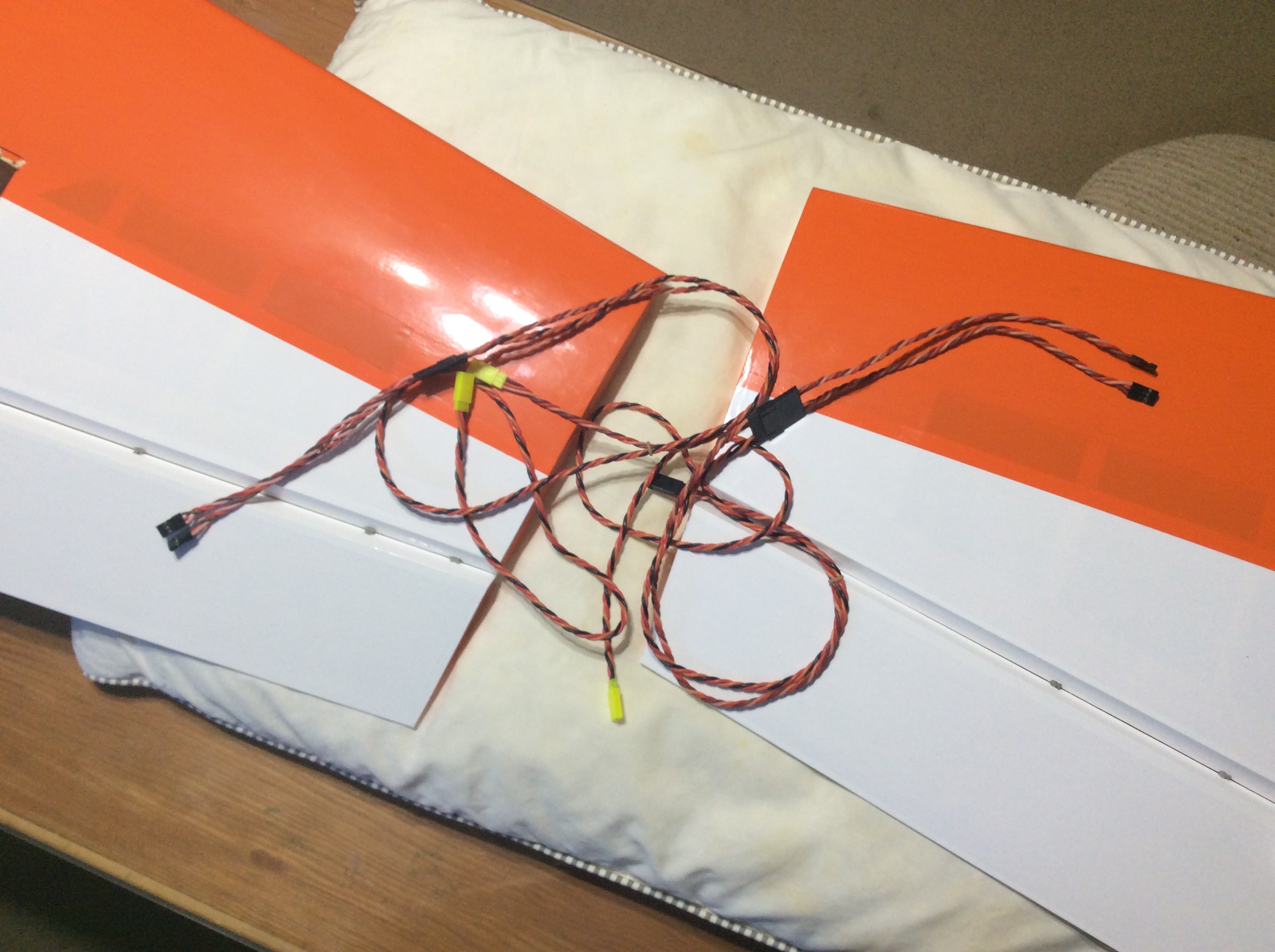

The wings are all done servos in and all the connections made and the wiring installed. So now install the rudder servo and make a wiring harness to connect the three servos in the tail of the plane up into the cockpit.
