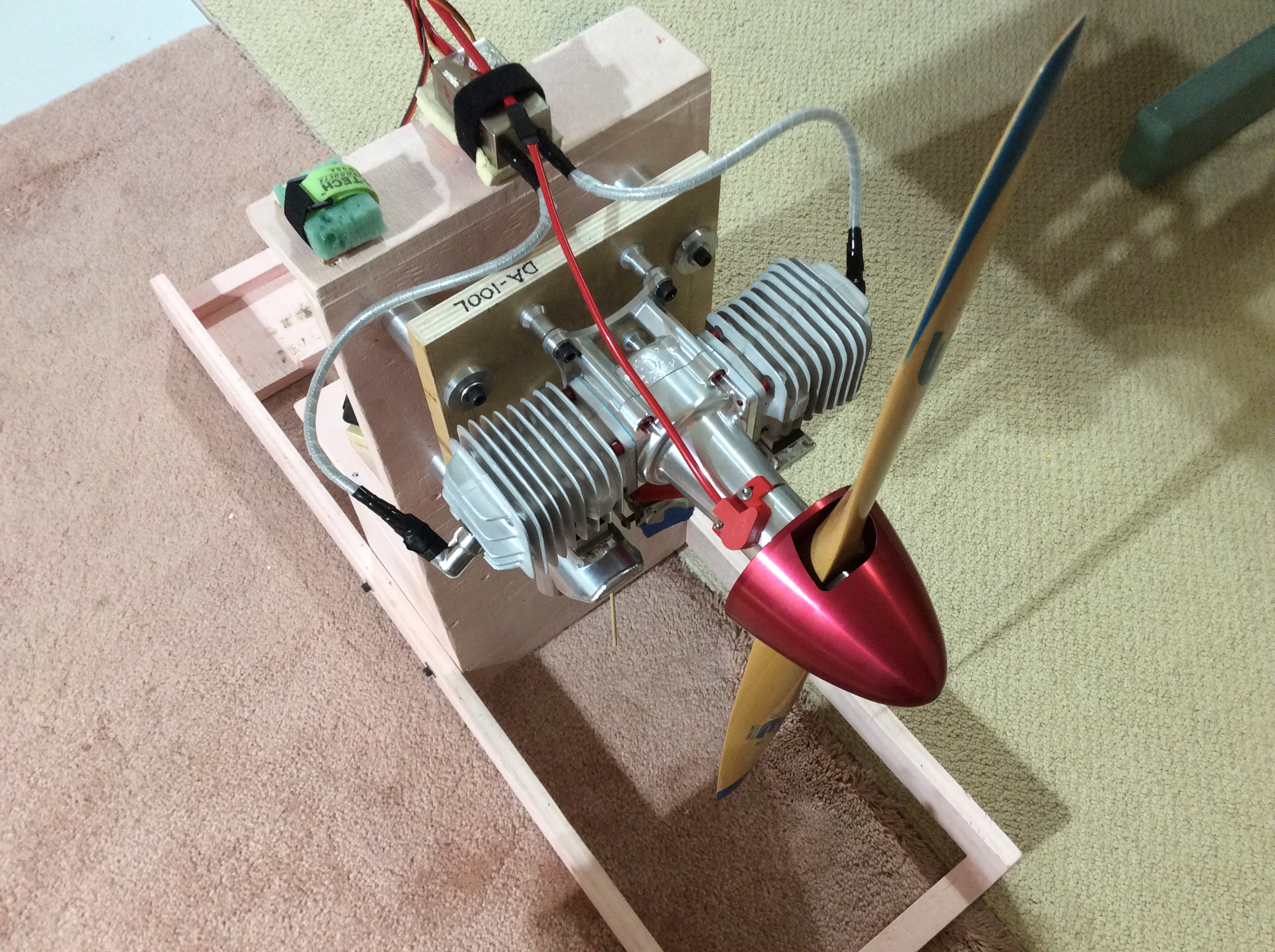

The engine is on the test stand ready to be run. Just have to get the mixture screws close and that the engine holds an idle. Also make sure it is not set lean and it will be ready for plane. Now it just waiting for better weather.

That's a 100L? I had thought that the DA 100's had the plugs in the middle of the cylinder head, I guess they moved the location for the L version?
How much weight do you put on the stand?
