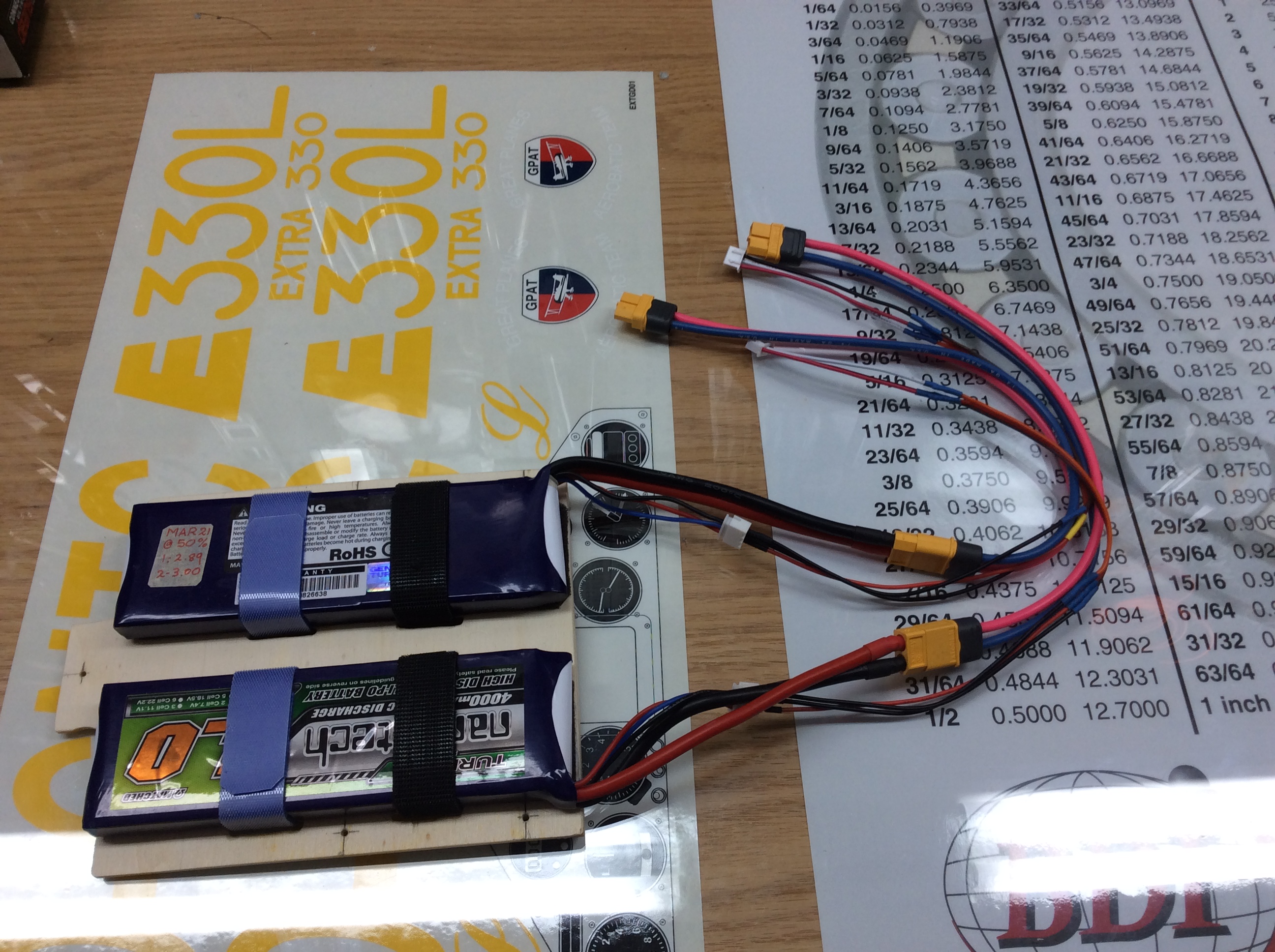

Ok made all the extensions for the balance leads and power leads so that they can be readily accessed for charging and checking from the cockpit area. Just have installed the tray and run the wires back.
TonyHallo
Noticed the decimal equivalent chart on your desk. Funny thing I just downloaded this file and had it printed and laminated at Staples two weeks ago, have it hanging above the lathe, printed on legal size paper so it is easy to read. Every time I needed to drill and tap something I had to get out the tap and die set and look under the lid, not anymore. Nice work on the batteries, leave mine in the plane most of the time and the plane stays in the van outside, hard on battery life.

Mine don’t come out either, they get removed in the fall and installed back into the plane in the spring.

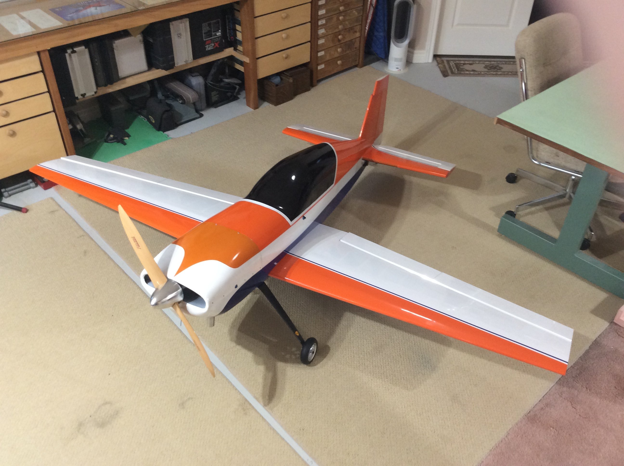

Ok this is it the plane is DONE it is built. Sorry it took a little longer than it should have. Just have to run the engine and setup the radio. Everything is installed and the plane balanced nicely, it came out 1/8 inch tail heavy which I am going leave as is.
The cowl is already starting to bug me.
-Rick-
Snoop, lay a piece of narrow white covering over the point where the two oranges meet. Sometimes it helps to break up where colours are off from each other. If that works find a way a break the colours up.
