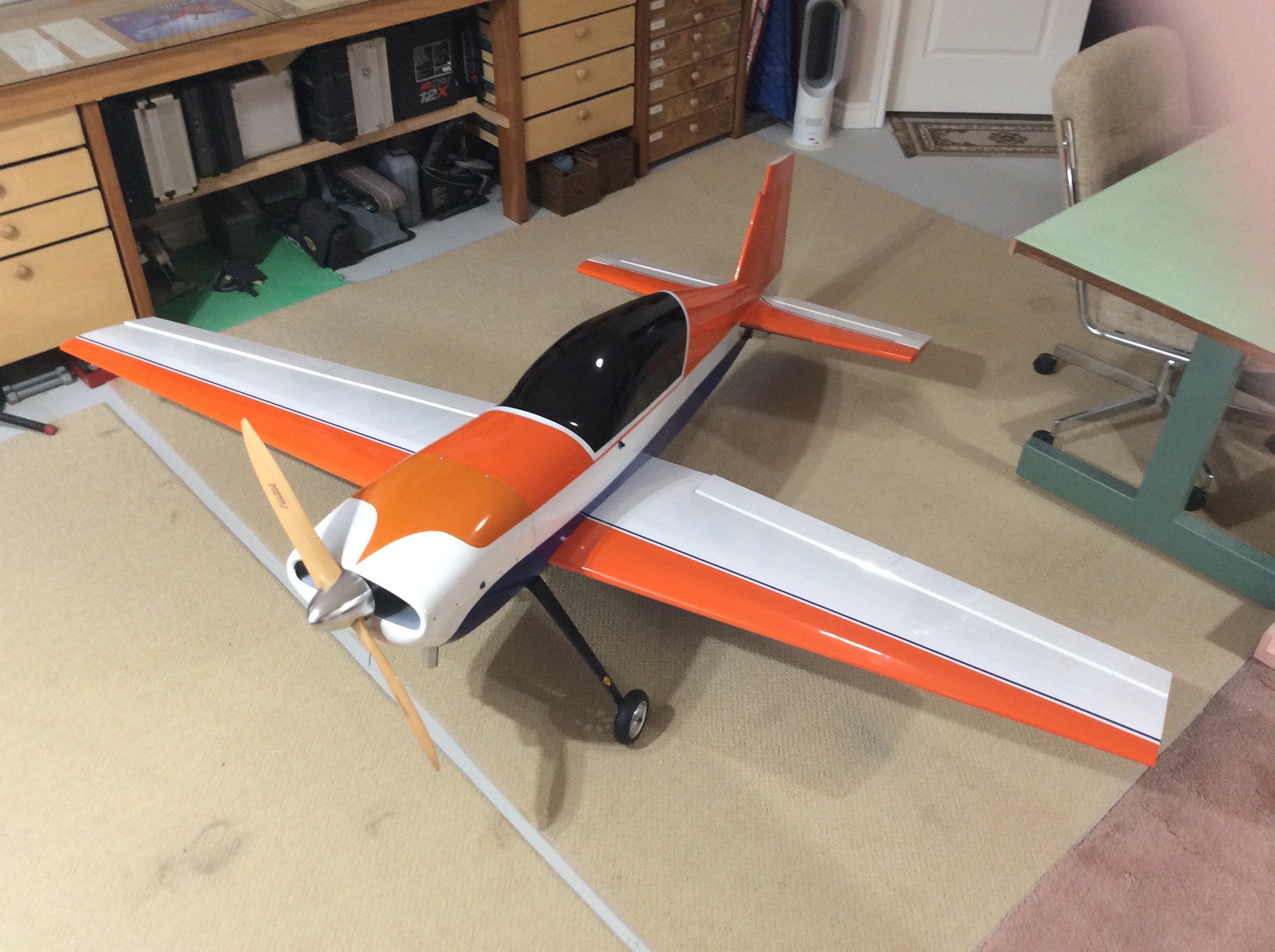

Latest up date, the plane has done its maiden flight, and 3 more flights after that. All I can say is that I am very pleased with the plane. It flies true and straight and virtually no coupling Not enough to do any mixing. Remember reading that it did not have enough elevator and or ailerons well that is not true. All I can say the person that designed the plane for GreatPlanes did a fantastic Job.

You built the ailerons and elevators per plans? I remember you doing some changes. I have one on the shelf that I hope to build some day.
Yes they were built to plan. Better said to the same size but not constructed the same. Made a lot of structural changes.
Ok changing my answer to the ailerons same size except they are a little bigger because I added a double bevel for the ailerons which increased it by about 3/4 of an inch.
