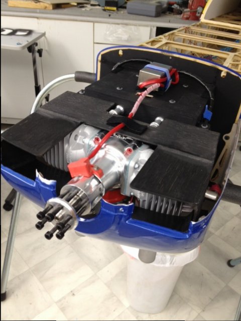

got the 120 stuffed in,, this one seems alot tighter than the first one. I havent trimmed the left side of the cowl but I think I will just a bit for the plug cap, it is touching and even pushing the cowl out a bit.

Yes...I grind the "stick-up" from the center of the plug cap.....then make sure it only "rubs" the cowl's wood.....If any contact is made with the fiberglass, I add a "rub-plate" with a leftover control horn...so it doesn't wear through the cowl. I love the 120 in a 103 for sure....

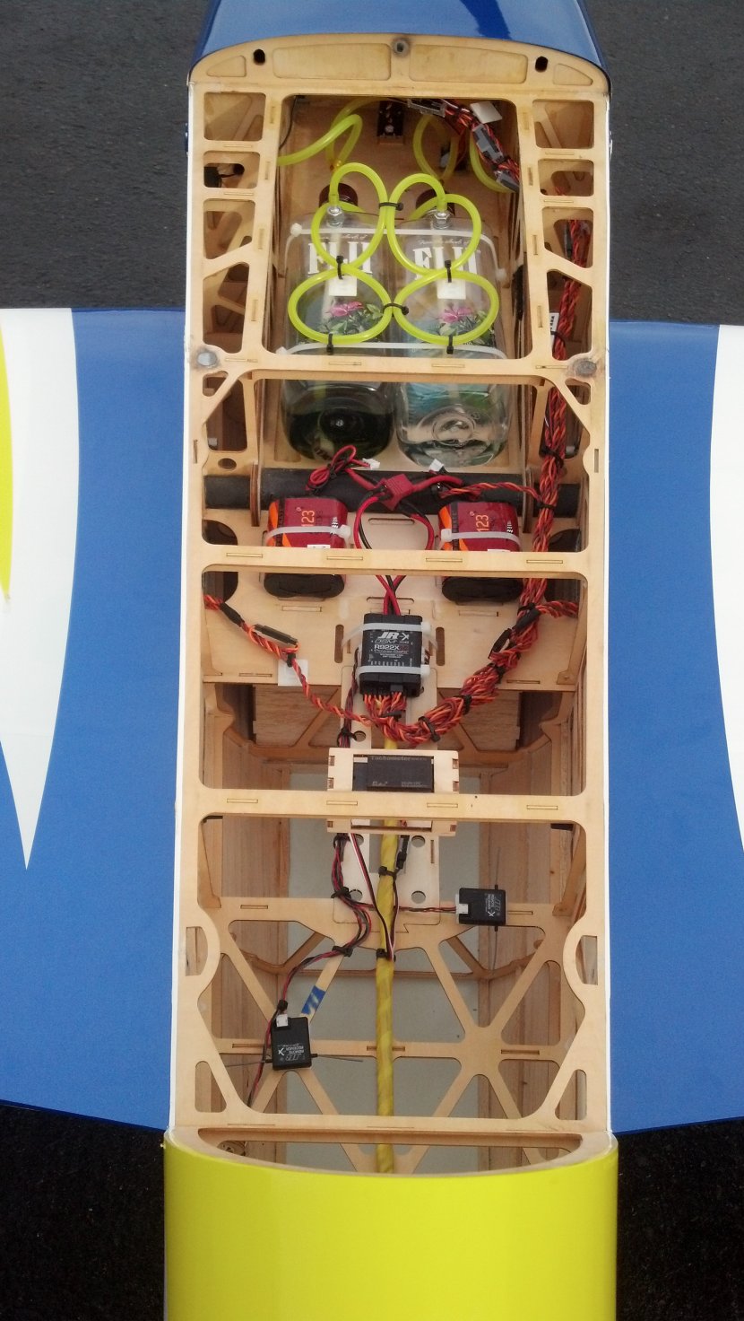

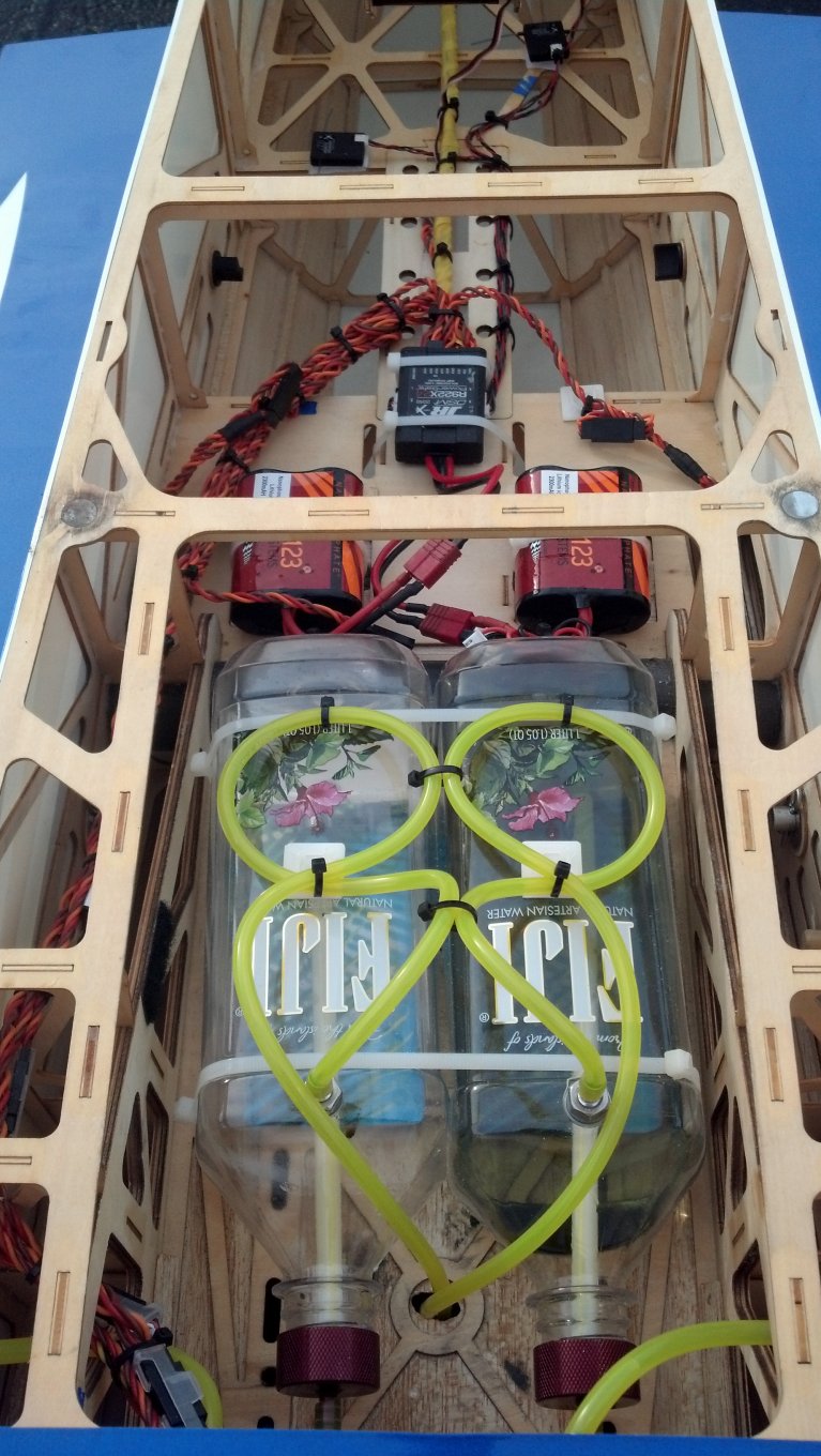

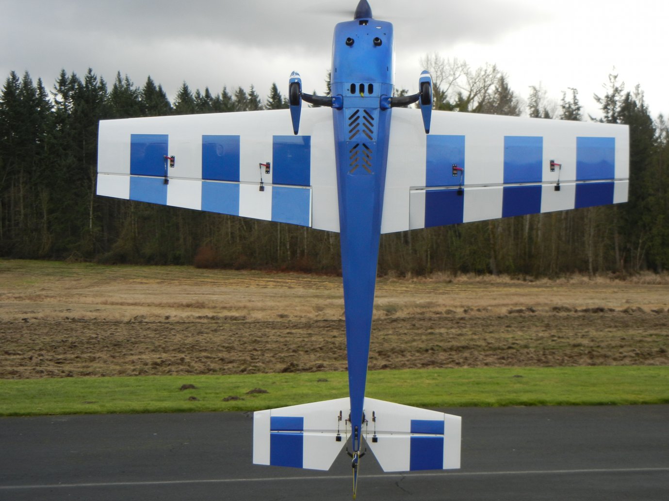

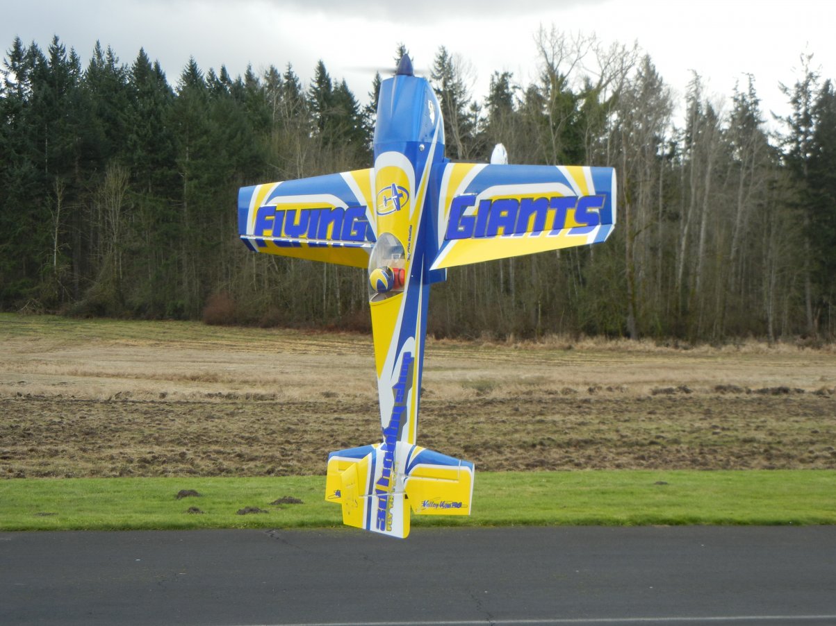

What's up guys. Just finished mine up last week and even in the dismal January weather in Seattle snuck out for a maiden and a few extra flights. Got the new v4 dle-111 under the hood and a 27x10 CF Xoar. Power is AMAZING and even with only 5 flights on her I know it'll only get better! Hitec 7954's all the way around on dual A123's into a powersafe receiver. 2 rudder servos in the tail and she's moves around nice and snappy like a crack yak! Be kind, I know it's logo's for another site...
DSCN1783.jpgDSCN1782.jpg2013-01-24_10-58-03_529.jpg2013-01-24_10-54-41_891.jpg2013-01-24_10-51-26_553.jpg2013-01-24_10-47-27_251.jpg2013-01-24_10-47-13_396.jpg

Just my 2 cents, but I'd be a bit concerned on how the tanks are strapped in. A tank full of gas or oil
weights a lot and tend to want to move around.
