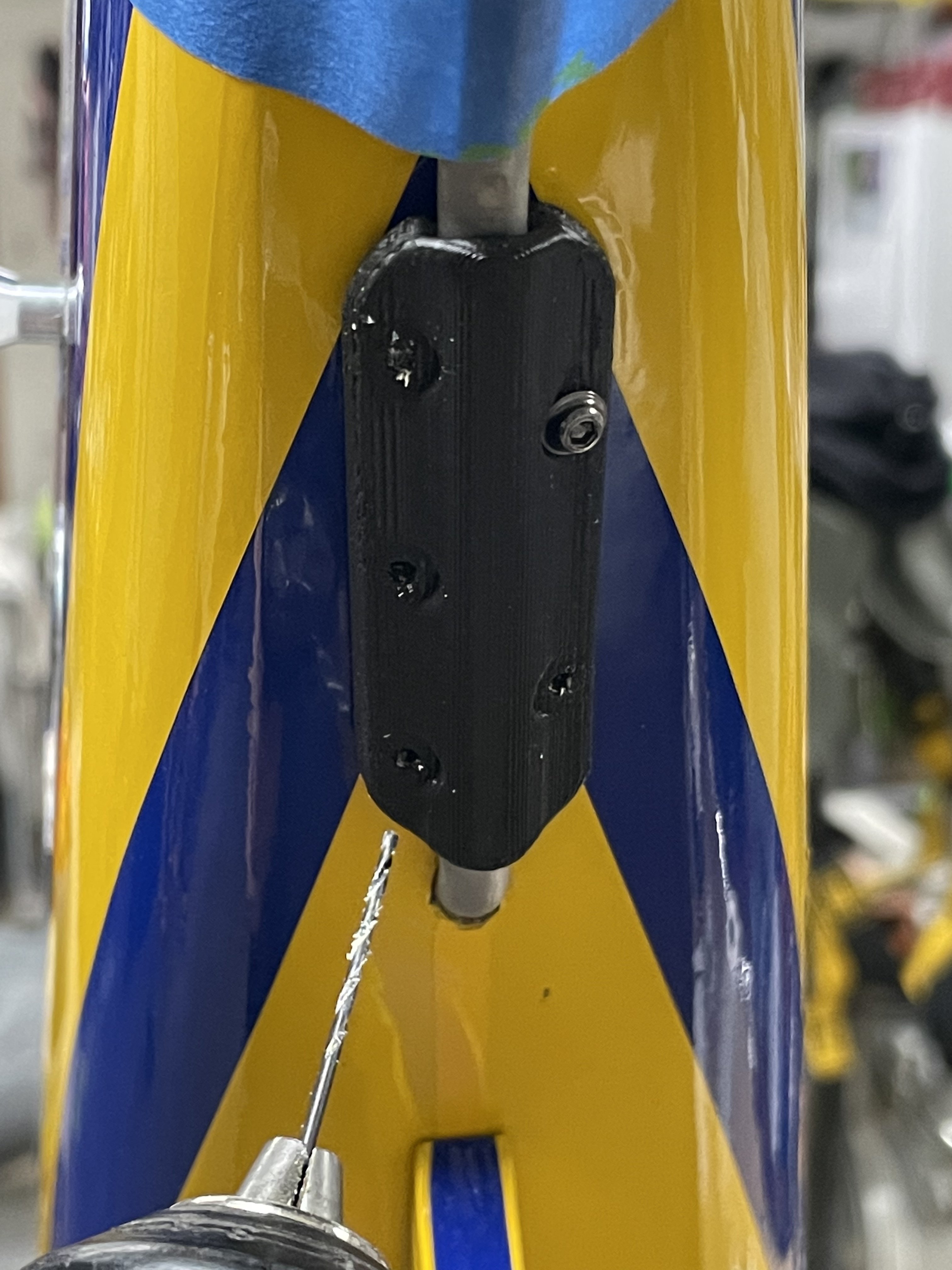

@AKNick ok Nick need some guidance the mount or bracket you (3D printing) made to hold a J&J tail wheel in place you have 2 files , wide and a narrow which one do I use for standard J&J tail wheel.
Either one. The narrow was made so the screws didn't go into the empennage tail gear supports on the 120" TurboBushmaster. The Narrow version uses only five screws (instead of six) and the holes are canted inwards towards the centerline (so the screws go in at a bit of an angle).

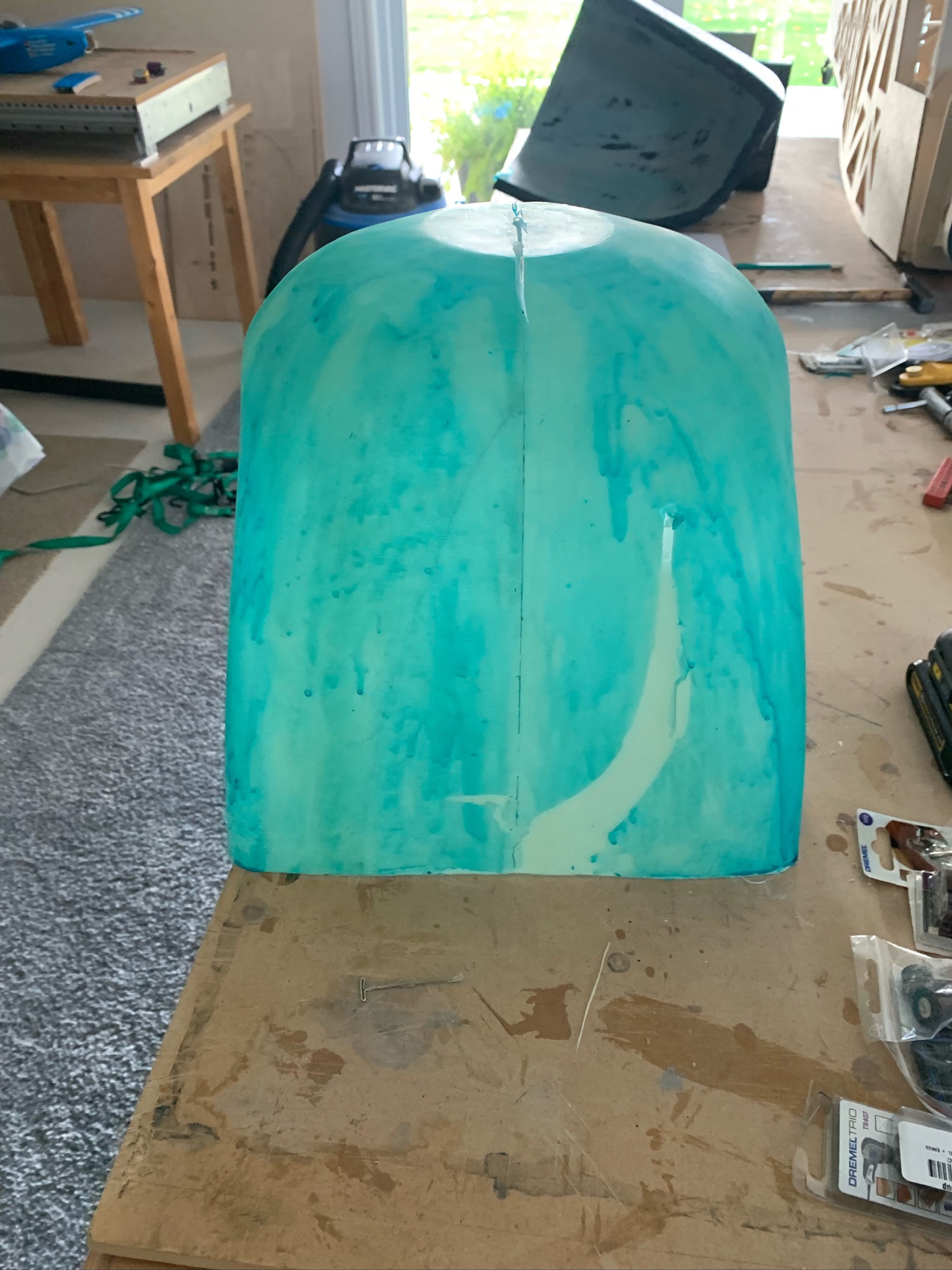

Well making progress slowly the cowl is made just needs to be cleaned up and then it will be ready for fitting to the fuselage. Really one benefit is when you make your own you can shape it just the way you want it and have nothing stick out everything fits inside.
TonyHallo
How did you get from the photo on post #82 to the laid up cowl? The shape looks different? Epoxy or polyester resin used? Wondering about the blue tint.
We made a bunch of changes to make sure we could get it out. We can add the intakes and add the spinner ring afterwards easily. It Is made up of 4 layers of 6oz cloth and it is done in epoxy. The colour on the outside Is PVA that will wash off with soap and water.
