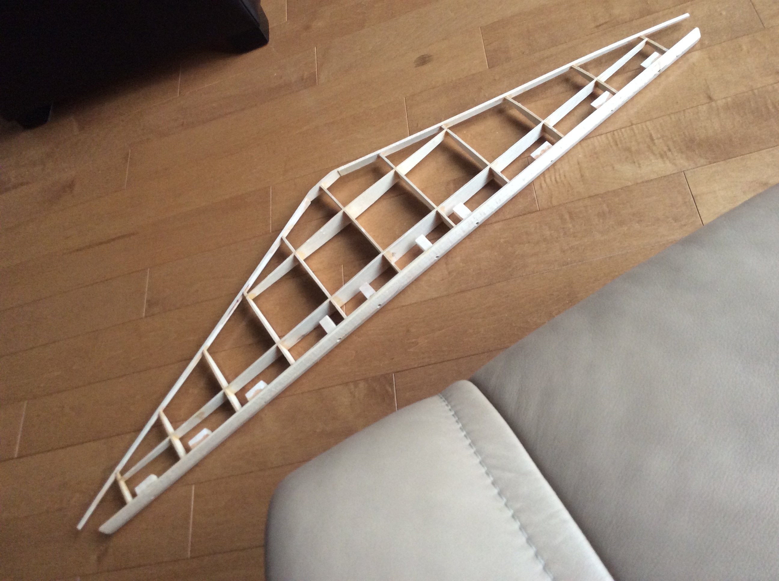

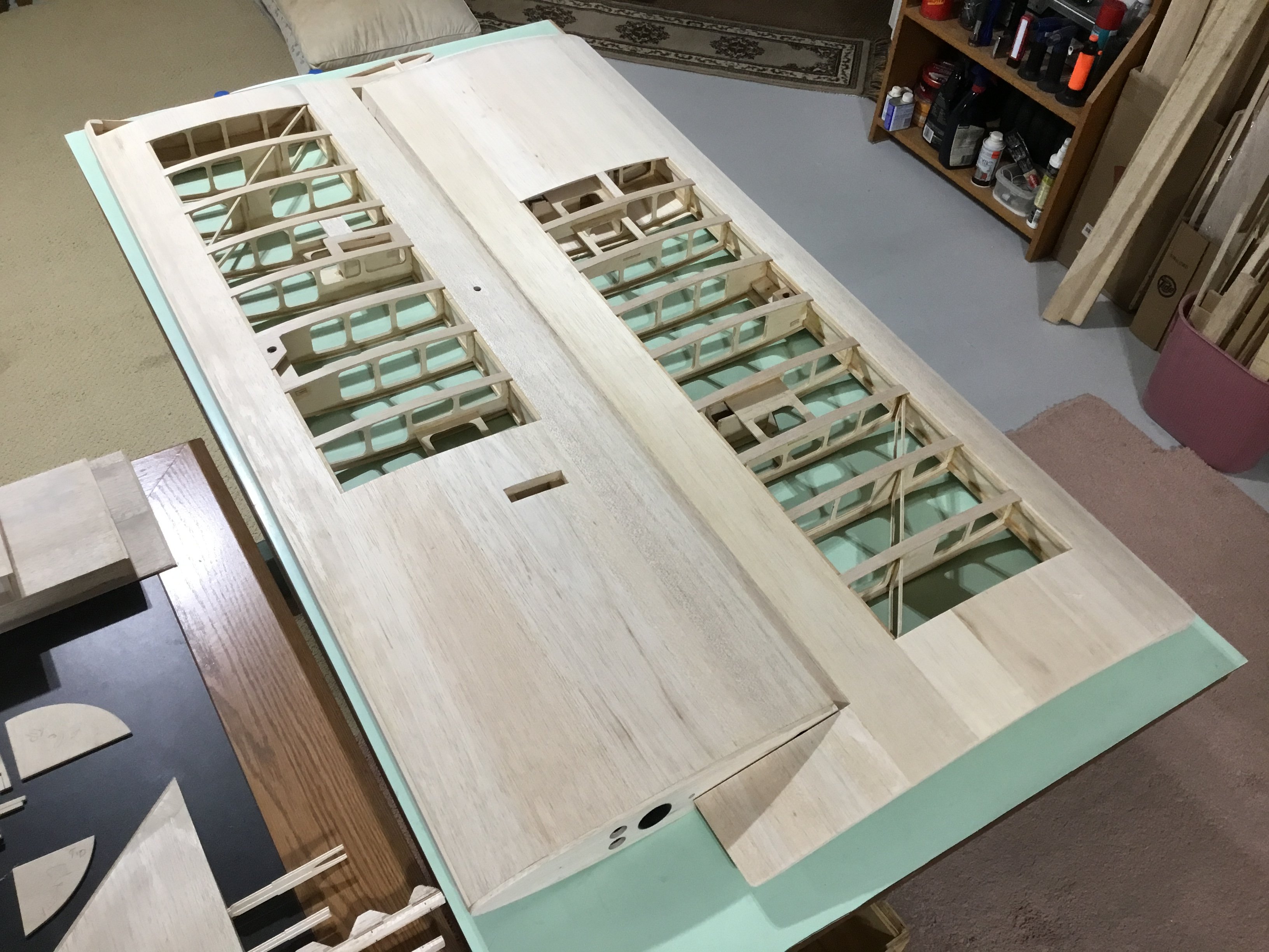

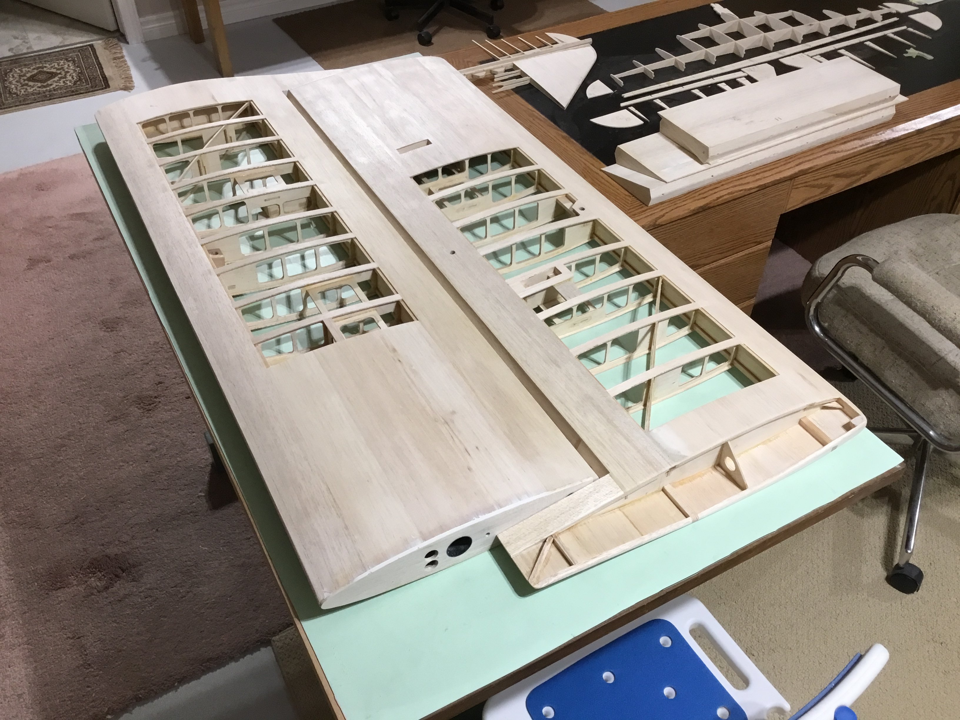

Both the wings are done all the gluing is done just needs final sanding and finishing. Will be starting the rudder and stabilizer next.

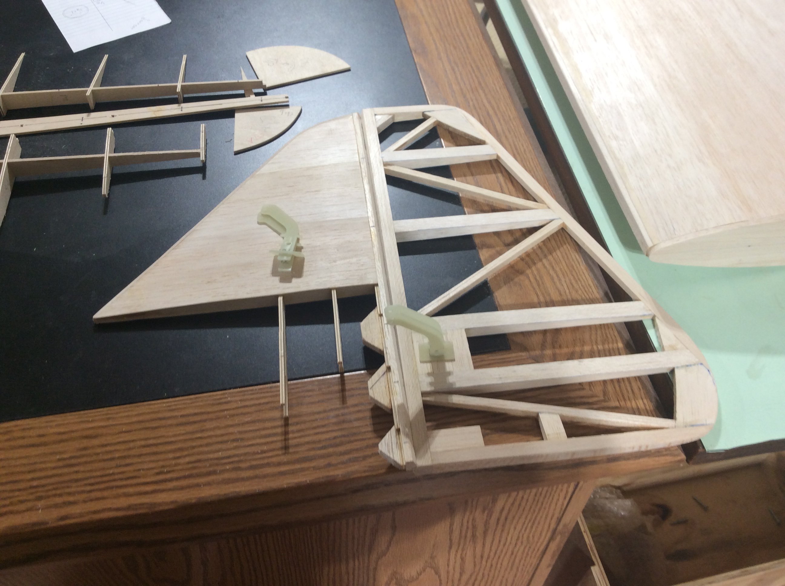

Waiting to see how the trailing edge work out.

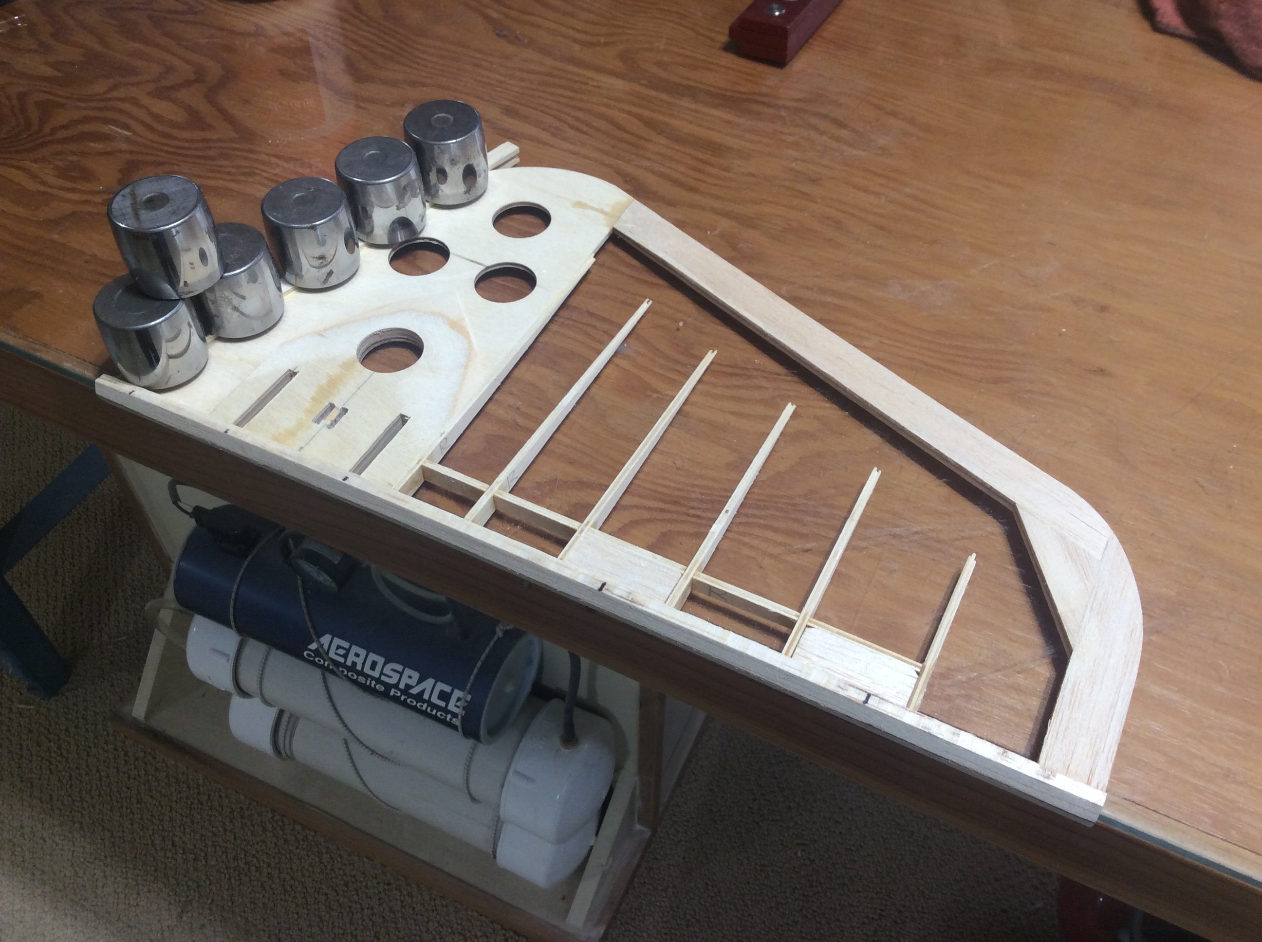

Well making progress slowly. The stabilizer is framed up and with a little sanding it will be ready to sheet one side. Still have to decide how to finish the stabilizer tips, whether to cut the tips off and it to the elevator. Not sure right now.
Having some difficult trying to sheet it the stabilizer bends in two directions and having some difficulty trying to get the sheeting lay down on the stabilizer. Working on it hopefully I can find away to get it sheeted.
