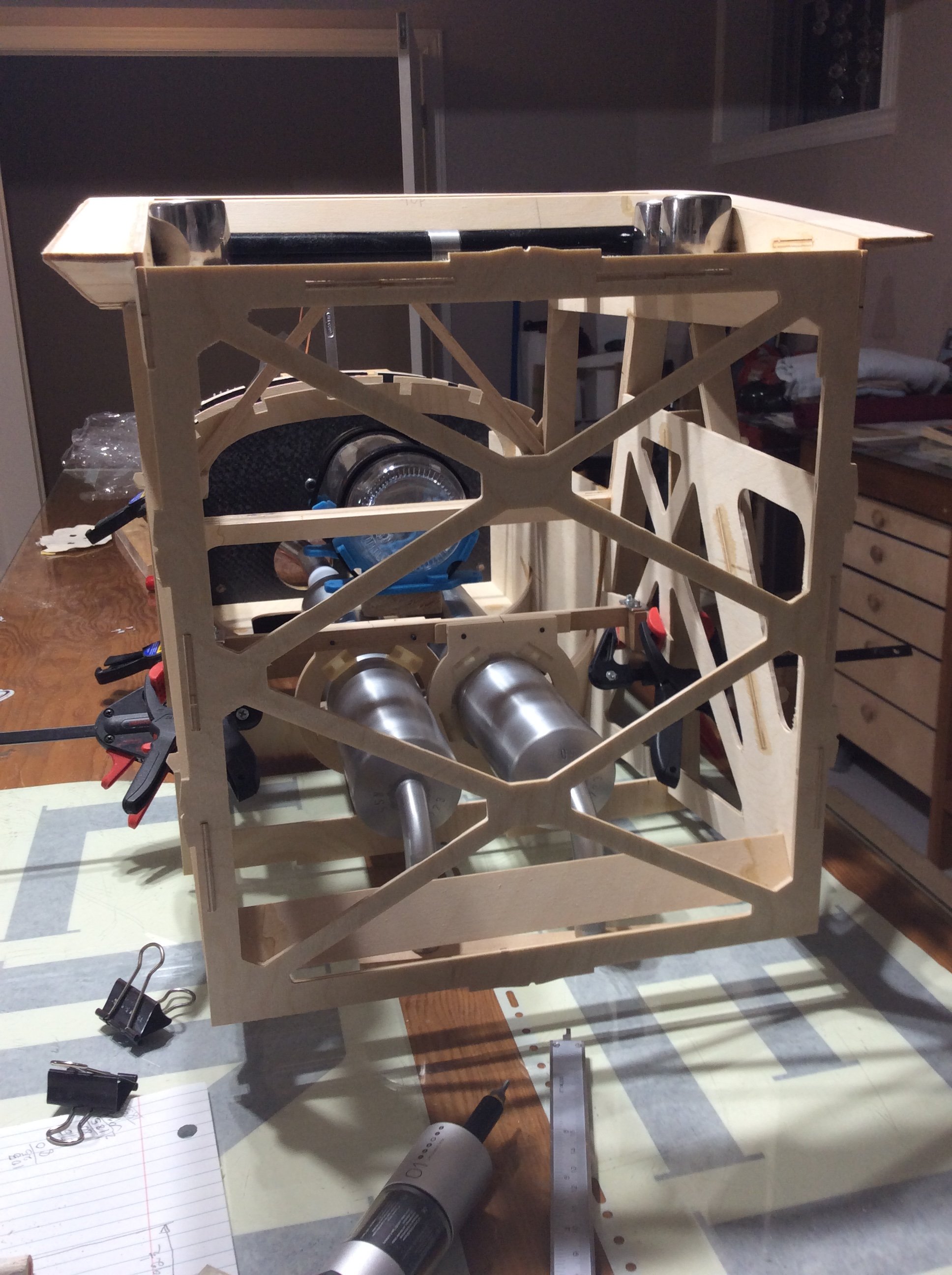

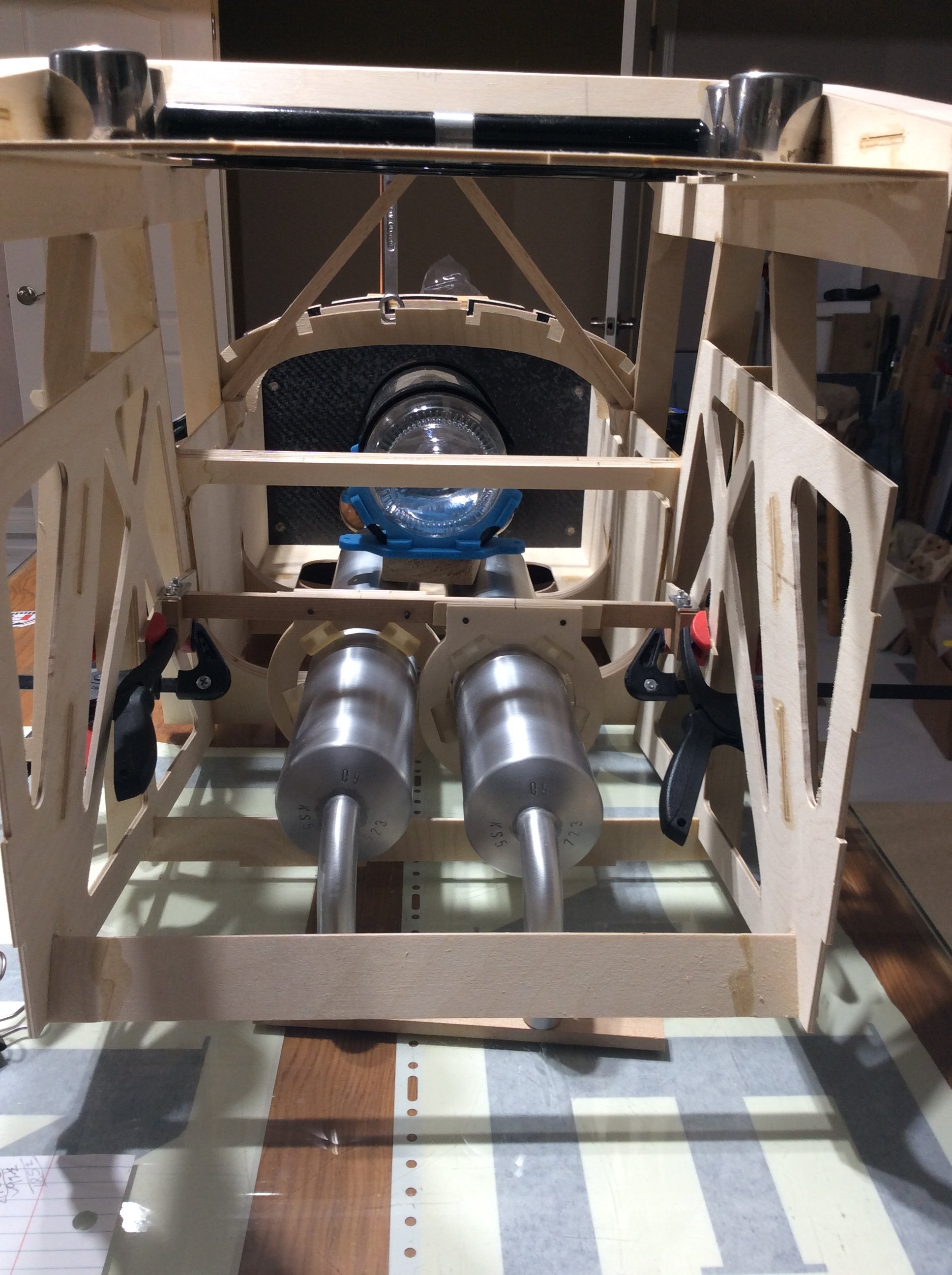

Well after some fiddling and trying to make the engine fit with the canisters. It became obvious that I was In a bit of difficult. Started weighing everything in great detail and all the components and I mean everything. After several attempts I kept coming up that the plane will be well over 40 lbs. this will have be digested and given some thoughts.

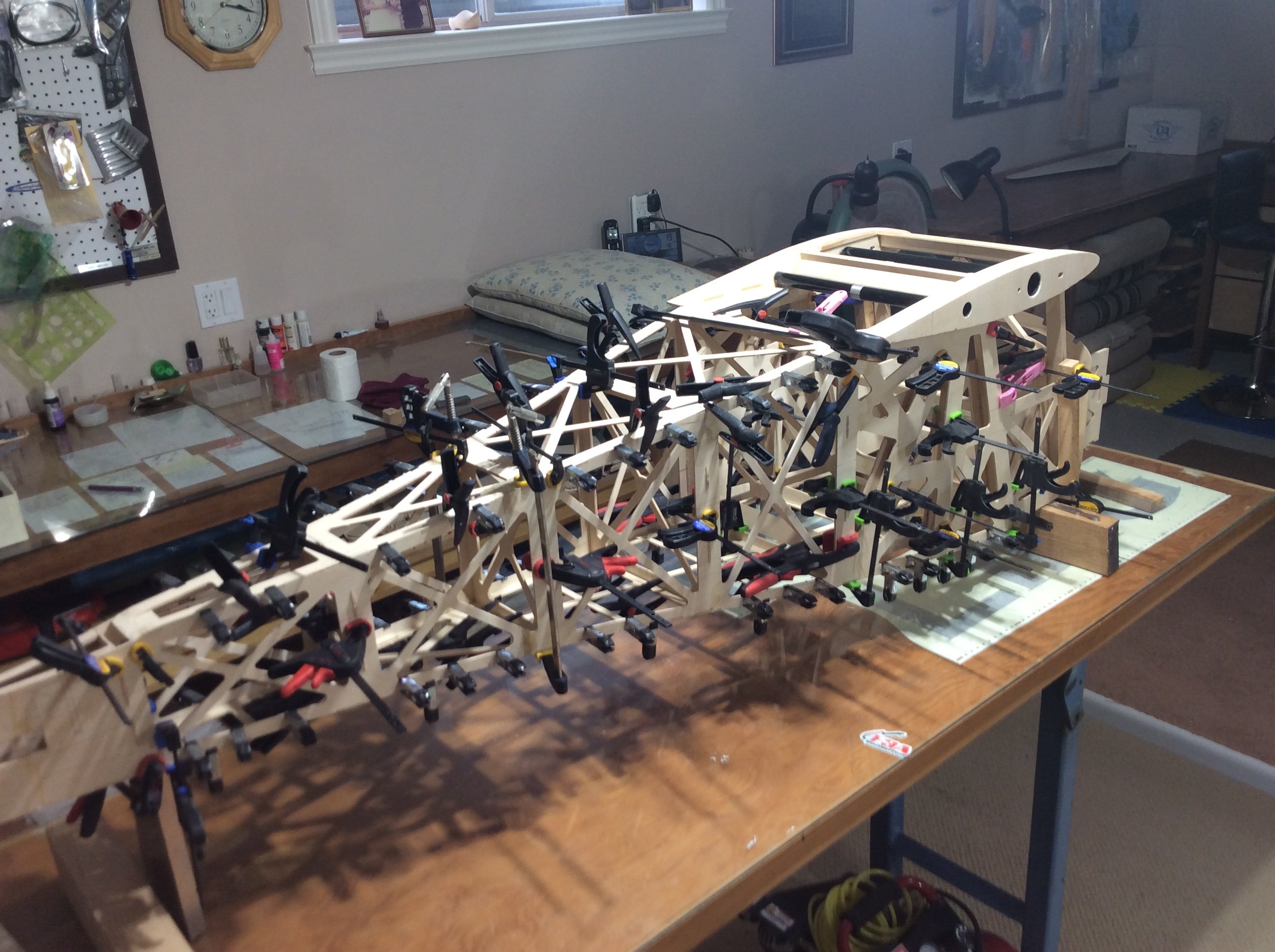

Well decided to put the back half of the fuselage together check if everything squared and parallel. That took a while but then used the Lazer and it went a lot better. It’s all aligned and glued just needs cure, should be ready tomorrow to remove all the clamps and see what we have.
AKNick
Boy do I love visual progress like this! You'd save another 4lbs if you didn't use the cannisters. That would be easy to omit last minute though.
I've always enjoyed seeing your wood working skills, whenever I imagine a beautiful wood joint - it looks like your work in my head . . . not how I do it though ha ha!
