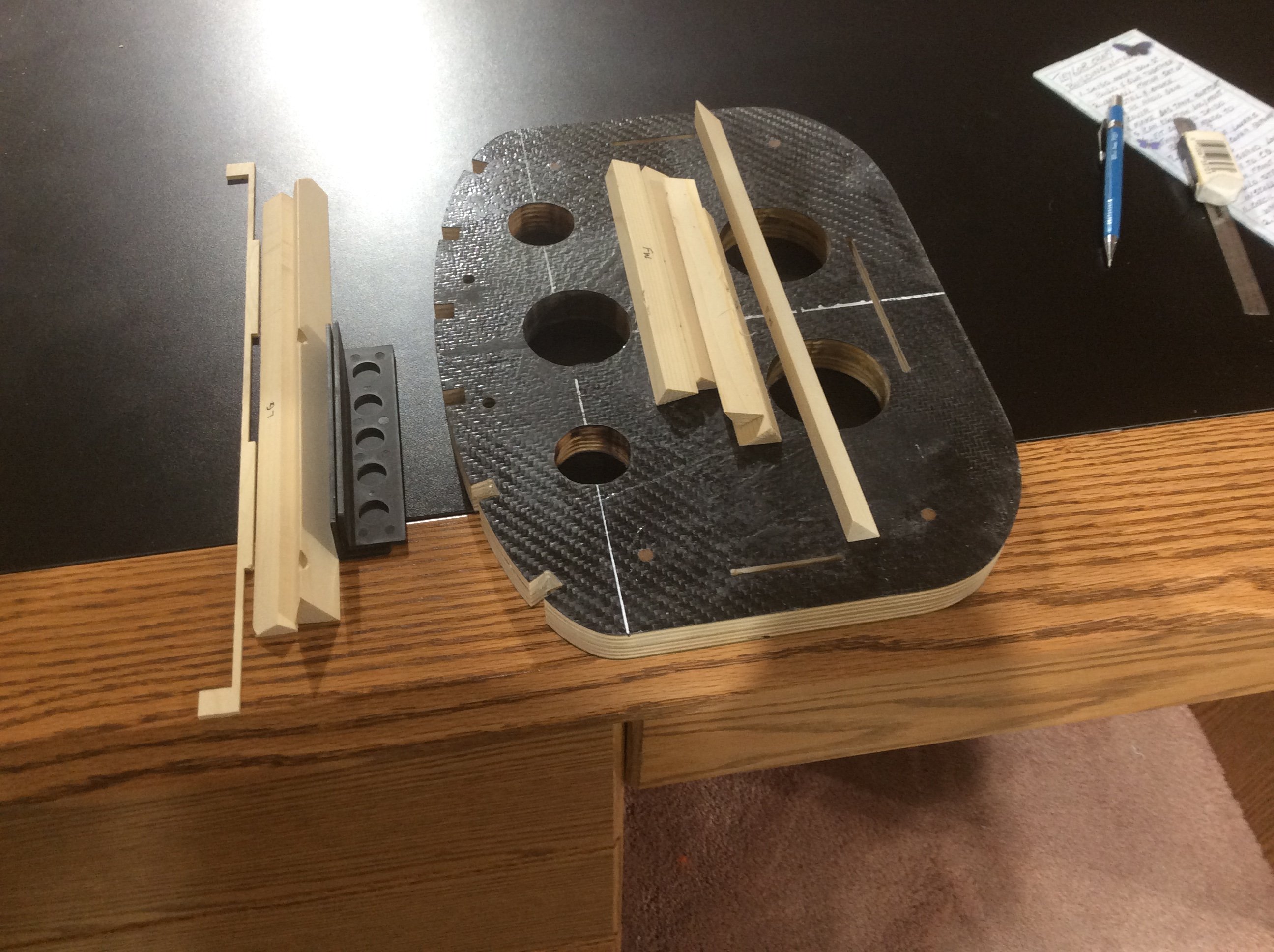

Working on the motor mount and motor box. Trying to see what to change and see if I can save some weight.

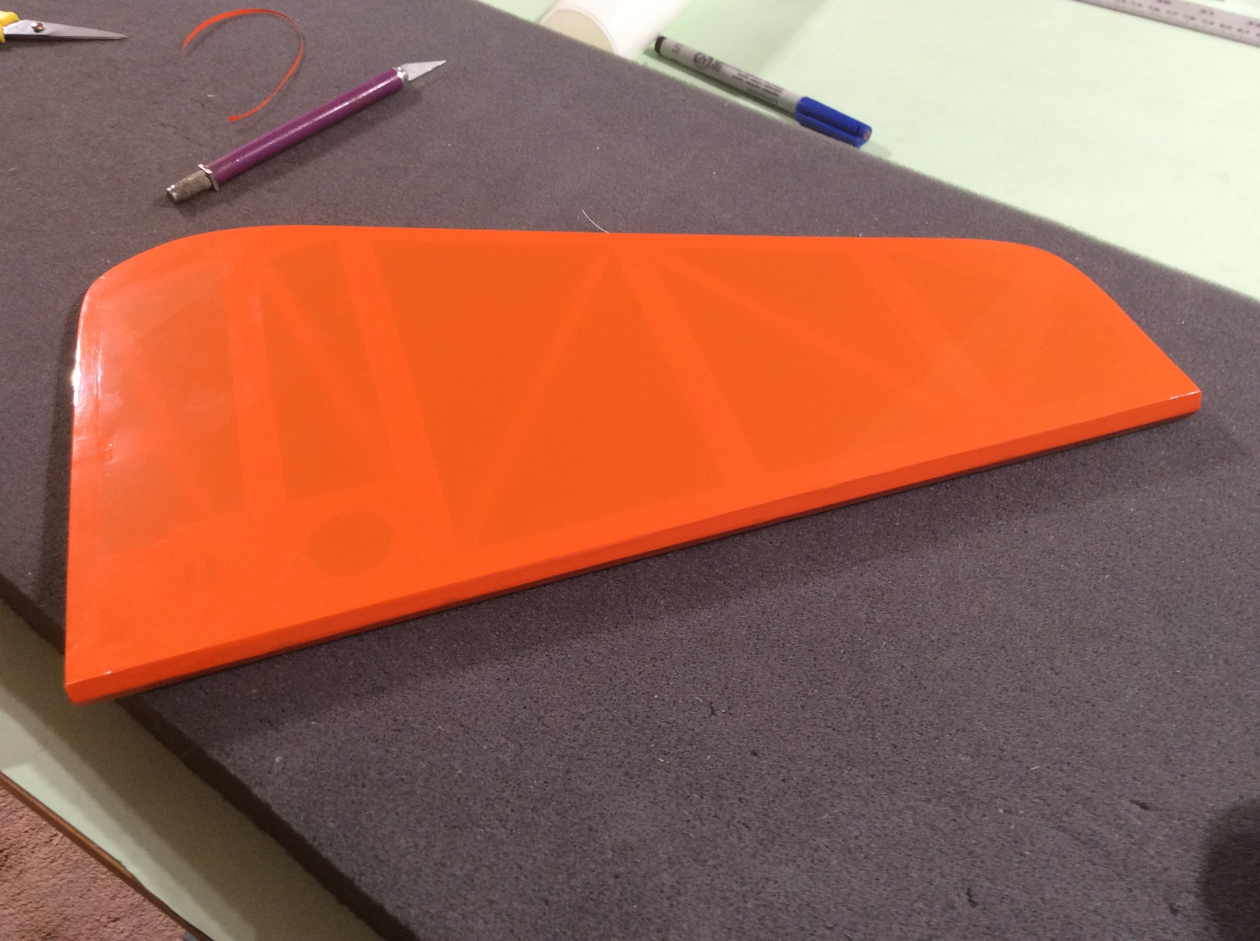

Well just plotting along, decide to cover the rudder and the two elevators, while contemplating the rest of the build.

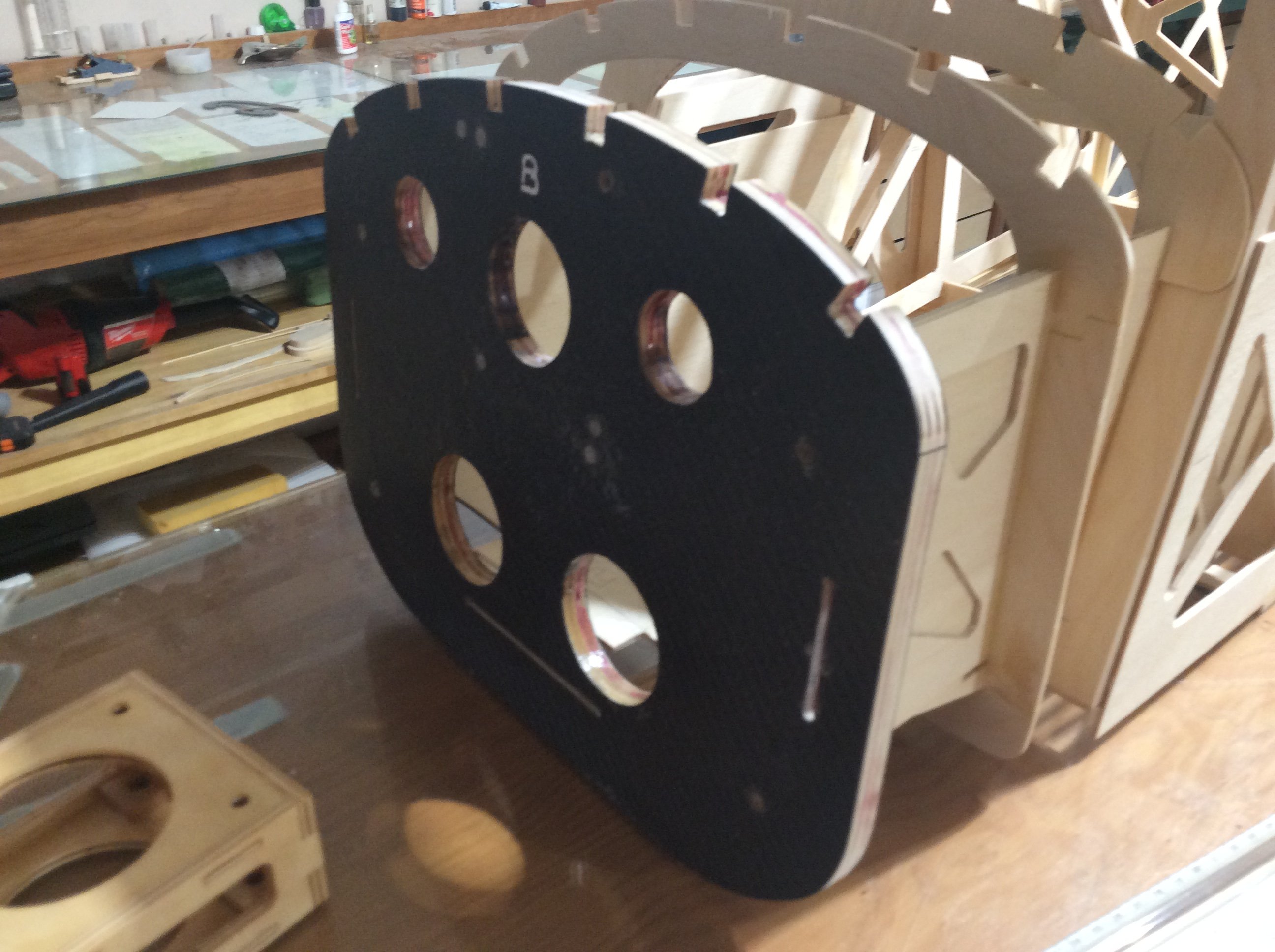

Ok this was a lot of work and a big change for me the firewall has been completely rebuilt. It was originally 22mm thick and now it is just under 12 mm thick. Removed 12oz of weight. Split the old firewall blown the middle and removed just over 5mm from either side. Then put the 2 halves back together and vacuum bagged the firewall. The picture shows the end result.
This just showing the firewall being vacuum bagged.

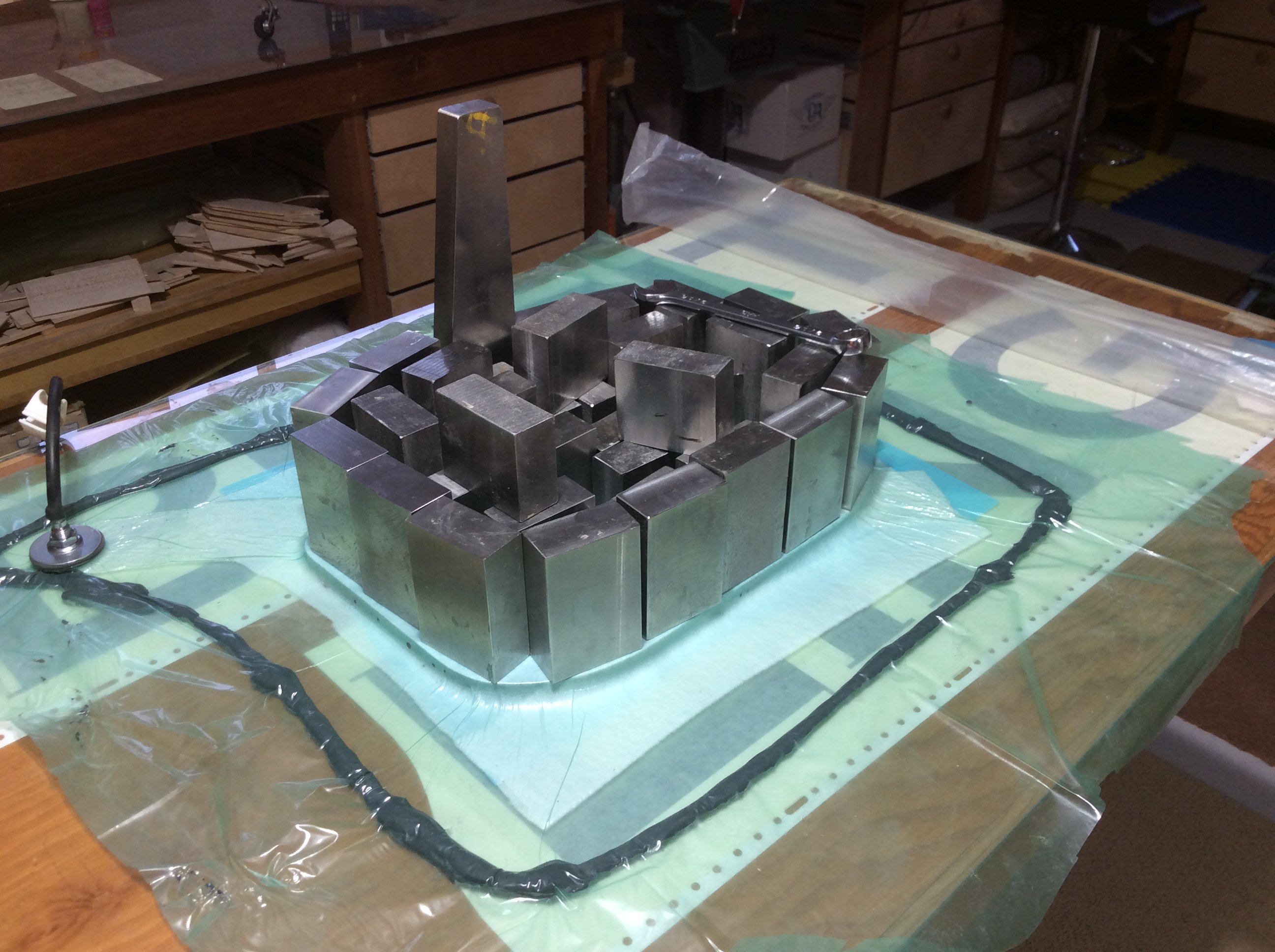

Have question for @TonyHallo looking and following your builds you seam to be using something different for the seal around the plastic bag. I am using this tack seal from the Fibreglass supply companies, difficult to use gets stiff and old quickly. Interested to know what you use.
TonyHallo

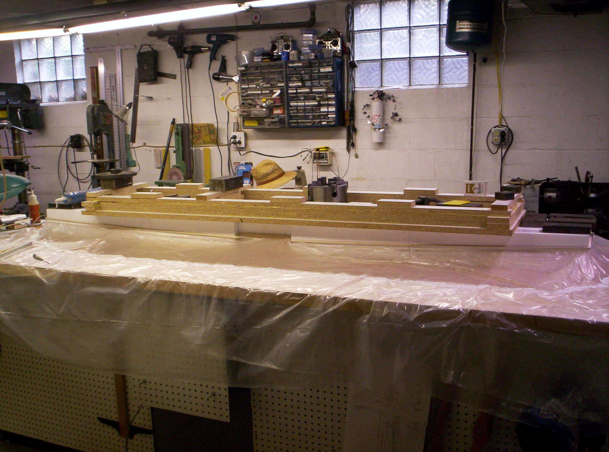

I use cheap door and window caulking to seal my bags. Plastic drop cloths for the bag material. A roll of tape and a tube of caulking are about the same piece. Never used the tape but I am considering using it for vacuum bagging the Cherokee fuselage. Watched a video recently where a man used a butyl tape from Home Depot. I said it worked but not as well as original.
This is the largest bag I've done to date using drop cloth and caulking, 96" one piece Cessna wing, 3/32" sheeting, polyurethane glue. I believe I use a glue called ProBond from Emler's as it seemed to take a bit longer to foam. This was some 18 years ago.
