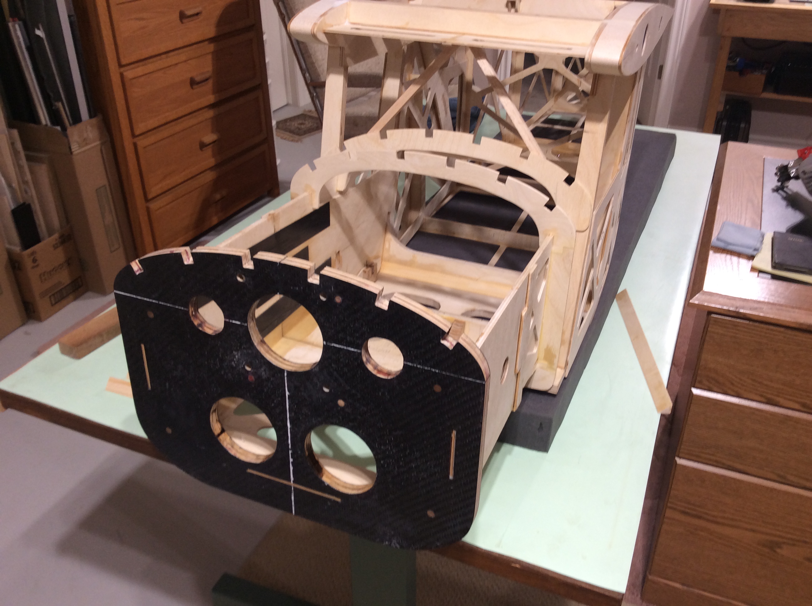

Well the firewall is in and looks good just have to spend some time cleaning out the corners and then gluing in some gussets around the firewall.

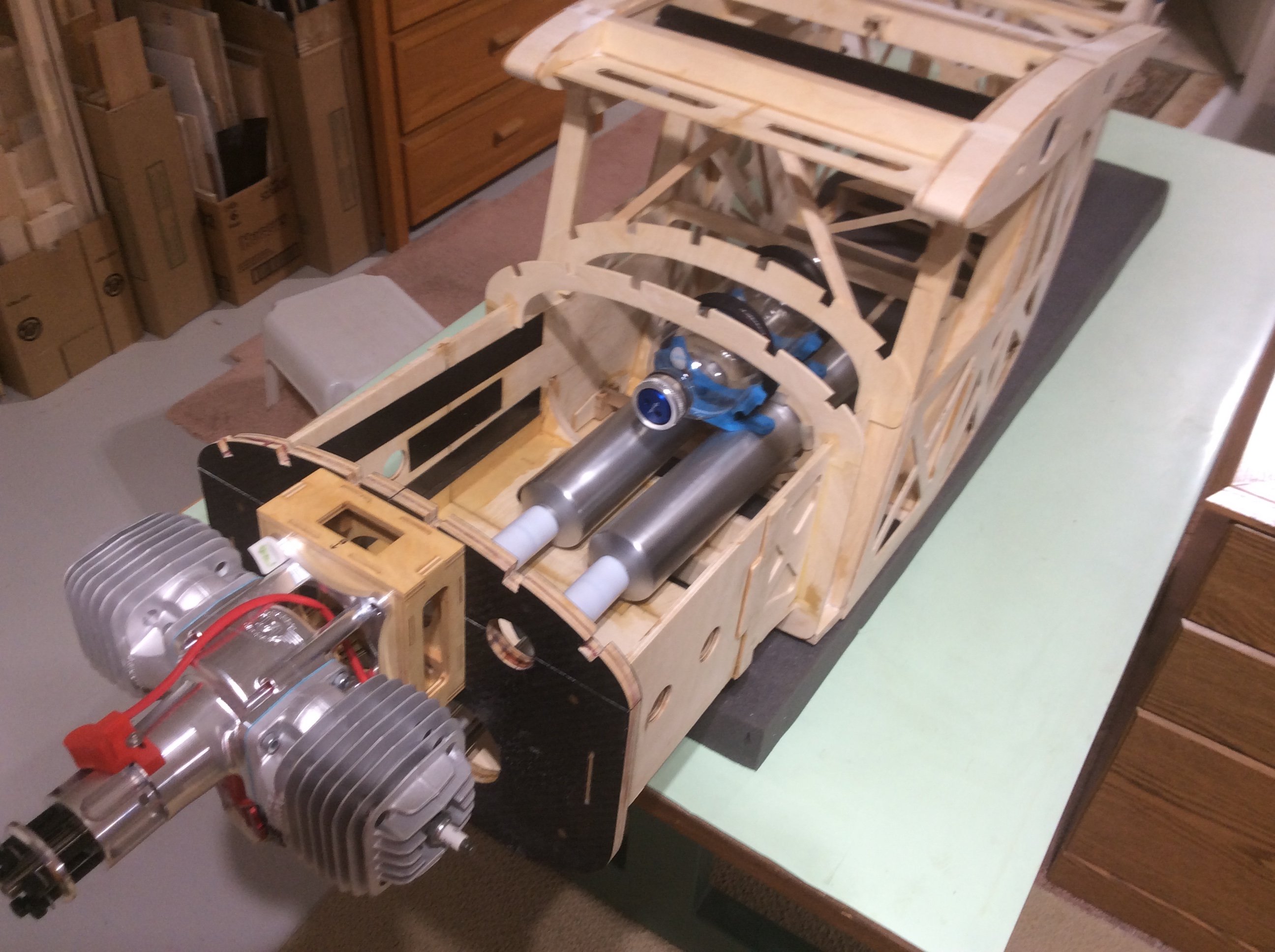

This has been on my mind for a month or so but at last I know it fits and can be done. The canisters are in and the gas tank is in over the top of the canisters and I have 1/2 inch of clearance to fit some kind of tank support structure. Hope fully the heat wont be a problem. Time will tell. But it fits. So will be making a removable tank structure, tomorrow.

The firewall was 1 inch thick. I cut it down the middle and then removed around a quarter 1/4 inch from either side and then glued them back together. After it was all done the firewall ended up just under 7/16 thick. Splitting the firewall and removing the centre was a lot of work and difficult to get the two sides flat and square again. Managed to remove half the weight out of the firewall.
Yes I added carbon tape down the sides.

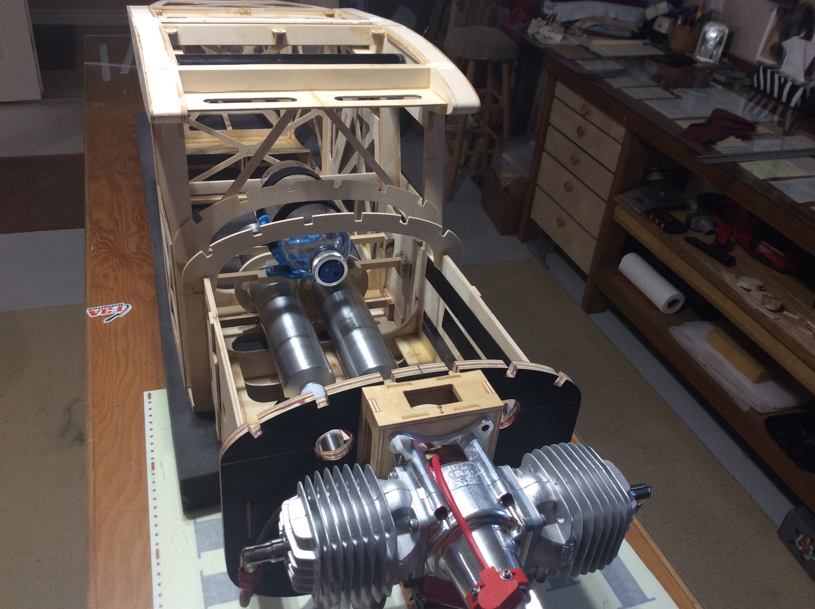

The tank is mounted and all the support brackets are removable so that I can get to the canisters when necessary, it will not be easy but can be done. The Taylor Craft does not have a lot of depth in the fuselage which makes things difficult. You can see all the brackets and aluminum hold down plates glued to the side walls of the fuselage.
