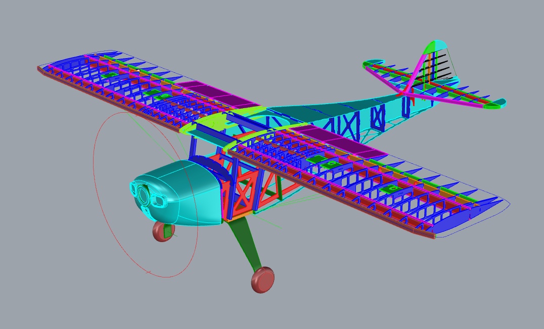

Tony, read along on this thread I started. I still need to get back on this and finish it up so I can share the files for anyone who would like to build one. It may not be the correct way of doing things but it's what works for me.
Find the patience. It's worth it once you learn it. I will not go back to AutoCAD for airplane design's again.

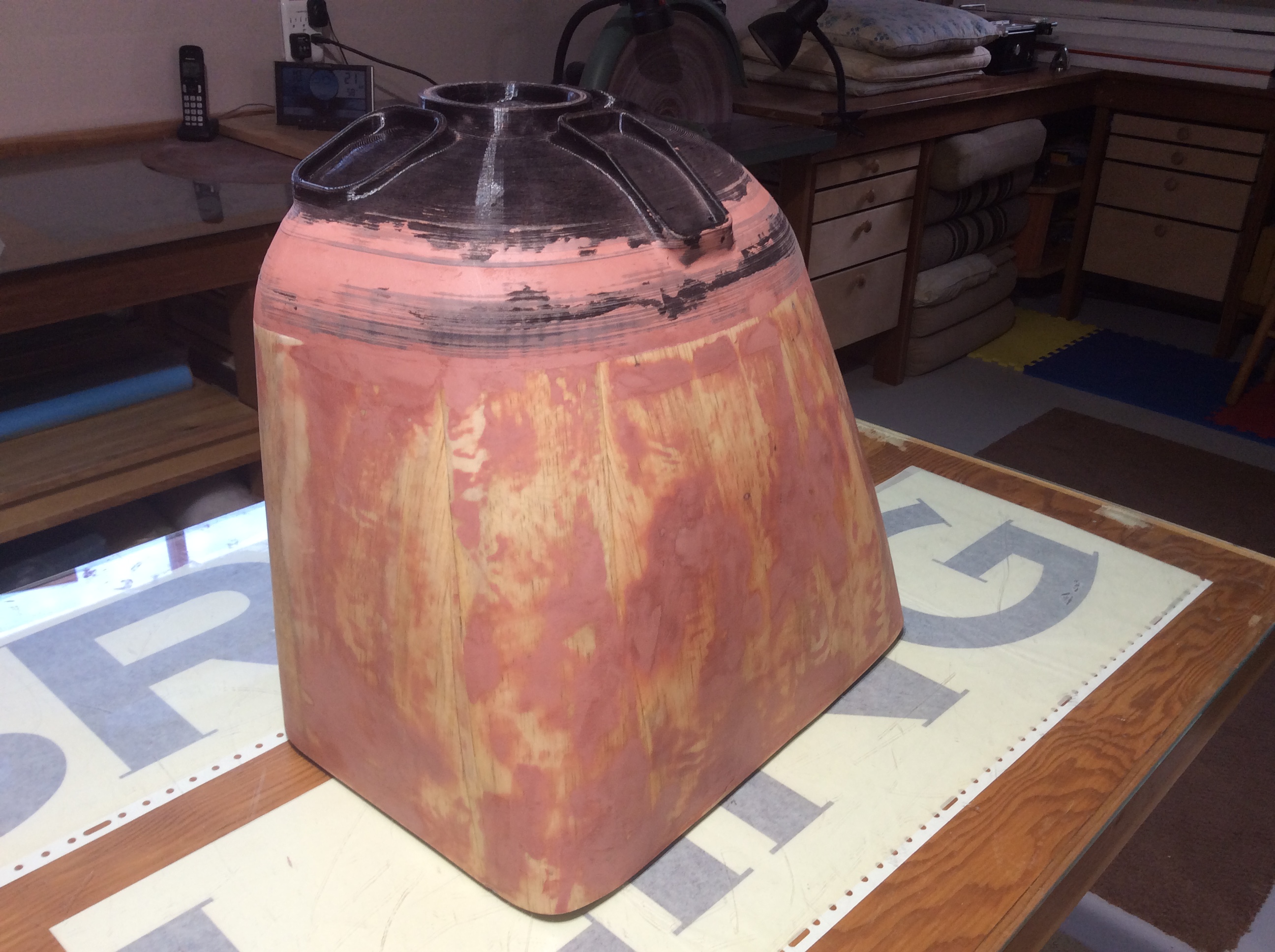

Ok the 3D printed part and balsa part have been glued and glassed together. Then puttied several times until everything is blended properly. Now it will be primed with a 2K primer and worked on until is ready to be used as a plug.

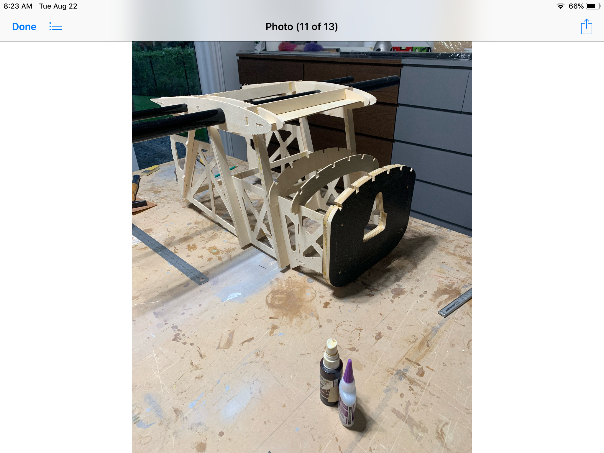

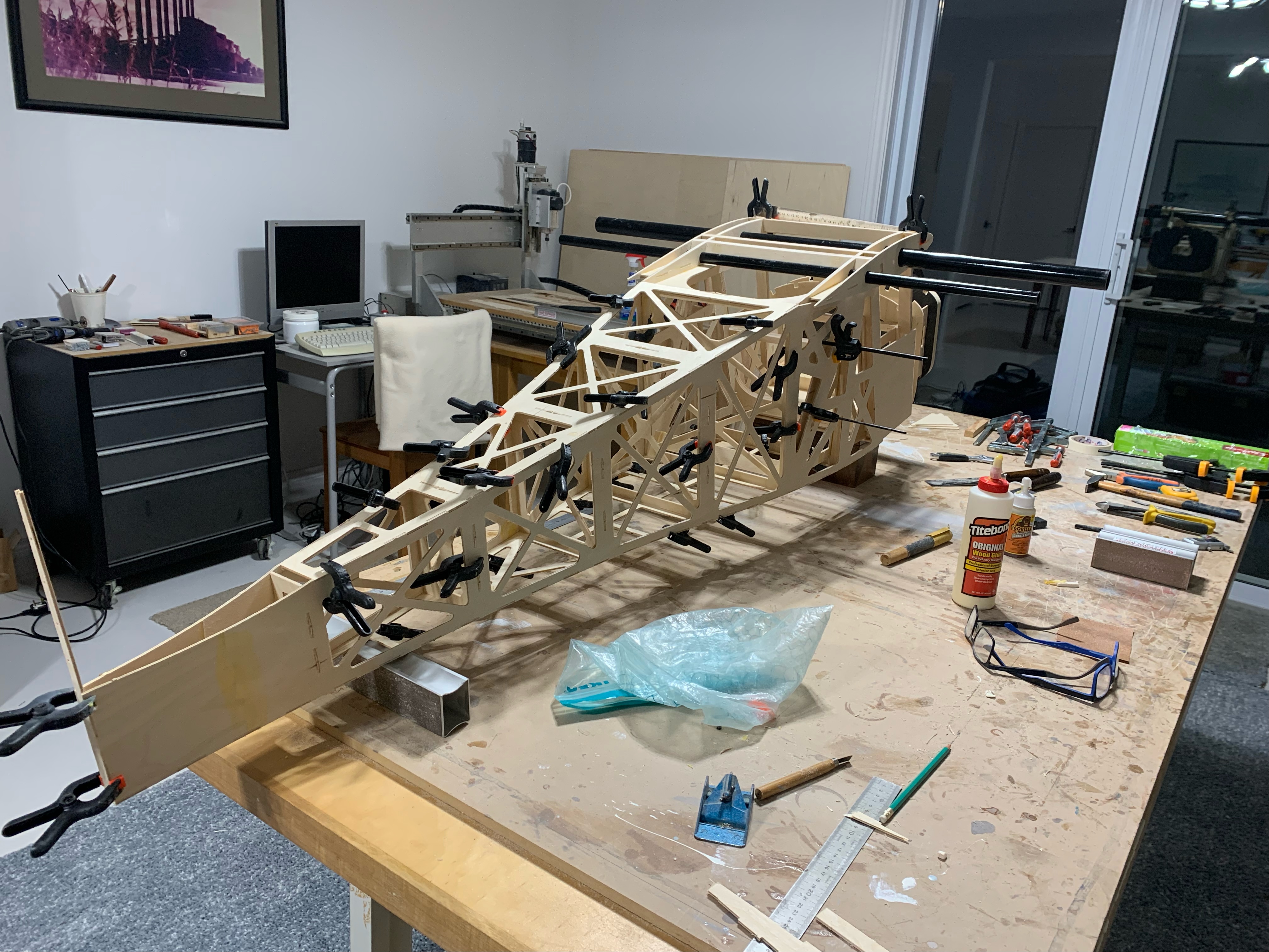

The weather has not been good the last couple of days we spent a few hours separating the parts from the plywood sheets. Luc had some time the other day and dry fitted some of the parts to see how it all looks. The picture is showing front end without any glue just pressed together.
Well Luc has started building like he is on a mission. One thing I cannot believe how wide the plane is. One thing is the way Luc has designed the plane it just falling together and it is straight and square, not going to be difficult to build.
