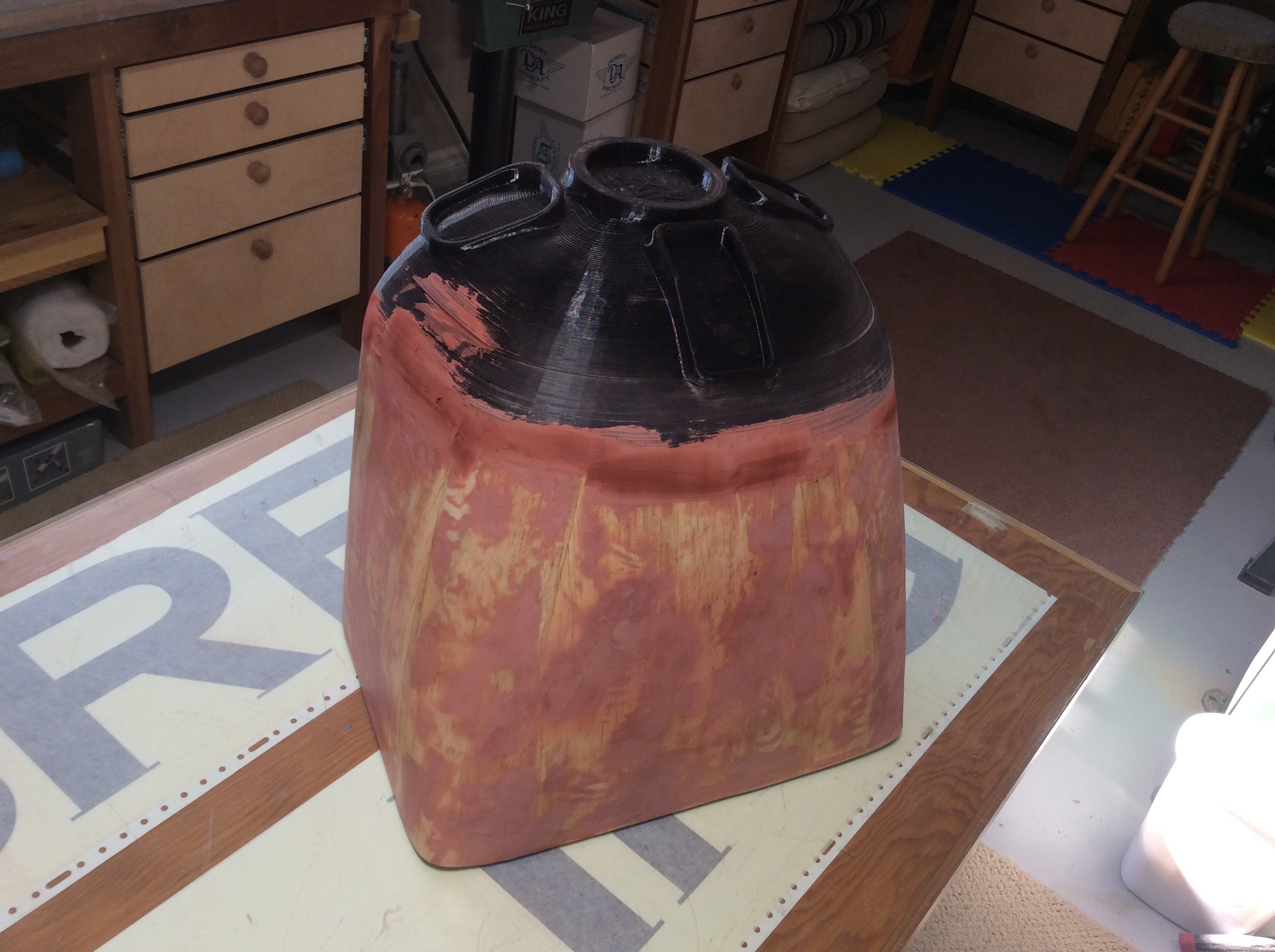

We are making progress slowly it depends on the weather if it is windy or raining then progress is made.
This is cowl plug being made. Luc printed the nose cone and now it is being glued and blended to the rest of the cowl.
TonyHallo
I assume you are filling the areas adjacent to the openings as well? I expected to see the triangular shaped inlets just because that is what I have in the past, but if you look around you will find other as well. Very neat way to make the bowl area, I need to get into 3D printing.
@TonyHallo
I am not quite sure how Luc is going tackle this I have never built a cowl this way, but sure is interesting. I do know he had a drawing or picture of a Taylor Craft that was used to do the 3D printing. Yes I agree 3D printing is amazing and makes a lot things a lots easier. From what I have seen so far it is not so much the printer but expertises of the person to make the drawing and the set it up so that it can be printed. And yes again I really would like to have one.
Well then let's wait and see what Luc does.
I downloaded a free version of Fusion 360 to play with, will see what happens.
i have Fusion on my lap top. Not that easy, I am very proficient in AutoCAD but in 2D. I moved off the design table before 3D became the norm. I have opened Fusion a couple of times but at this time I do not have patience to teach my self for hours to make a drawing.

Tony, read along on this thread I started. I still need to get back on this and finish it up so I can share the files for anyone who would like to build one. It may not be the correct way of doing things but it's what works for me.
Find the patience. It's worth it once you learn it. I will not go back to AutoCAD for airplane design's again.
