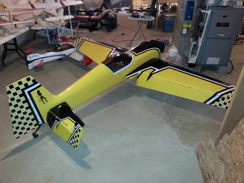

So what size servo arms is everyone using for IMAC? 1.25 enough for imac? 1.75 for push/pull rudder? Ordered a full set of MKS 777's to go on this bad boy last night.
Dan767
I'm using 1.5" arms, pull/pull on rudder. With the 3W-157 up front and push/pull, there is a chance you might be tail heavy. Batteries as far forward as possible will help. I have a DA170 with Re 3's and had to add 4oz. to the motor box for balance. CG is on the center of the wing tube.

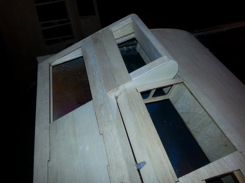

first wing tip is done. yaaaaaaaaaa
