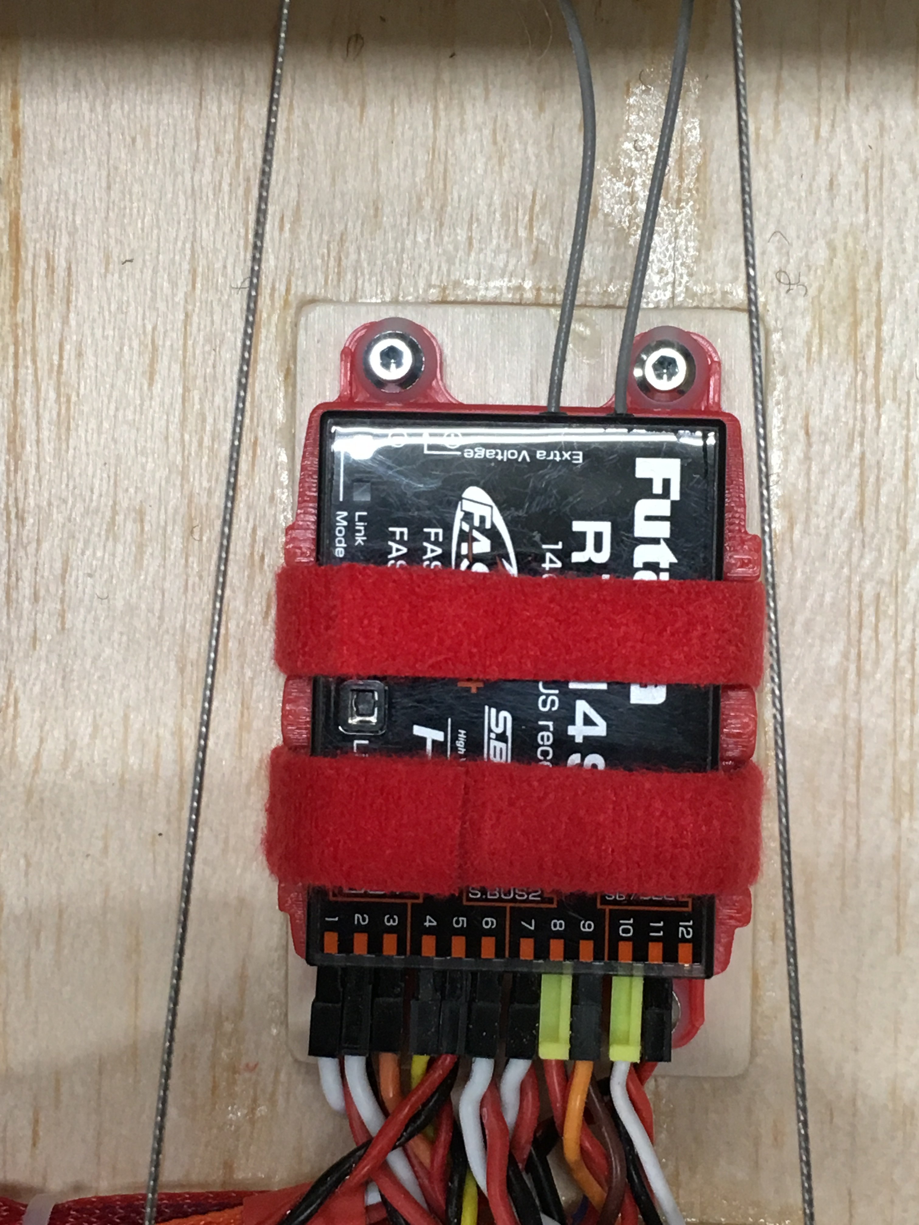

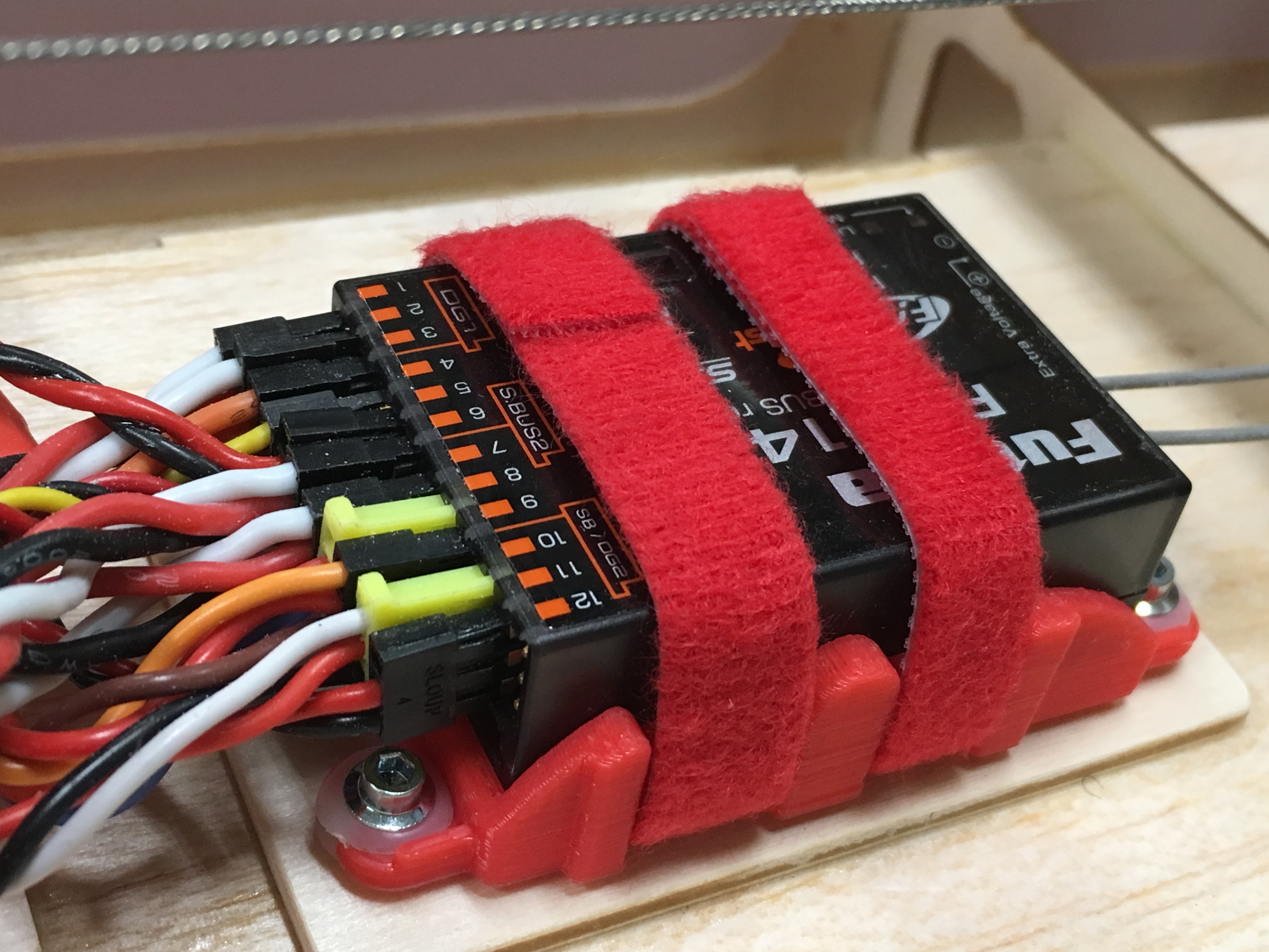

Redesigned the Futaba R7014SB tray. The original was too boxy, designed for foam padding... now it’s a snug fit, servo style grommets and sleeves. Now I am thinking about raising the side center posts to act like clips to retain the Rx in place of a strap.
I would stick with the straps I belive it will allow the the receiver to be little bit more isolated from vibration than hard clips.
AKNick
Thinking I may add a slot on one side of the trays strap recess so I can glue in a piece of double backed Velcro and then I can wrap it around itself while tugging. OR maybe just glue the Velcro to the tray itself? Now that I'm writing this... maybe I could create a flat to use a small screw to hold it in place. What do you guys think? The screw is sounding like a good user friendly idea.... now thinking a slot with a recess for a small servo screw :fist_pump: THEN I could tug on it, and wrap it around on itself. :applause: I may have answered my own question.
I also discovered that thin CA leaves a white haze when it dries on PLA, kinda nasty looking actually. doesn't rub off easily, and not all the way I'm finding. just learning as I go!
AKNick
Installed my receiver tray in my edge! I like it! I still need a better strapping system. I don’t feel like it’s holding it down tight enough.
