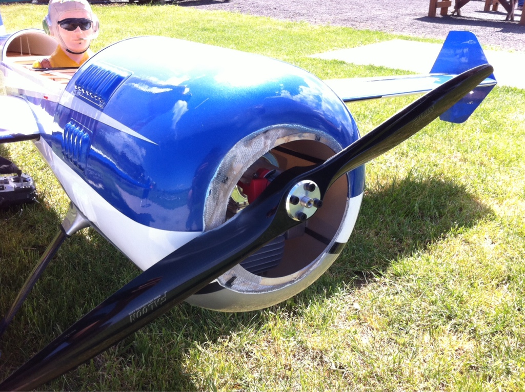

Second flight, more of the same but got a bit more aggressive with the control inputs. CG was still conservative. No bad habits. Landing wasn't as good. It was very gusty and I flared a bit high. The tail wheel came down first and drove the mains in. I bounced it and broke the Xoar PJN 24x10. No other damage other than the prop.

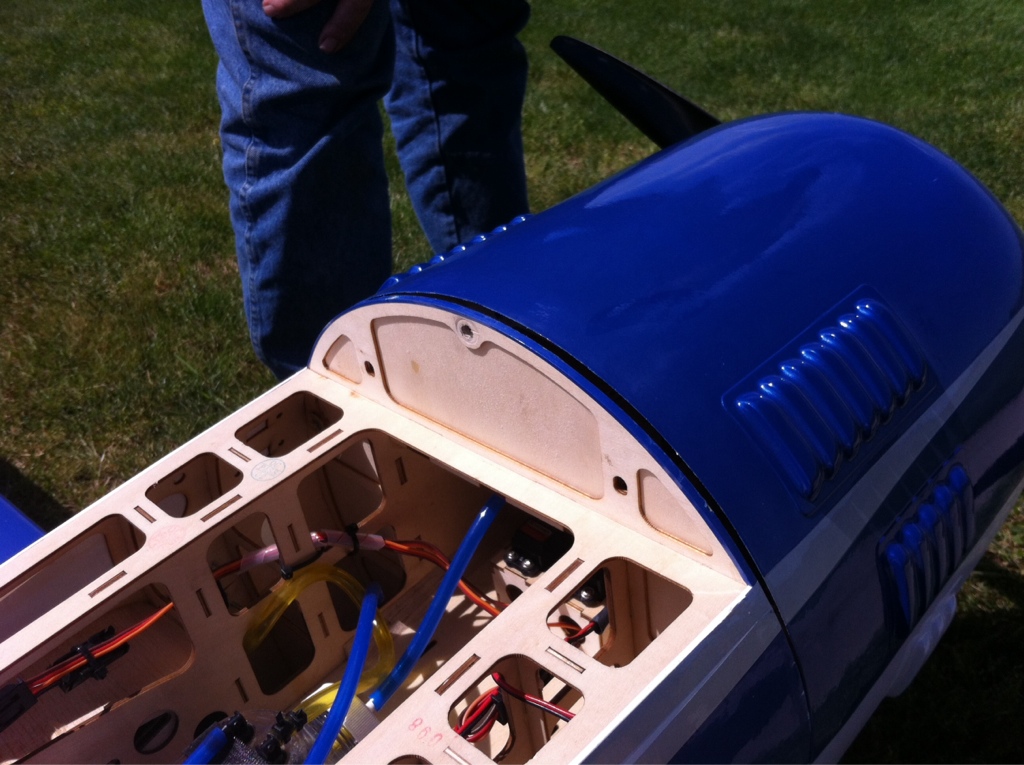

Third flight was very short. I changed props to the PJN 24x12, taxied out, took off and immediately notice a vibration at above 3/4 throttle. I landed and determined that one of the cowl screws had come loose. I fixed it and took off again. Power with the 24x12 was noticeably better. Pullout from hover was outstanding! More than happy! Flight time was a bit shorter as I was more aggressive and pulling more amps with the new prop.
I was still getting a bit of vibration from the cowl, but reasonable. I balanced the spinner, but not the 24x12. I just used it out of the package. I'm going to fine tune the prop balance and look at where the cowl may be vibrating. I left the 2 bottom screws off in case I needed to take the cowl off at the field so I'm pretty sure it's from that.

Good choice! Just make sure you tighten the cowl bolts REAL tight, use loctite and double check them between flights as I said yesterday. Here is what happened to a friend of mine on sat. It was his maiden day. He put 4 or 5 flights in and was loving it. Then we both noticed a weird noise during a rolling harrier. He landed right away and killed the power as quickly as he could :-(
Tim H.
Ouch... I check my cowl now. I had mine come loose too. No damage, but terrible noise...
3dmike
Ya we were all sick to our stomachs when we saw that damage! He had it repaired, painted and new prop on in a couple days. The plane just seems to have hardly any bad behaviors at all! Very nice plane.
