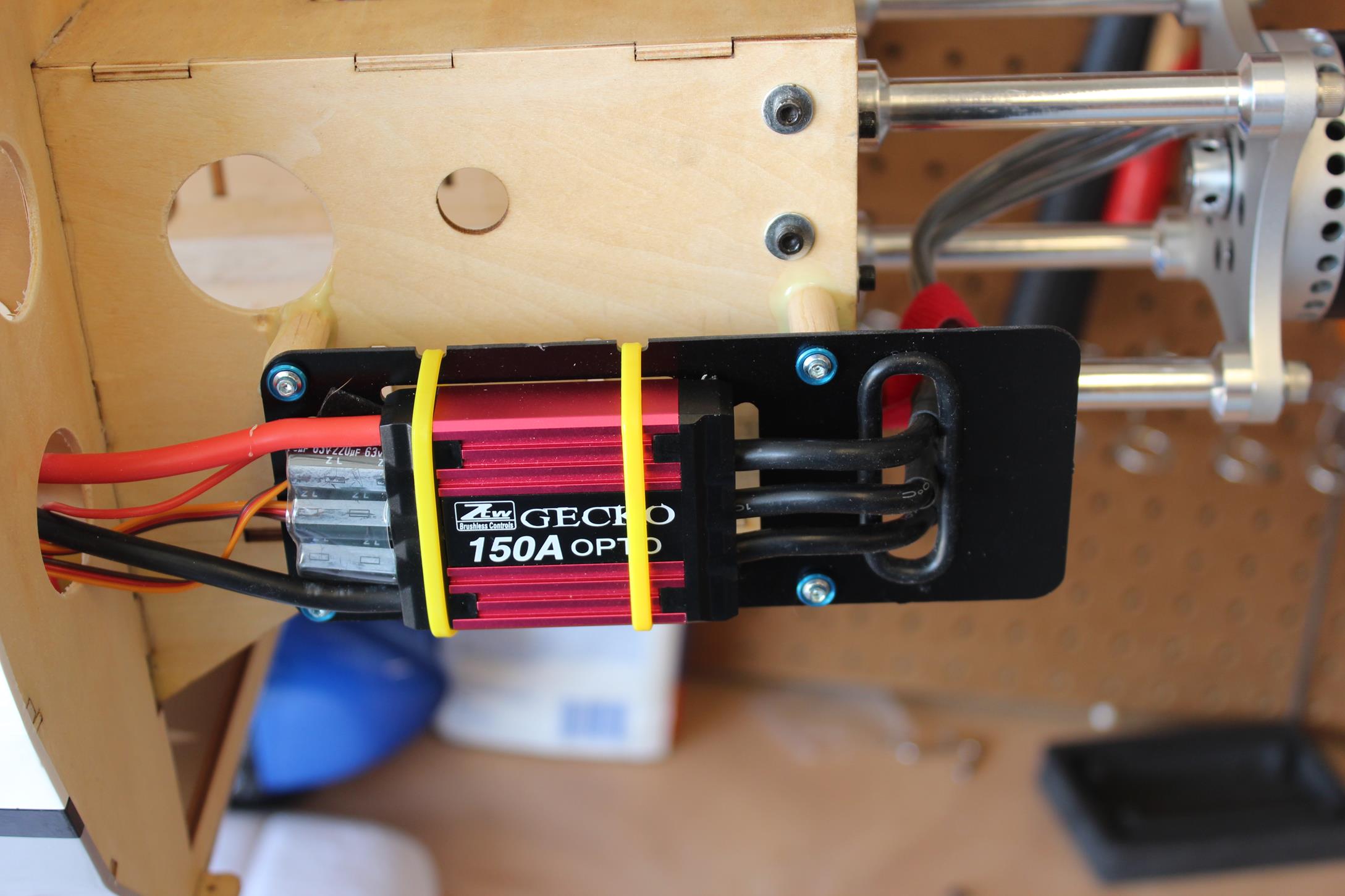

That gyro is awesome! Super easy to set up and flies great. I am working on a quick swappable plate system to make it easy to swap the Cortex over to different airframes. I'm going to cut the prototypes from G10 this week.

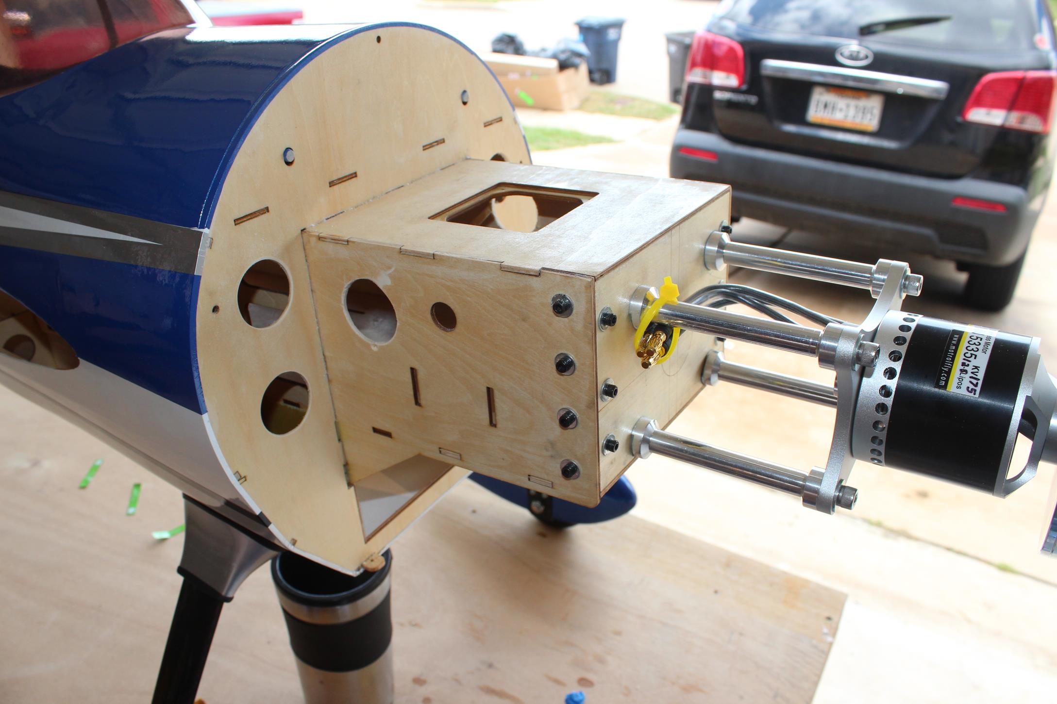

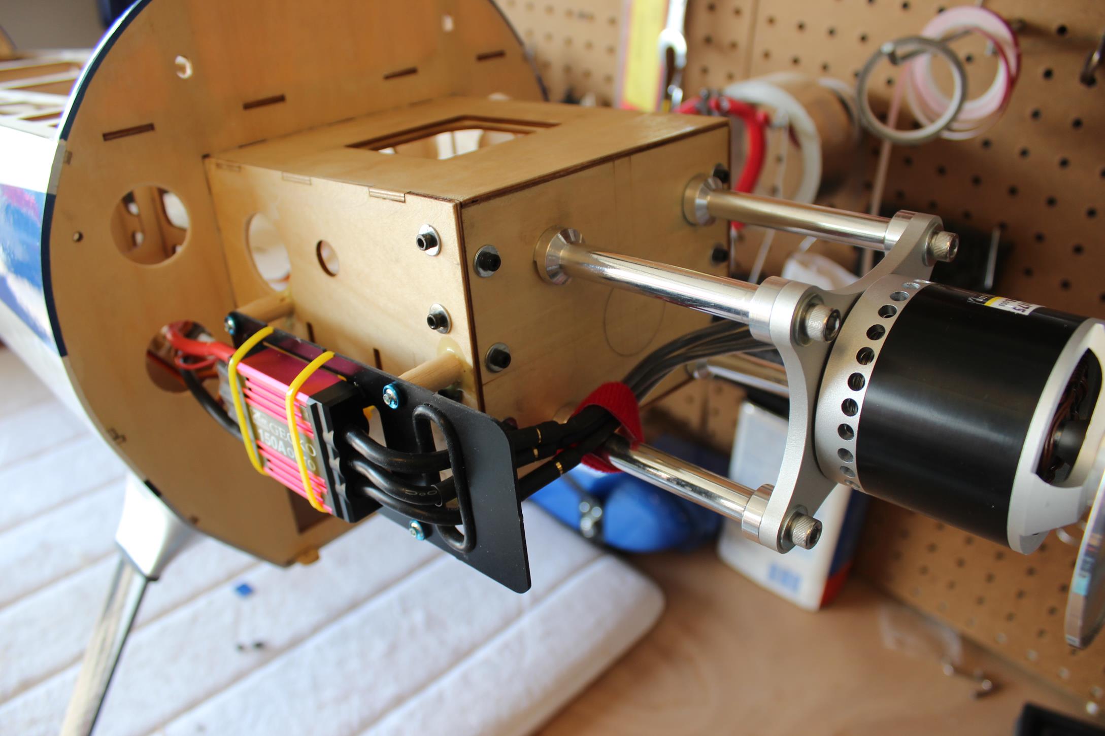

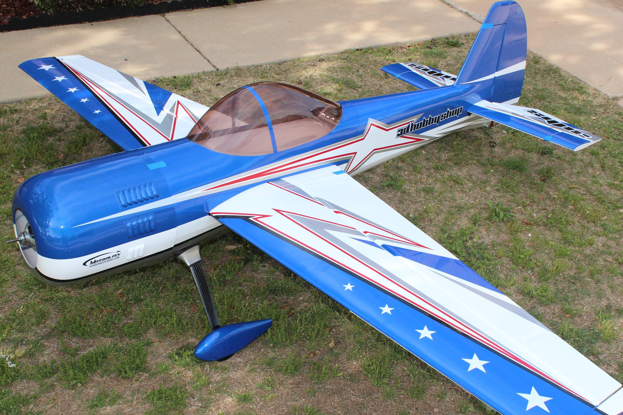

Yak is gonna get the new Motrolfly 5335 175 kv. I talked to Ken the other day and he suggested the new wind on a 24x12. I ordered the motor, so hopefully I'll get it this week. The airframe should be delivered on Tuesday, and I ordered 4 Hitec HS-7954SH servos from Chief Aircraft.

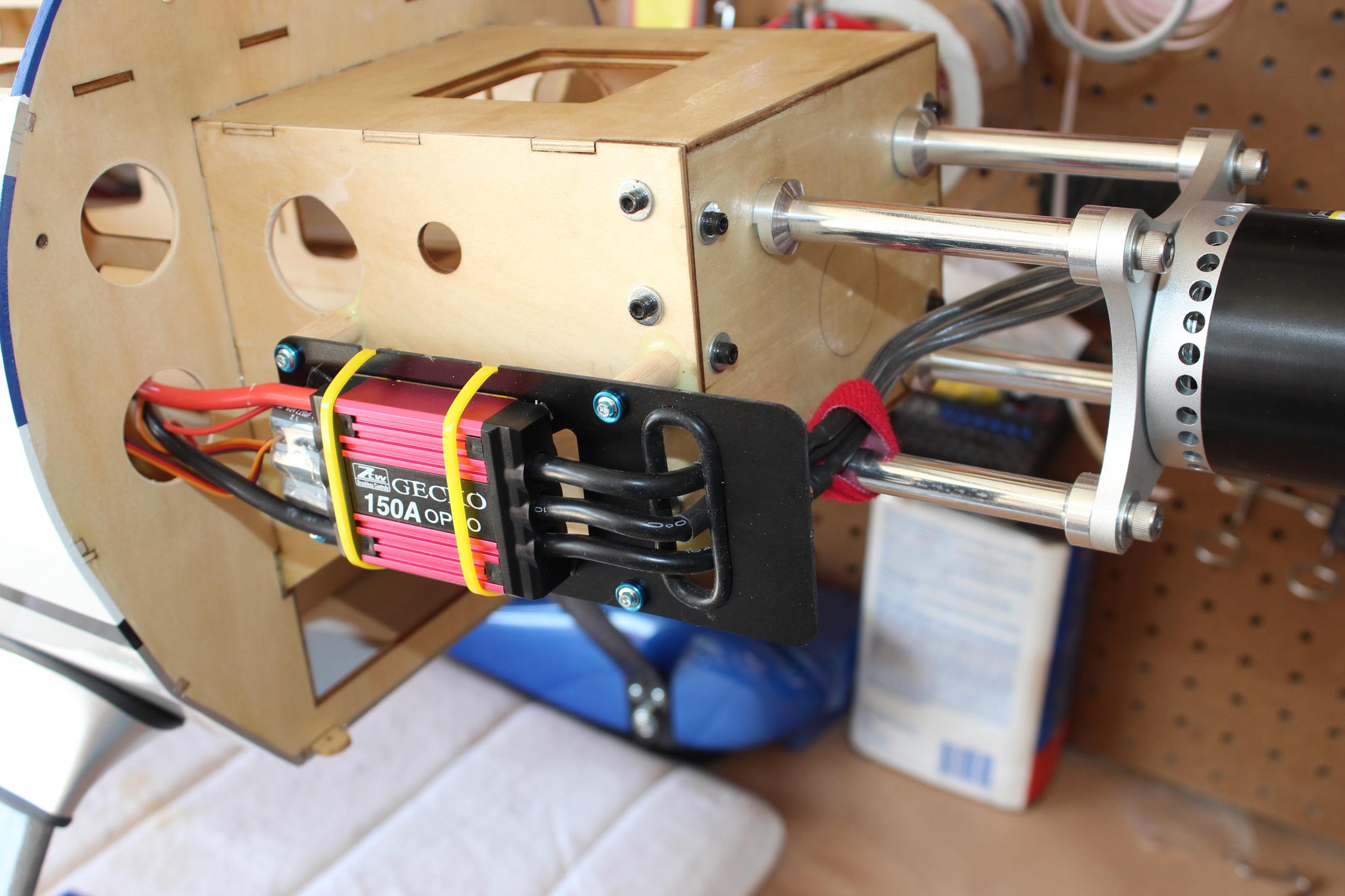

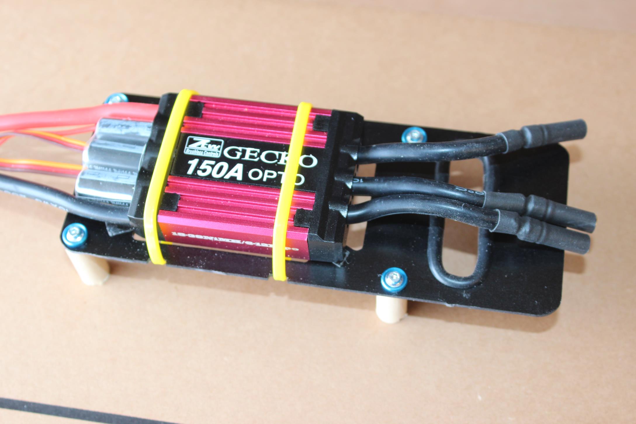

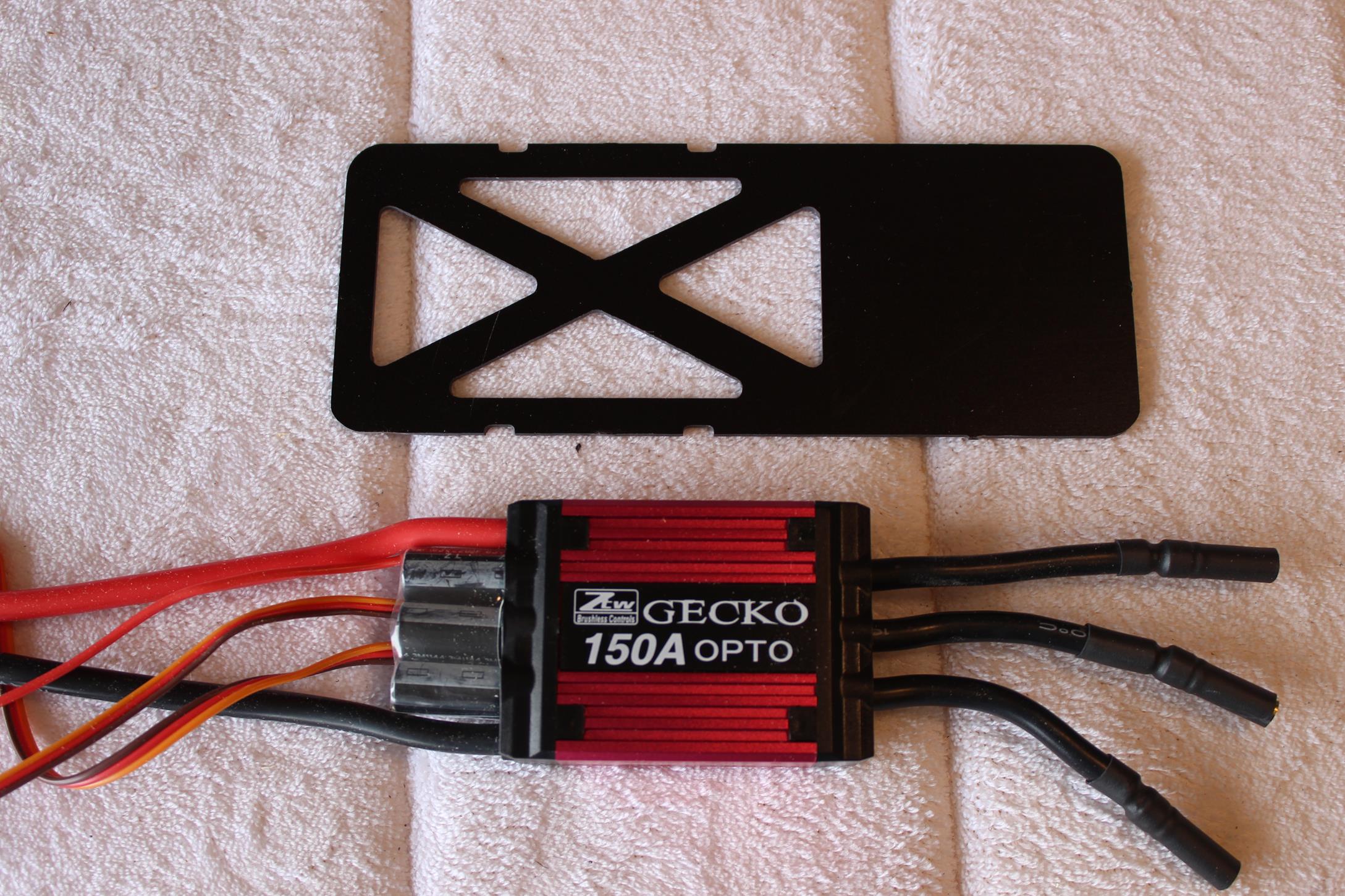

I'm going with a ZTW Gecko 150 ESC, and probably Hitec HS-7956SHR rudder servo. I need to order those this week. Not sure on the power dist. board yet. I need to read up on the Spektrum AR9110 to see if I need/want to go that route. This is the biggest plane I've done so far so I'm wading into unknown waters for me.
Xoar 24x10 and 24x12 to start on the props. Hardware, servo arms, etc. to be decided. I was hoping to get it flying by next weekend (I have the week off), but that's probably not gonna happen.
I may start a build thread here... The Poor Yak isn't getting a whole lotta love yet...
I highly recommend that you use the AR9110. It works great and is one of the simplest ways to set up a plane this size with a good power distribution system.
