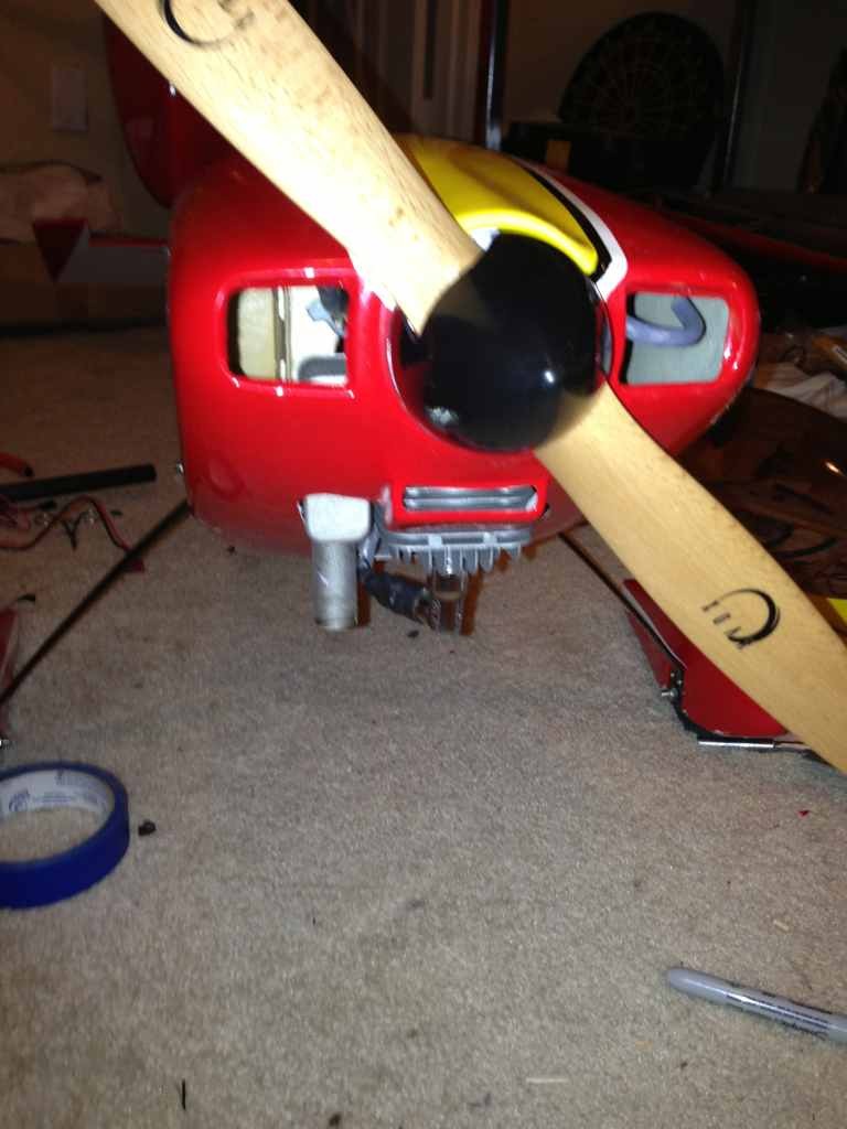

Well, should have left well enough alone...was trying to set myself up for success, and was putting a bowman ring into the DLE-20. Broke the DLE ring pulling it out, no biggie right? Well, I put the bowman ring in upside down... damn it... oh well, pull it out and turn it around. Nope! Broke that one too pulling it out.
Off to send Frank some more money...

Bummer...but directions? the dle piston is pinned, ring only goes in one way. also a bevel on the top side to catch some compression.
A ring expander is out there, but really to big for this small of a ring. two thumbs and just open enough to get it over, and try to keep it flat while expanding.

Thanks Rob... I learn the hard way sometimes! It actually goes "in" both ways... but I had the pin bevels upside down. Stuff happens! Started building my SHP to cheer me up! :)

Maybe the 20 is a little different. On the dirt bikes I use to work on the pin was centered. The ring could go eitherway. A quick look at the dle55 ring and the pin is offset, so the ring can only go on one way. On the diesel engines I use to rebuild all the rings were free floating, no pins.

Yep, it's offset like the 55, that's what bit me. :(

Noob to gas question: What does the Bowman ring gain you on the DLE? Is it better compression? Dad and I were trying to understand how a different ring could improve performance.
That is exactly what it does... It's made from a different metal the DLE ring, and seals better against the piston, increasing compression. While I know the motor was working, (just not perfectly) when you sold it to me, I really wanted to try and set it up for the best chance of success!
