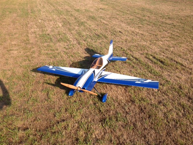

Ok guys, we maidened the 70 Velox today and it was kind of a good news, bad news thing.
Setup is with a Graupner MZ24 radio, Hobbywing 100A Platinum V3 ESC, Kingmax servos, 19x8 Xoar prop, and Hacker A50 14S V3 motor with the servos in the tail to balance it out instead of using the pull pull setup.
First the good news.
My 8 year old son Caleb did the maiden and he got it up in the air and after 3 clicks of down elevator, everything was flying perfect. We were pleased with the power, flew very neutral upright and needed only a tiny hint of elevator to keep it in the air inverted in both high speed and low speed maneuvers. Was very stable and we were all happy.
I put in the second battery and turned him loose on high rates and he put it to it. When it came down I checked the battery and we got almost exactly 6 min out of it leaving 20% in a 6s 5000. I noticed the motor was pretty hot so I let it cool for a minute and then we put in the third battery.
Well, about 2 min into the third flight we started seeing smoke and he started loosing power. Thankfully, he was doing some slow maneuvers close to the ground because by the time he got it down he almost had no power at all. I ran over to the plane wondering if a battery had gone crazy or something, but it was the motor that was letting out the "magic smoke". The prop nut was so hot that it would burn you instantly on contact.
