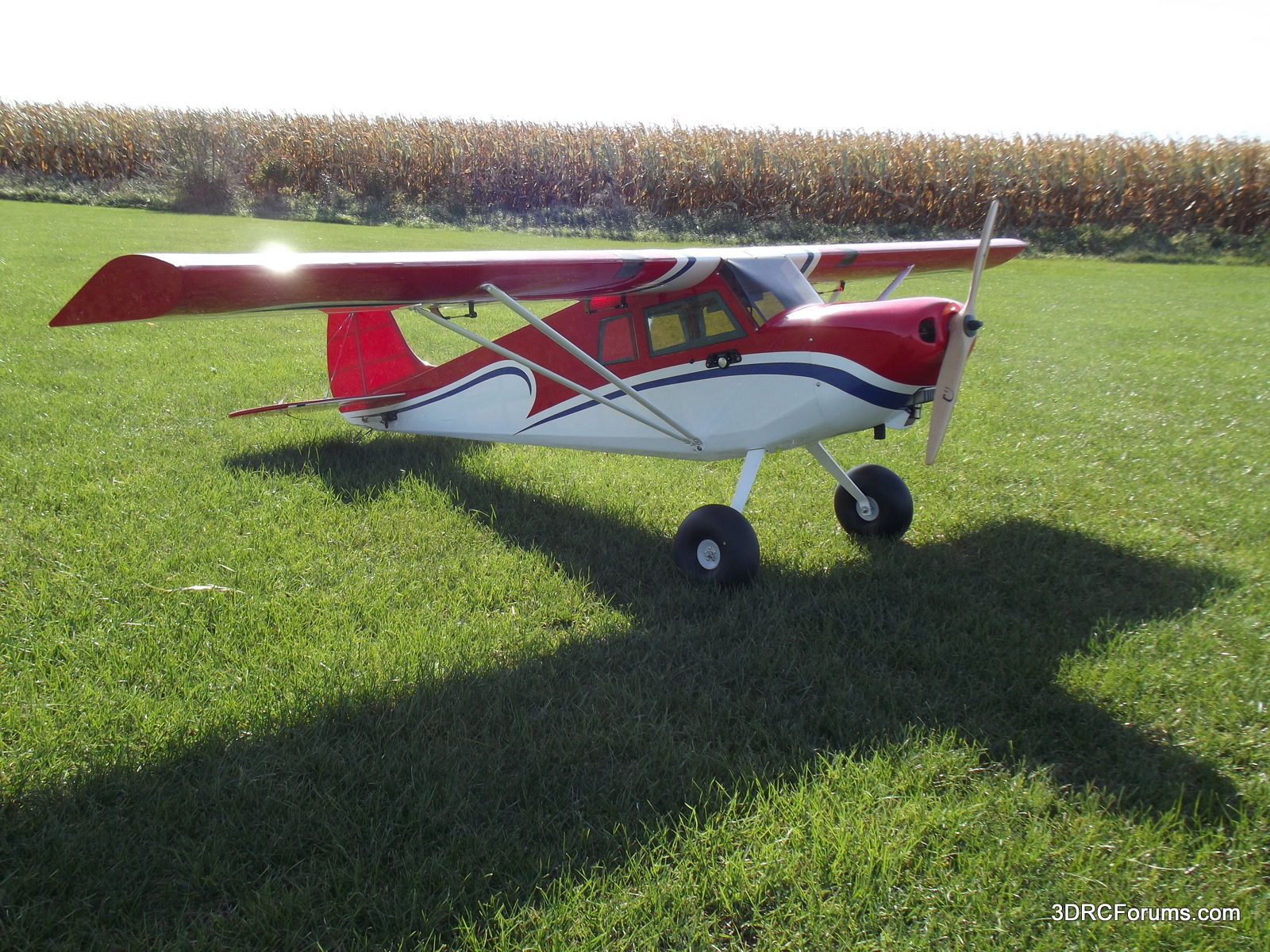

Bigfoot is 3DHobbyShop's first high-performance high-wing aircraft. The amazing maneuvers performed by Alaskan and Canadian bush pilots, and the rugged, light, maneuverable aircraft they fly, are the inspiration for this amazing model aircraft. Bushplanes rely on light weight, large wings, high power, and big flaps to do these amazing things. These extreme capabilities are very similar to 3D flight, and so Bigfoot fits right in to the 3DHobbyShop lineup of extremely high-performance aircraft.
We recently got to build and fly one, and here is our review!

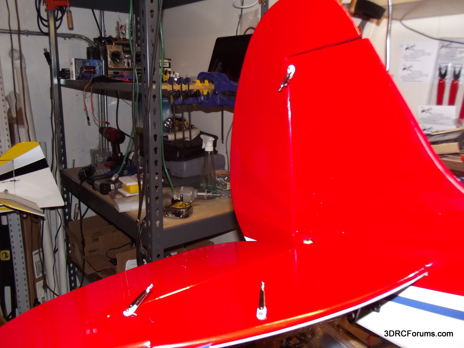

Per the online instruction manual, we started by removing the covering and installing the tail surfaces. No big surprises here. The tail wires are something new for a 3DHS airframe, and we required time and patience to get this right. There are wires for the top of the stabs and wires for the bottom of the stabs...they are of different lengths, and care must be taken to assure the correct wire is in the correct location.

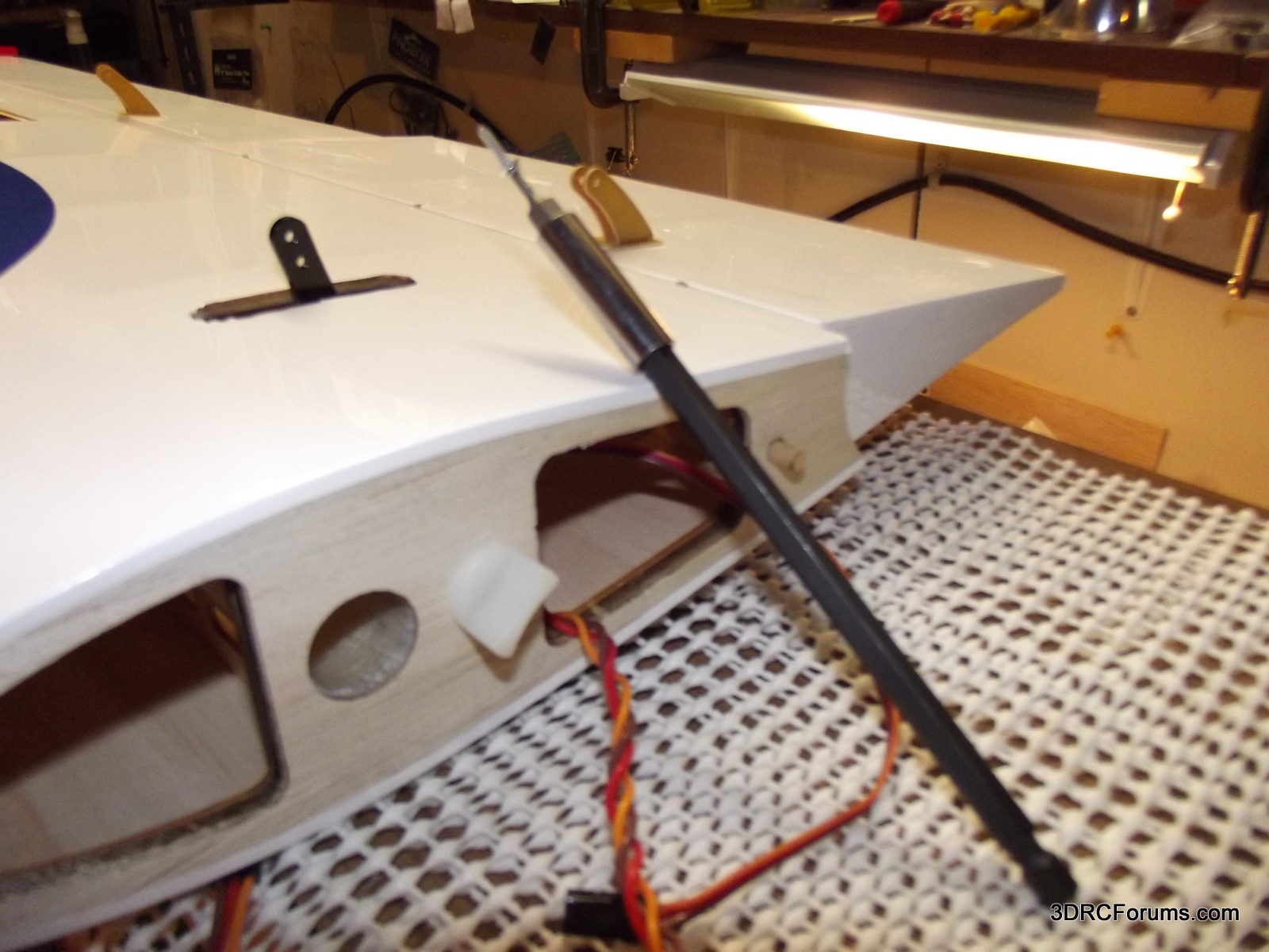

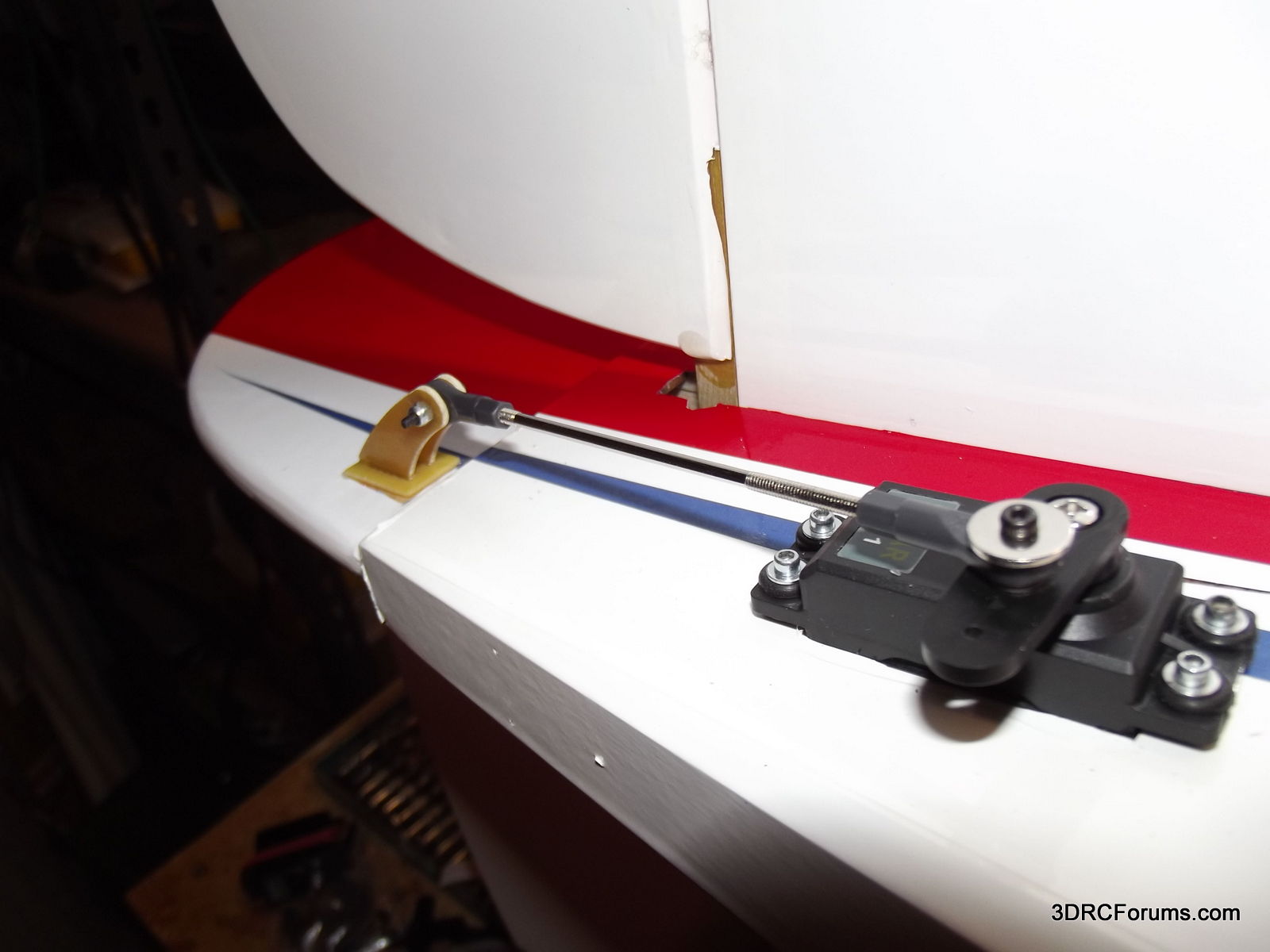

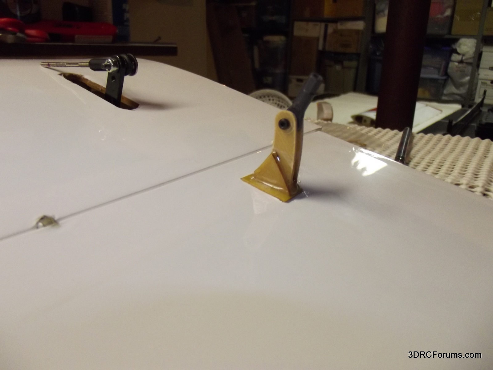

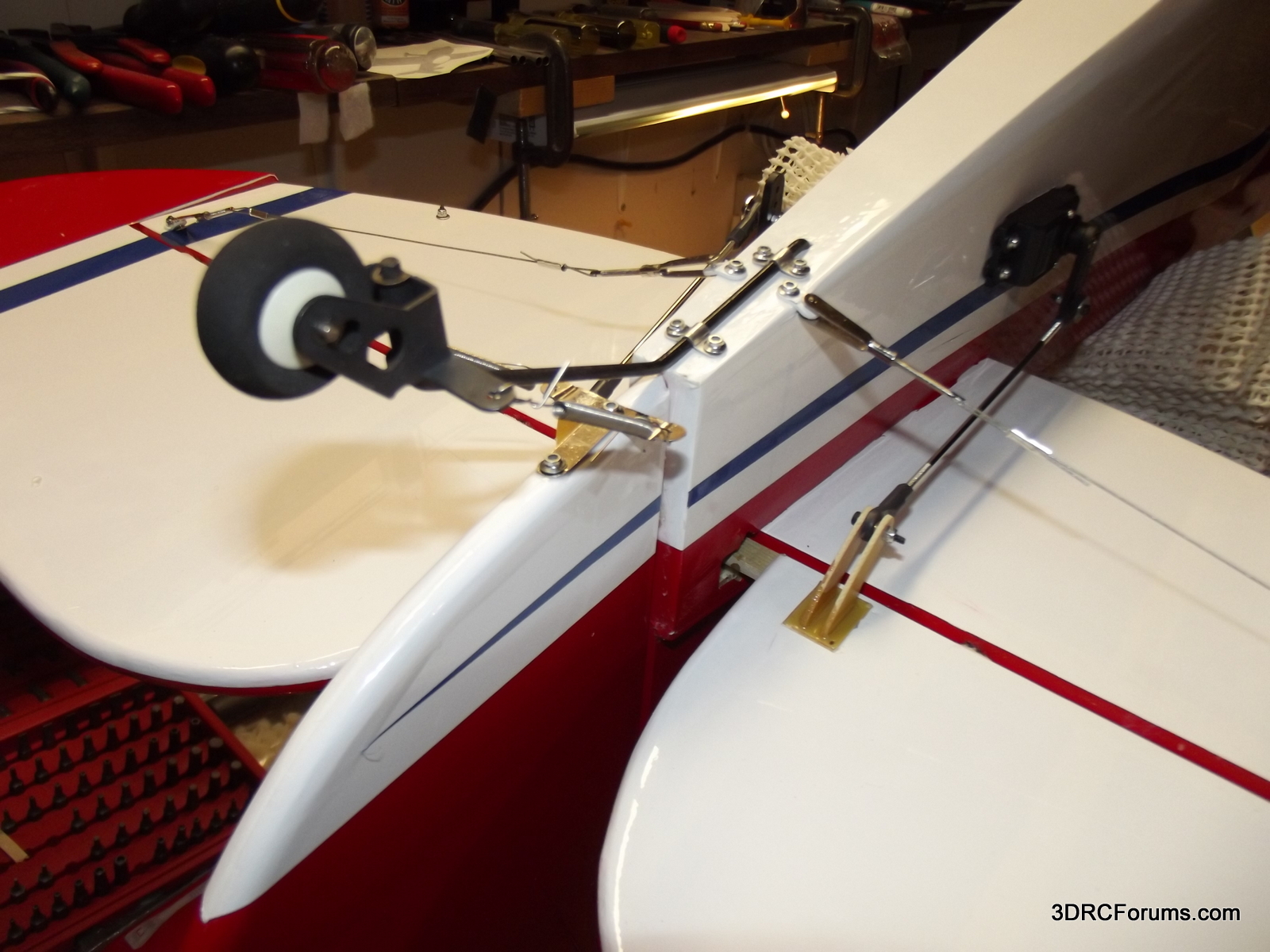

The next step was installing the aileron control horns and flap control horns in the wings. Installation of the aileron control horns was simple. The flap control horns were problematic. Based on other build logs and input from 3DHS, we were aware that installing the flap control horns in the manner specified in the installation manual would lead to problems such as burned out servos. This was determined to be a result of bad geometry of the flap control horns. We decided the best approach given the materials that we had was to reverse the orientation of the flap control horns. Here are a few pictures which should help clarify:
![DSCF1039.JPG DSCF1039.JPG](https://www.giantscalenews.com/data/attachments/68/68254-23a865c46254c9d13138f0ed551c8496.jpg)
We were disappointed to learn that even with the well known issues with the flap control horns, the online manual was not updated to mention this issue.

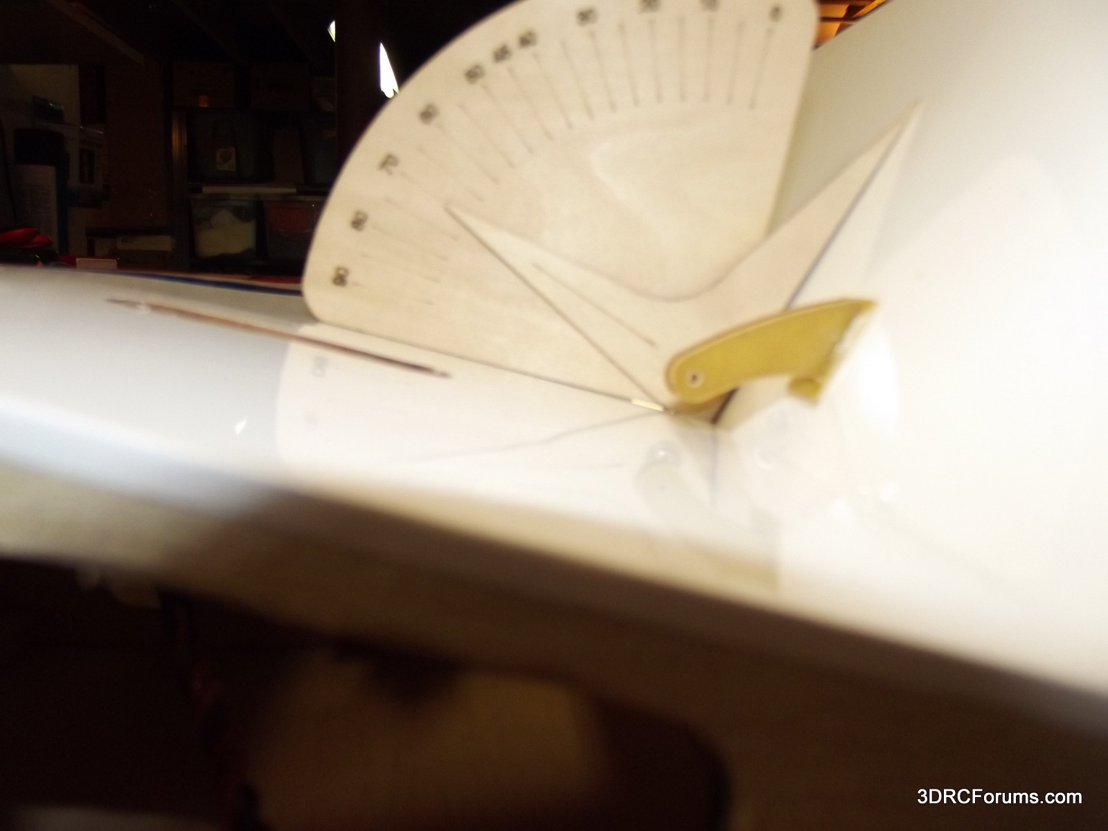

Another issue identified in the manual is the amount of deflection recommended for the flaps. The manual calls for 85 degrees of travel in one section and 75 degrees in a later section. Consensus from other builders and from 3DHS was that 70-75 degrees of travel is the correct amount. We feel the manual should have been updated regarding this issue.

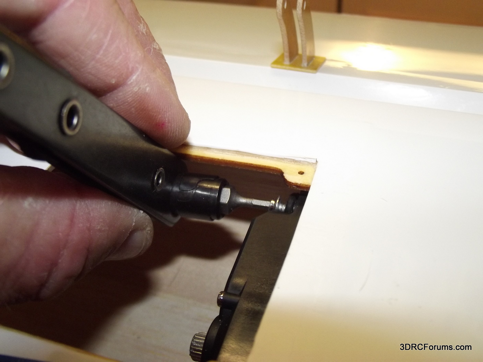

Once the control horns were glued in and the ailerons and flaps were hinged, it was time to tackle the installation of the aileron and flap servos. We installed the flap servos without any problems; the aileron servos were more of a challenge. The reason for this was simple geometry - it was very hard to reach the servo screw holes that were closer to the top side of the wing (those furthest away from the panel opening in the bottom of the wing). If we had used the standard phillips head screws that were provided with the servos, this might have proved a nearly impossible task without a special screw driver. As it was, third party hex head servo screws were used to attach the servos. A nut driver with a hex head attachment was used to secure the servo screws. We found this to be a tedious process but our patience was rewarded with a very clean looking wing.

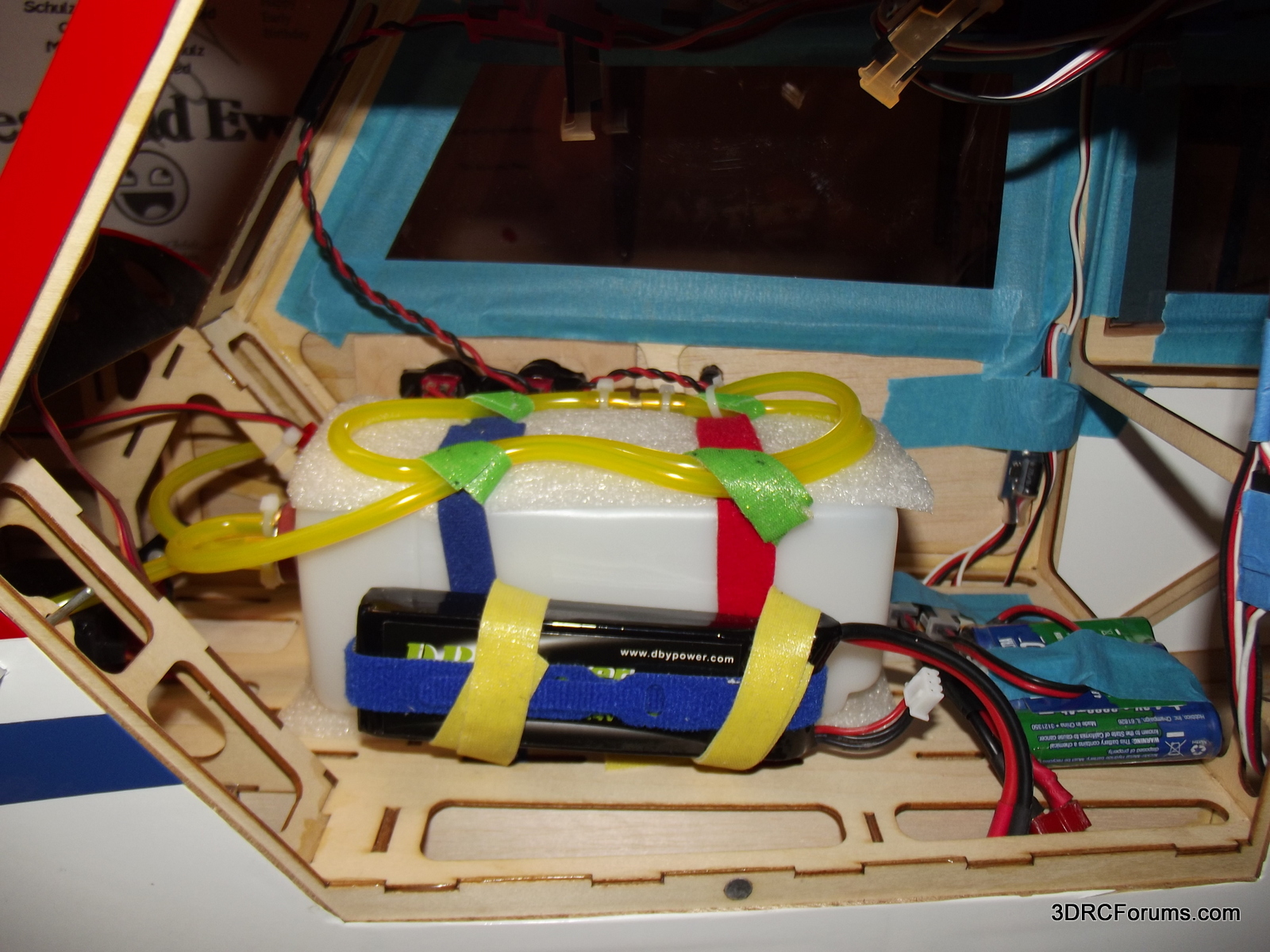

The engine and fuel tank installation was quite simple...there is plenty of room up front and inside the cockpit for all the components. We decided to use the stock fuel tank and plumb it with a three line fuel system.

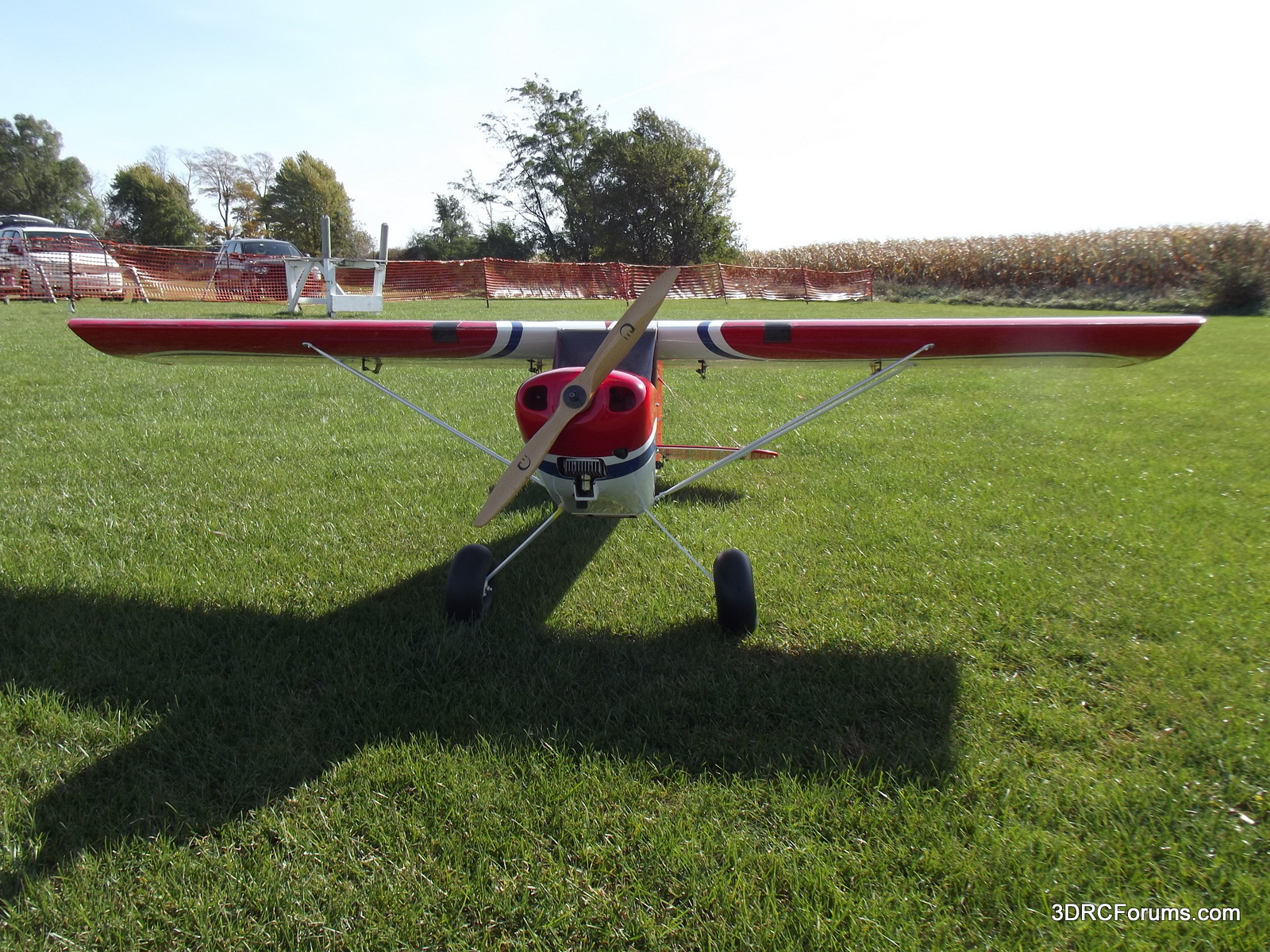

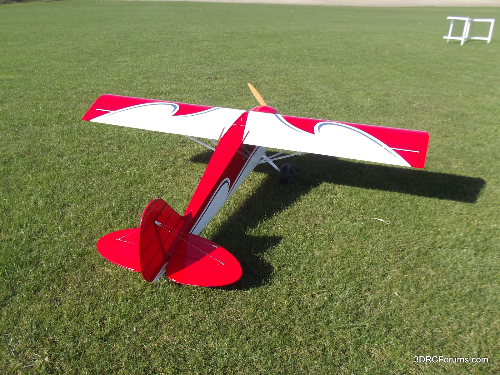

At the field, everything attached; ready for the maiden flight!

The 3DHS Bigfoot is an exciting new airplane for 3D pilots. However, it is not as forgiving as previous airframes offered by 3DHS. The instruction manual clearly states this difference and encourages people to take a cautious approach to learning how to fly this airframe. Failure to heed this advice will likely result in unexpected behavior in the air and potentially wing stalls that require time and height to recover from. With the judicious use of flaps this airframe can fly low and slow just like the real bush planes. Short distance take offs and landings will be real crowd pleasers. Full on 3D maneuvers such as hovers and rolling harriers are also possible with this airframe, making it a unique combination airframe.
Highlights:
* Short take offs and landings
* Slow speed flying with the use of flaps
* The red and black schemes are both real crowd pleasers
Low points:
* Documented approach for installation of flap control horns will cause problems
* Locating blind nut locations for wing struts on fuselage was very difficult
* Stabilizer wire mounting tabs did not have correct bend angles
* Online instruction manual has not been updated to cover known issues/mistakes

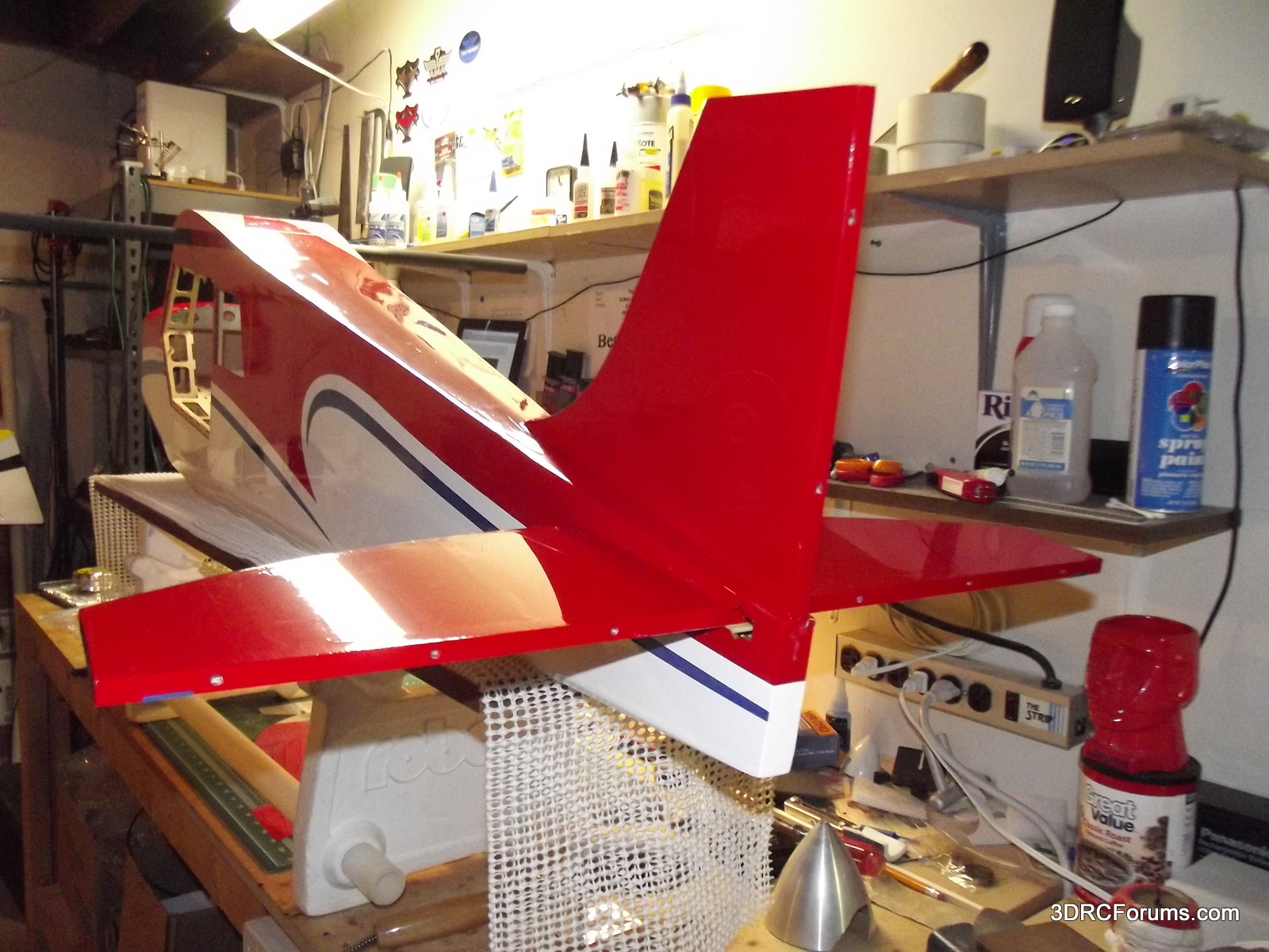

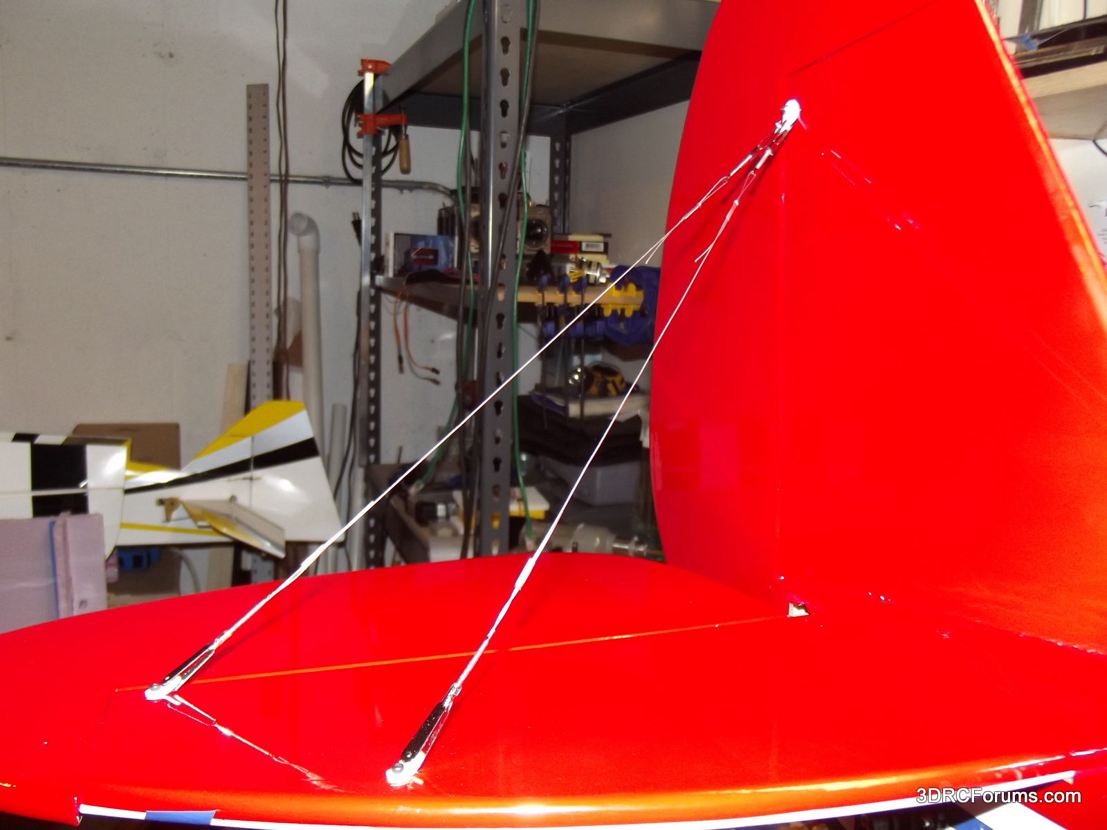

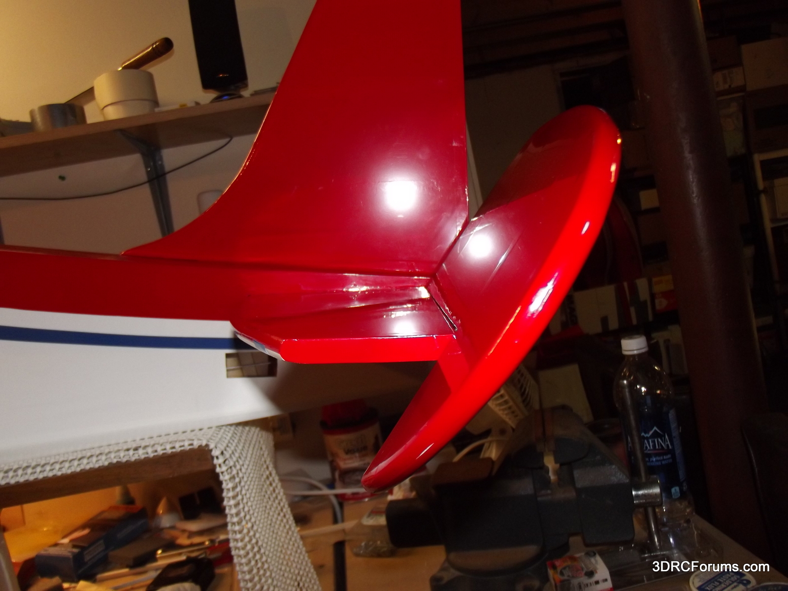

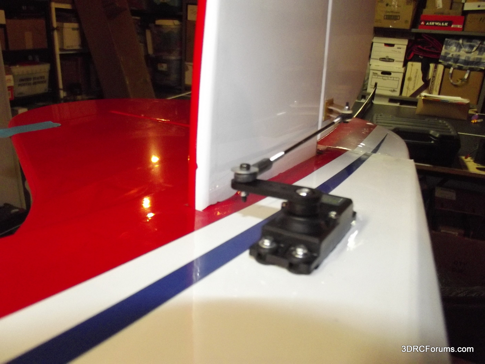

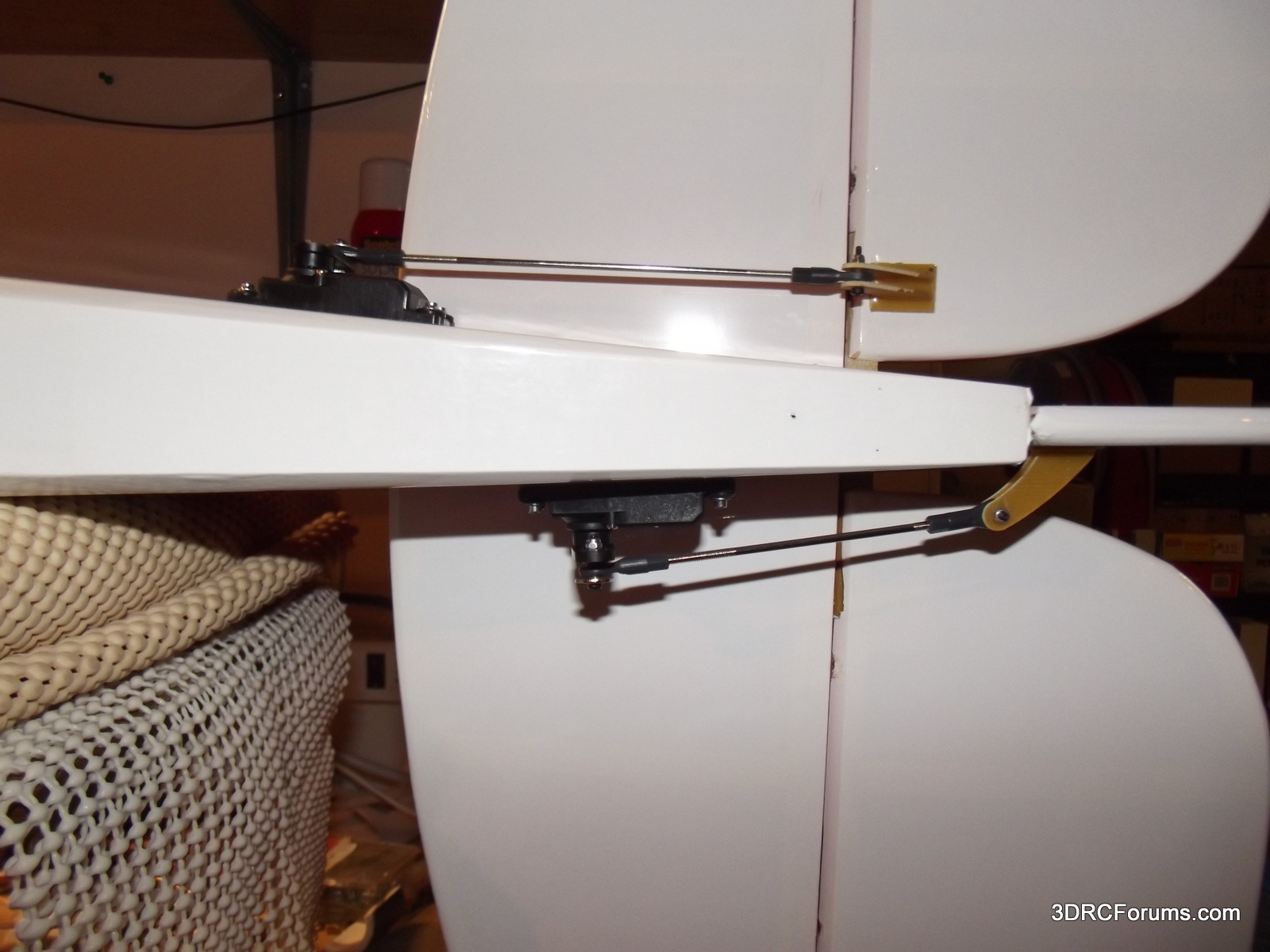

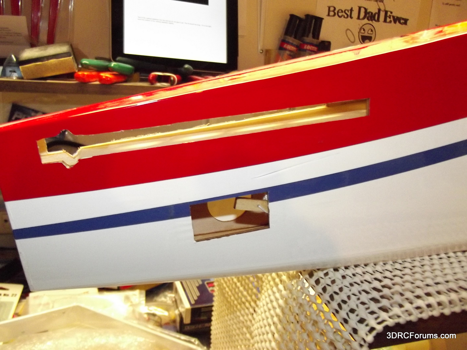

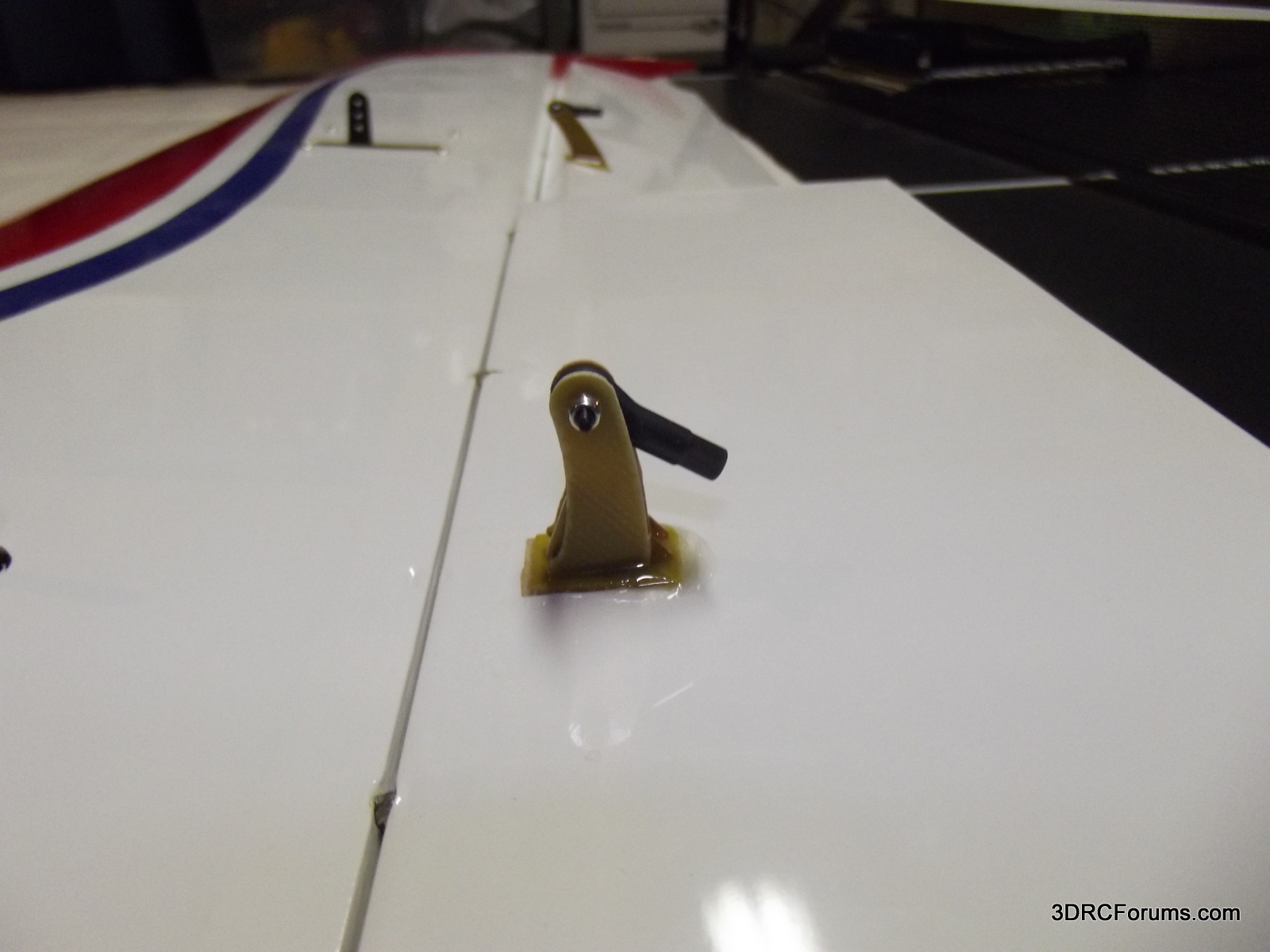

![DSCF1040.JPG DSCF1040.JPG](https://www.giantscalenews.com/data/attachments/68/68255-379bbcdf055002baf3ec8749efaaf517.jpg)

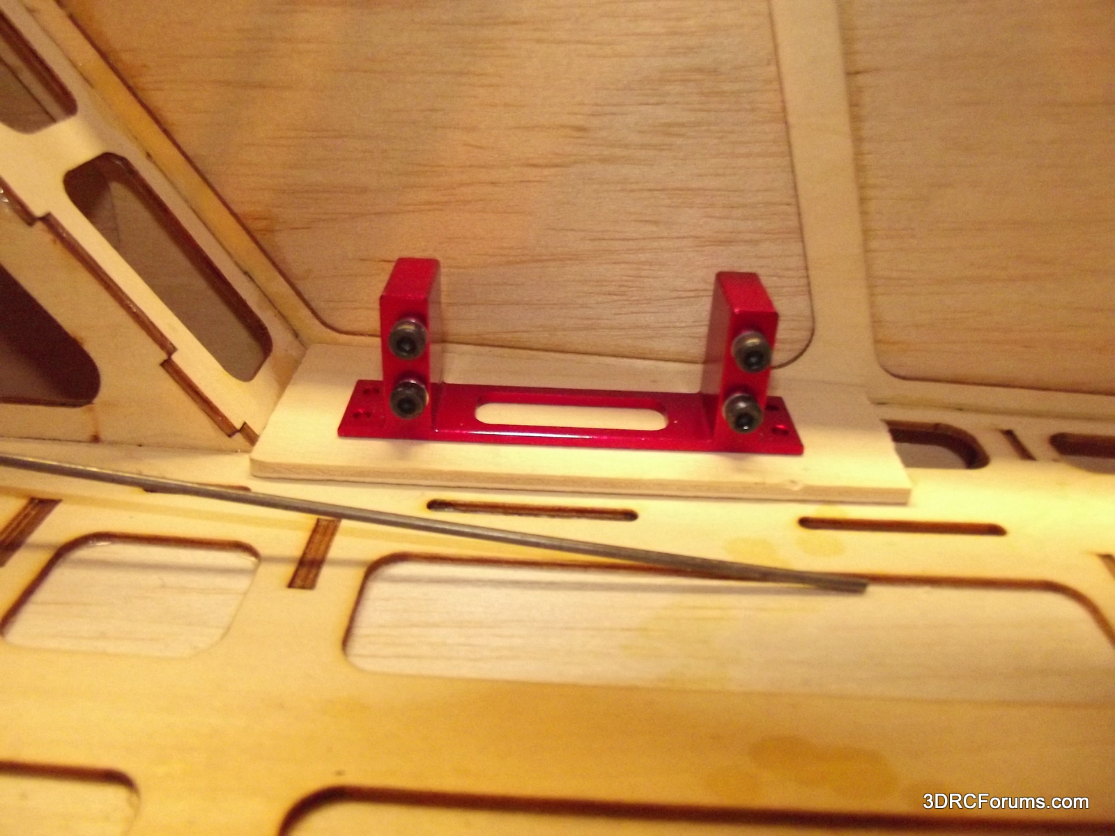

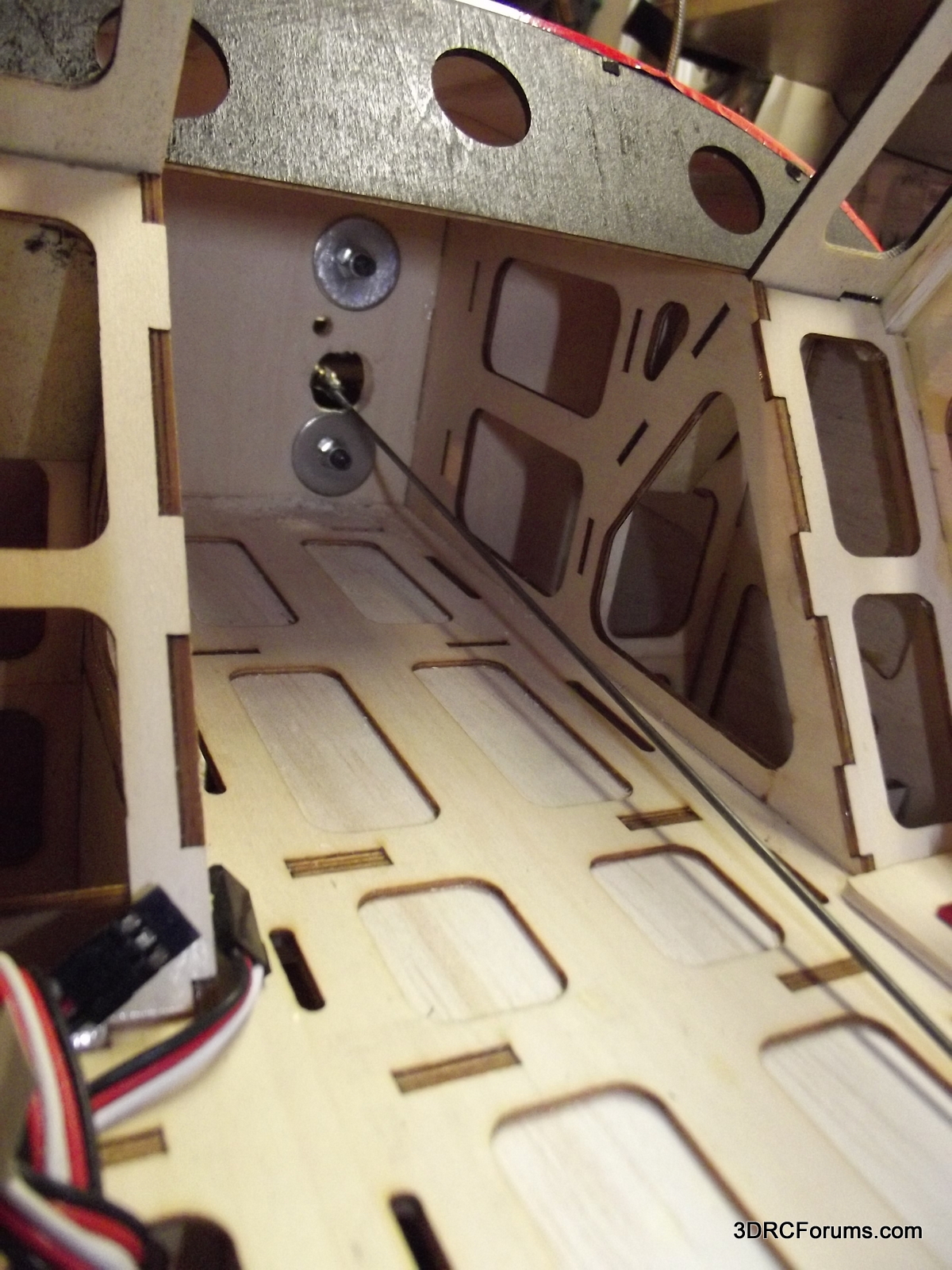

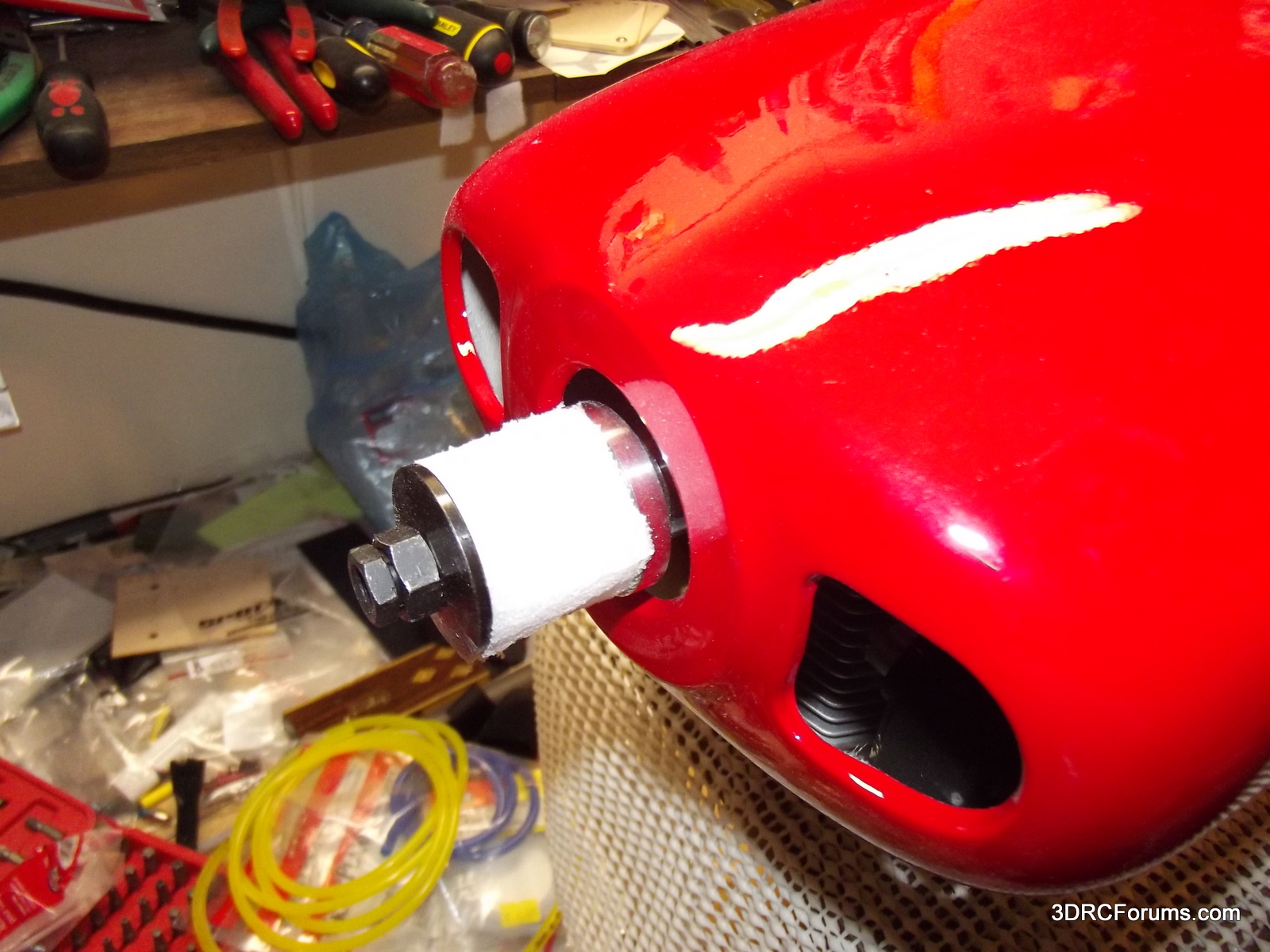

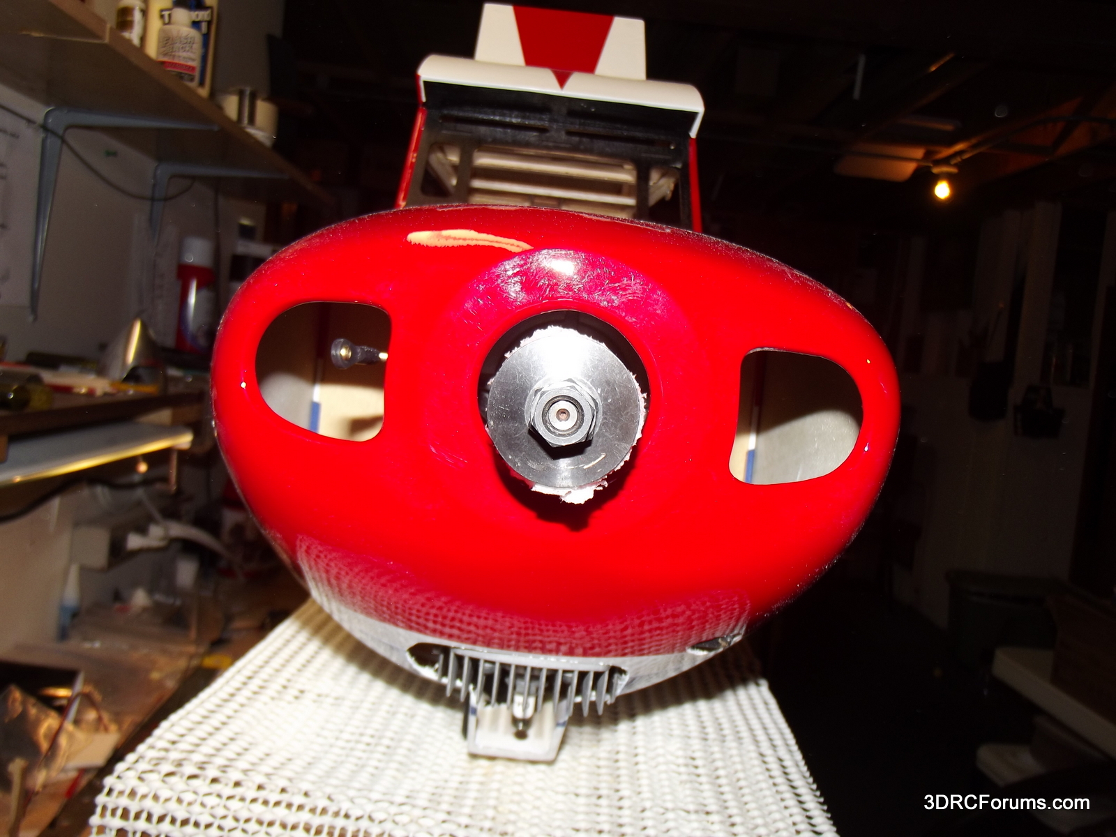

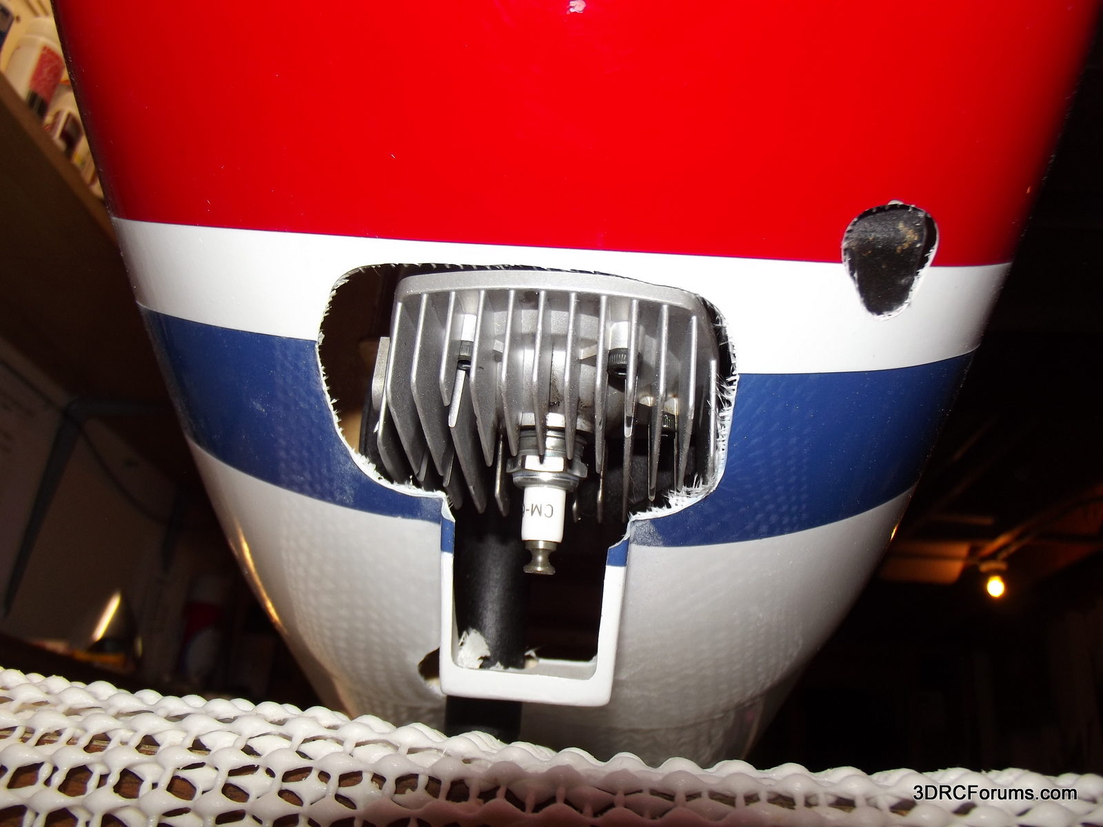

![DSCF1082.JPG DSCF1082.JPG](https://www.giantscalenews.com/data/attachments/68/68262-f781d7b7faa4d0b366567895ff4b6a7b.jpg)
![DSCF1083.JPG DSCF1083.JPG](https://www.giantscalenews.com/data/attachments/68/68263-1cfdc4999c50dc2c49812bc0d5d0fa58.jpg)
![DSCF1099.JPG DSCF1099.JPG](https://www.giantscalenews.com/data/attachments/68/68268-bb2e72983397bc90f7c0760942781ca7.jpg)
Cutting the cowl required patience (as always) but resulted in a nice looking front end.
![DSCF1087.JPG DSCF1087.JPG](https://www.giantscalenews.com/data/attachments/68/68264-f441b3cae1ee213a0ef17c2e3788cfa6.jpg)
![DSCF1088.JPG DSCF1088.JPG](https://www.giantscalenews.com/data/attachments/68/68265-5b1da3342360e69f4e0033426d426fc6.jpg)
![DSCF1089.JPG DSCF1089.JPG](https://www.giantscalenews.com/data/attachments/68/68266-a94c42bd153f11f0cb7f794467e5d18d.jpg)
![DSCF1092.JPG DSCF1092.JPG](https://www.giantscalenews.com/data/attachments/68/68267-199353870bfe97bbc72e104cc7eb448b.jpg)
