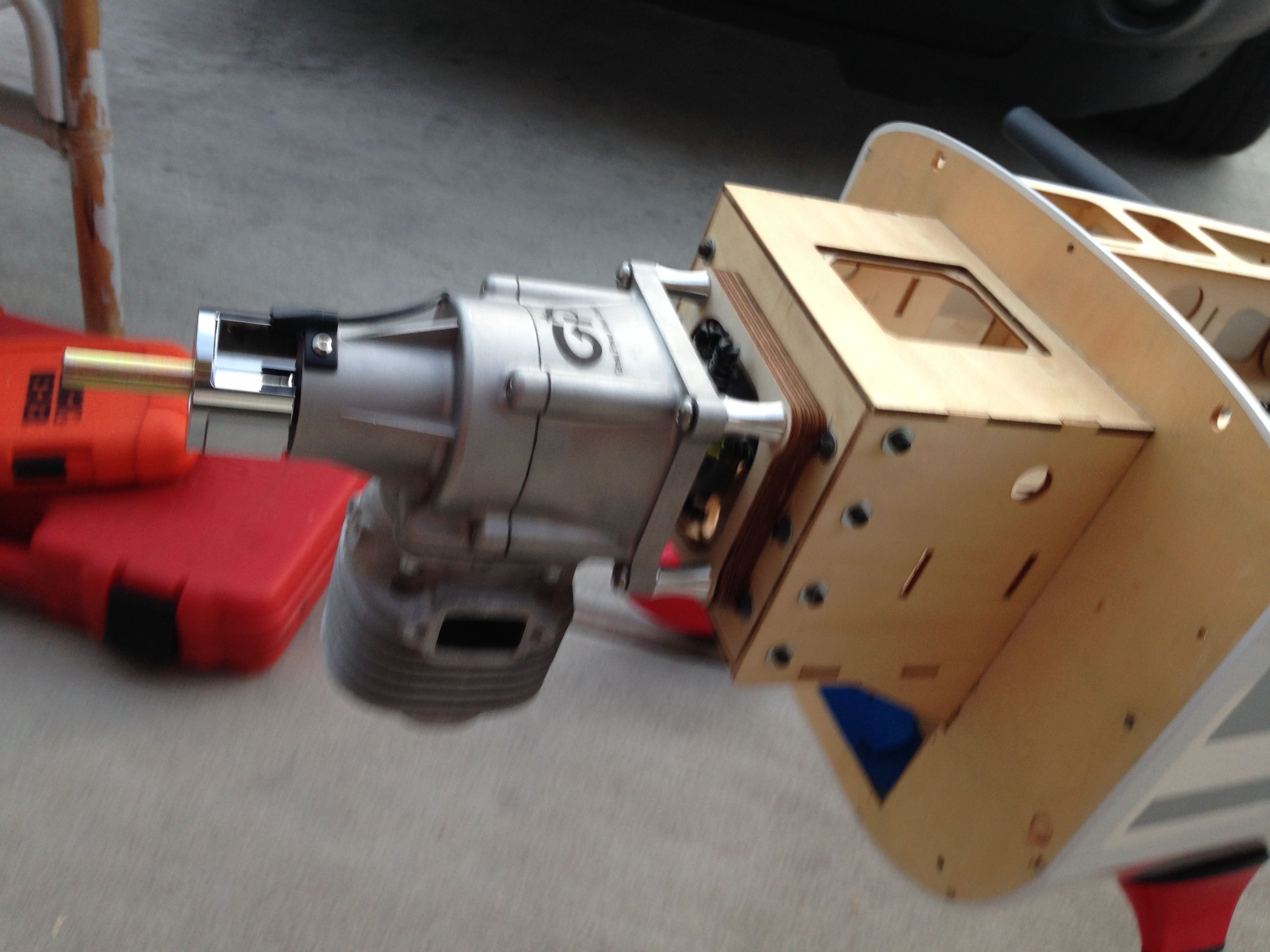

Got a question for those of you who have built one of these.
I got my edge yesterday and when I was going thru the bag of components there was a wooded spacer in there that looks like the cutout for a DA60 carb. Is that what it's for? Just cutting the hole in the firewall.
Not exactly positive, but I believe that spacer is for mounting an engine. [MENTION=2668]Yowzilla[/MENTION] mounted his GP61 with that and some standoffs, as did I until I got the correct length standoffs.
There should be a flat cut out/drill template for the DA60 in the kit.
Yowzilla
Yea I used the included wood spacer with the Edge kit and the spacers from the GP-61, but did not fly it this way. IMG_4110.jpg
The ticket is with the custom standoffs from Craig. If you have the GP-61. If you have the DA I have an unused Blazing star stand off for sale..
Av8r RC
Gyro,
Yeah I saw the drill template for the DA50/60, but the cutouts there will not work for the 60.
Yowzilla,
I already have a Blazing Star mount for the DA60. Thanks though. :)
What do you all think about using that spacer on the inside of the firewall. Might give a little extra surface area on that backside instead of just some washers. Although I'm a little worried it might cause more harm than good because of longer bolts needed.
