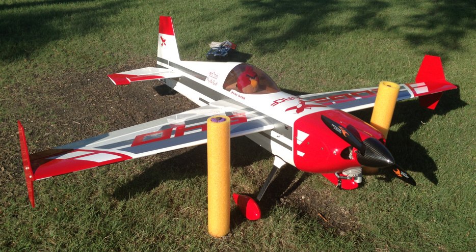

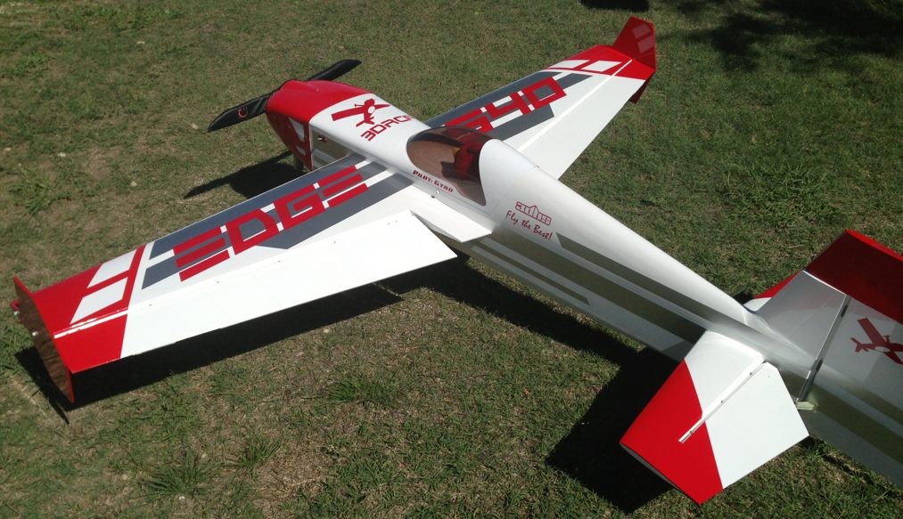

Got some flying time in this past weekend... Tried her with the SFG installed.
WHOA!
Much better slow speed performance! It was almost "easy" to harrier in the weeds around my field. Definitely like her much better with them on. No sacrifice in roll rate or precision that I could notice either. So this Edge is one of the best flying planes I've had control of. Really inspires confidence down low!
here are my notes after 2:09:00 of flight time:

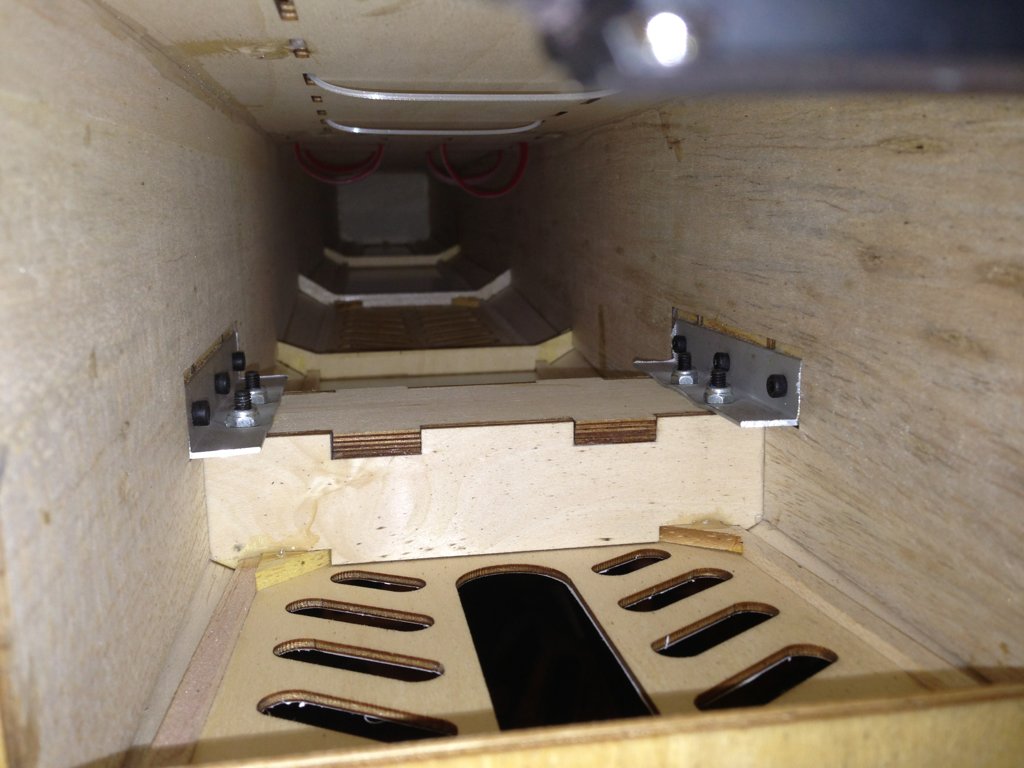

- Elevator hinges have a some slop. The glue in the airframe didn't come loose, but they move at the hinge line at least 1mm fore and aft. Only three hinges per side... Maybe a fourth would help?
- a few of the blind nuts inside the cowl came loose. Definitely hit those with extra ca or epoxy during the build to save yourself the headache of getting the bolt out when the nut spins freely.
- the factory cowl alignment relative to the motor is a little off (see pics with 4"
spinner during the build above). Going to a larger spinner hides this.
