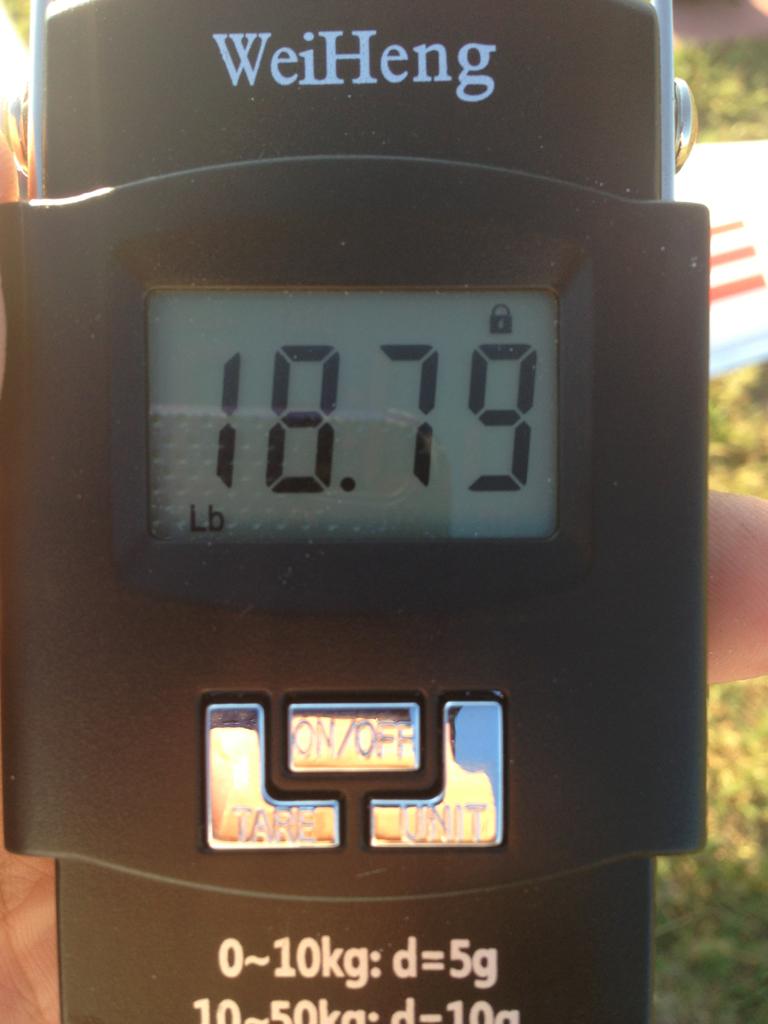

Weighed mine at the field today, fully loaded.
The weight includes about 2oz of rope, and 20 fluid ounces of fuel.

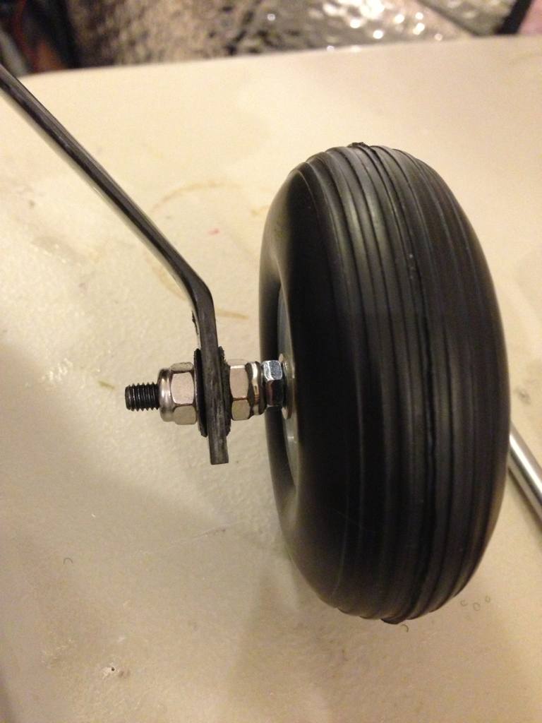

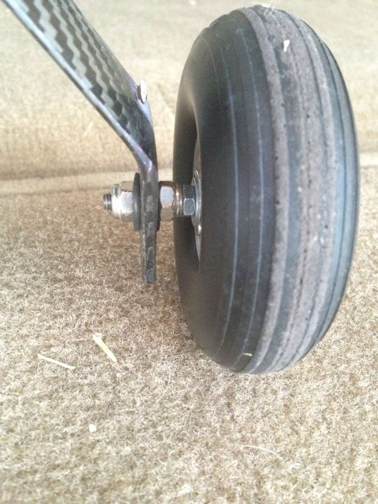

For the question about the new landing gear setup I did, I used a 10-32 cap head bolt, about 2" long, a flT washer on the cap head, a small regular nut on the wheel, a nylock nut, a neoprene washer on either side of the landing gear, and another nylock nut.
