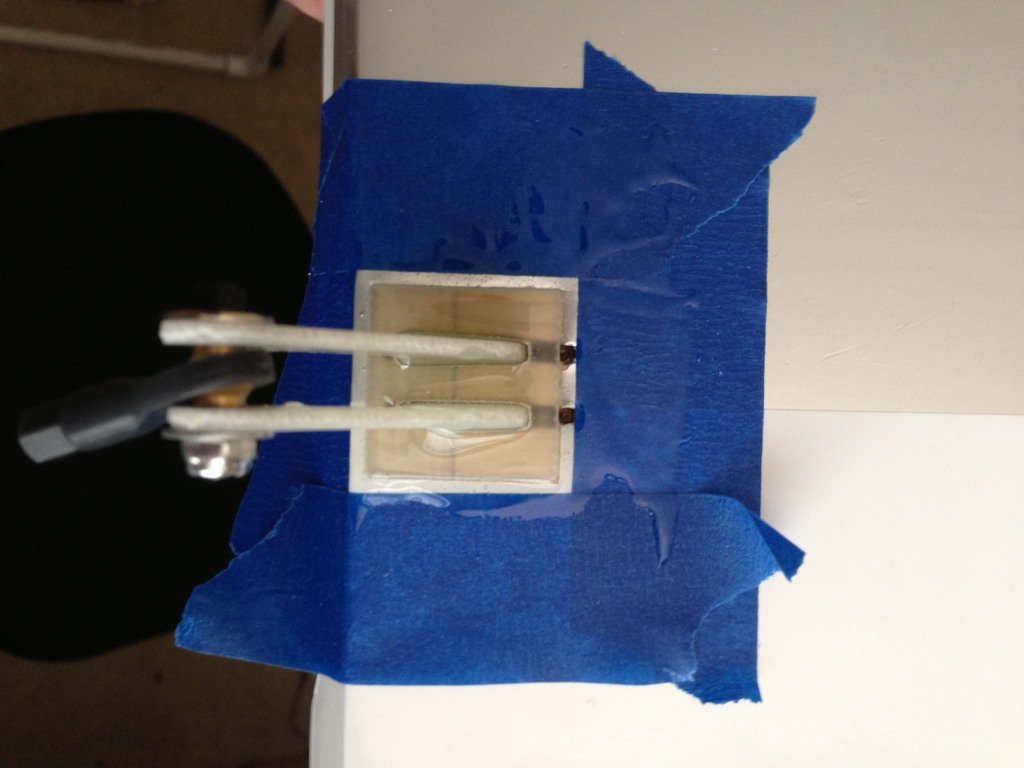

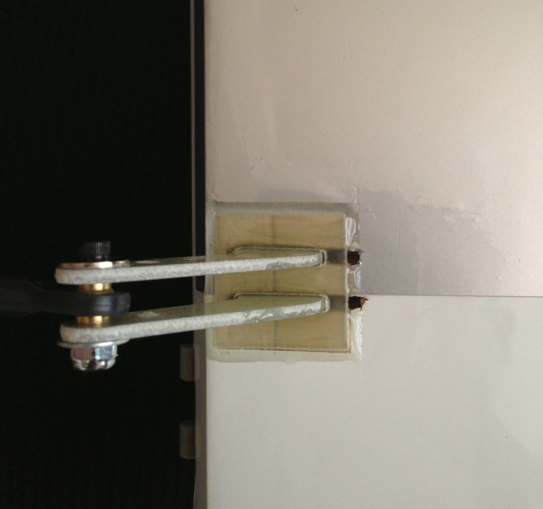

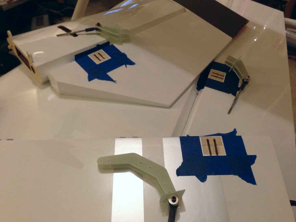

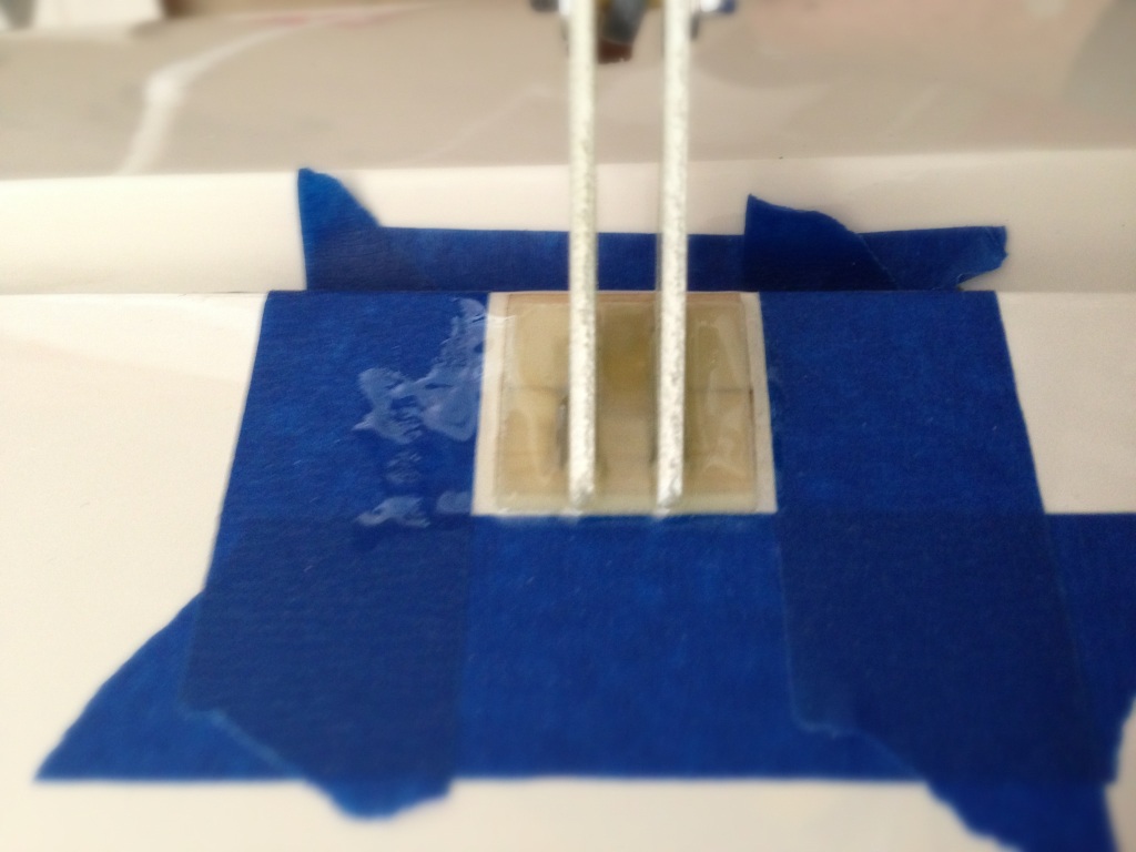

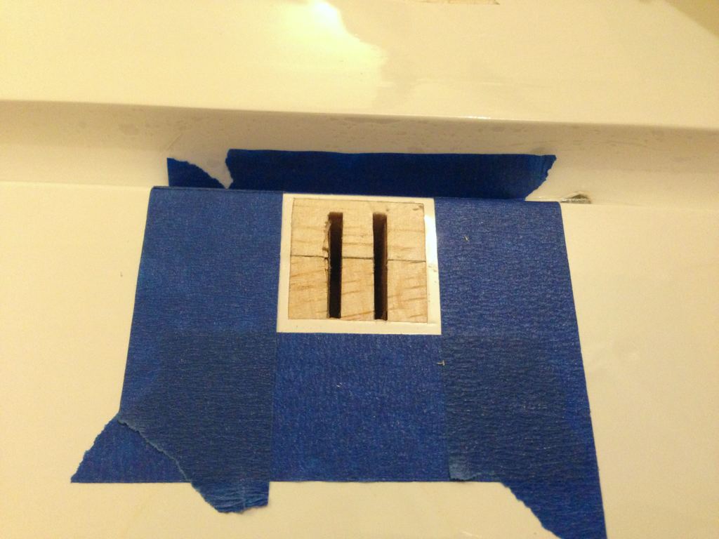

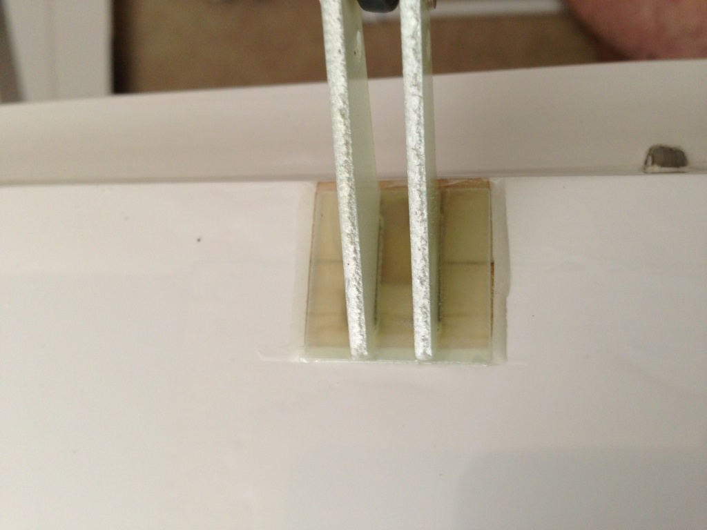

So for the control horns, I decided to use the method of masking off the area around the plate as seen in another build on the site. I think it made for a very nice appearance:

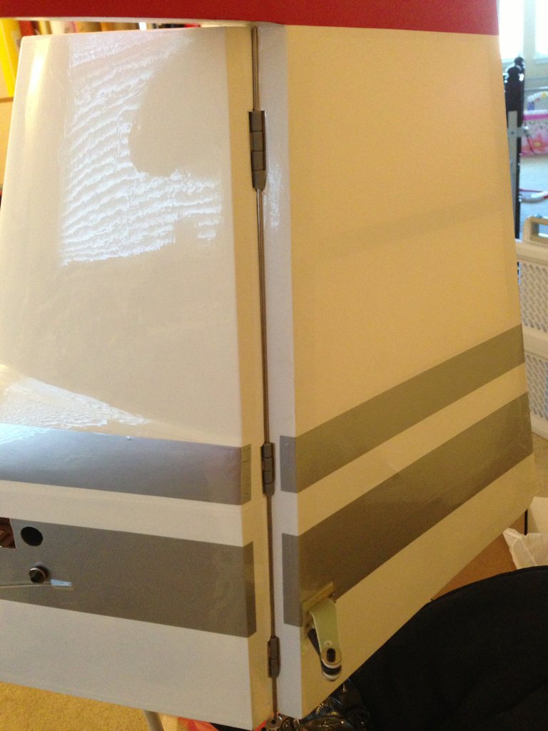

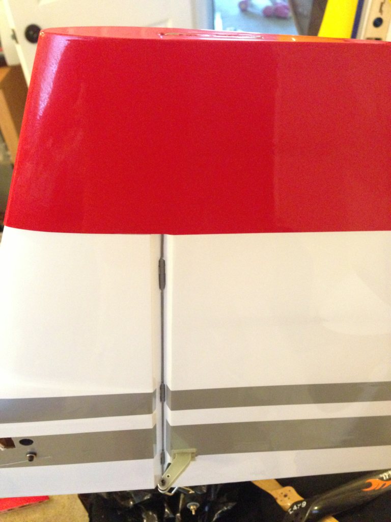

After freaking out because I couldn't find the rudder pin, and calling Noll for help, he calmly told me to look on the inside wall of the of the box... that it was taped there.
Doh!!!
So, I put the rudder hinge in, and it fit in nice and snug. This was not only the only hinge I had to install, but it only took a minute, and it essentially sealed itself. This was the easiest airplane I've EVER had to hinge!

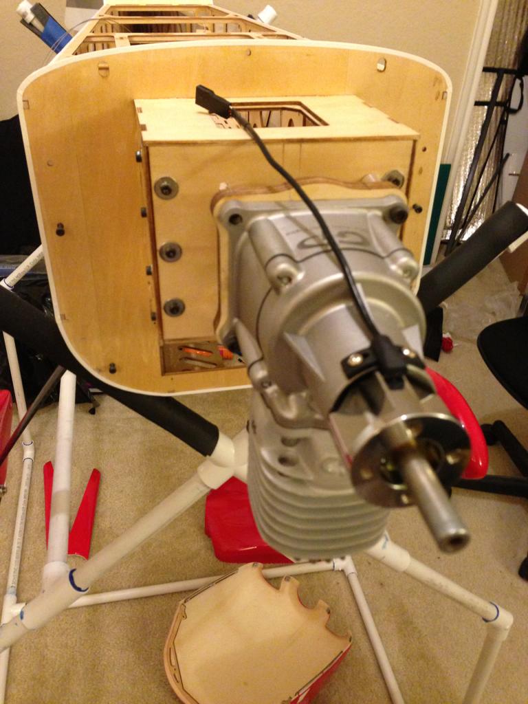

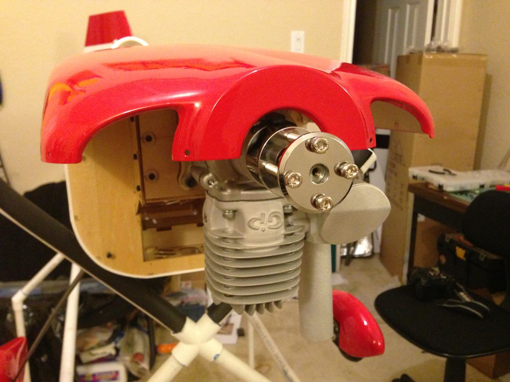

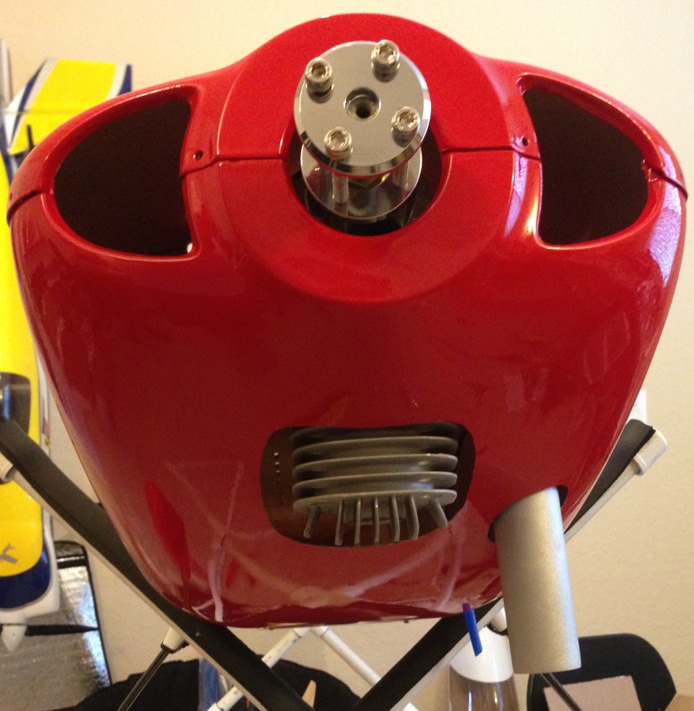

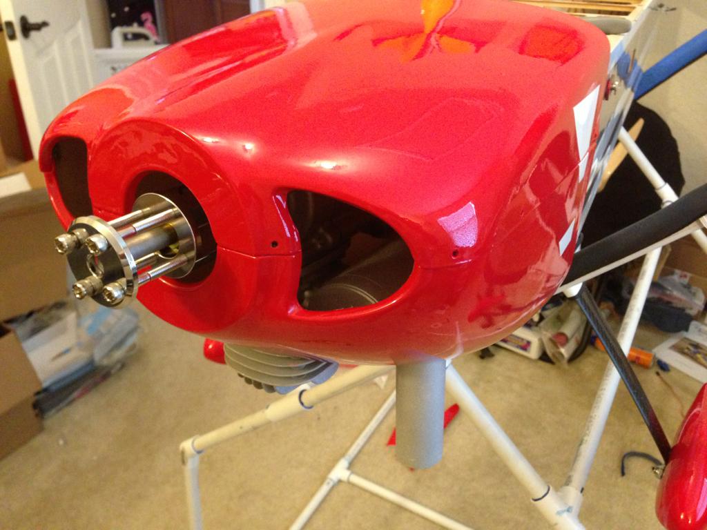

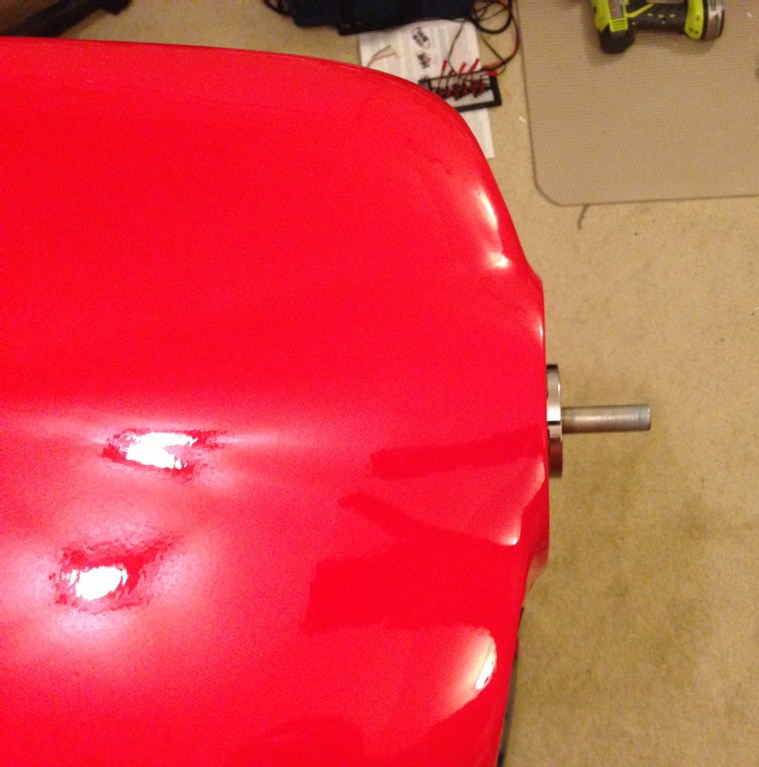

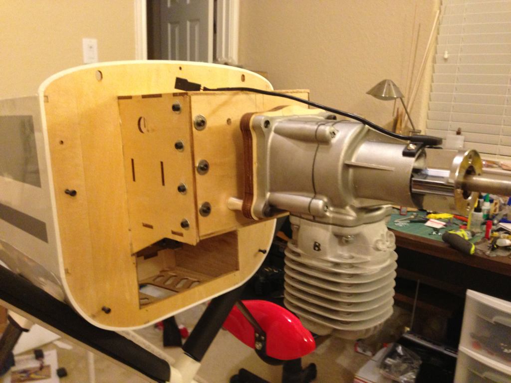

I dry fitted the engine, and I'm pretty happy with the spacing. I also LOVE the two piece cowl, and I'm excited to not have to hack up the bottom of the cowl to get it onto the plane.

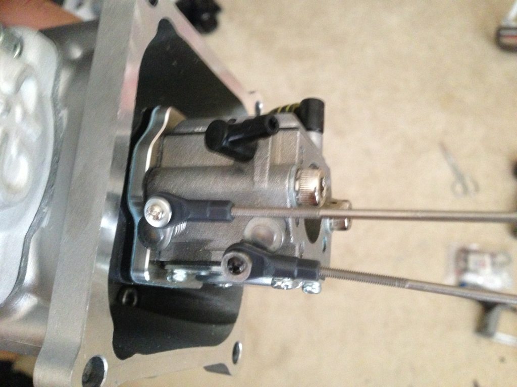

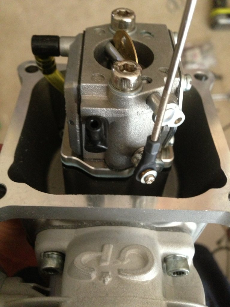

Next up was the engine. It has small arms for the throttle and choke, so the alignment will need to be perfect inside the fuze. Will likely need to use a choke servo, or a bell crank as depicted in the 3dhs manual.

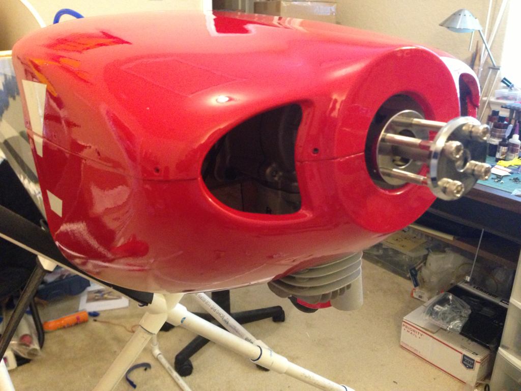

Also, got the main cutouts for the cylinder and exhaust done, and did a test fit on the cowls.

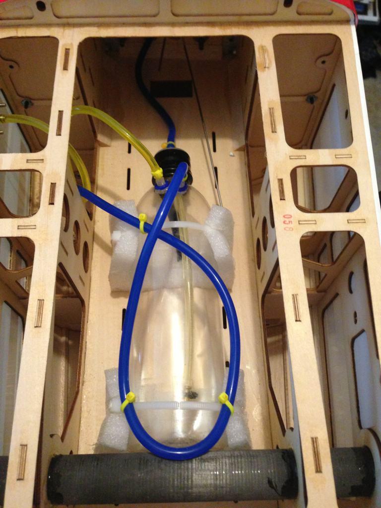

Also, since the motor is mounted, got the fuel plumbing done:

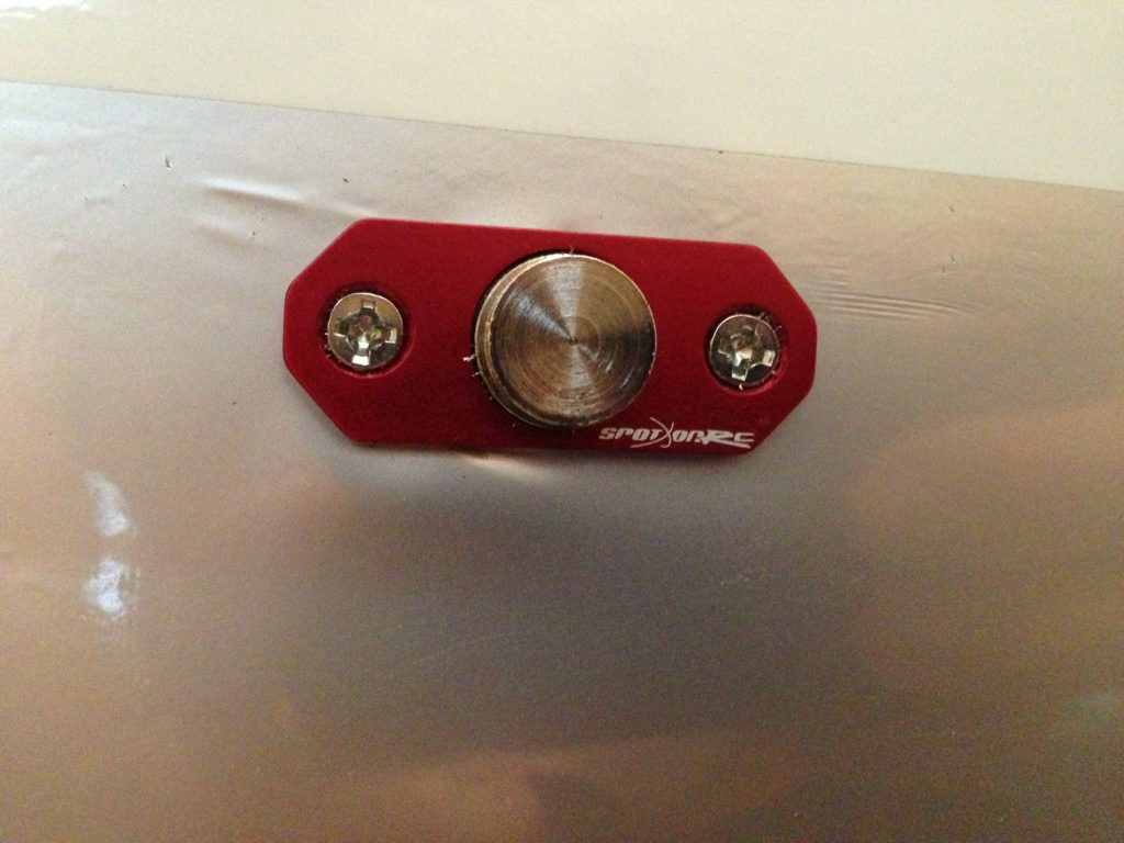

And finally, installed our first bit of bling from Aztech Aeromodels, the SpotOn RC magnetic fuel dot.
I can honestly say this is the easiest fuel dot to open and close that I've ever had. It slides out without much effort, but I'm confident the magnets can hold it in place during flight.
Also, the stopper is the perfect size for quick disconnection from the line.

looks good Gary....I would suggest you get a longer throttle arm...I doubt you are going to get the resolution you need with an arm that short.
TBM makes one; I used it on my DLE-30.
