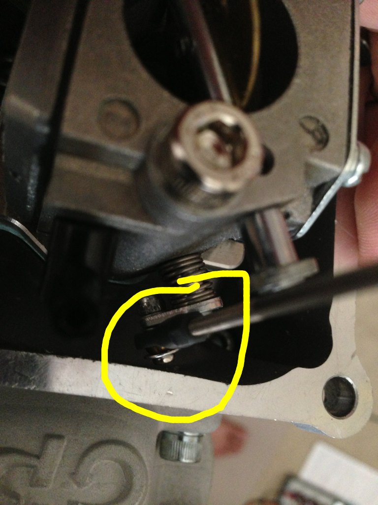

looks good Gary....I would suggest you get a longer throttle arm...I doubt you are going to get the resolution you need with an arm that short.
TBM makes one; I used it on my DLE-30.
The arm isn't removable like on a DLE.
The arm isn't removable like on a DLE.![]()
You have to pry it off and buy another:
http://store.aztechaeromodels.com/s...product&filter_name=arm&page=5&product_id=449
I just had to do the same thing on my Zenoah G38
:facepalm: even IF I could get it off, then issue is there is NO extra clearance inside the engine housing for a longer arm:
How about on the opposite side of the carb where the other end of the throttle rod extends?
Is it not possible to just use it the way it is?
It's definitely possible...you're just going to have a teeny tiny amount of throttle servo throw.
Inner hole of the servo arm and a well made throttle curve?
That sounds like a plan!
