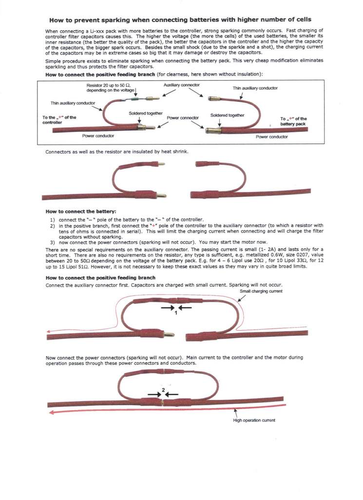

Last night I setup my new Motrolfly 4315-500 on my 58 edge for 6S power. I was getting 1250 watts and 60 amps, major improvement over my 4S setup.
Now for a new question, when I did connect the 6S batteries (2x 3S in series) I got a spark as I get with other 6 S packs but this time I want to eliminate it. I found the “anti-spark” connector how to and it notes that you must connect the negative side of the battery first then the “anti-spark” plug then the positive side of the battery, so what happens if you are using dean connectors?

It won't work with Dean's connectors.
what you CAN do, though is just get two of those anti spark things and put one on both the negative and positive...hook both of those up, ESC arms, and then plug in the Deans.
njswede
Or you could simply have two deans in parallel. On one of the deans you hook up a resistor in series with the positive lead.
thanks :(, you guys have created more work for me now :facepalm:
I think I will get mini deans and hook them in parallel as Swede noted... I should only need one resistor on the positive side unless you guys disagree?!?!
