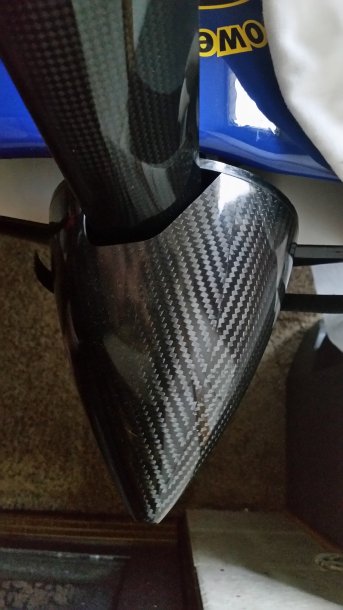

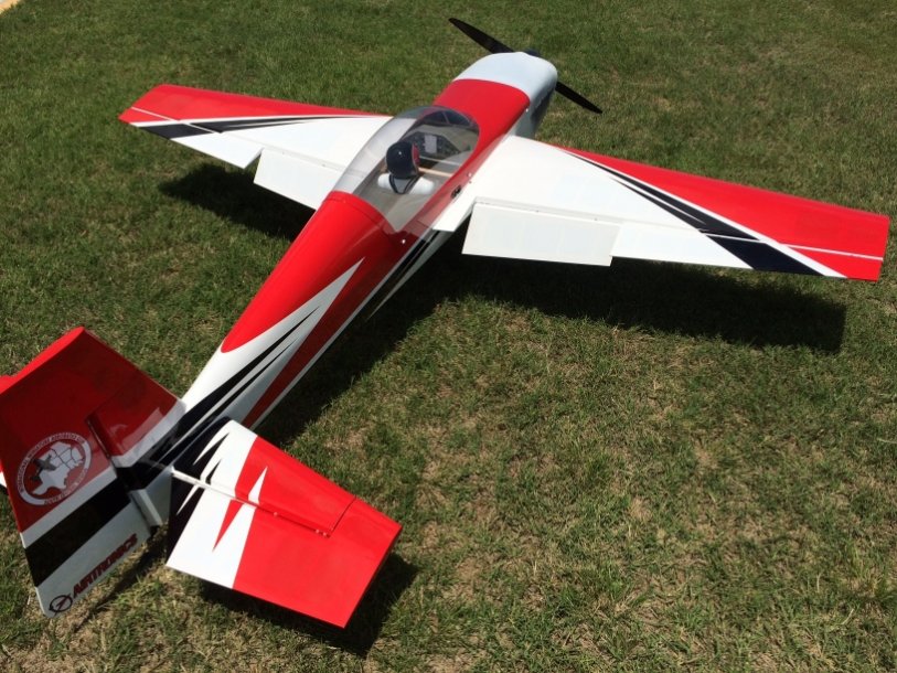

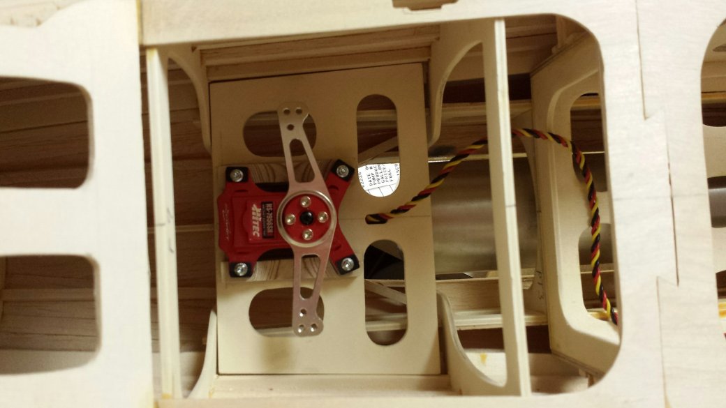

Here's some pics on the dle60 in my 89"
A lot less cutting
I hade the dle55 on a different plane and was going to use that on the 89 once i heard the twin was out I decided to use that so I sold the 55 and the airframe it was on and bought the 60 twin. The twin runs much smoother and idles so much better then the 55. The extra 1000 rpms the twin has really makes a difference even with the 1" bigger prop it still has noticeably more rpm. The extra weight penalty is definitely worth it, you can put the servo in the tail for push -pull. It's not necessary but it helps with placement of everything else. I'm also using smoke on mine so I'm on the heavier side and the previous owner of the plane had a q80 on it, I let him fly it and he said the power feels the same as the q80.
The twin also beats the da50 hands down on power. I haven't compared it to the da60 yet. Glenn has one in his 89 so we will be comparing soon.
I haven't had any issues with the motor , it seems a little sensitive on the needles but once in the sweet spot it's rips. The sound the twin makes is awesome and the smoke is better then the 55. Fitting the motor in the plane was easier then a single piston and there's no need for a choke linkage the carb sits right at the opening on the cowl so you can just stick a finger in and pull the choke lever.
Next time at the field I will get an AUW of mine and of Glenn's they are setup identical except for the motors.
