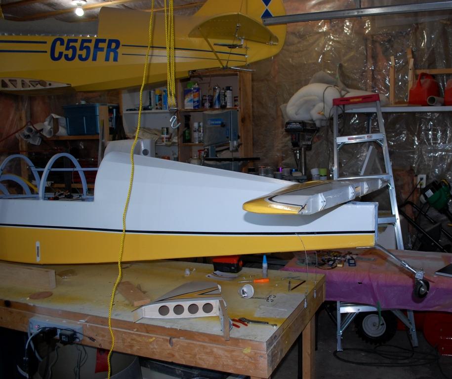

Here is my setup, but not pleased the track rod is a bit small and bends making the moving part a bit touchy, so I'm off to see if I can get a bigger setup, dam I miss those foamies LOL

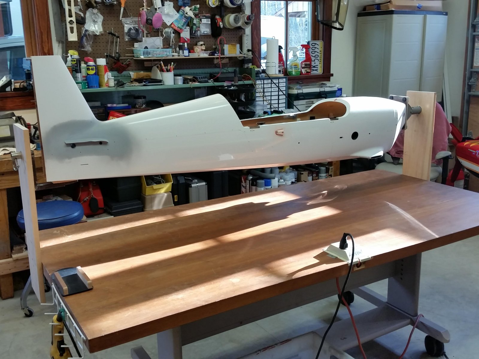

I'm thinking of a cradle like support, mounted to the end of my table, that I can rest the prop and spinner in.....which would allow me to grab the tailwheel and roll the fuse over, then slide a support box under the structure (canopy removed, of course).

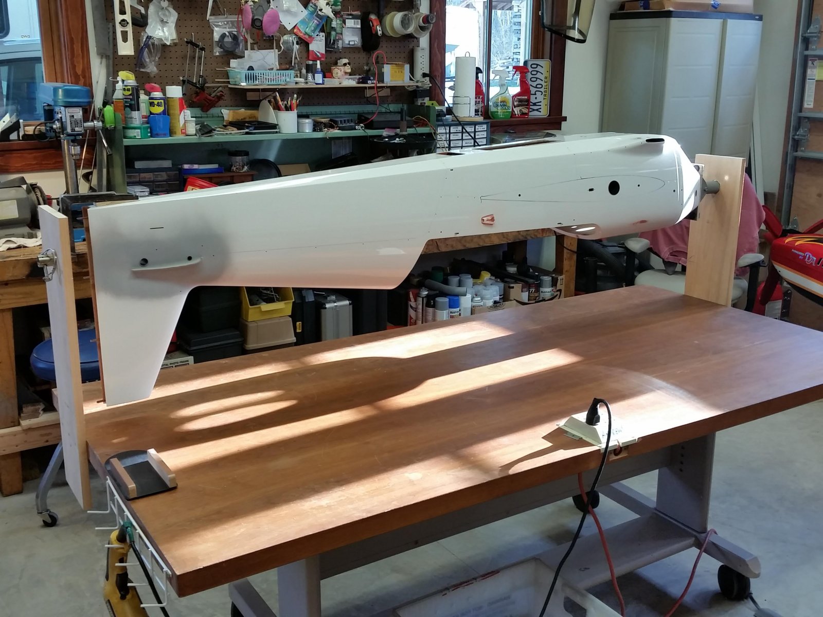

I built this rotating spit for the Krill fuse.....but it only works with the engine and rudder removed.

that looks awesome, should work great, I need you to work in my shop for a few weeks, then I would have a clean shop also LOL

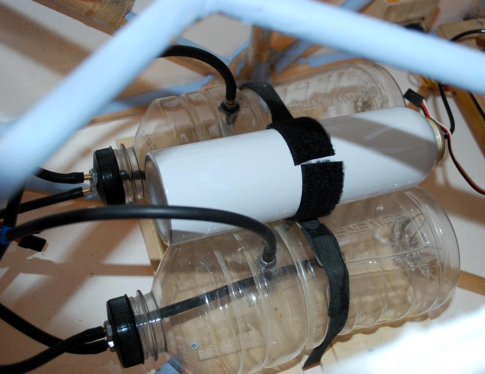

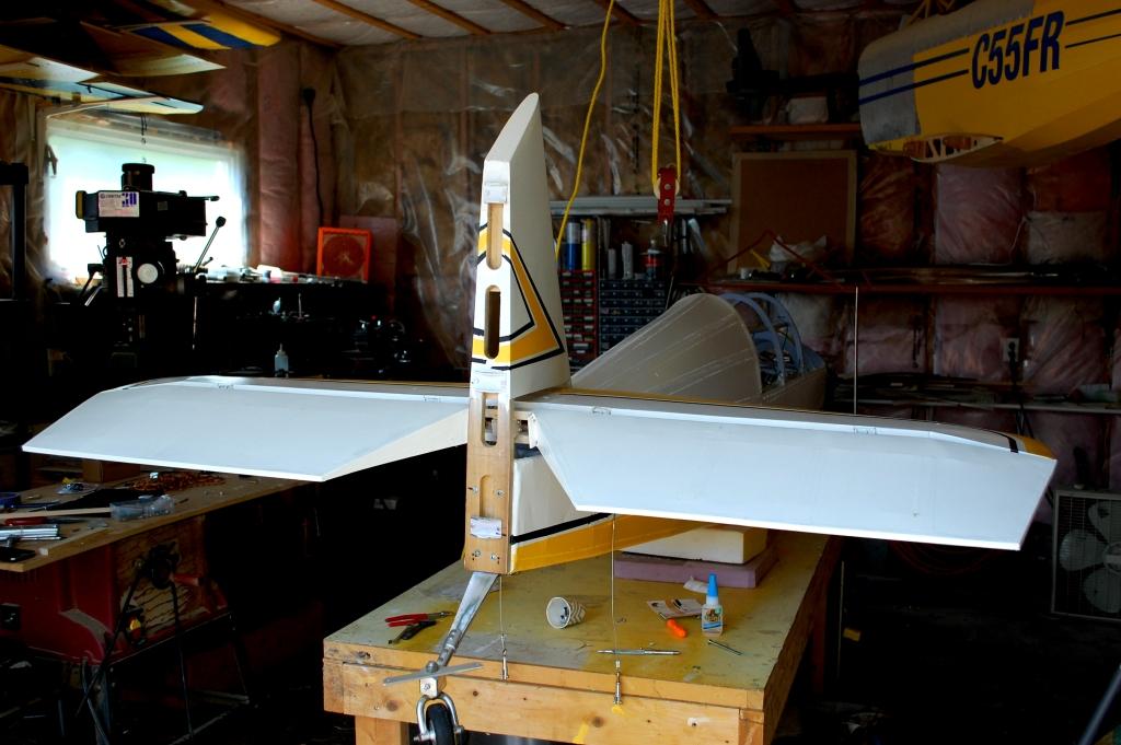

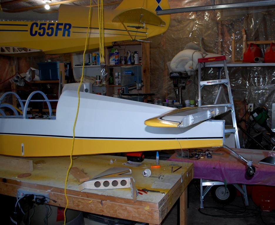

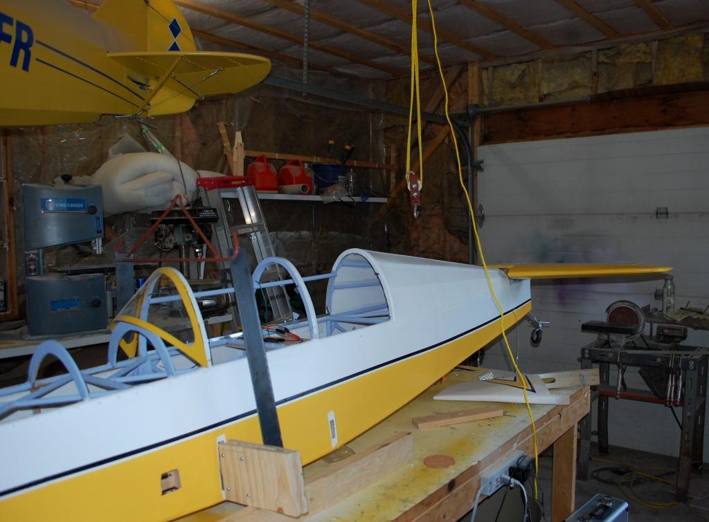

I put the air tank straddling the two fuel tanks, the other photos is showing the steps , this is really a home built airplane, in miniature
Man there is a lot of work but I love it and today too hot to go flying anyway , 30c with high humidity

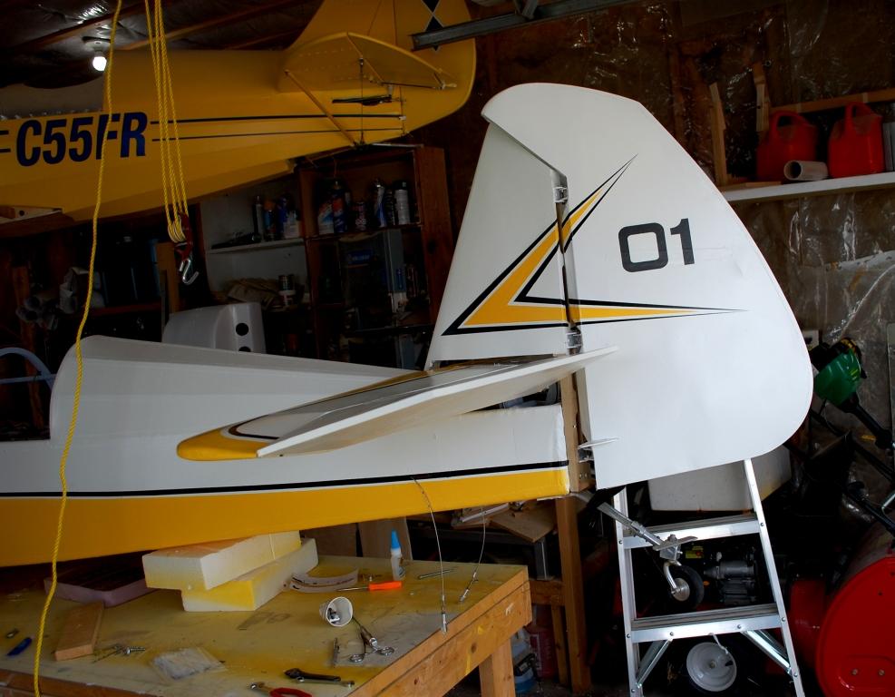

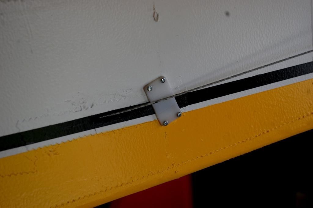

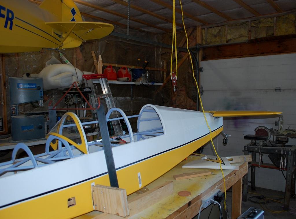

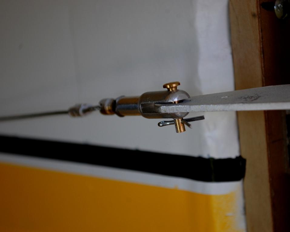

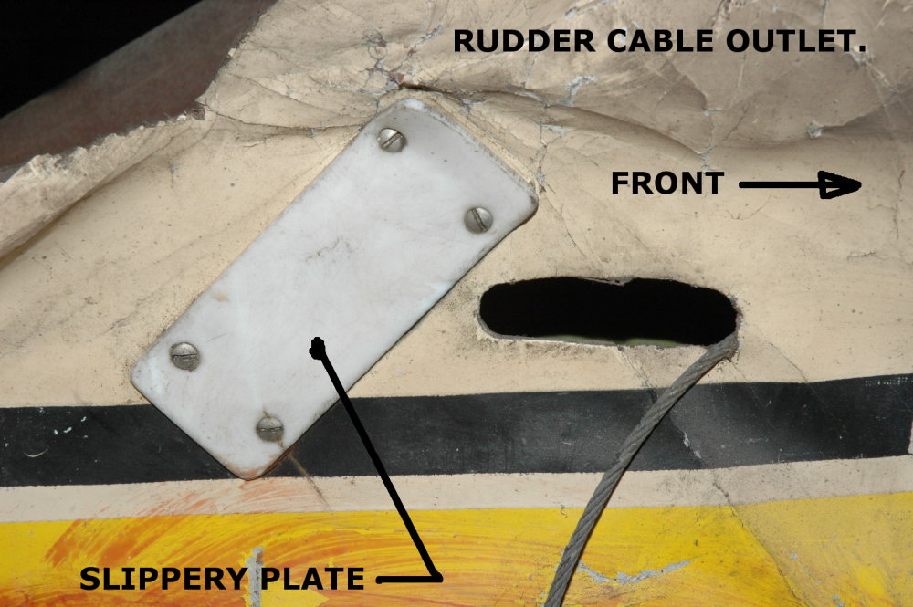

not much to show for 4 hours work lol, those are skid plates for the rudder cable as was on the full size the one photo with the markings is of the full size but in bad shape
