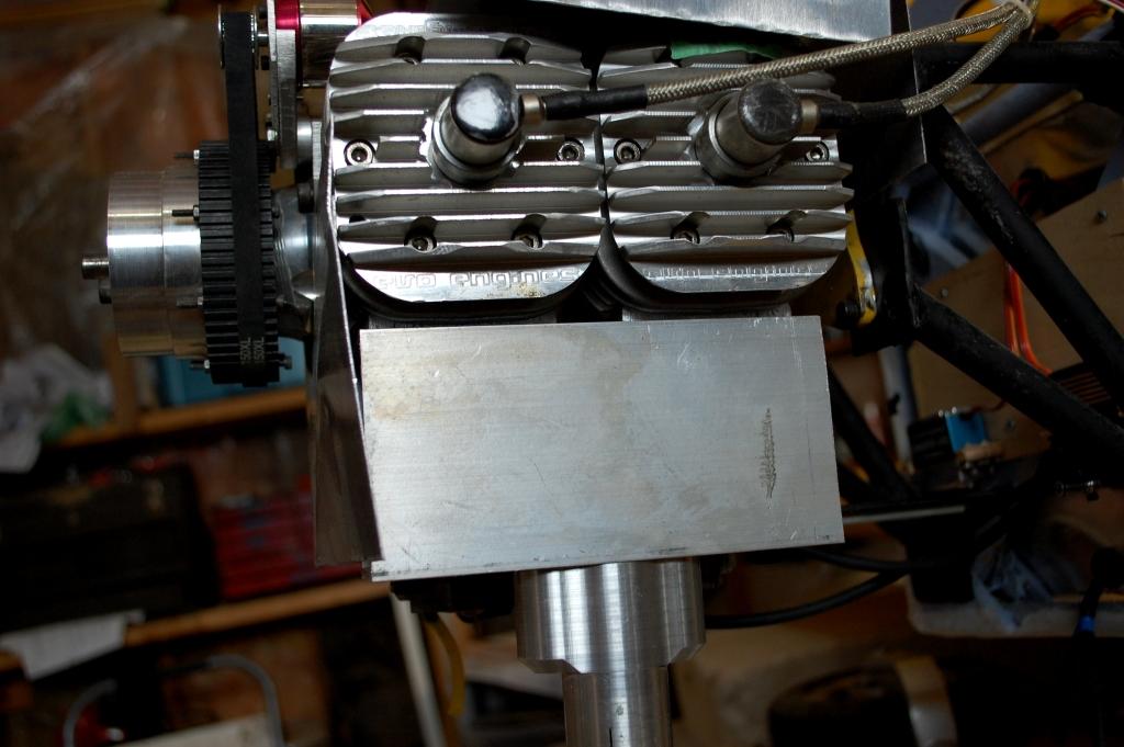

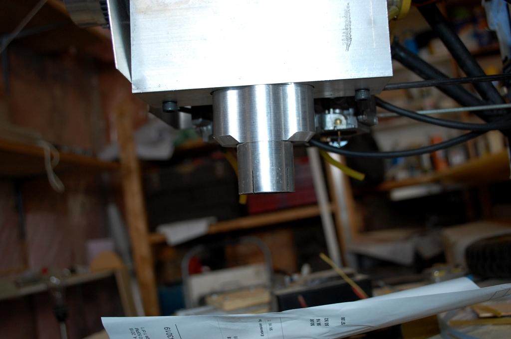

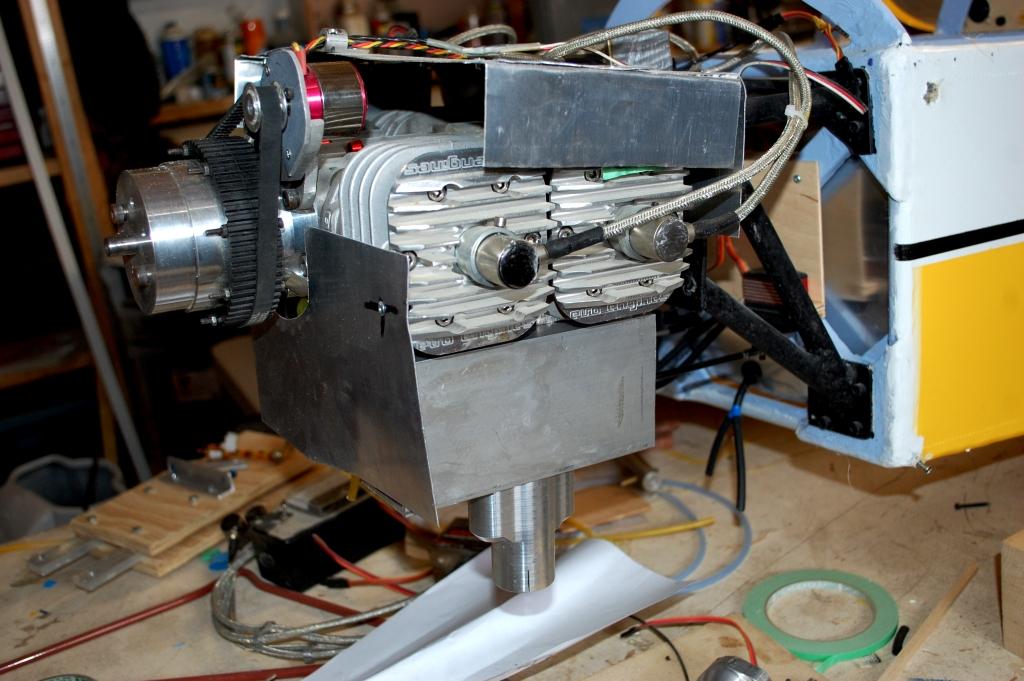

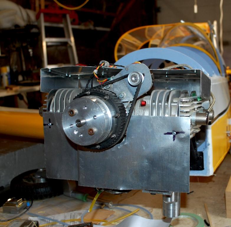

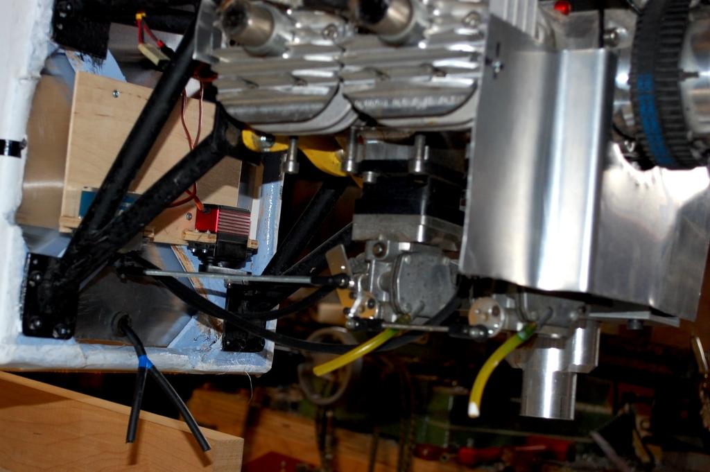

the mufflers are taking shape, have to redo one of the rectangles, no big deal, and still have to make the two tubes that goes inside, with all the holes in it but so far its working
