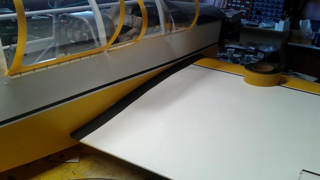

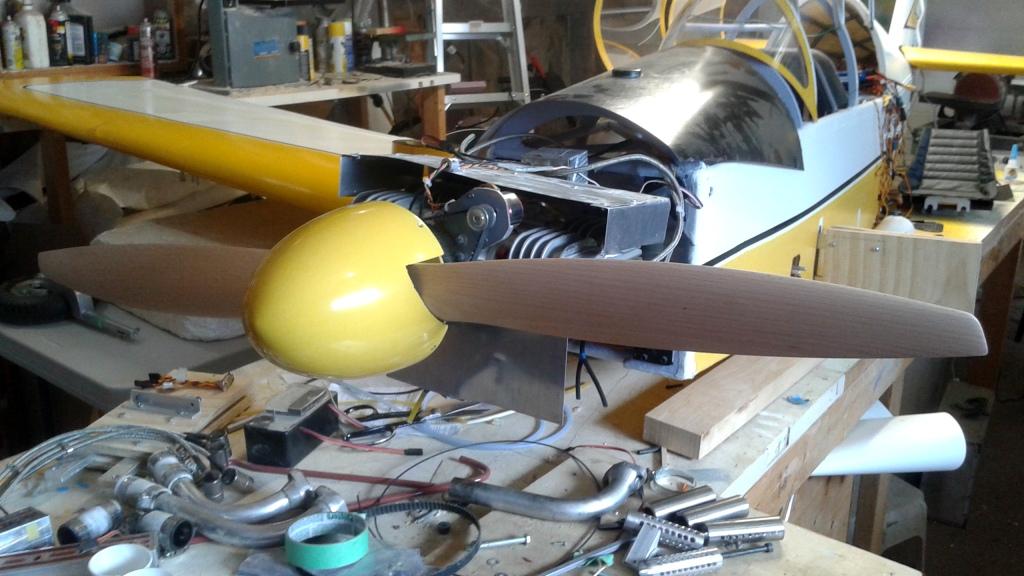

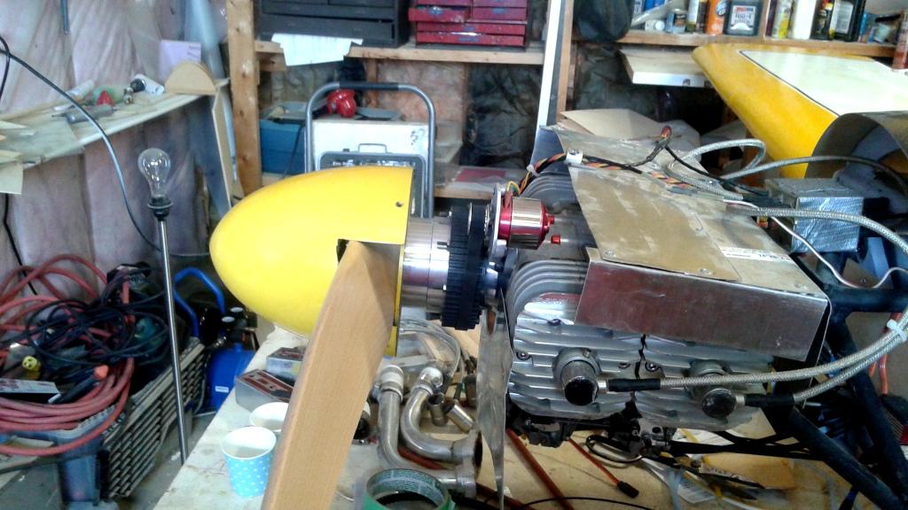

fitted the prop/spinner combo , looks like its going to work, this is a 38 x 14 , might not be enough propeller , any expert outhere, the engine is a 300cc also working on the wing/fuse seal

Seems like a 38x14 would keep you under 6K. Does the brushless motor act like an alternator as well or is it used for starting or both?
That seems like a pretty big prop.
Yes I would like to keep the engine under 6k and more like 5500. As for the small brushless motor yes it is used as an alternator, it would not be be able to even turn the engine over as a starter motor.
