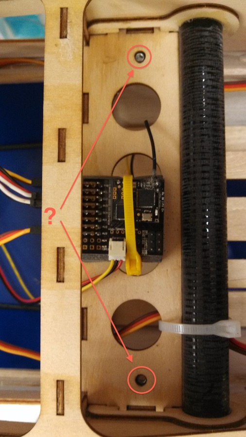

Perhaps a dumb question - but whut the heck are these blind nuts on the RX tray for? Can't find reference to them anywhere.
Those are for the wing bolts. There are tabs in the wings that go over those holes and you use I believe a M4 bolt to attach the wings.
One of the very cool features of this design. They are also used in the 104" Extra.
syspig
Well duh...guess who hasn't plugged the wings on yet. I assumed they would bolt through the fuse sides like all my others.
About the only way I'd feel dumber, is if I'd chosen that location to attach my TM1000. That spot was on the short list before I plopped it below the RX...:facepalm:
bryanb
Yes, [MENTION=271]Enterprise[/MENTION] is right (wing bolts) but I think they are M3 vs M4.

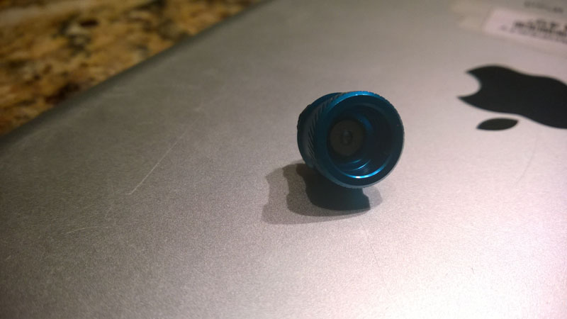

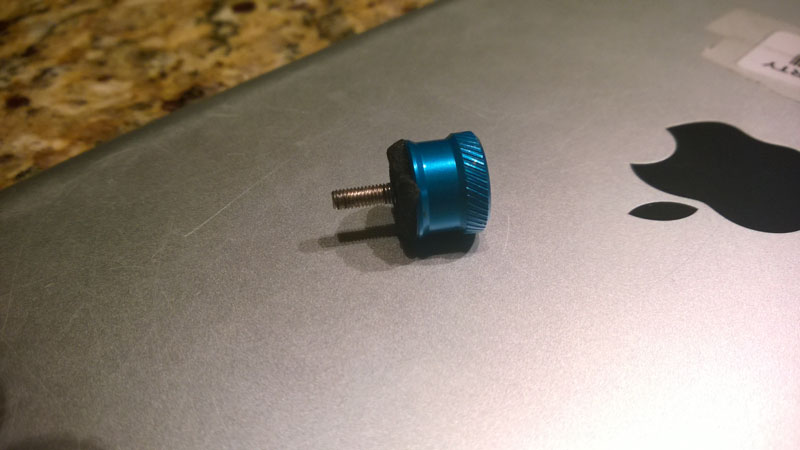

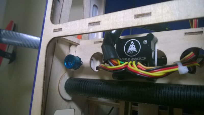

Here is what I did instead of using the stock bolts. I purchased these Seacraft Wing Bolts M3 from Aztech Aeromodels: http://bit.ly/1gsiDkD and used a tiny bit of Red threadlock on the head and the bolt to secure them together. They now function as thumb screws for me putting on my wings. I even added a bit of sticky foam on one side to hold tight.
