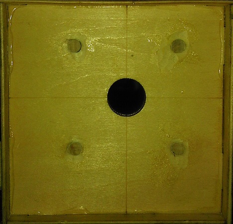

Question, Should I have plugged the center hole in the firewall as I did with the motor mount holes or can I use that as a reference for the new motor? Sorry about picture quality, came from my phone.
Nope. The shaft that protrudes slightly from the rear of the motor needs that opening. It also helps move air through to aid with cooling
Bushwacker
3DRCF Moderator
Sorry I wasn't very clear on this one. I meant do I need to plug that one and re drill another one like I will be doing for the motor mount bolts. Think I will be okay, it's just the bolt pattern that doesn't match up. The center is still the center right?
3dNater
3DRCF Regional Ambassador
No worries... what would make me frustrated would be for you to not ask and then have a screwed up experience with a fantastic plane.
