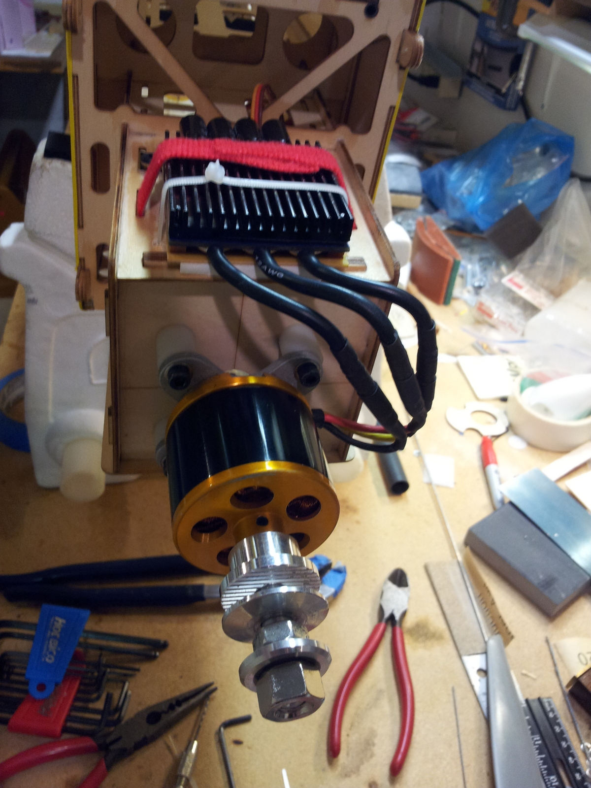

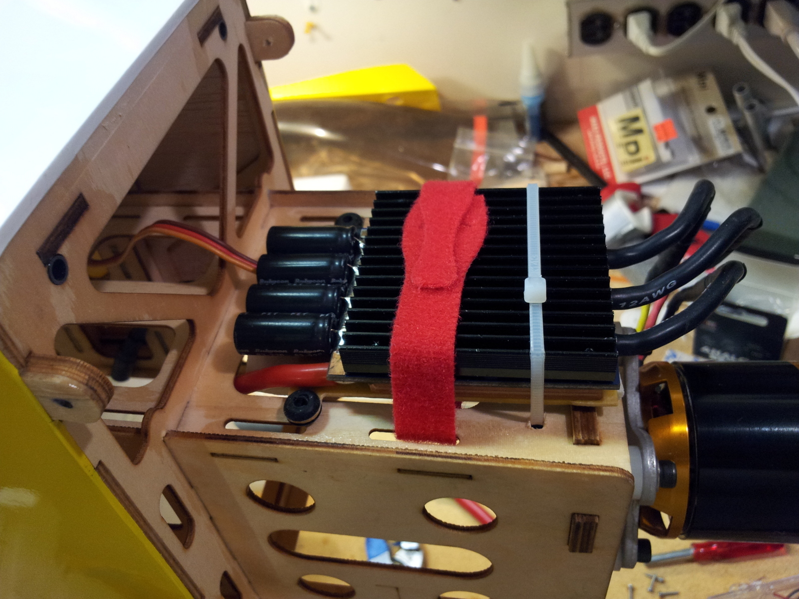

I got the soldering done. Thanks for the tips. Got a good fit of motor, spinner and cowling. Gave it the smoke test and actually spun the motor for the first time. I sure would like to see some pictures of how others have mounted their ESCs and their receivers. I would also like to explore some alternative battery straps than the one included in the kit. Anyone have any suggestions?

Glad you got the soldering completed.

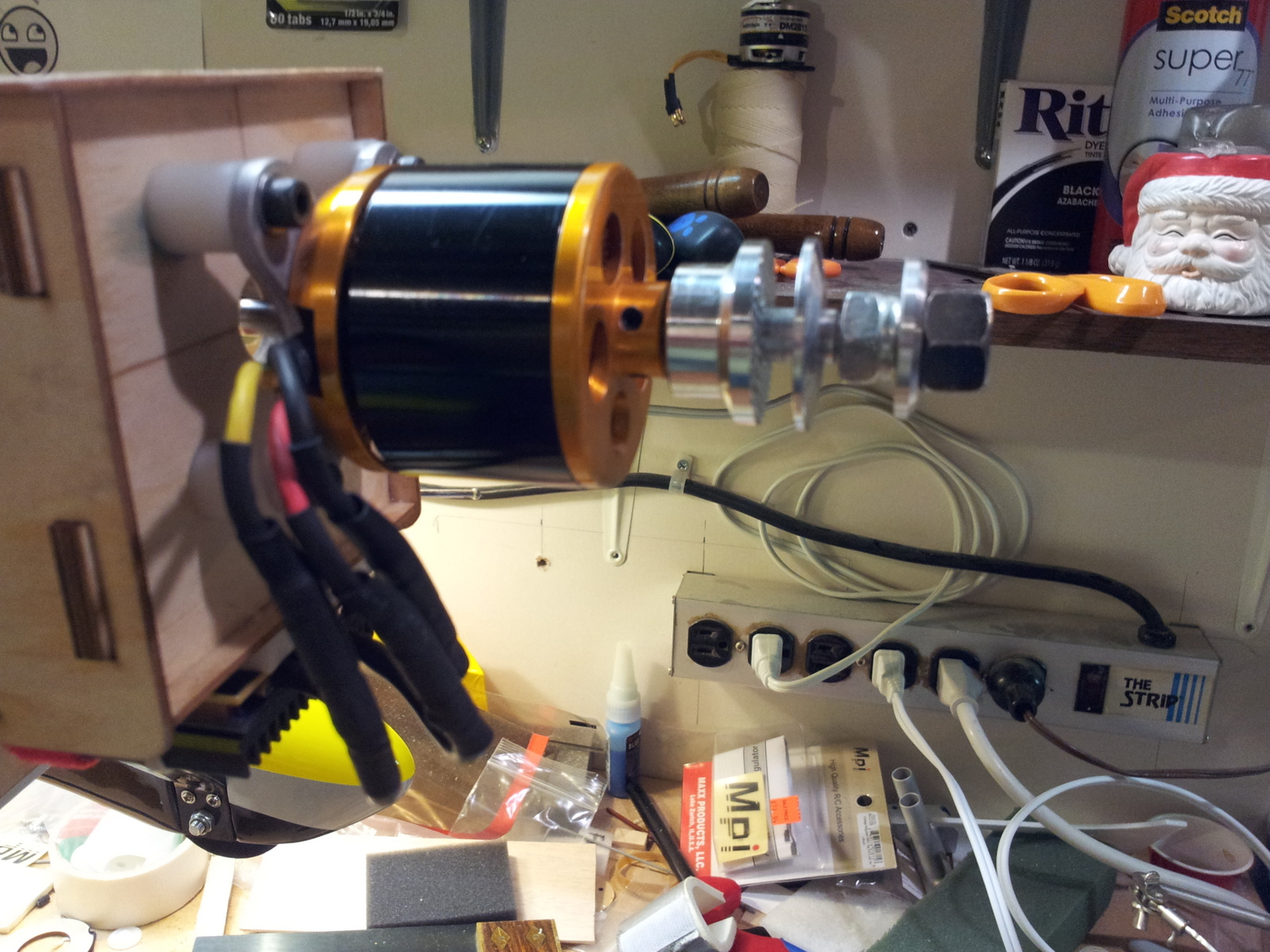

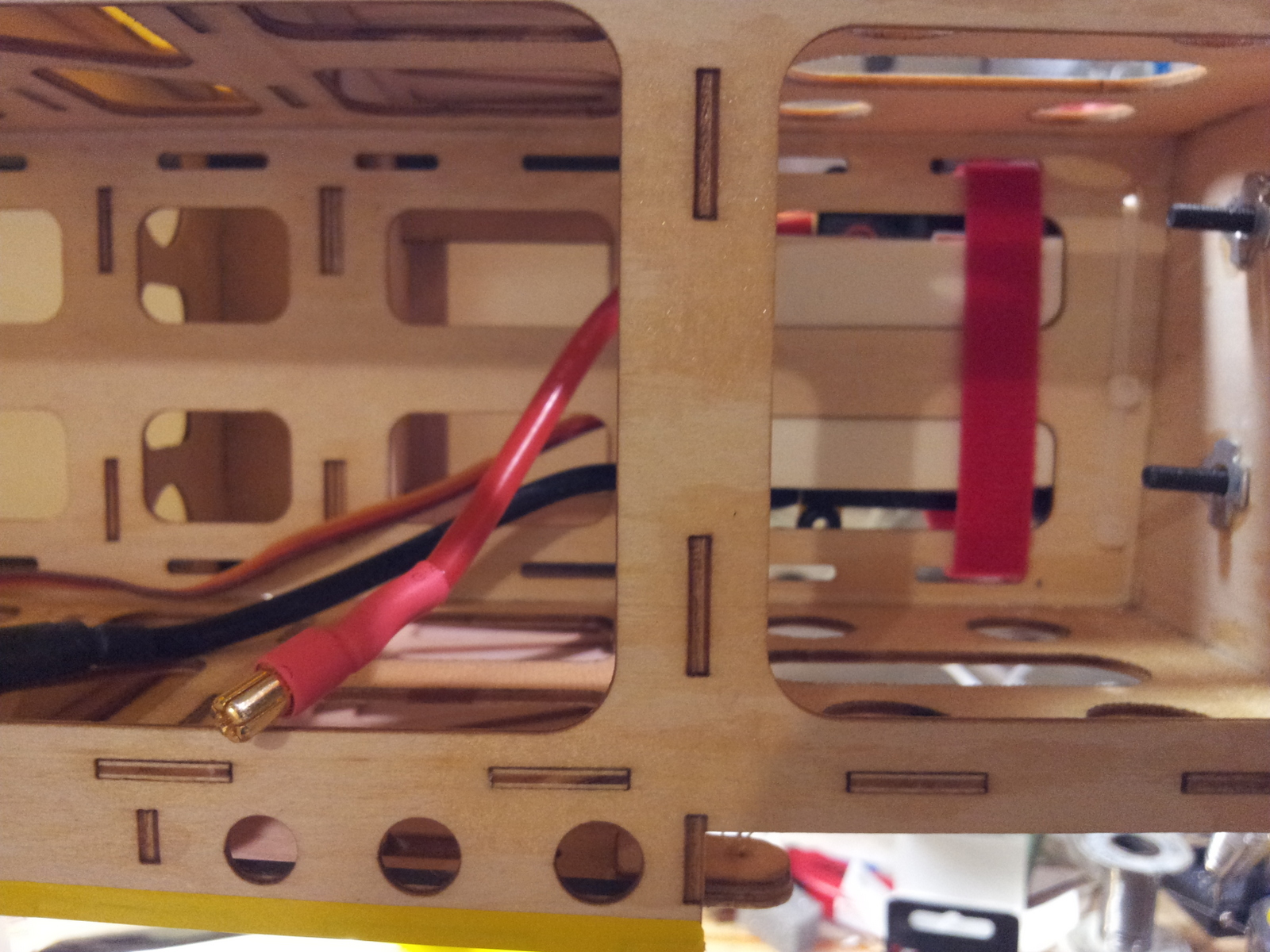

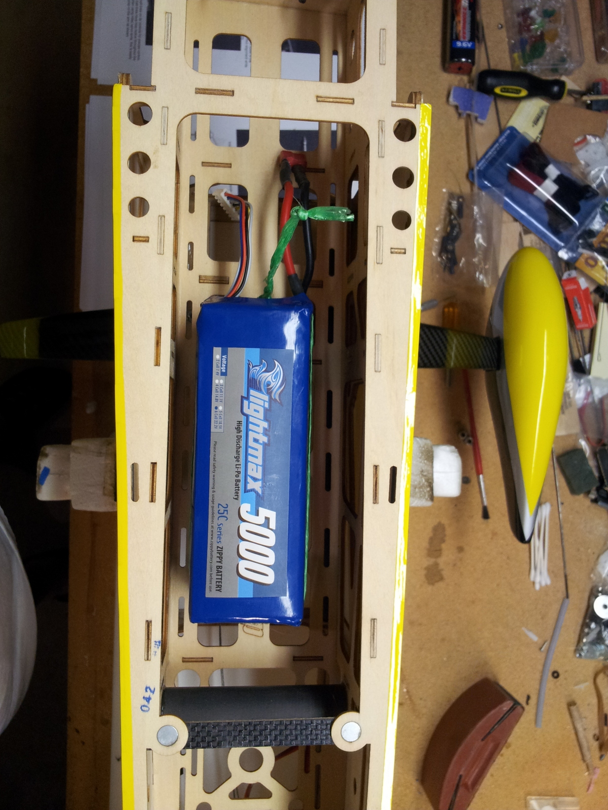

Here are some pics of my ESC and other stuff. I do not use the stock velcro straps...they are not sturdy enough. Use heavy duty velcro from Home Depot or similar. Couldn't find any good pics of the battery straps...I used two, one around the front of the battery and one around the back. Battery (6S5000 is located about 1-1/2" forward of wing tube.

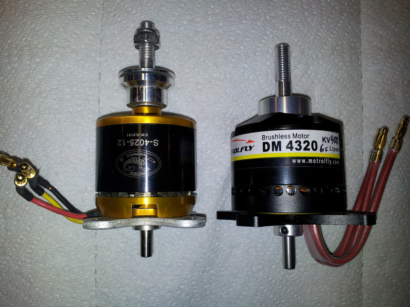

I burned up the Scorpion motor and replaced it with a Motrolfly 4320:

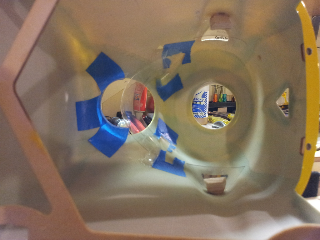

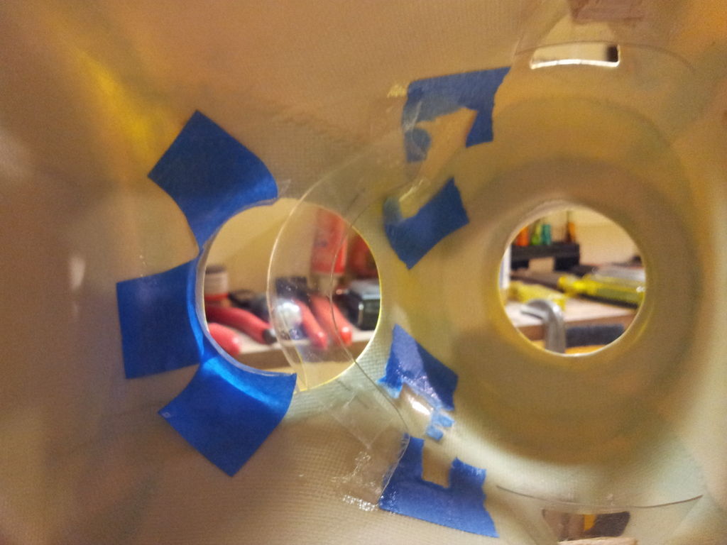

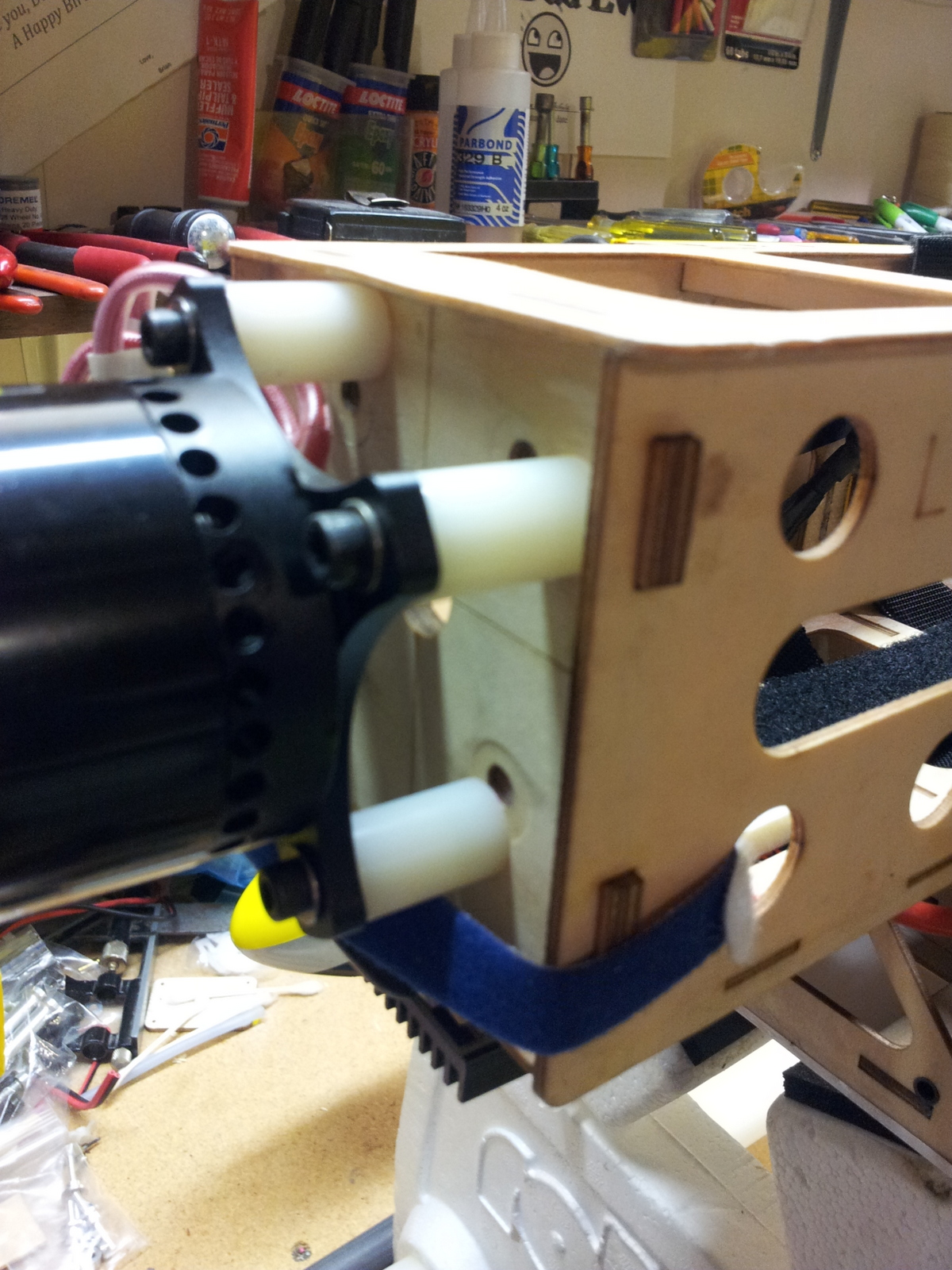

It felt like the motor was running too hot, so I installed some air vents/baffling:
I did find one pic of a test battery..not strapped in,
but that is pretty close to where it sits.

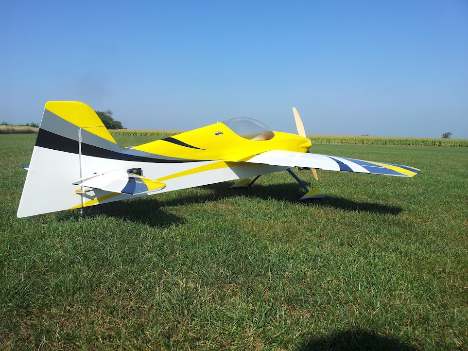

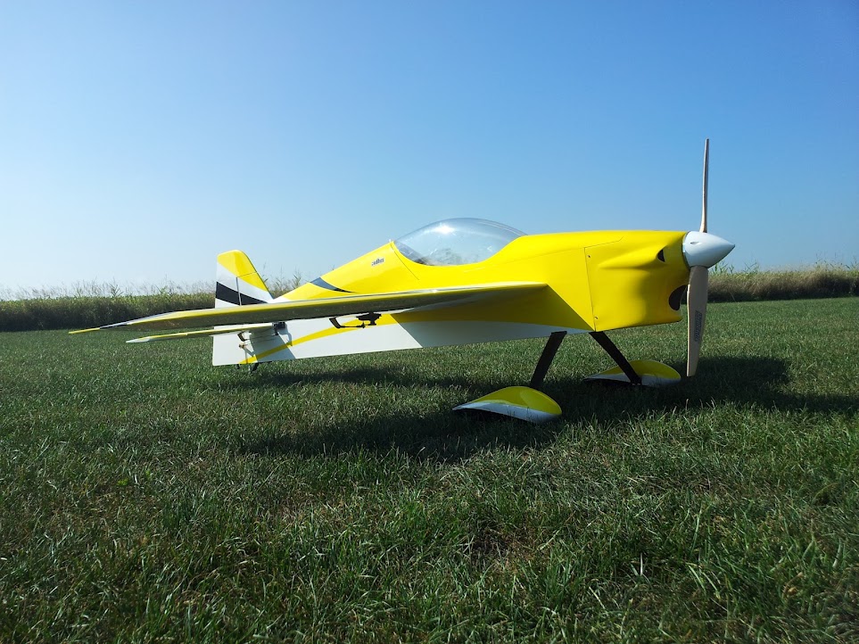

Of course, a few final pics are necessary: :D
These pics are very helpful. Thanks for taking the time to post them. Do you get the Velcro cinch straps at Home Depot or is it just raw velcro on a roll?
