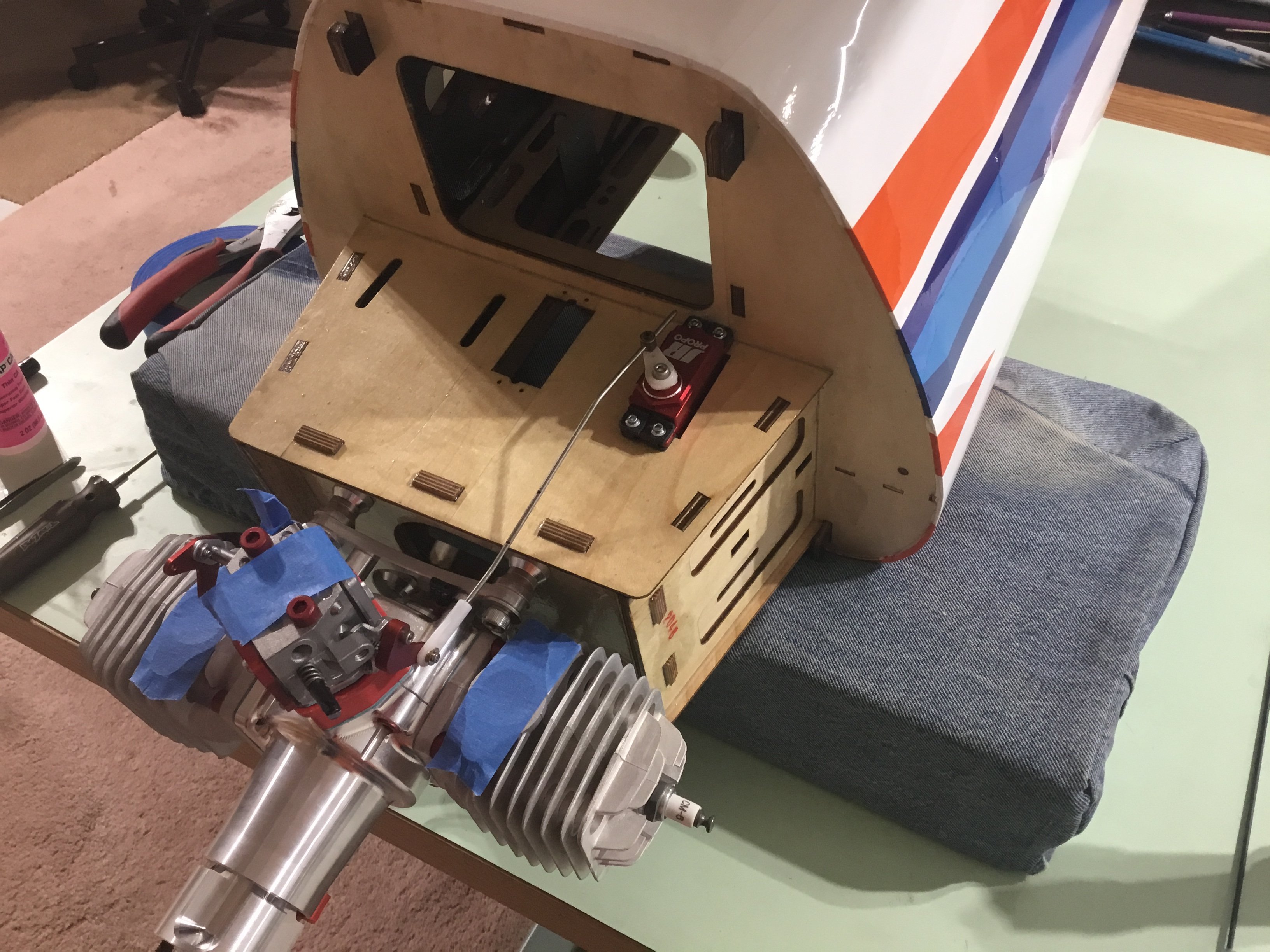

This is a JR thing, when you bind your receiver you can set it up in XBUS OR pwm. When set your receiver in XBus mode all the channels on the receiver in in Xbus. The Ibec from AJ is pwm device and cannot read XBus. So JR sells a device that translates XBus into pwm so that you can run other devices as required, hope that makes Sens. The rubber servo going into the plane is a MKS777 and it works on Pwm therefore I needs a pwm converter to make the servo to work. Using the servo had it left over and did not want to buy another expensive servo.

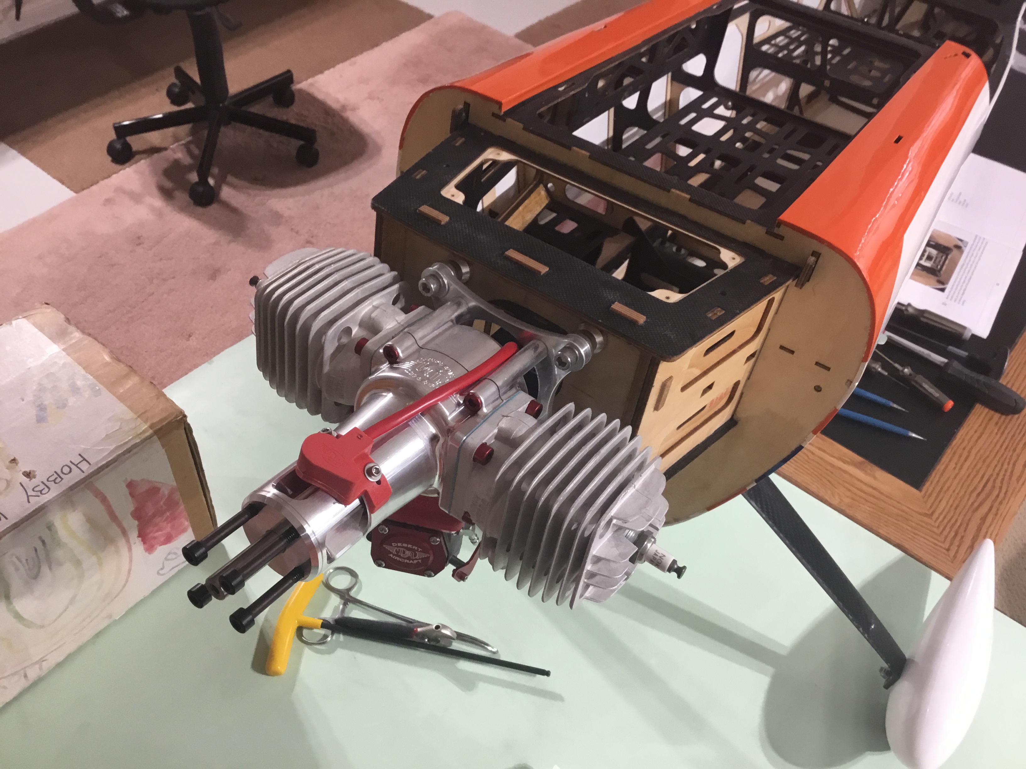

Big step for me always like bolting the motor on for the first time. Don’t know why but the engine looks small on the plane.

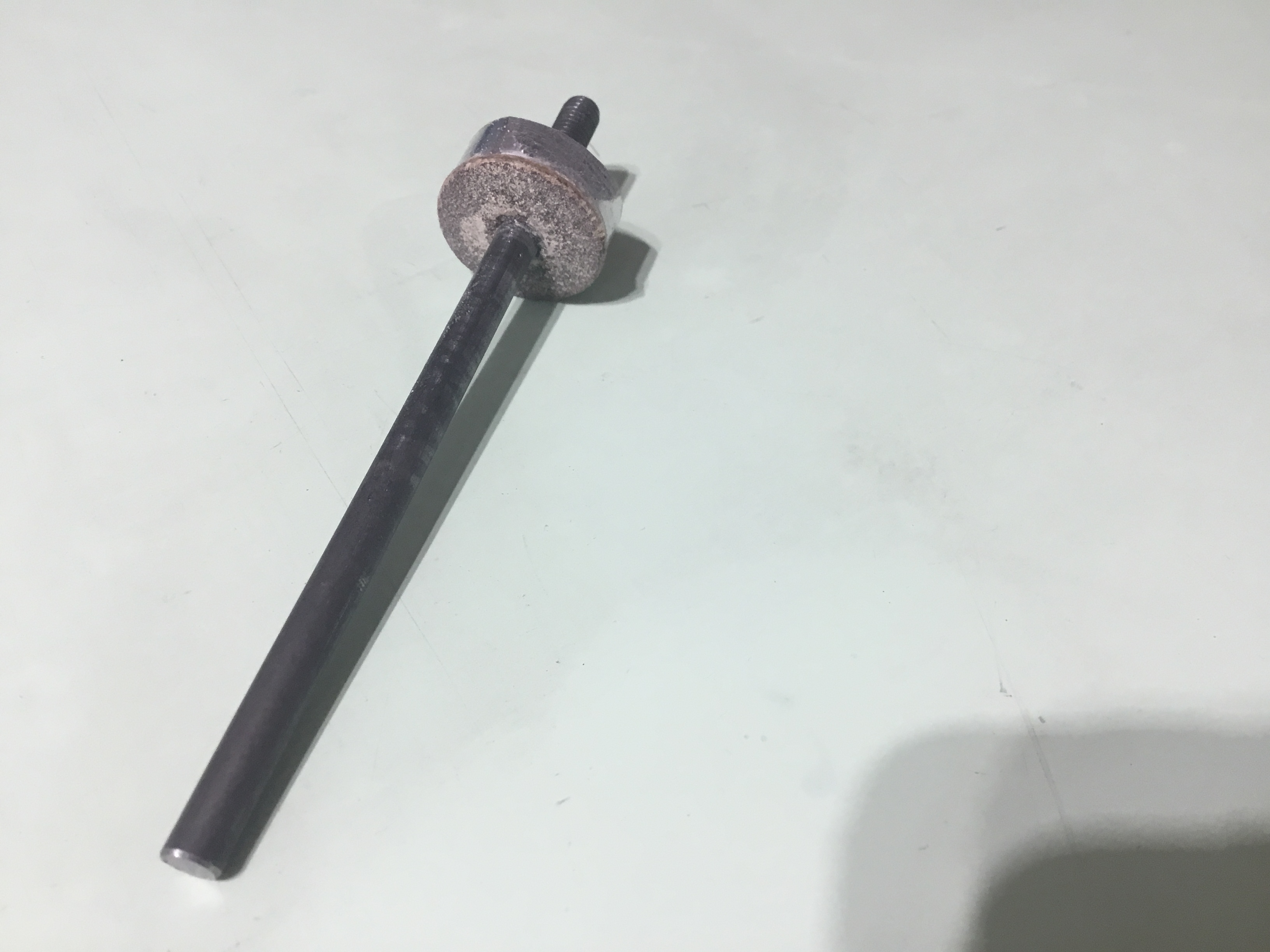

Just something I use to get the motor washers to lay flat on the firewall. Once trying to install the DA the bolt holes are very close to the triangle wood gussets on the firewall. I made this tool to sand down the gussets close the motor mounting bolt washers. It is made from a 1/4 bolt and 1 inch diameter aluminum rod Cut to 1/2 long. Then glue 80 grit sandpaper to the aluminum Part. Push the bolt through the hole connect a drill to the rod. Turn the drill on and then pull on it , it sand the bevel away in no time.

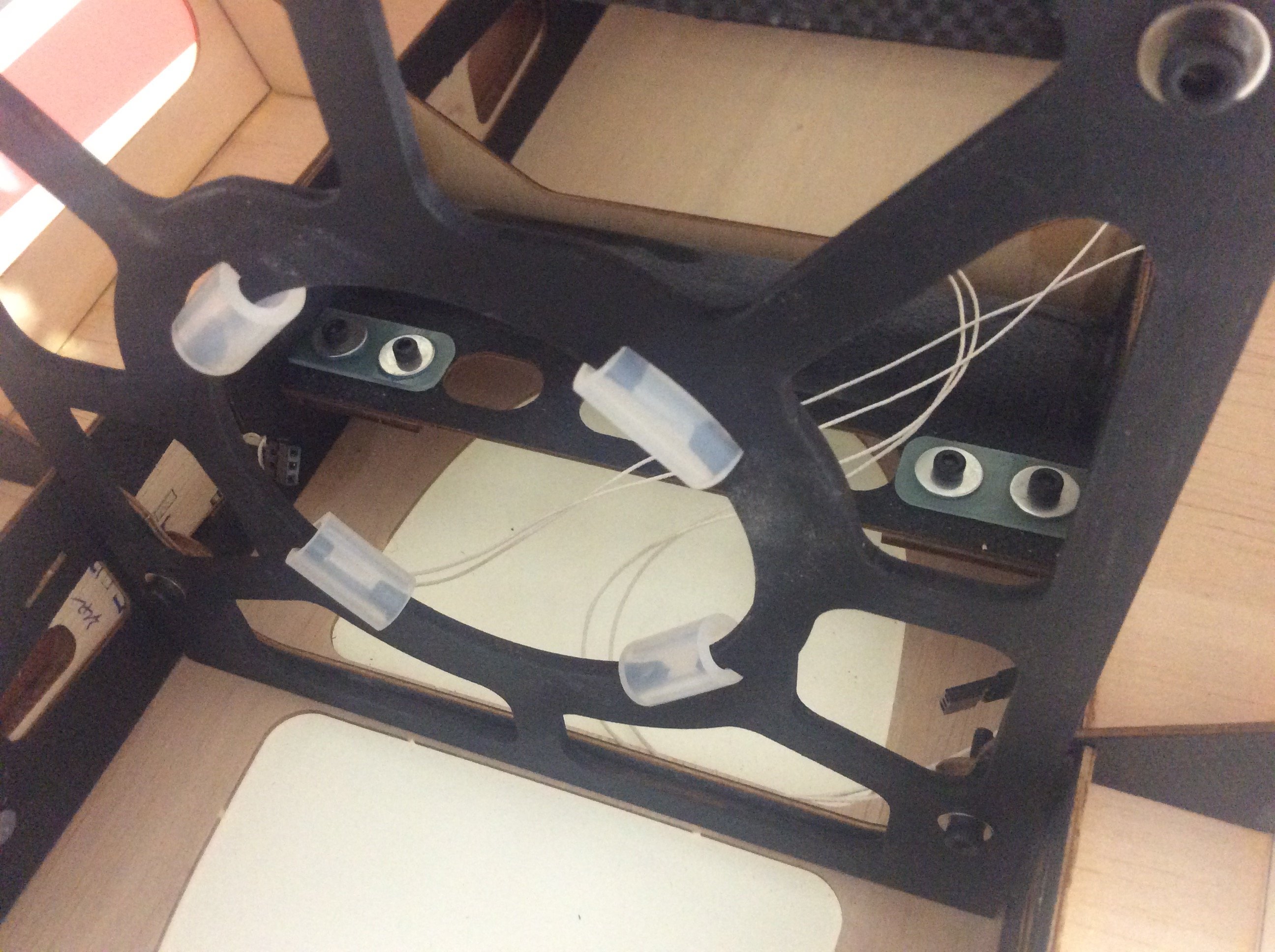

Well installing the bottom wings did not go well. The wing tube fit was good but the rest not so much. G10 fibber plates that hold the wing in did not line up. The left wing needed a bunch of filing to get the wing bolt in. The right wing I needed to make a new G10 plate the holes were just to far off to fix, so spent a few hours making a new one. It all fits now, the only 2 things that are going to a pain and hopefully I can come up with a solution for both. The aileron wire trying to feed them into the fuselage is painful and needs a solution because I will be cursing that every time I assembly the plane. Second is the G10 plate that locks the wing is difficult to line up with the wing and you cannot see the slot for the plate so not easy to slip into the wing into the fuselage.
