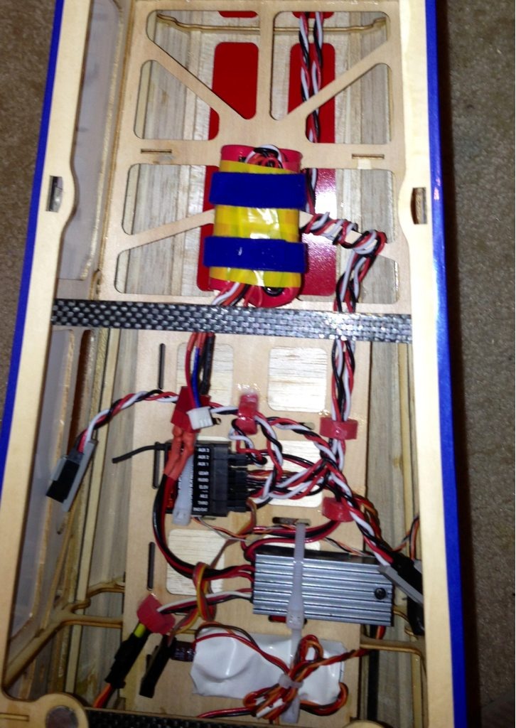

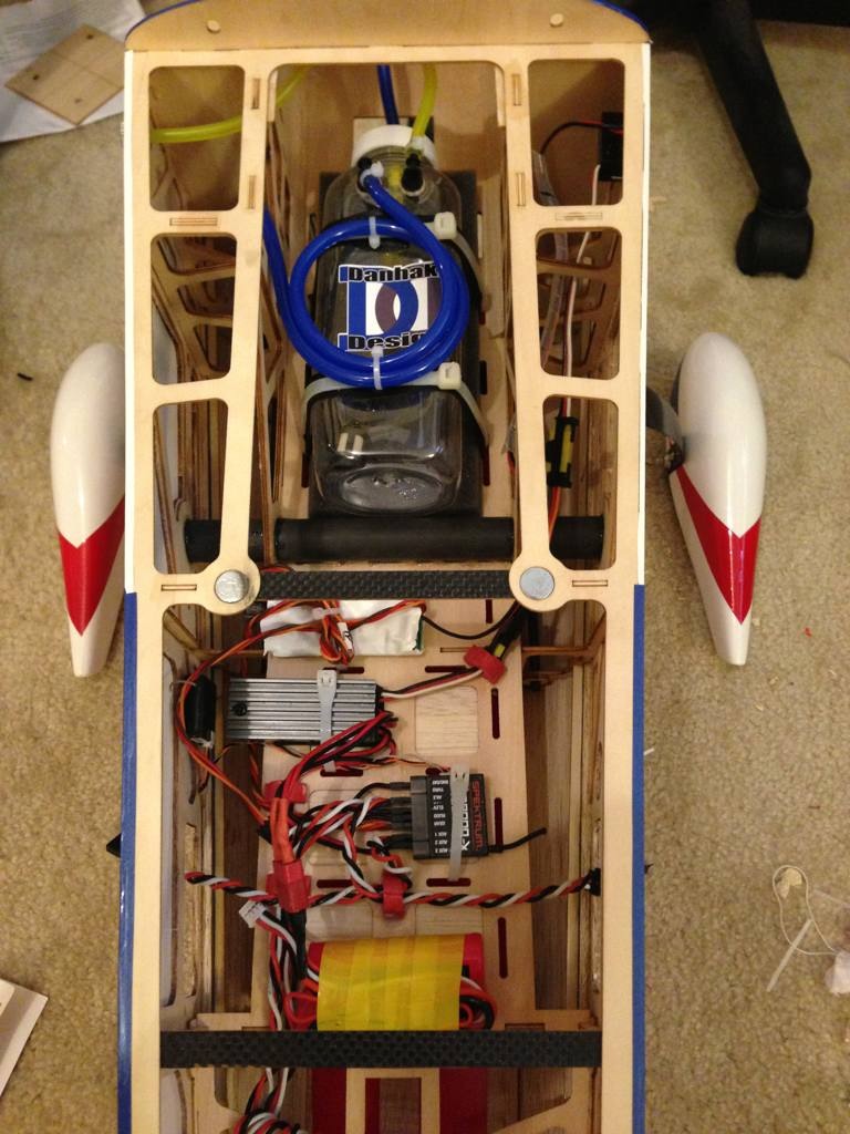

Here is the way I have the interior setup on mine, maybe seeing it will give you some ideas for balancing:
(note, I moved the battery back to the first picture location, the second pic was before I installed a spinner)-
Hope this helps,
