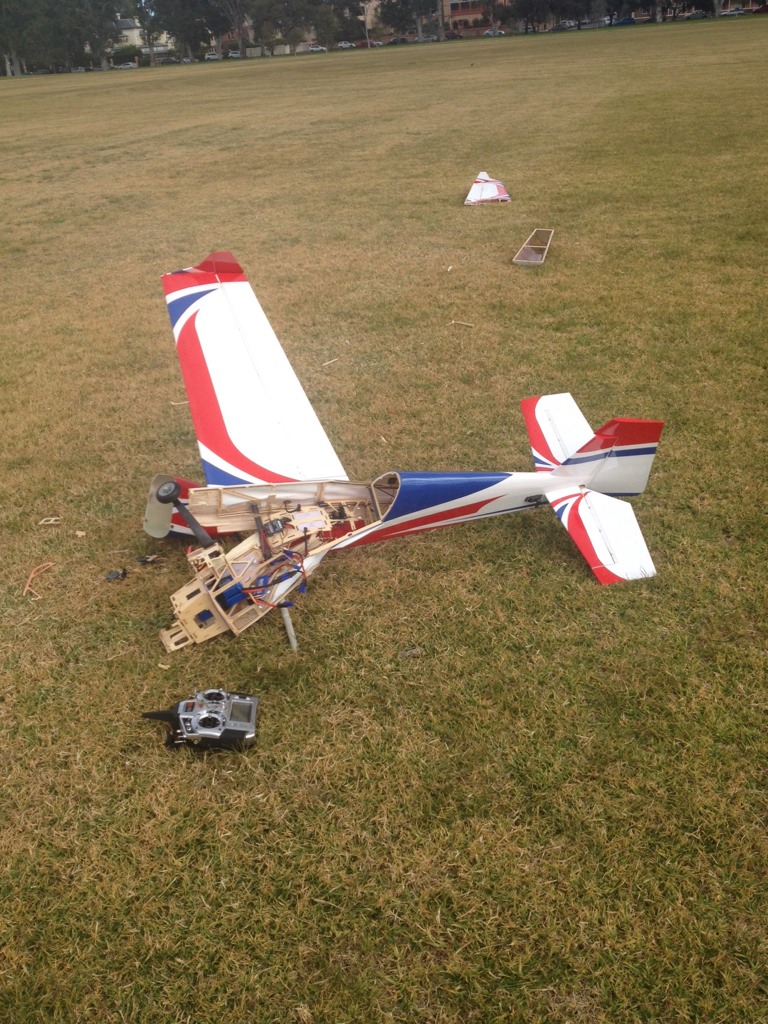

I pulled off an amazing manoeuvre a week or so ago.
The full throttle KE landing!

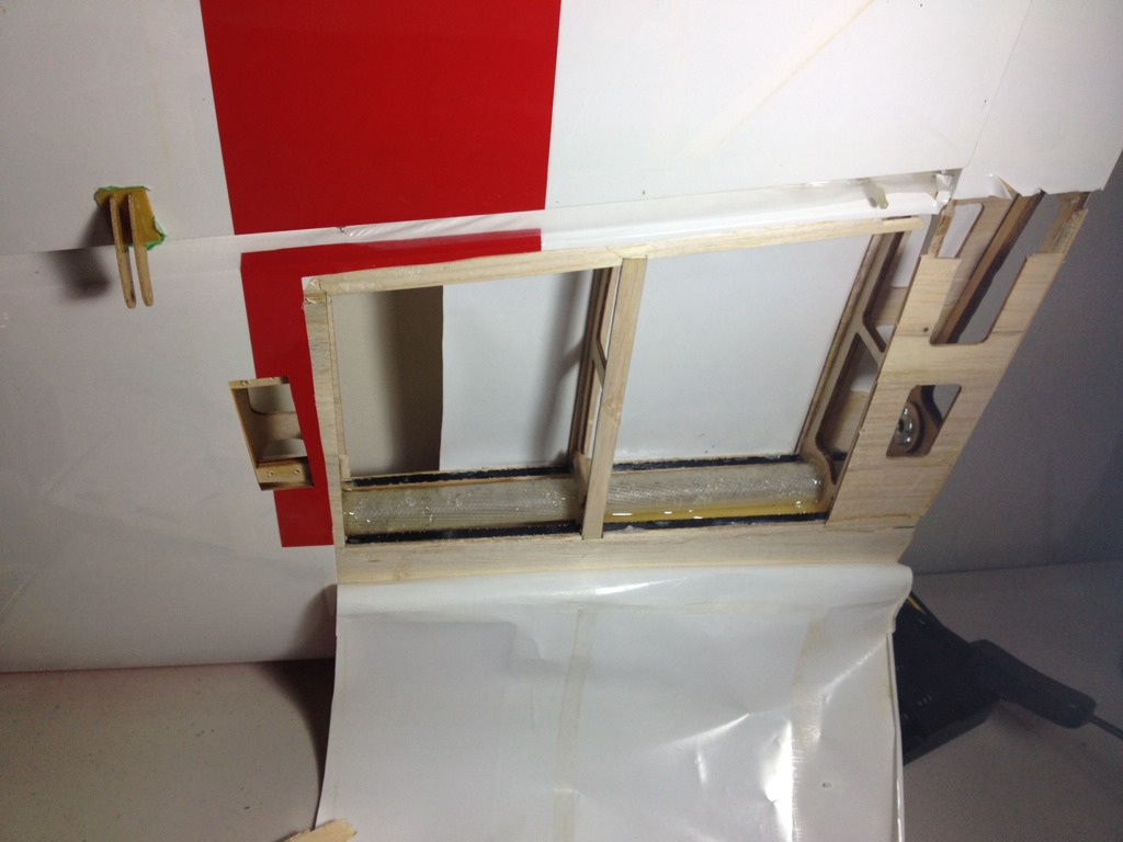

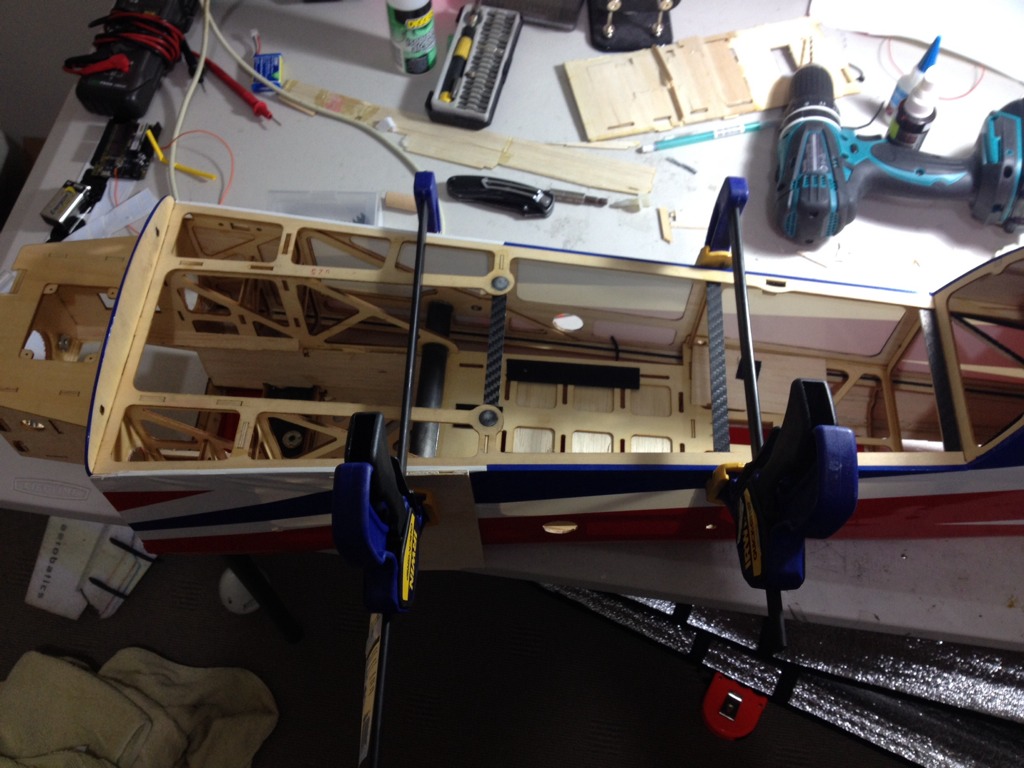

Since there are no kits left in Australia, I was forced to rebuild, and so began a huge learning curve in sheeting balsa and covering wings.
First up things needed a bit of "forced alignment" with a few quick grips and some ply... And a sheet load of CA+kicker to hold in place.
PU was then sandwiched between the old broken ply and new supporting ply.
Then the hard bit; open wing surgery and a wing tube transplant.

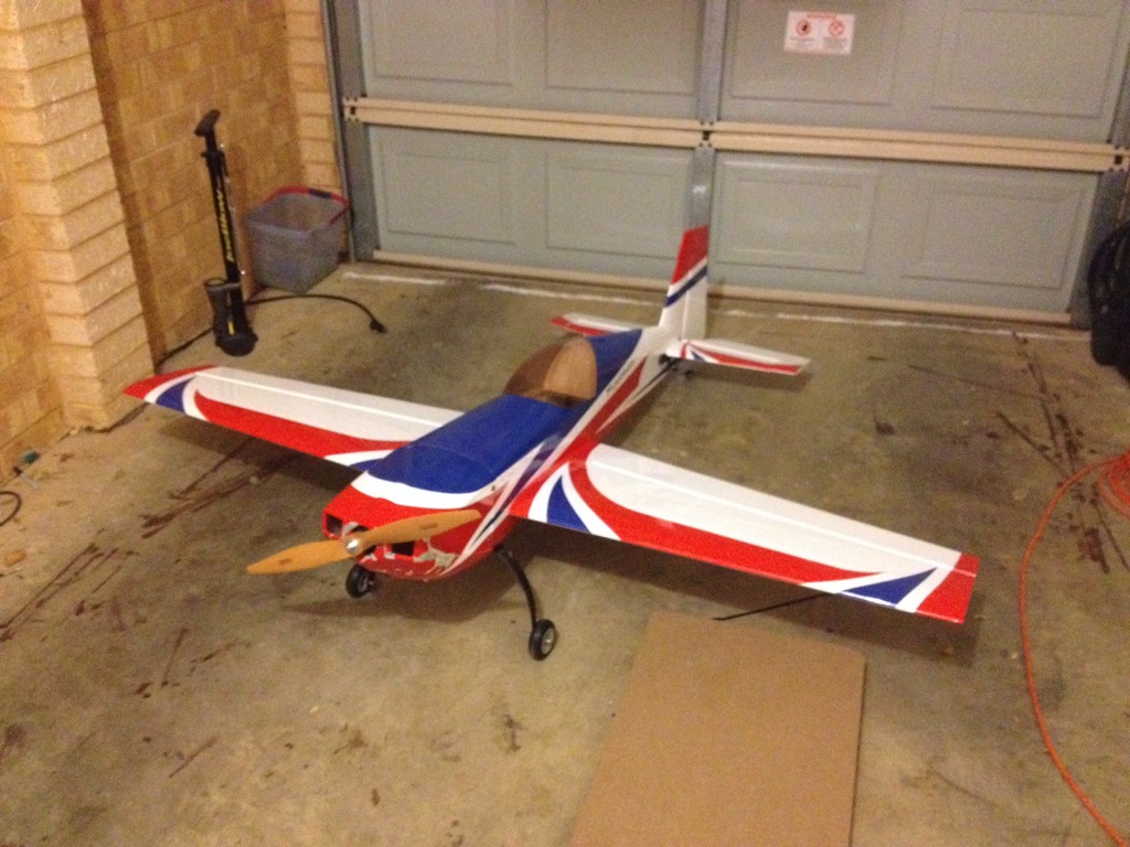

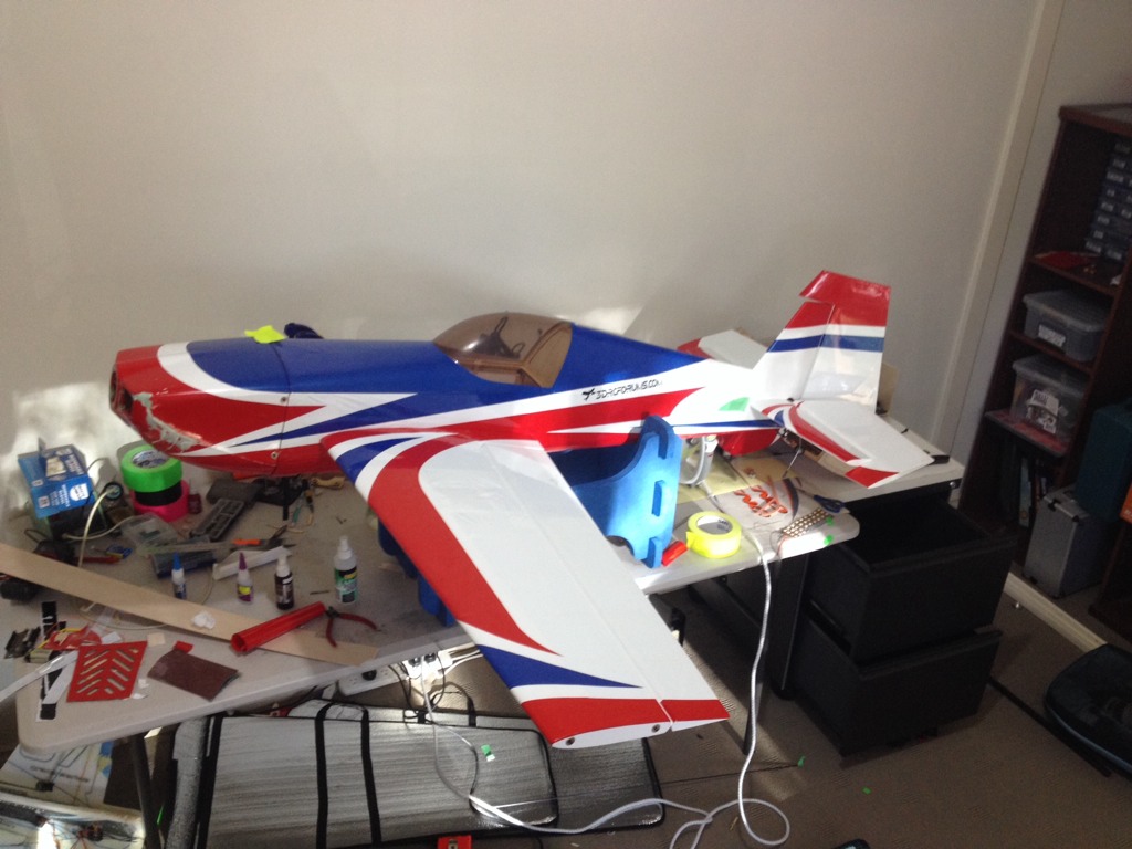

After many hours of gluing and sanding and covering it was time for a trial fit of the parts.
Holy crap it was straight!(ish)

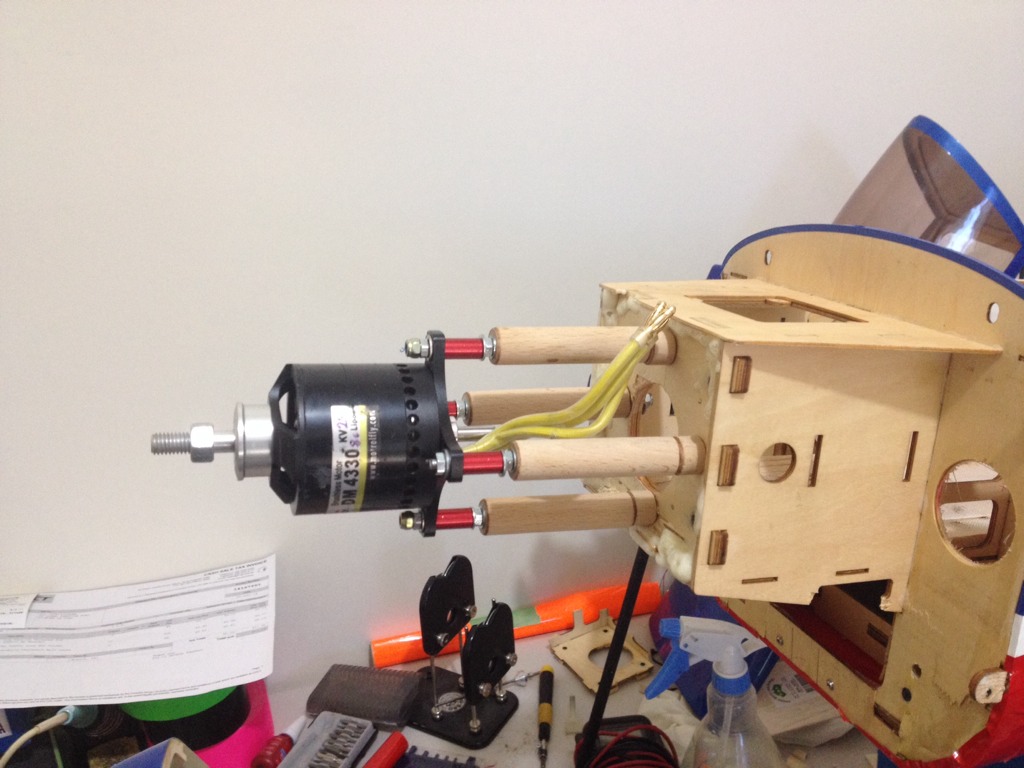

Time to work out what to do with the non existent electric motorbox.

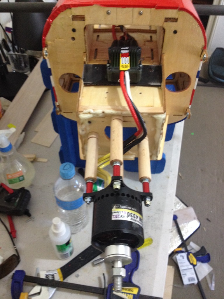

I chose to use stupidly long stand offs and 125mm threaded M4 rod to join it all together. There are lock nuts behind the blind nuts that cover the exposed threaded rod and stop any movement.
First impressions are "damn ridged" when I tried to squeeze the motor on
ESC mounted to a alloy brace now fitted to the motor box under side where it all ripped out in the crash.
I still have a lot to do, but it has been a great learning experience, rather than my usual "squirt CA and hit it with kicker, she'll be right" methods of the past.
