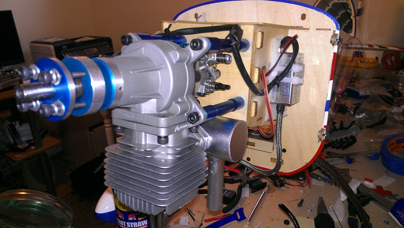

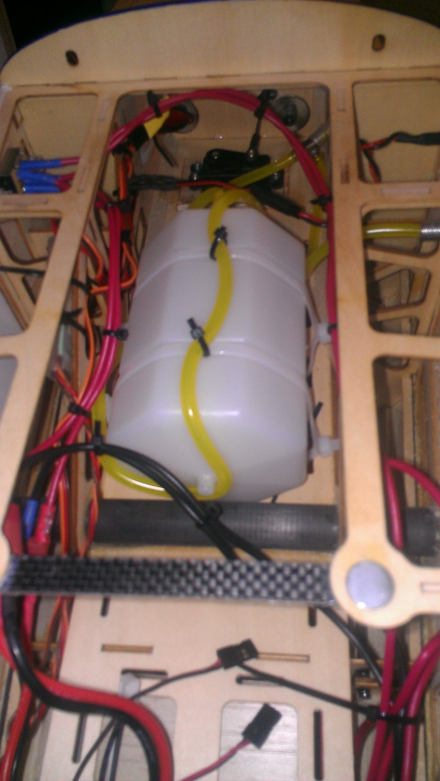

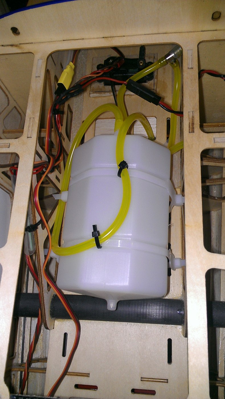

It looks like mine is going to come out a tad tail heavy. A heavy aluminum spinner may do the trick, but I'm still a bit worried. Anyone who can shed some light on this? Is it difficult to balance with a gasser in the nose? Did you have to add any weight? I went for the push-pull rudder (as per the recommendation in the manual). Should I have done pull/pull instead?
Right behind the wing spar.
