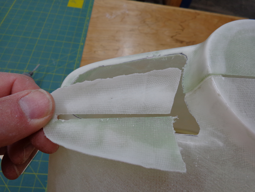

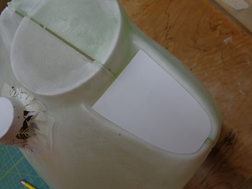

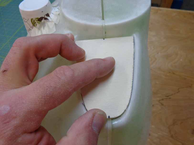

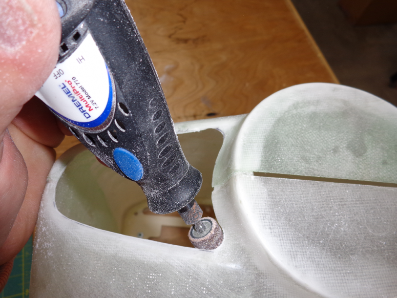

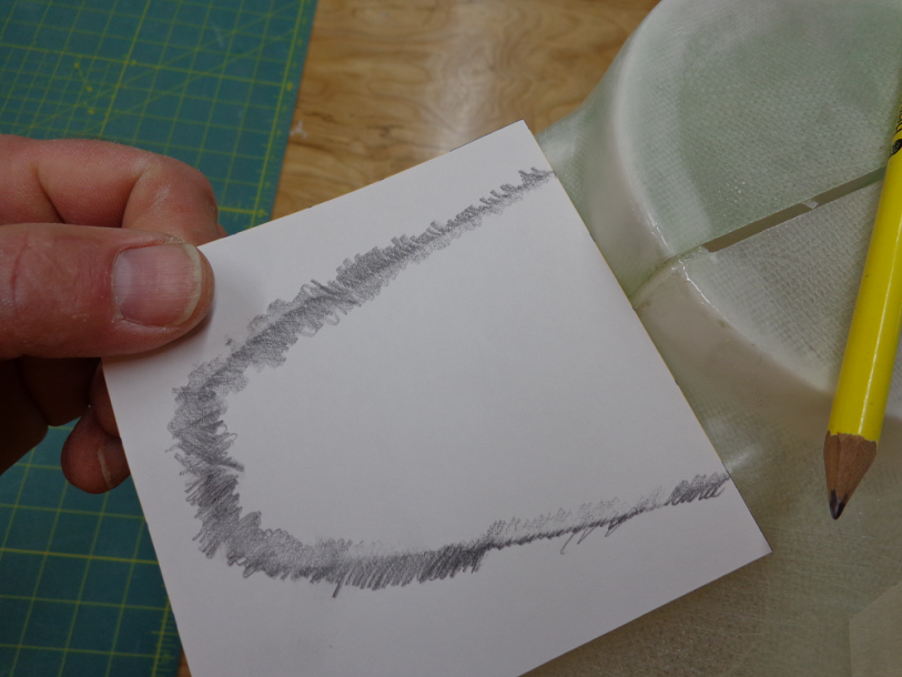

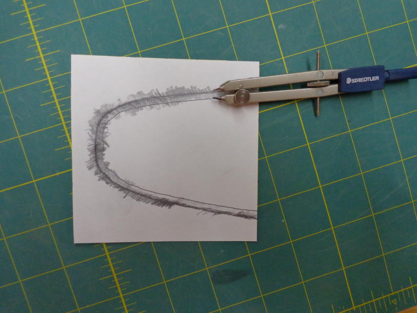

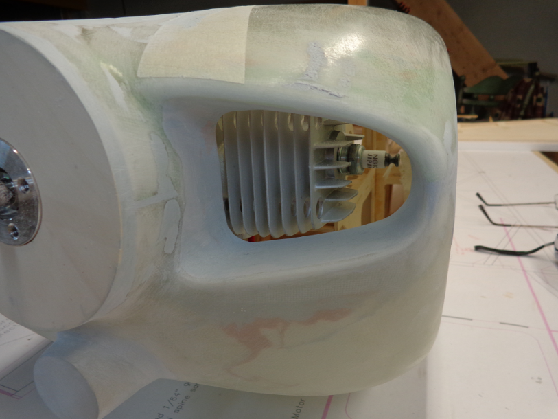

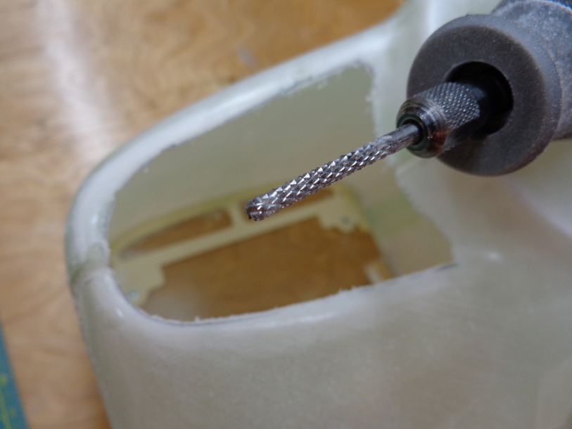

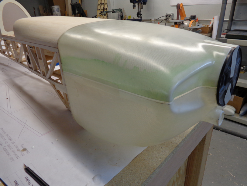

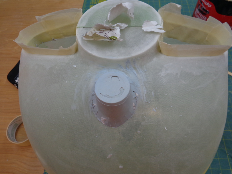

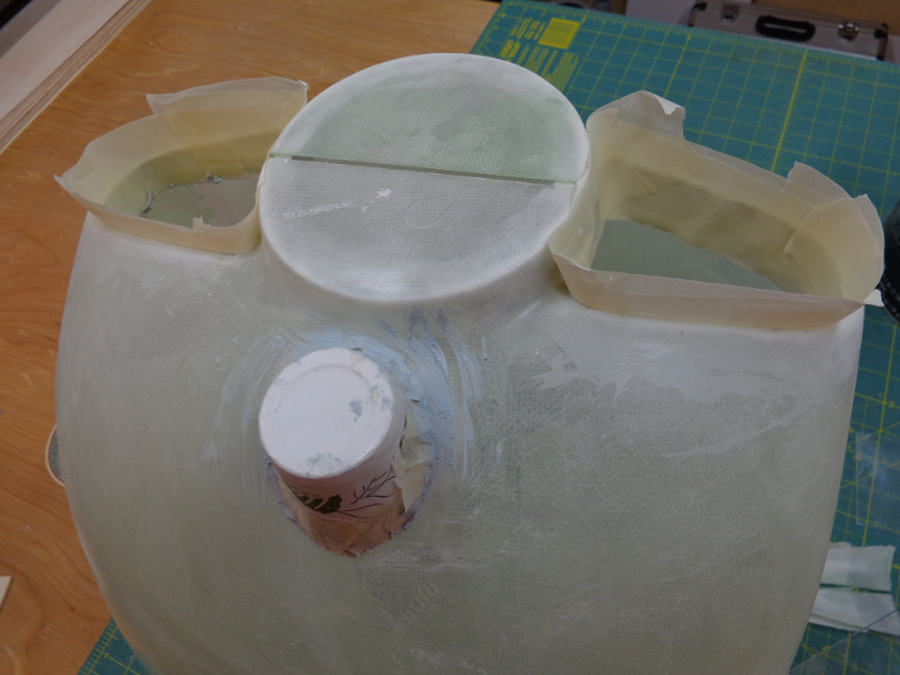

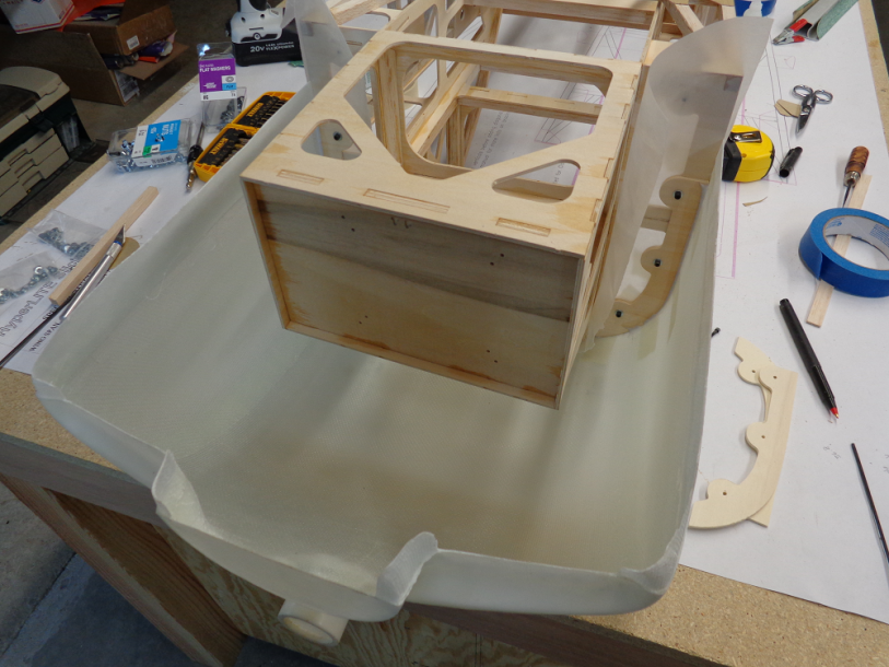

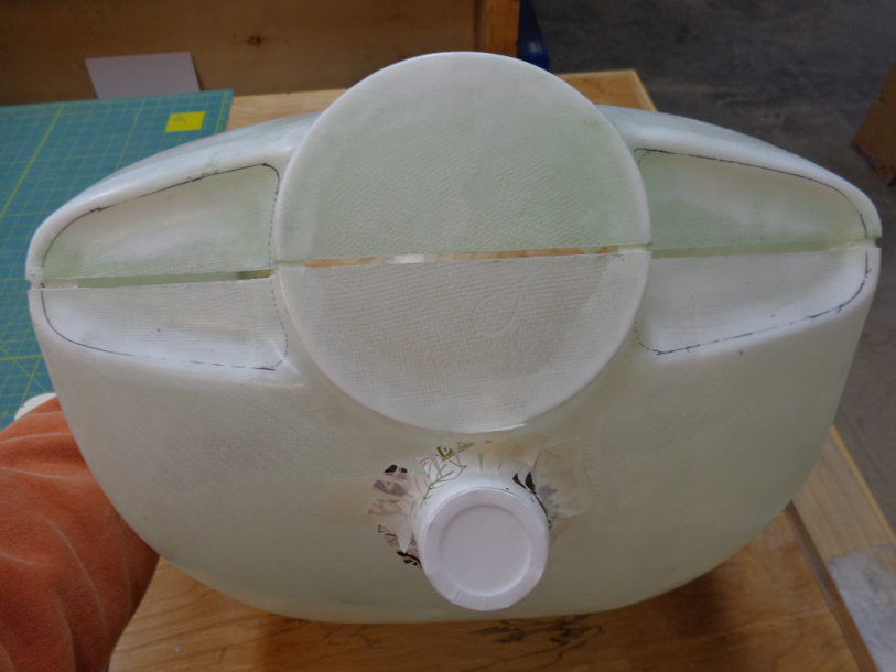

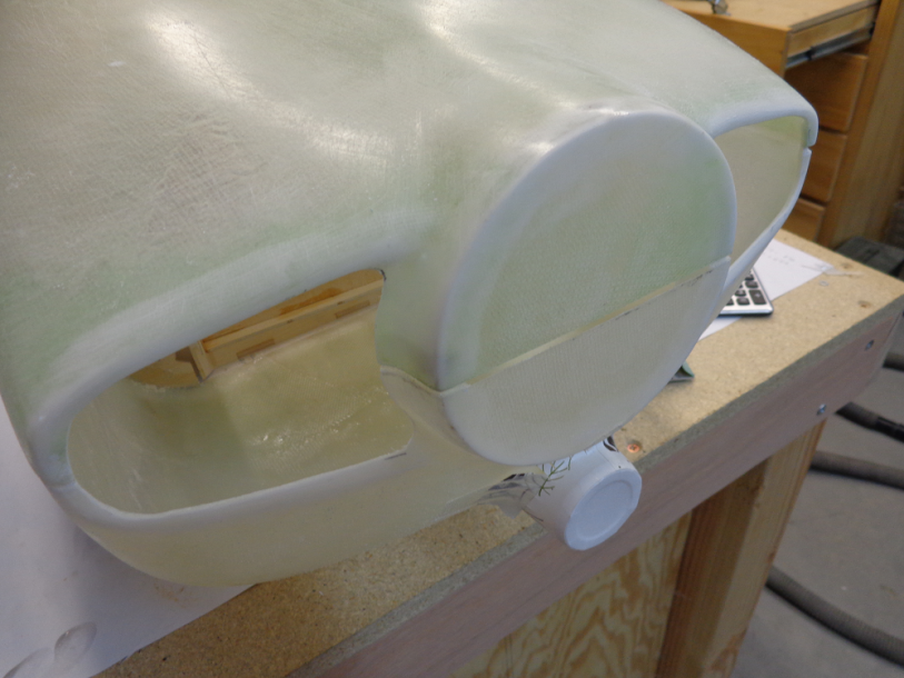

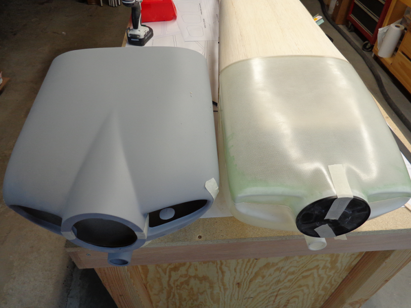

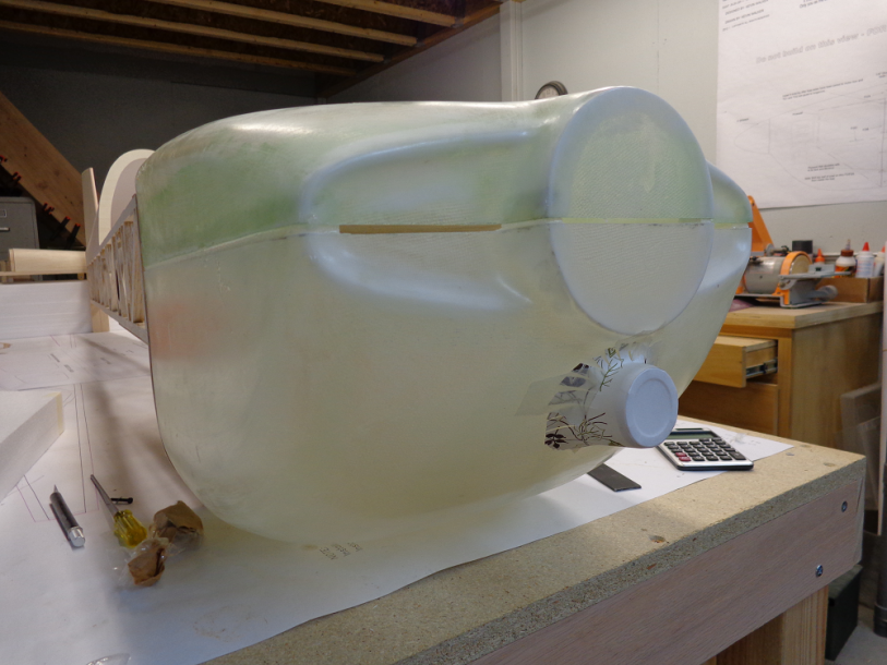

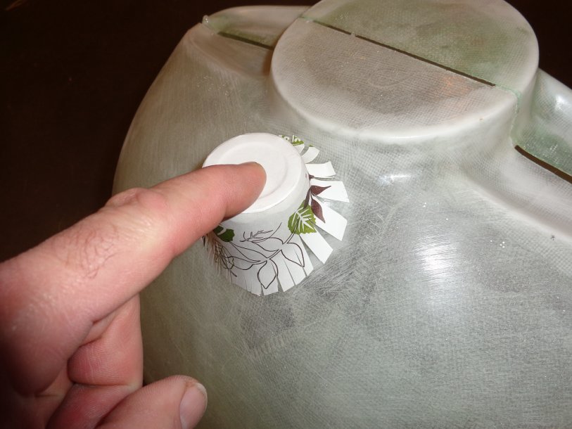

Ok it’s time to start on inlet mods. I took a piece of paper to lie over the cowl inlet and rubbed a pencil over it to shadow the shape. Then I marked another line on the inside for the cut line. I used this as a pattern to cut the ply. Ply is just a firmer pattern to use. Used the ply pattern and traced the cut line on the inlets. The dremel tool cuts the fiberglass like butter.
