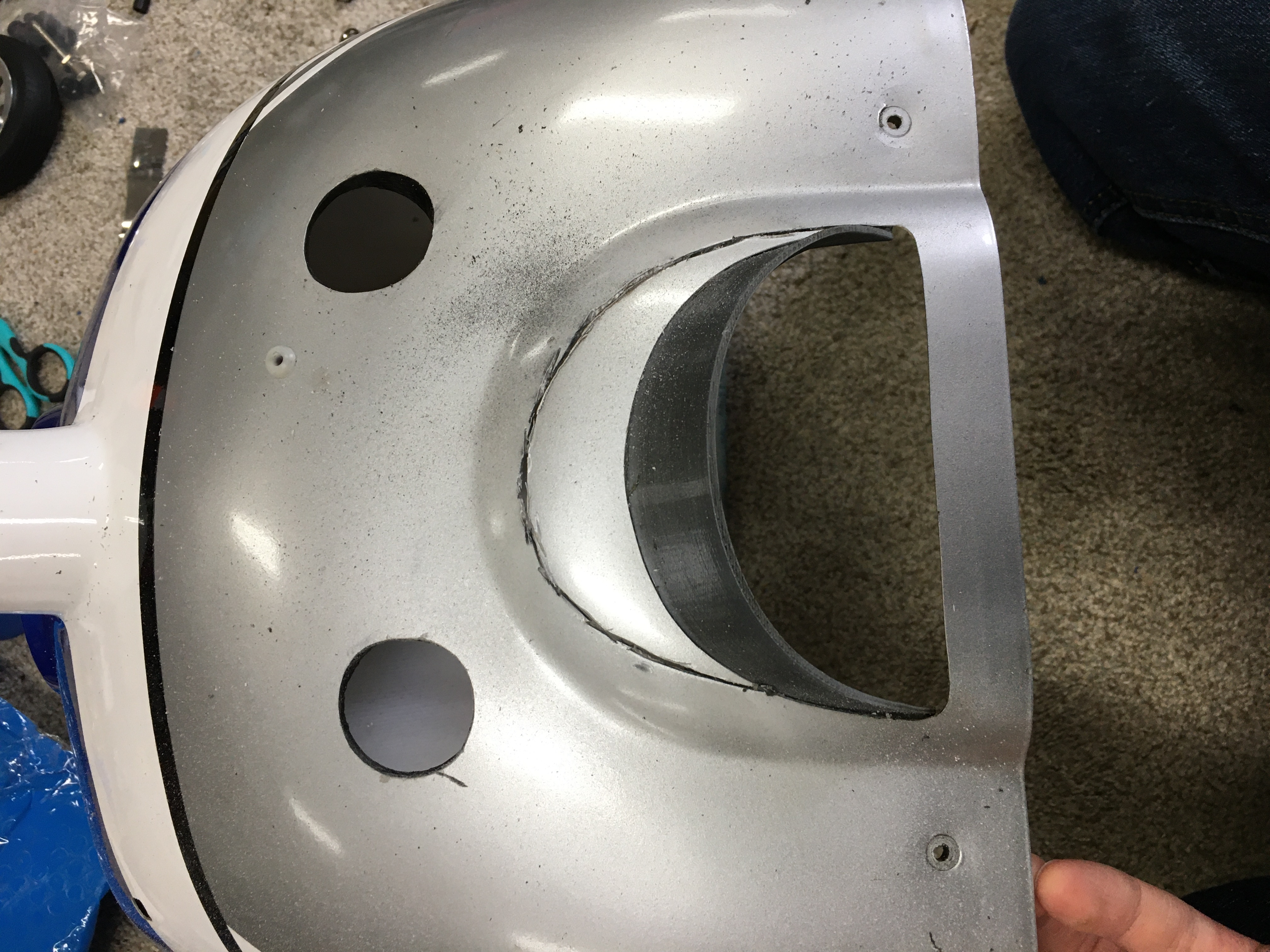

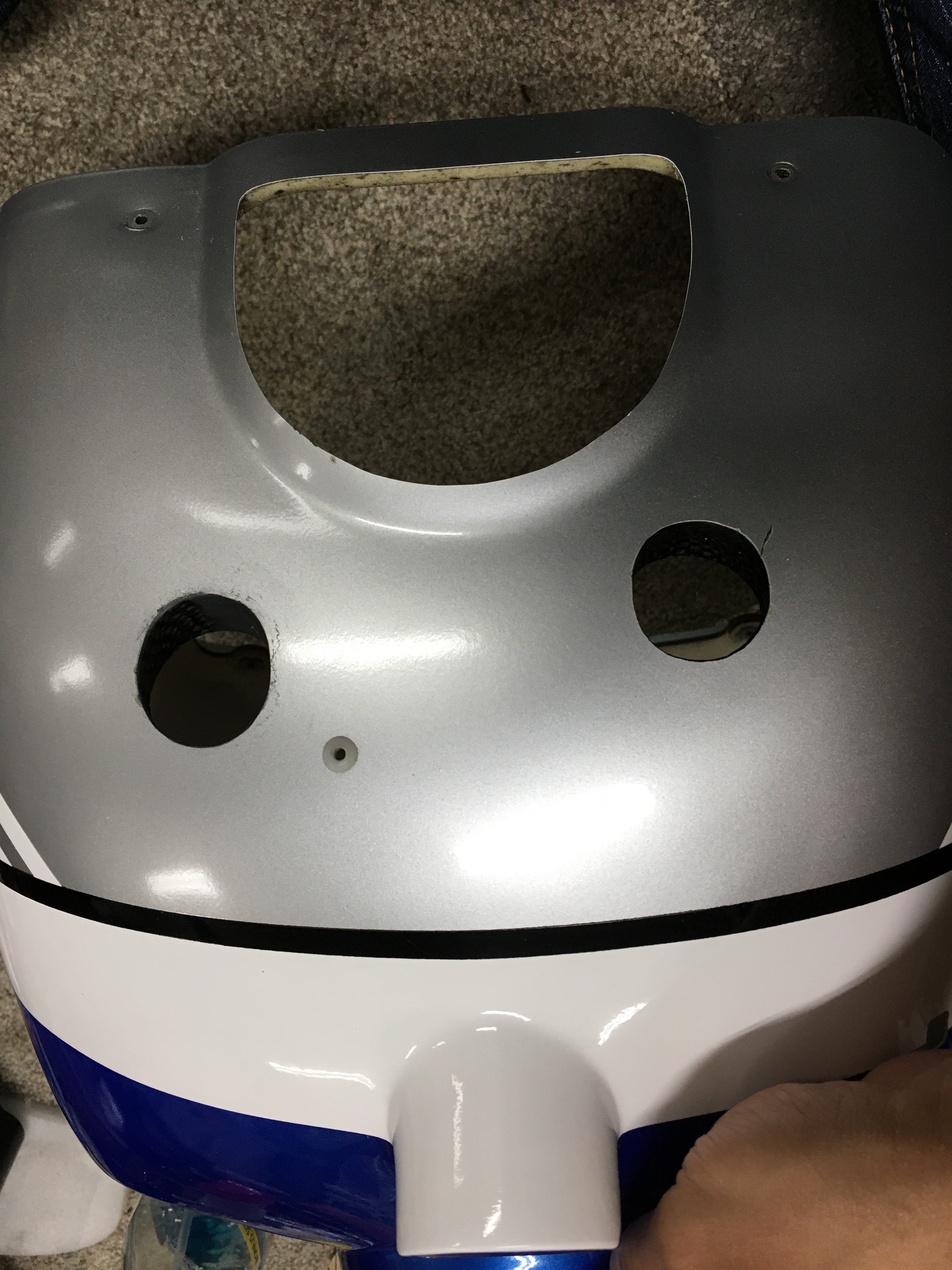

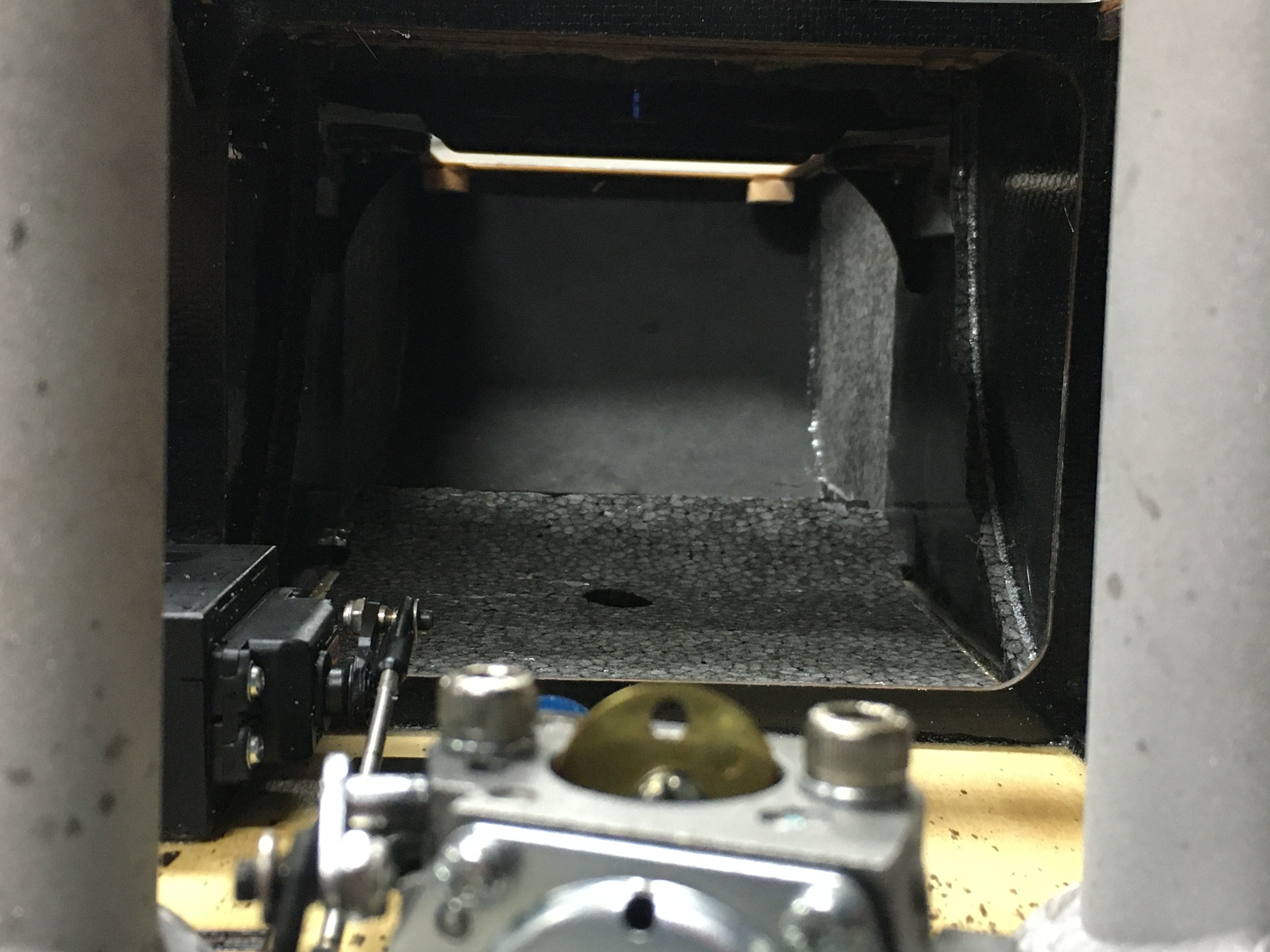

Decided to open up the cowl more. Basically removed the air dam, and using the slight incorporated ramp that is built into the cowl already. I’ll probably get some exhaust gunk inside the plane but I had already cured the inside with thinned epoxy, hopefully it won’t get too nasty.
I really think I’m not getting enough air out. So this seems logical.

AKNick

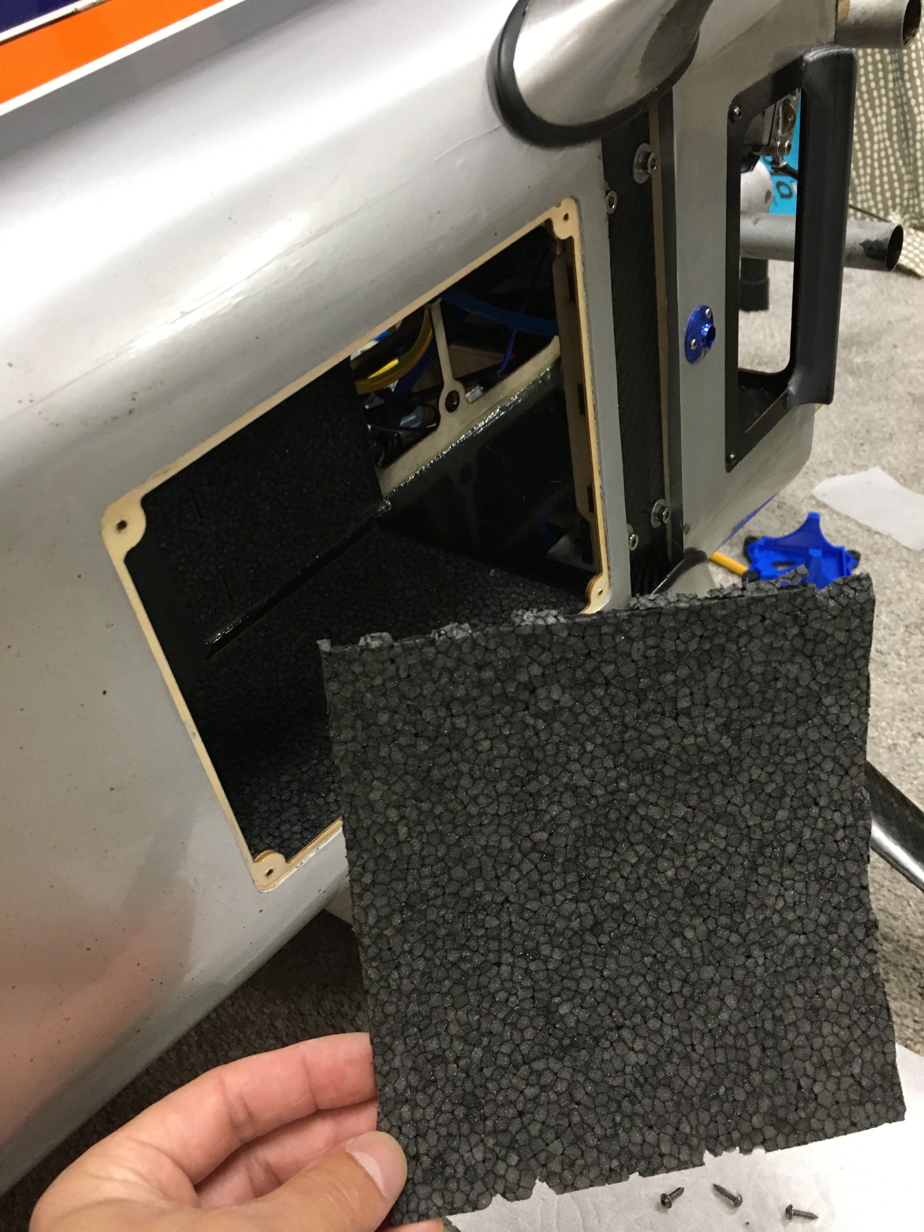

Skywing origional lt had this foam baffle directing the air out prior to the tunnel and the forward floor exposed.

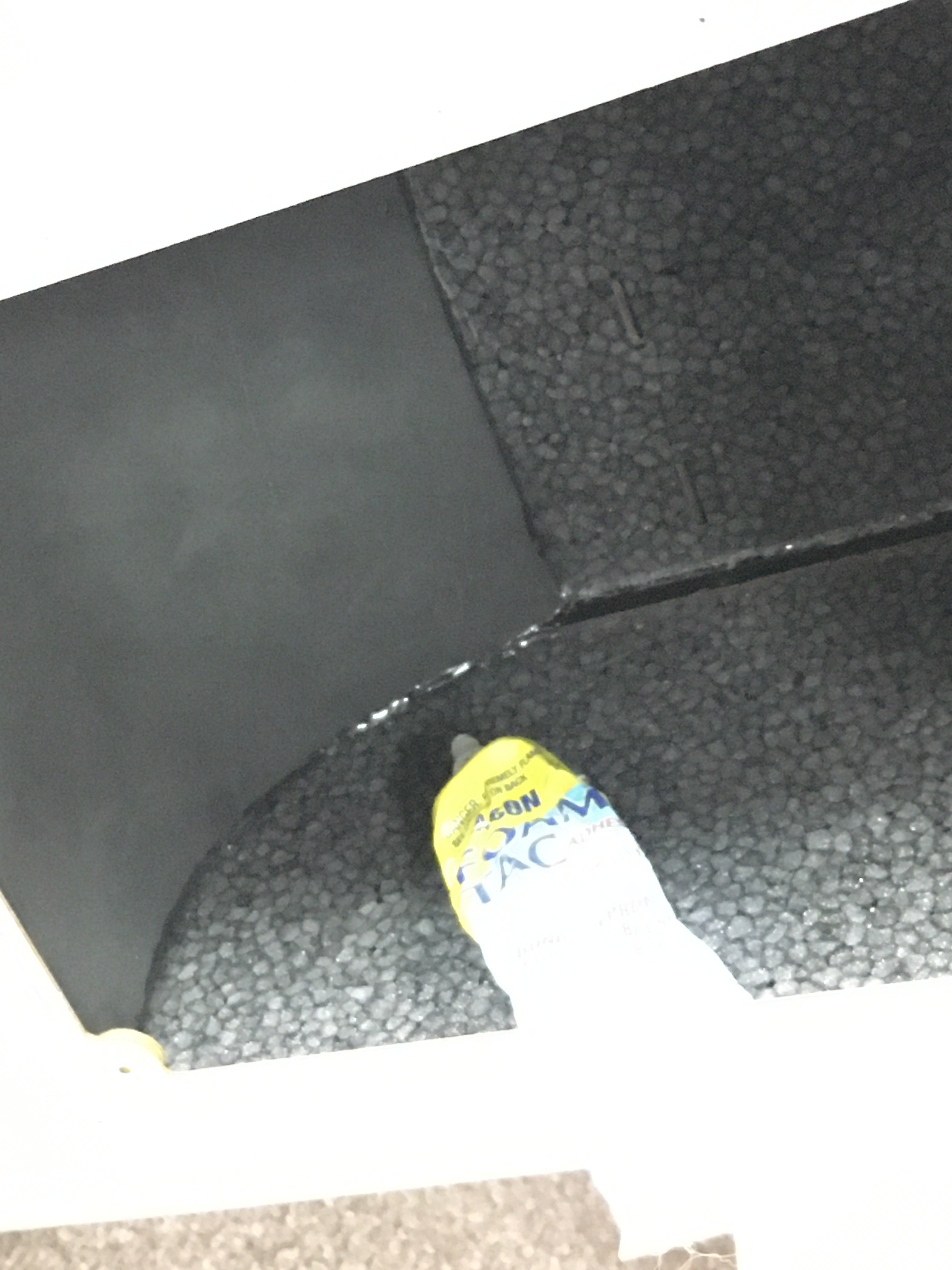

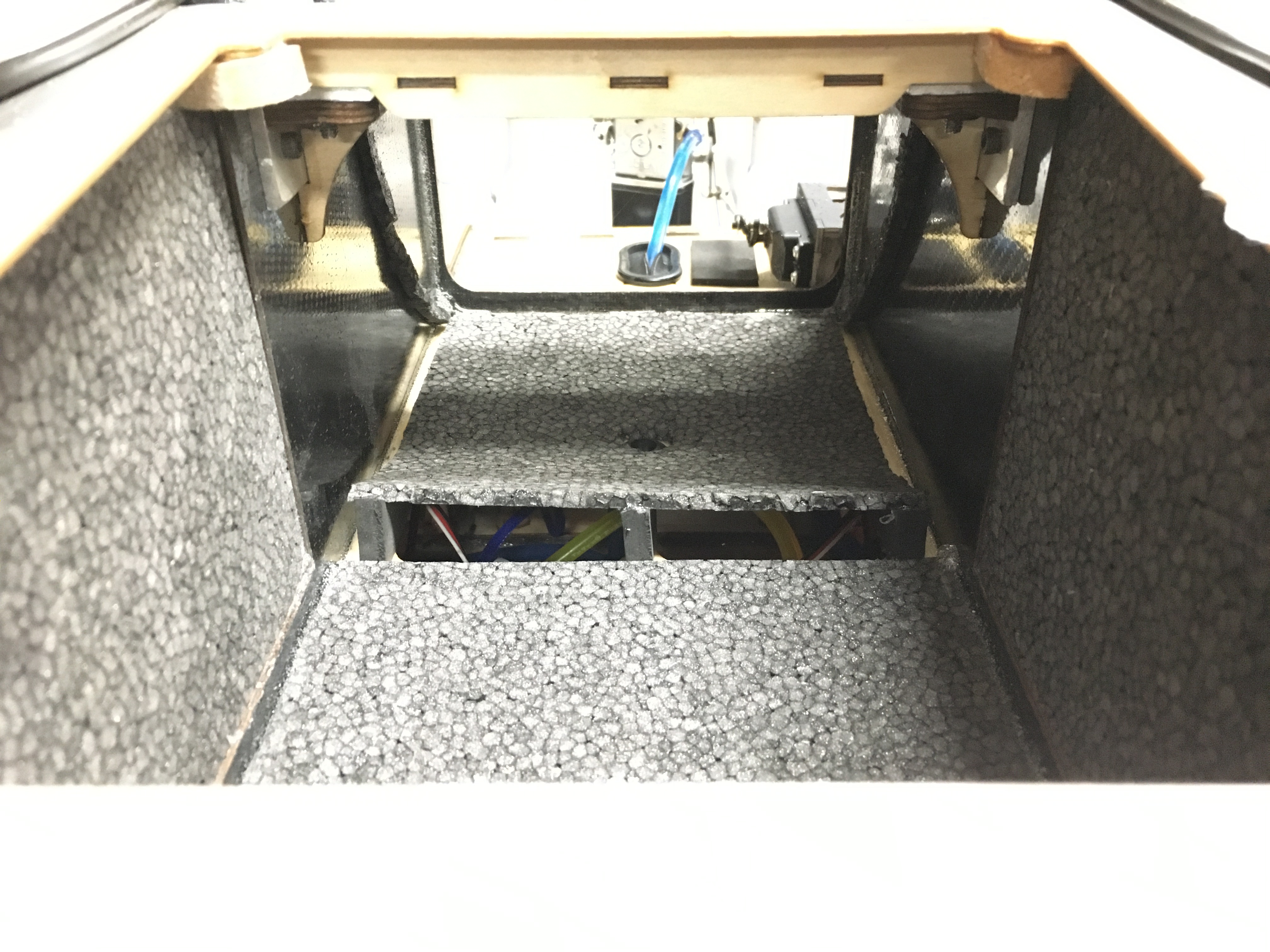

I removed the OEM air deflector and put it on the floor with a little ramp/air dam to let some airflow from the cabin into the tunnel. I then got some foam and made another air deflector out the mid section of the tunnel.

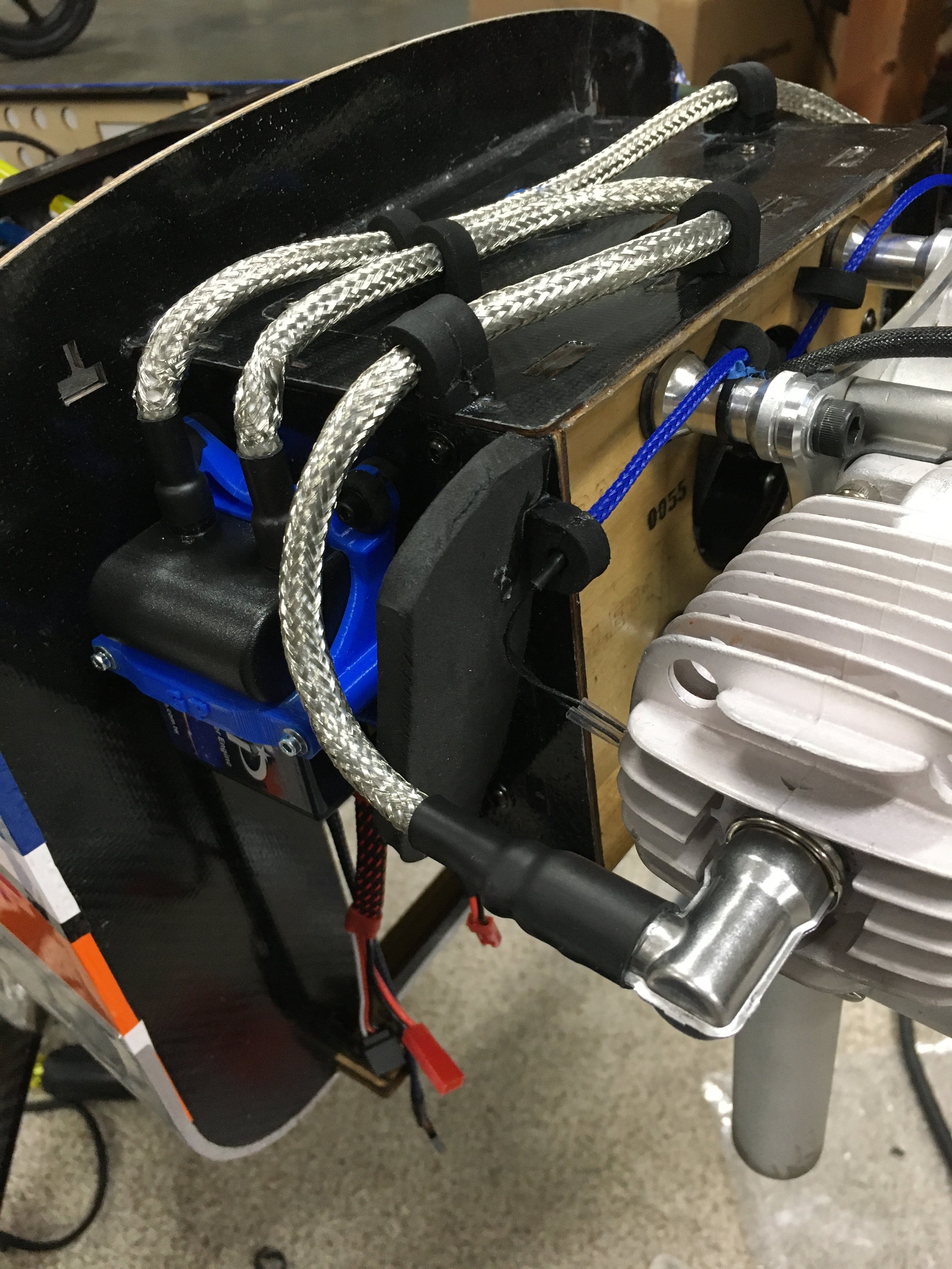

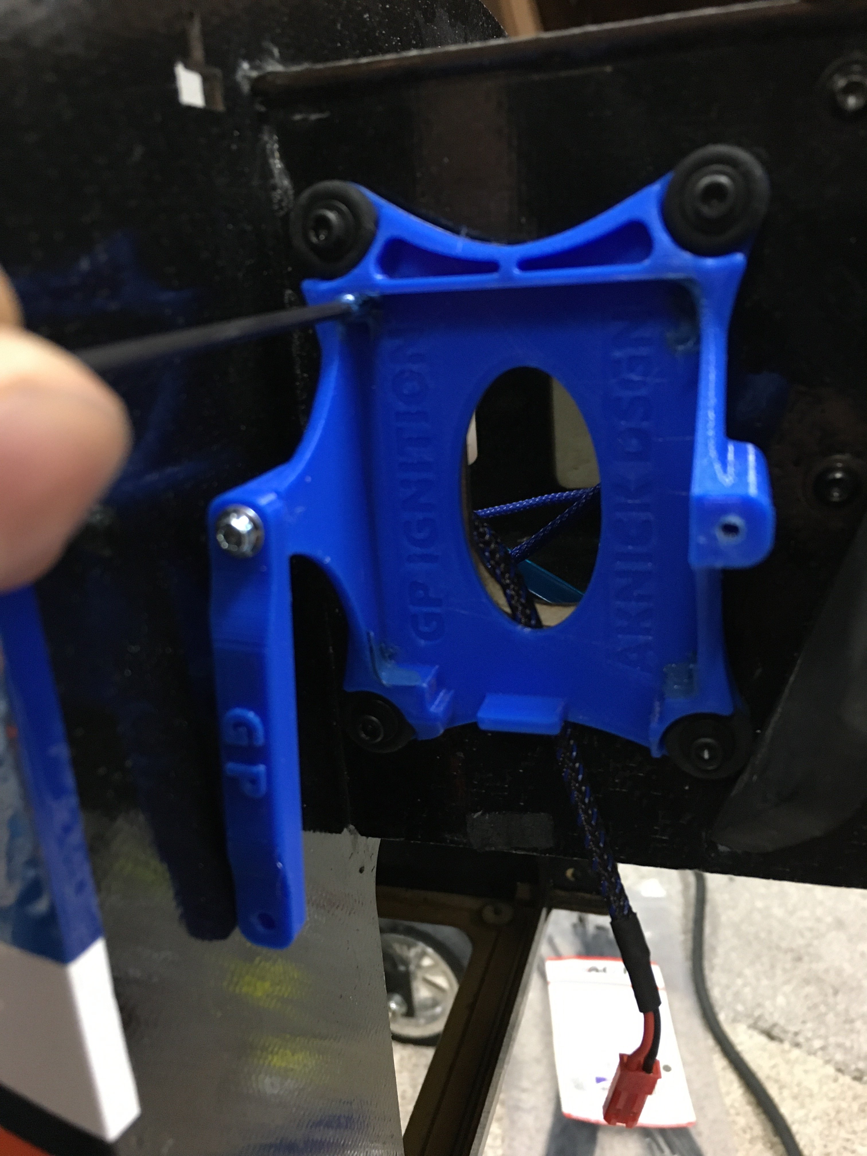

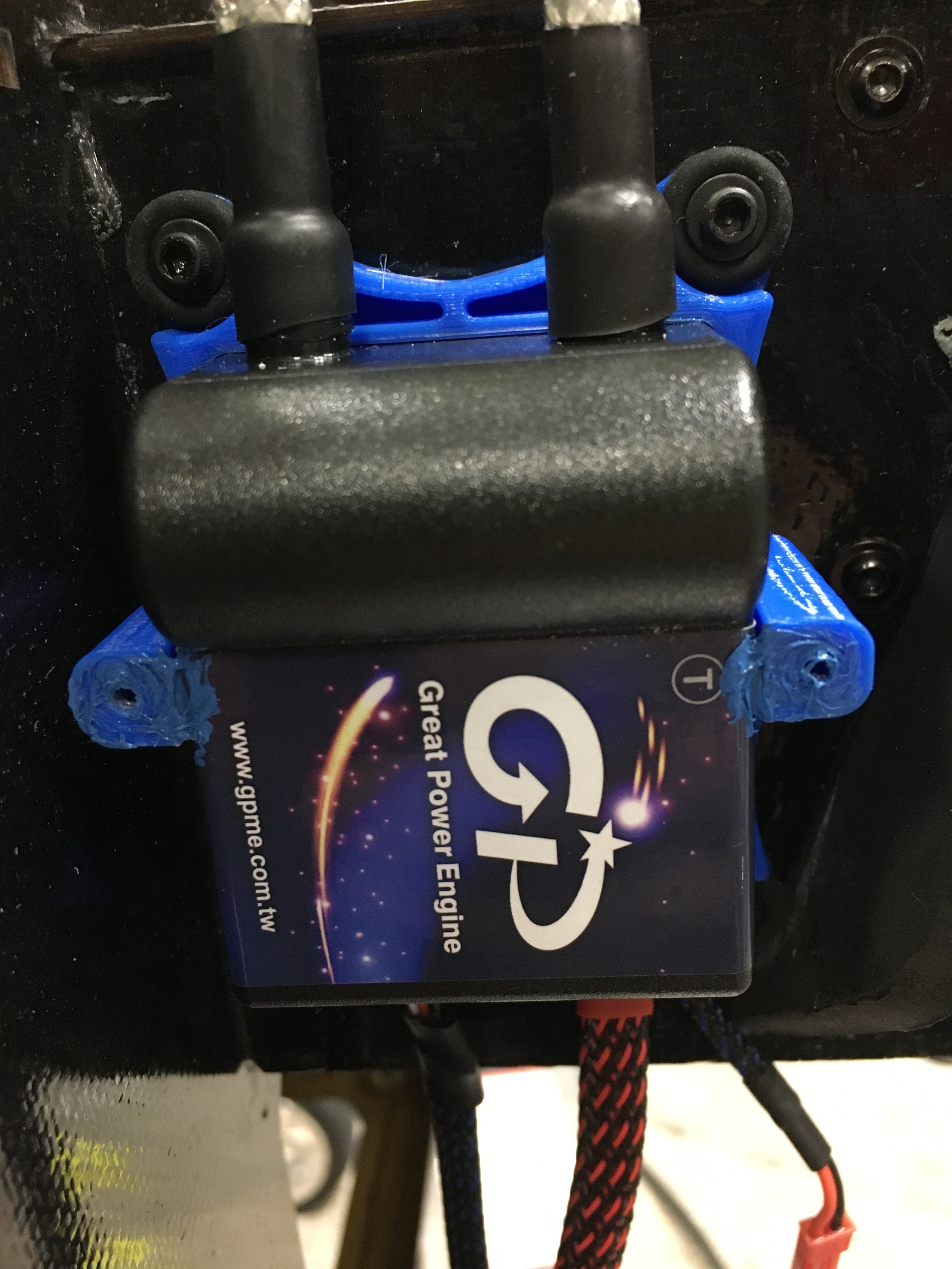

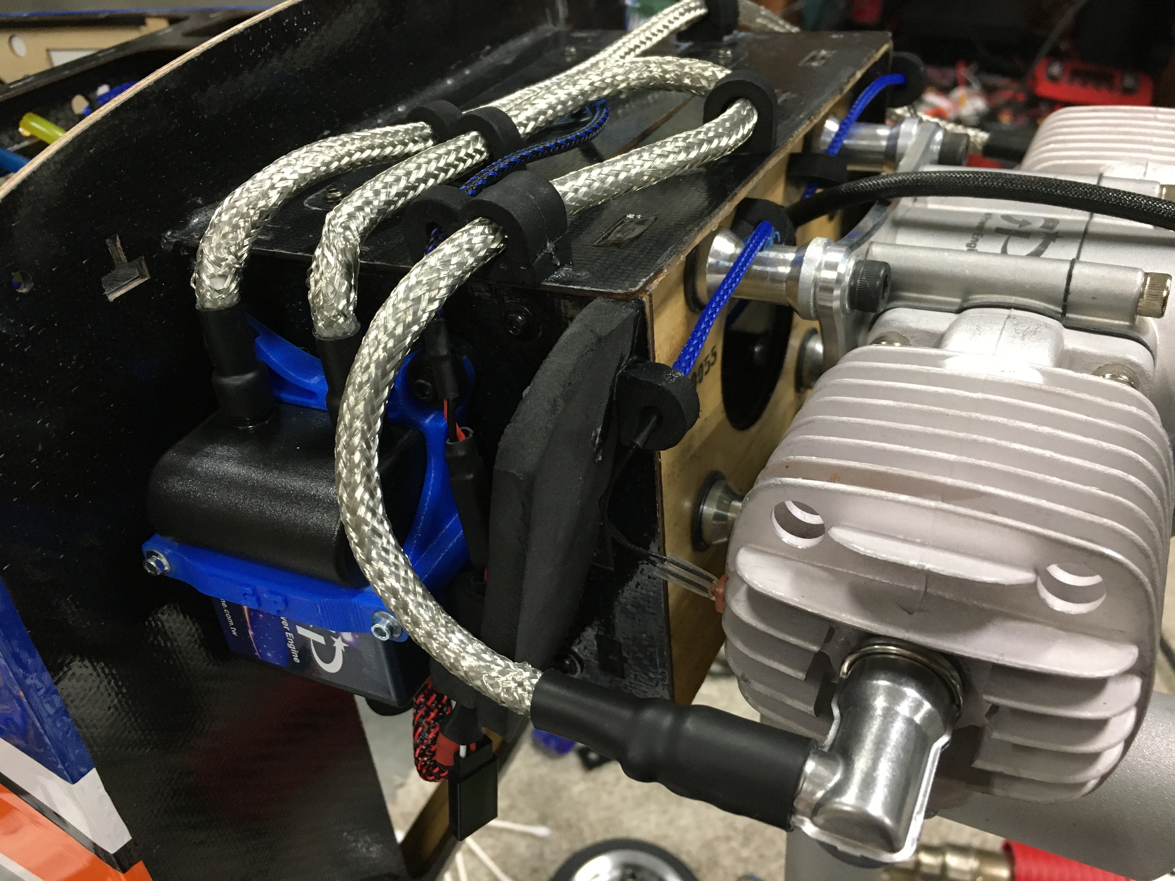

AKNick

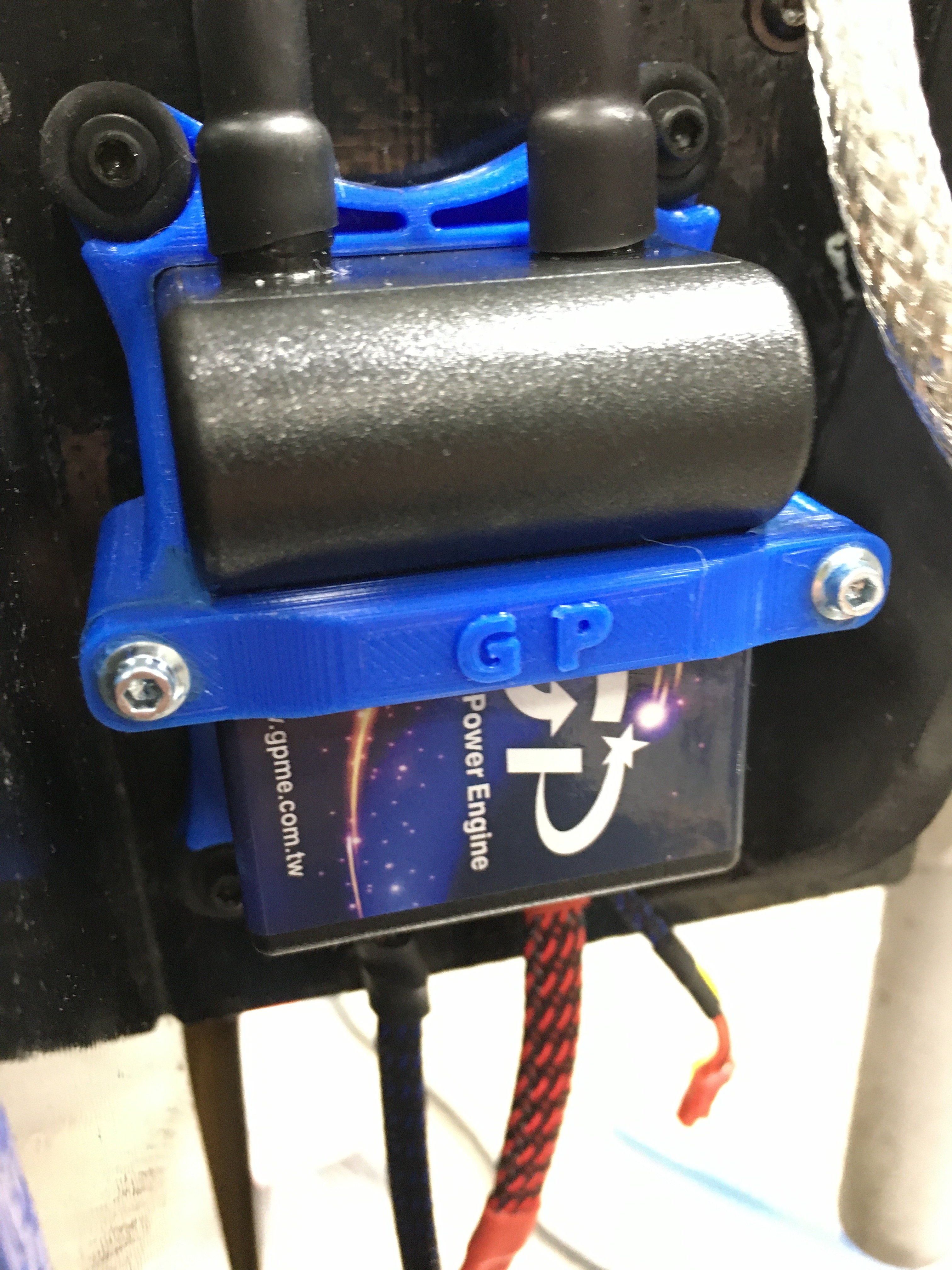

Finalized my new GP ignition holder mount and mounted with with a new ignition on the ARS. Not sure about you guys but I can look at wire routing for hours until I’m satisfied with the organization. No chafing, straining, or loose wires here. Even made a hot air deflector so it doesn't come hot off the cylinder directly into the ignition.
