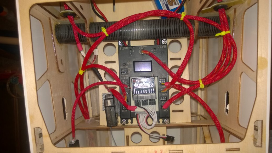

Wiring done.
Jeti spark protector installed.

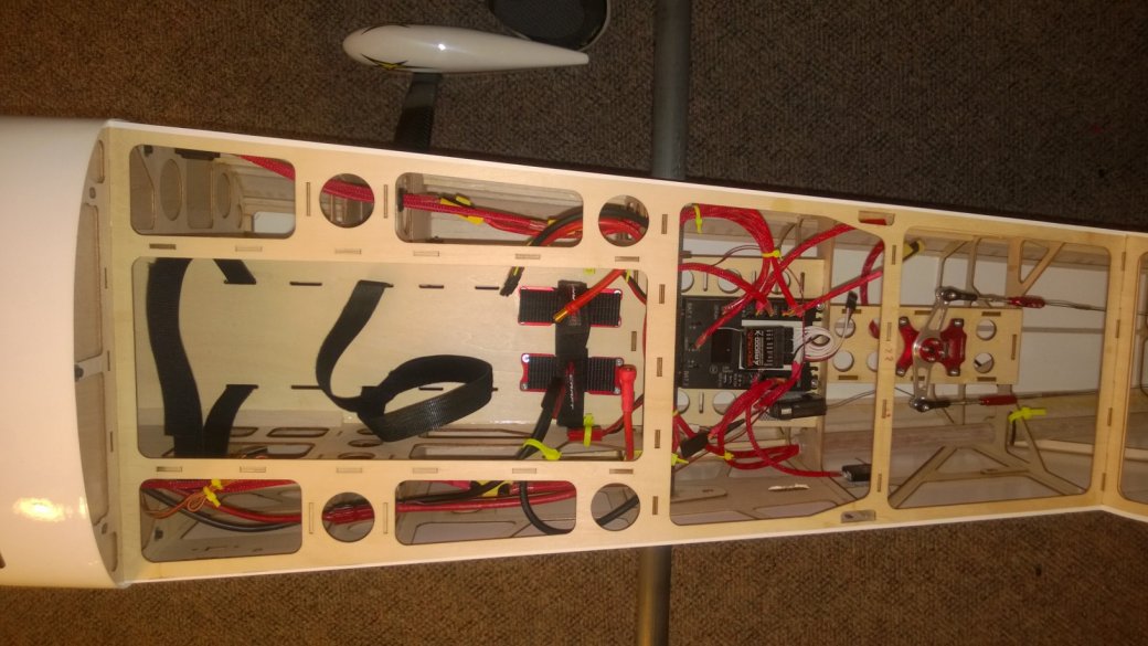

Interior complete.

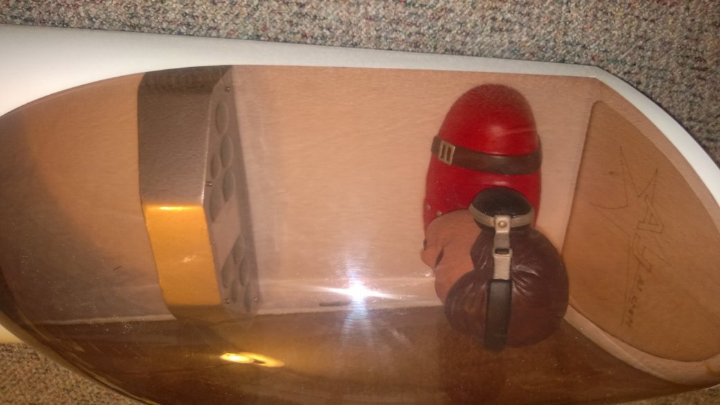

Pilot ready for inverted passes!
