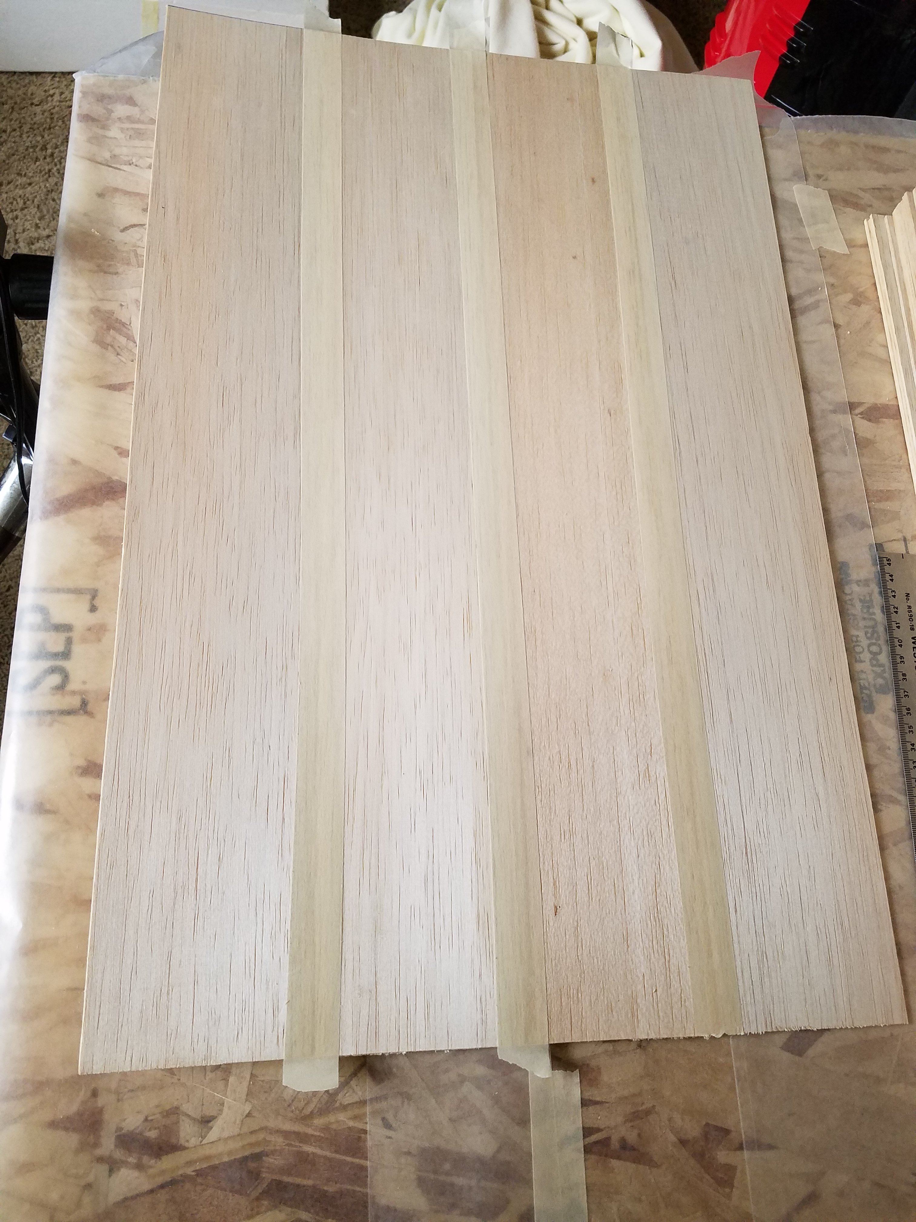

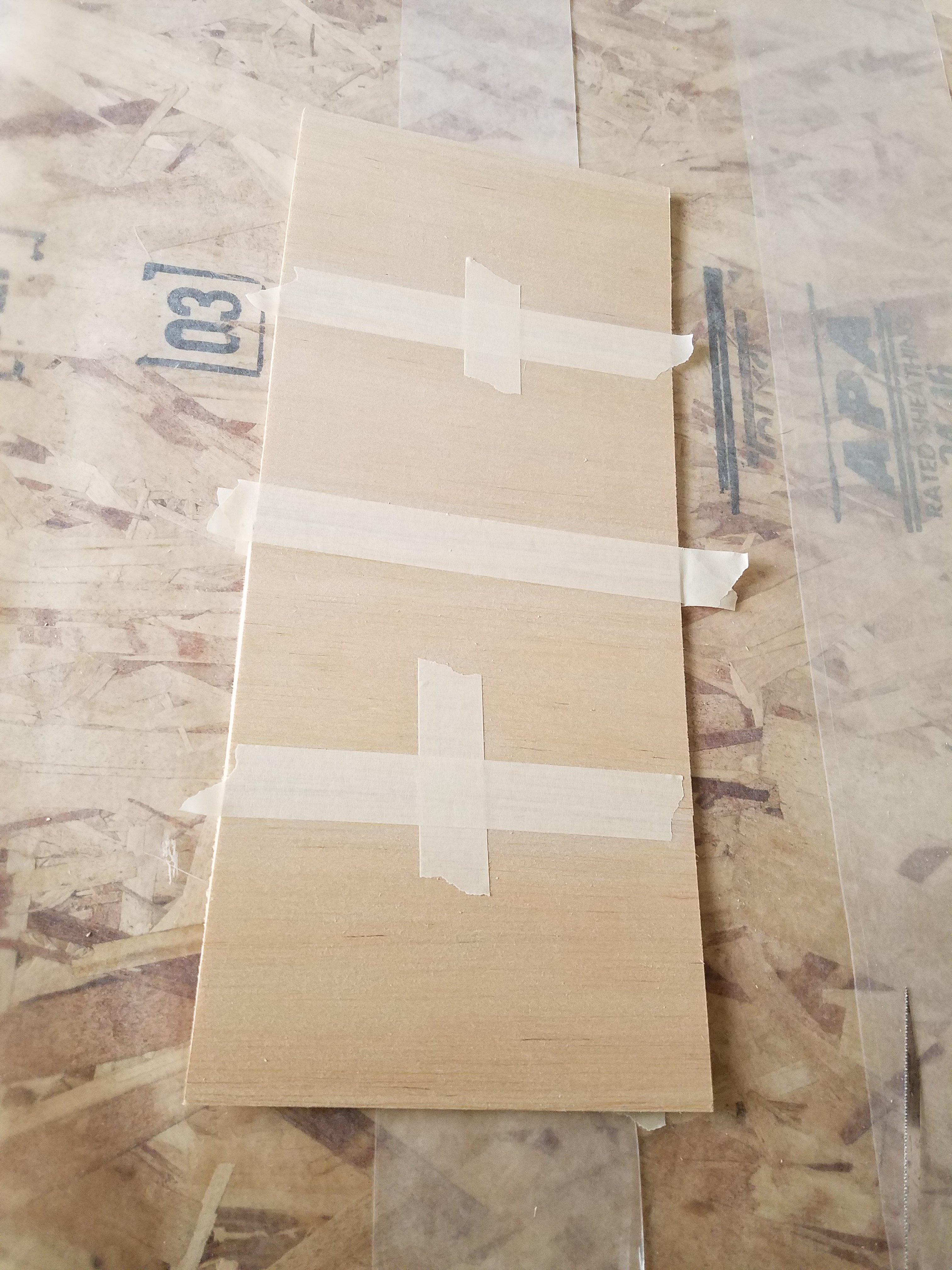

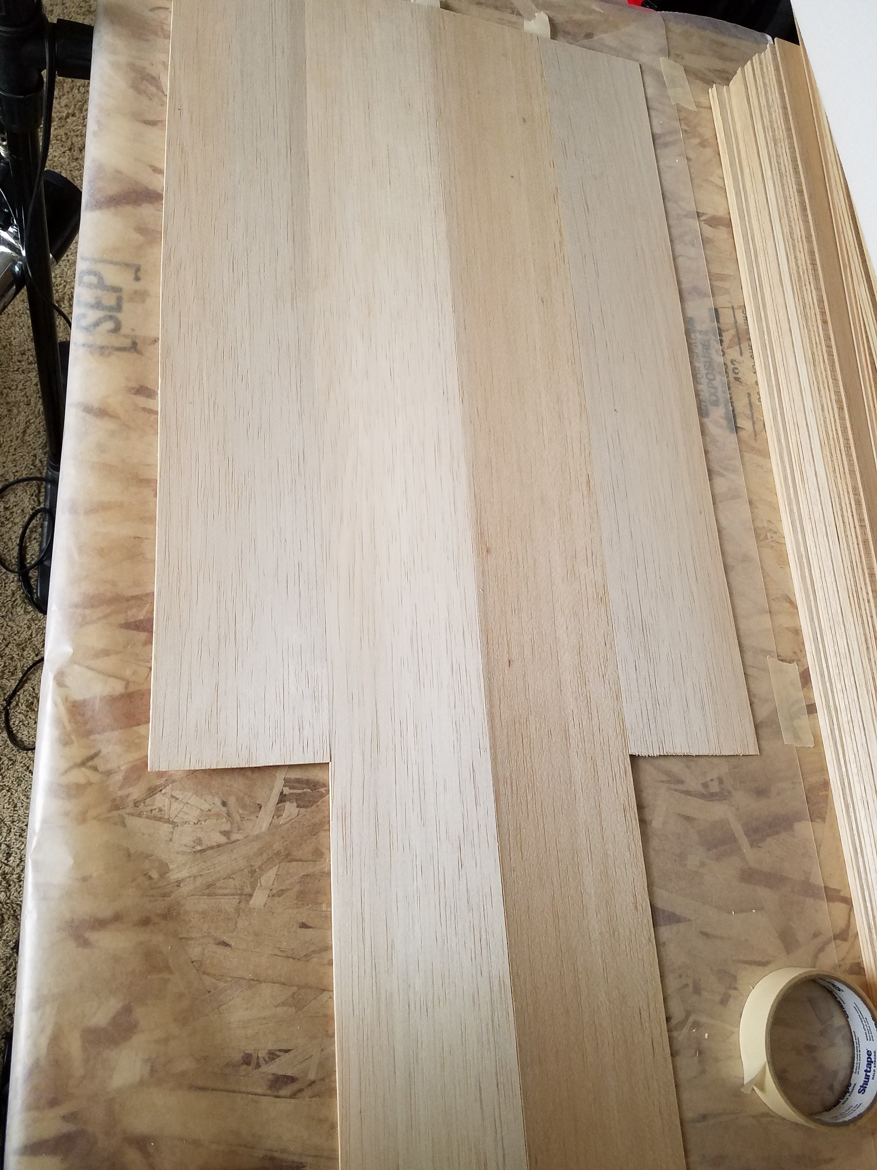

So just a minor update on the Velox build. I did get skins for the turtle deck and forward hatch made up.

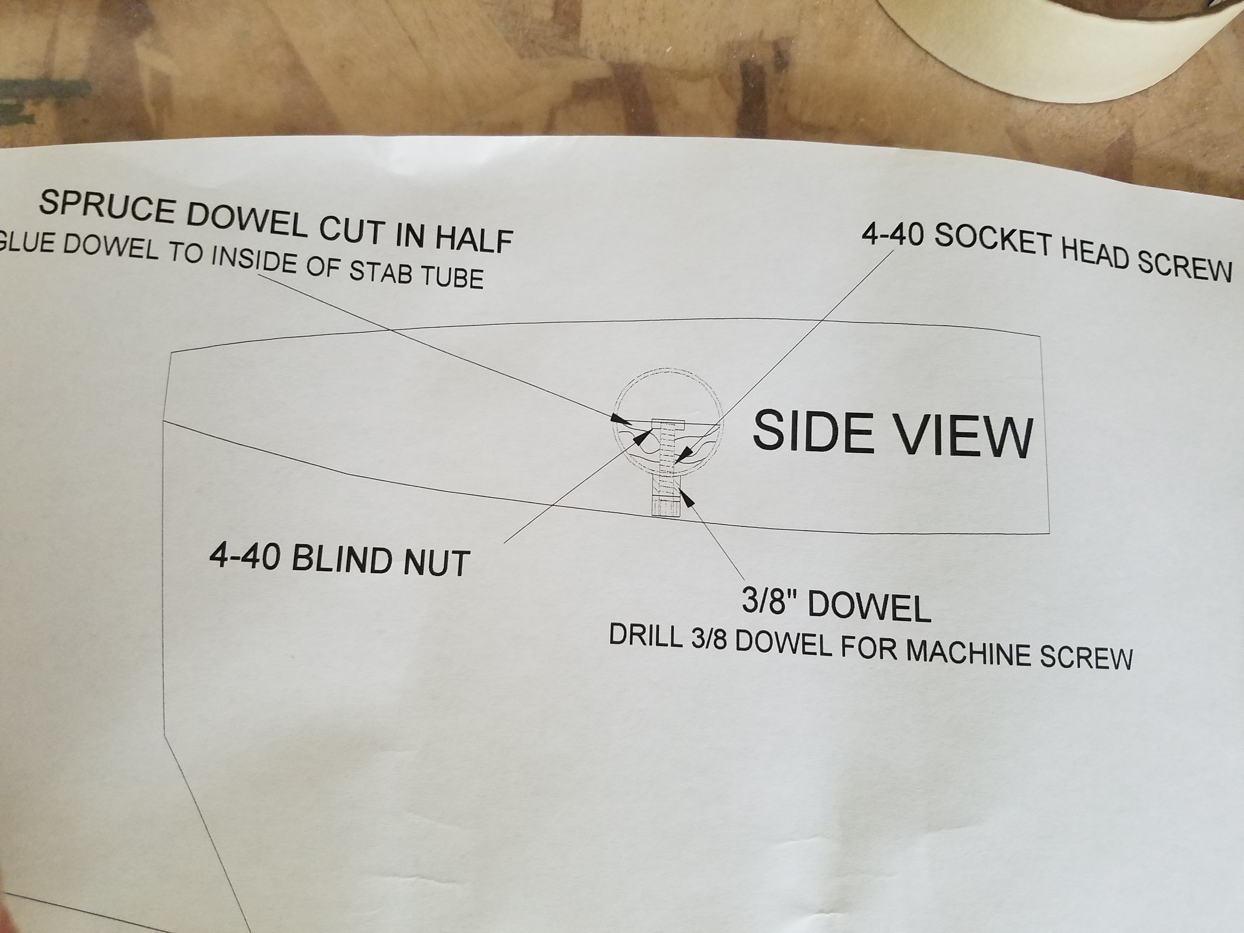

I have the skins now placed in the foam cores with weights on them until the glue cures. In the meantime, I looked over the plans and the fuse. I really don't like the stab attachment method so I will be updating the design to more current technics.
I just don't like this design.

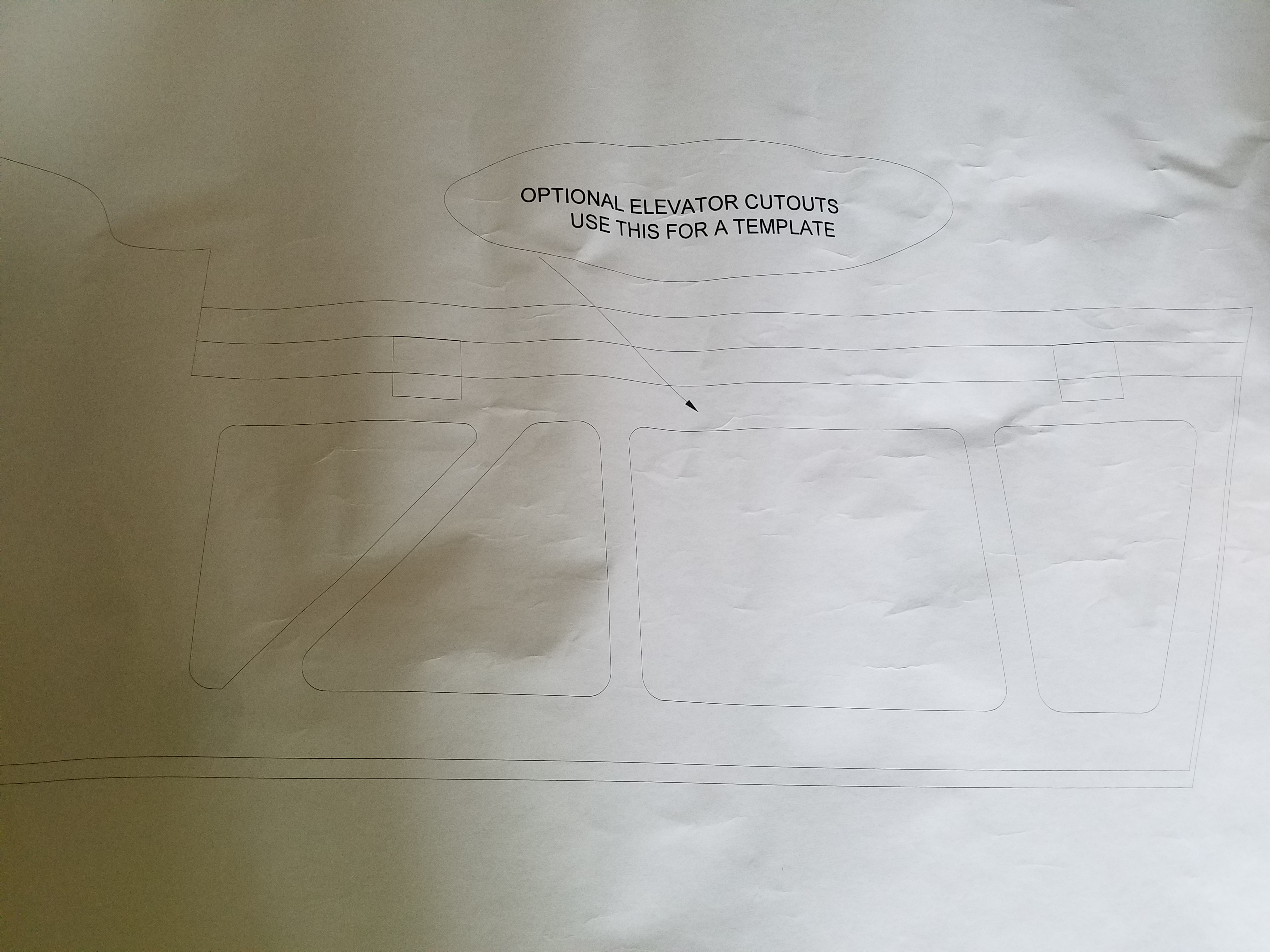

I've also decided to use the template offered on the plans to lighten the elevators.
