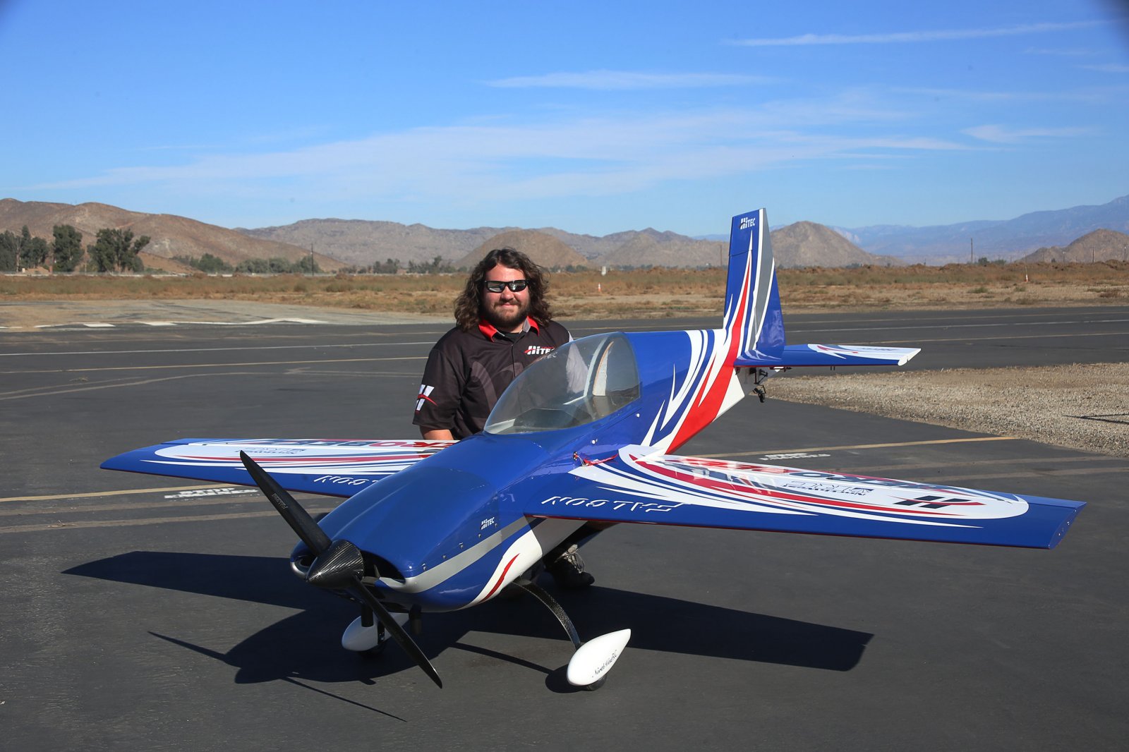

You sure look like a happy camper there!

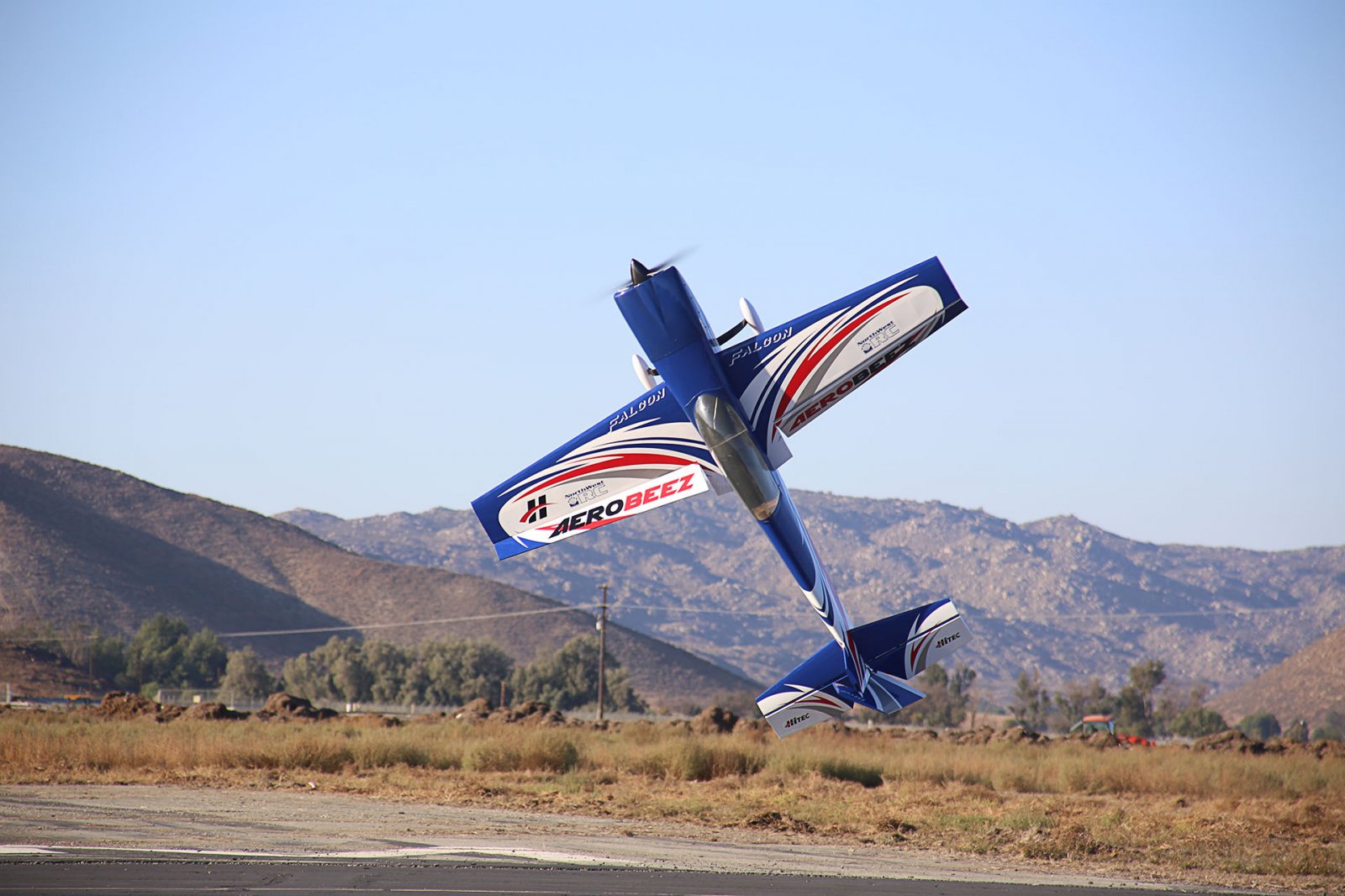

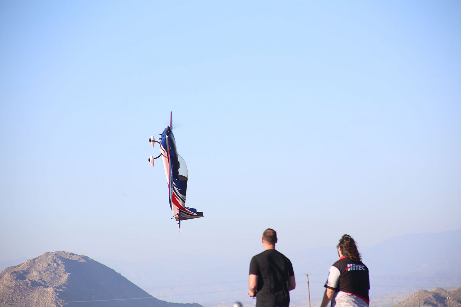

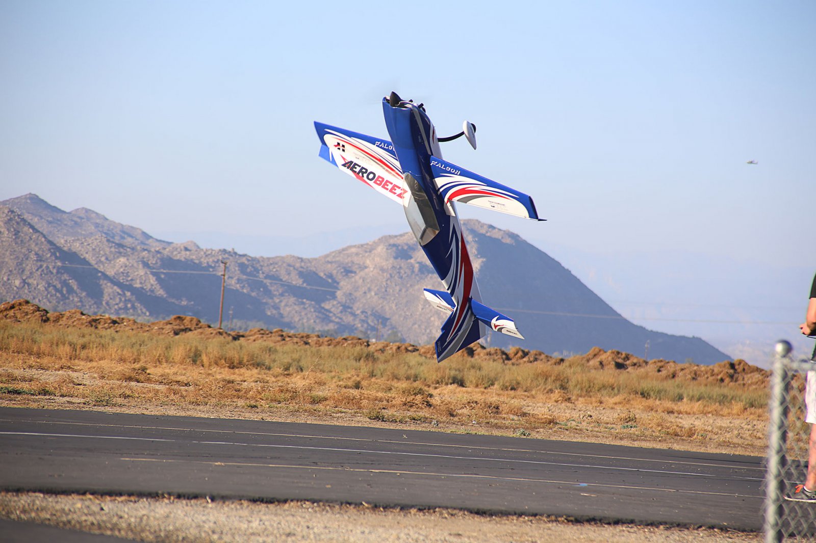

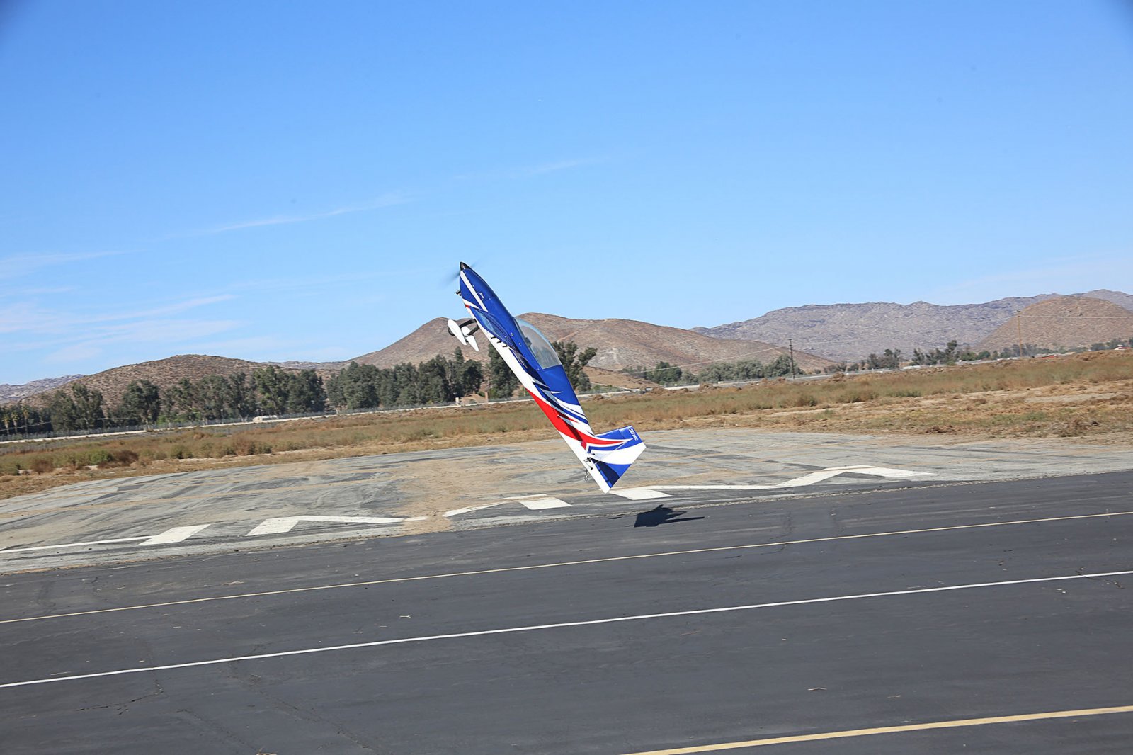

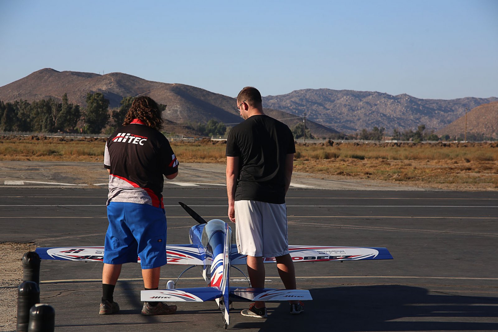

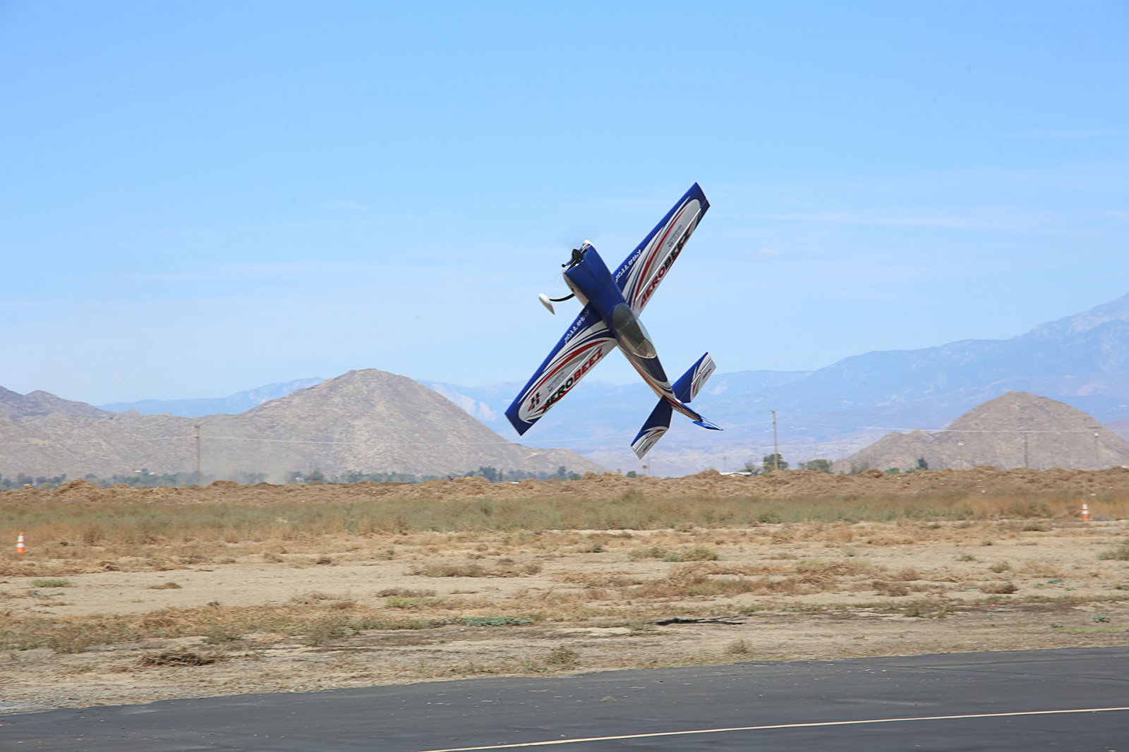

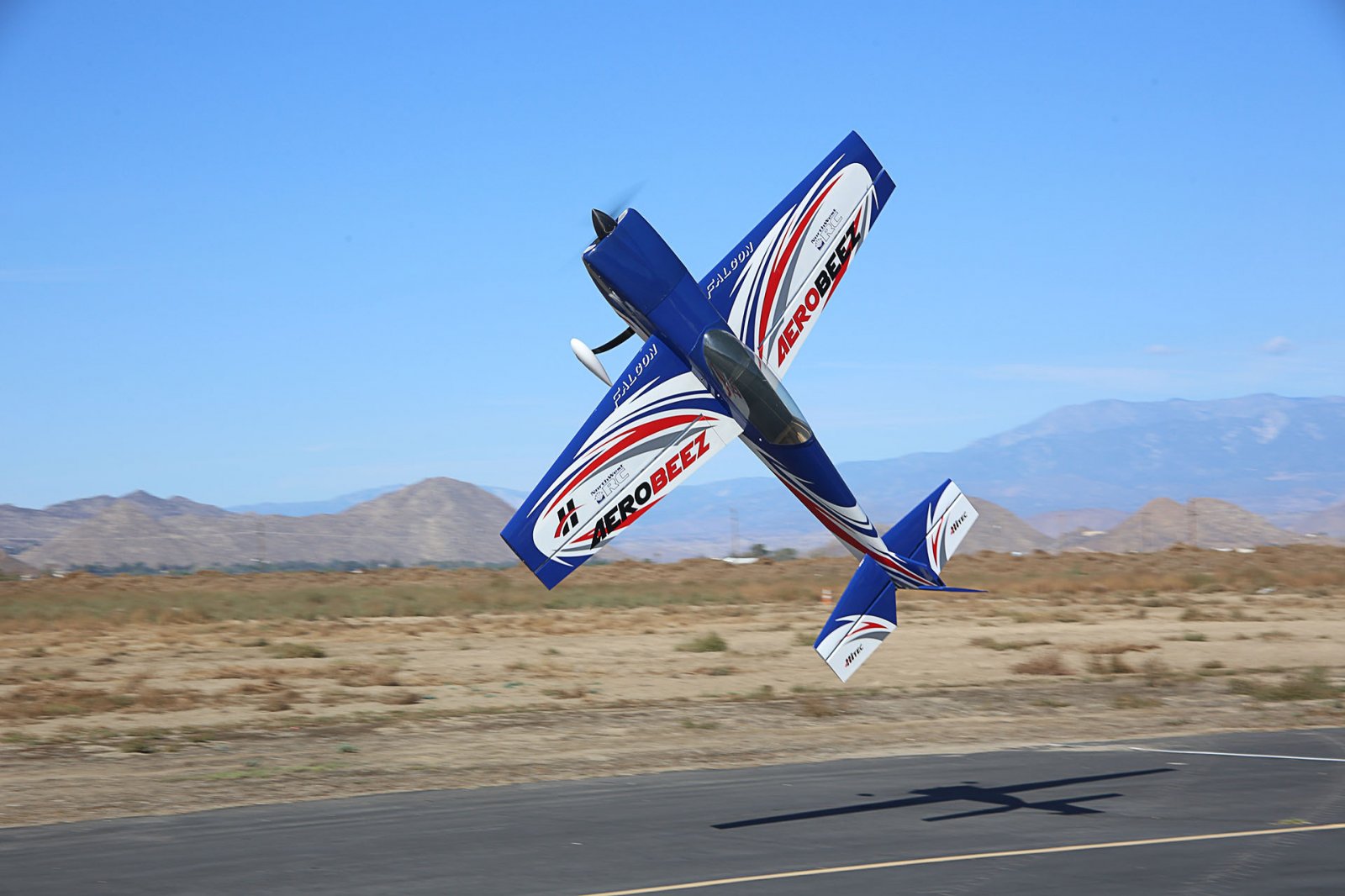

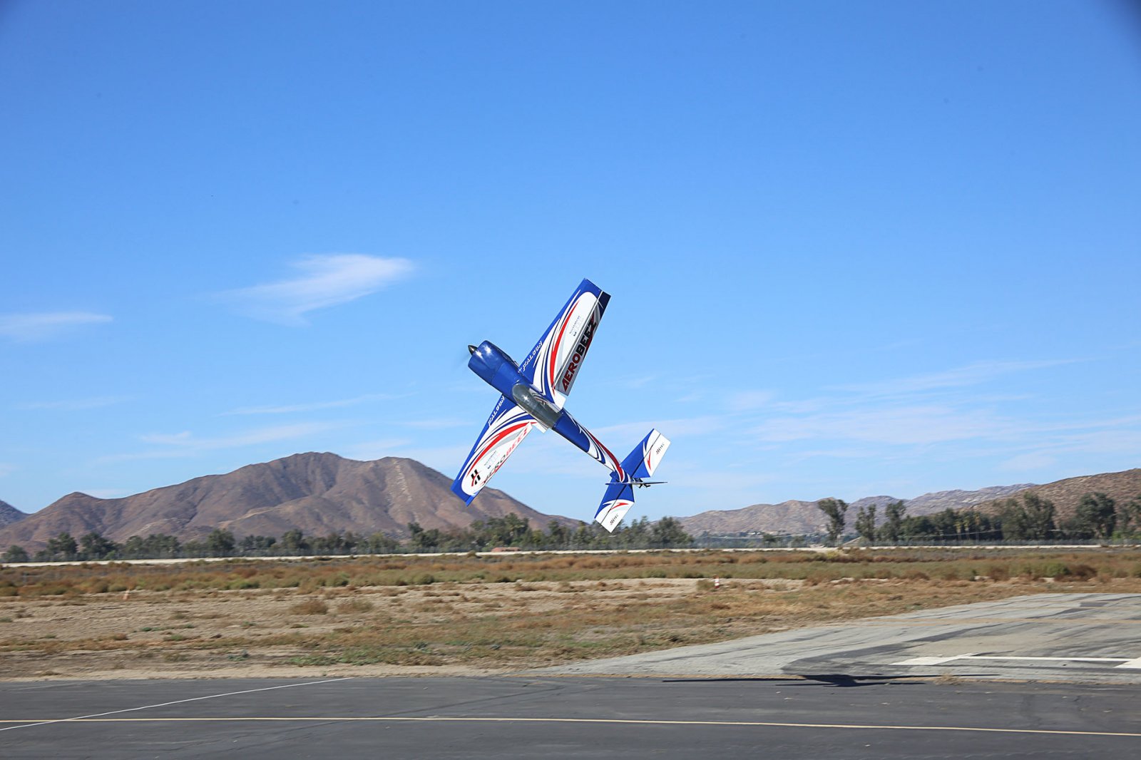

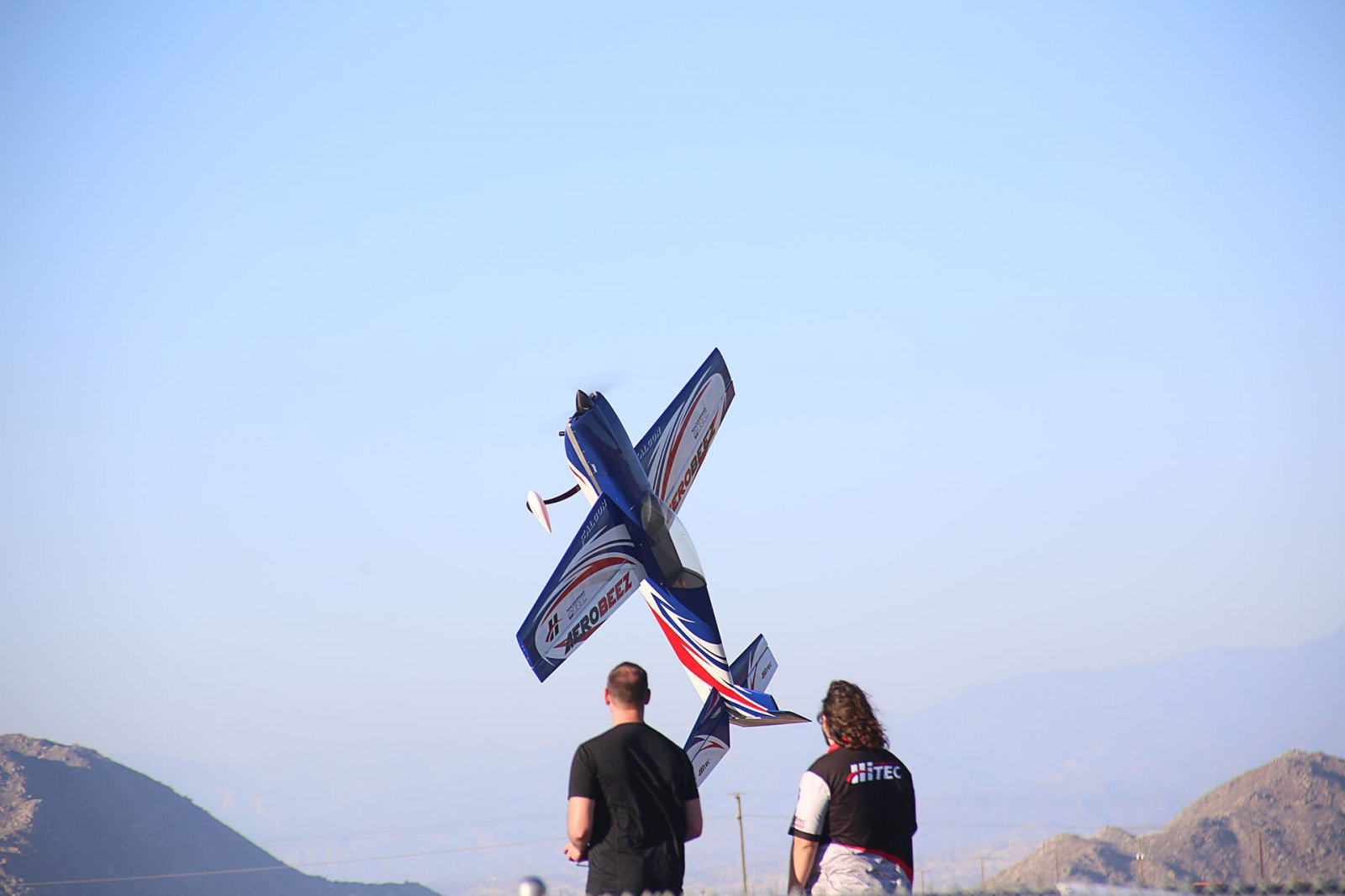

Some pics. Kyle Woyshnis really seemed to enjoy the airplane when I let him tug the sticks :)
I am very much enjoying this airplane, it flies extremely well with the light setup I have in it. I do want to push the CG forward a little, I had to give it down trim to fly straight which is creating some odd coupling on right knife edge. Might get some Pulse batteries for it as well.
In all my years of doing GS, I've only seen one, maybe two instances of people having a legitimate problem with a carbon backplate delaminate from heat. I did not hesitate to bolt one up and use it on the ZDZ. The only problem I've had with the carbon spinner is I needed to trim the prop cutout slightly at the event Friday because it was knocking against the prop.
We forgot the camcorder but there was a professional cameraman on site yesterday filming all the action.
Kyle Woyshnis flew it and seemed to like it a lot. Very predictable and super floaty. I think we're at around 20 flights on the ZDZ180 now, I lost track with all of the flying we did! The needles are still set super rich so I can probably lean it out and get it dialed in now, it was pulling the airplane around as good as the other guys with DA200's on their 40% airplanes, running burbling rich!!
Awesome job! I'm really diggin the scheme on the bottom.
