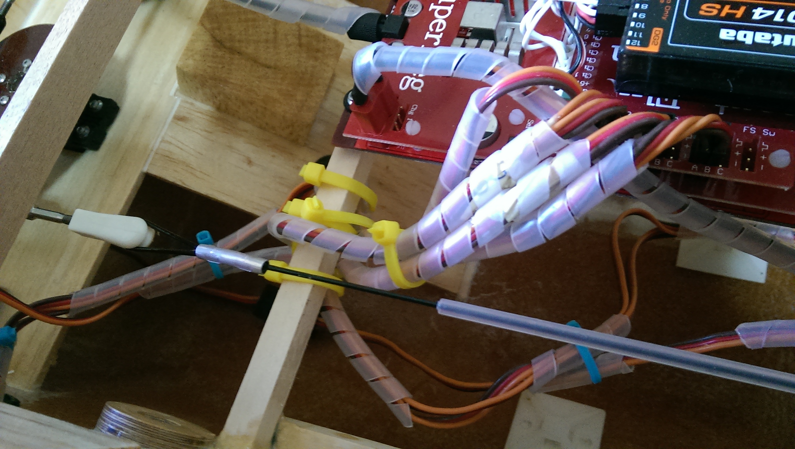

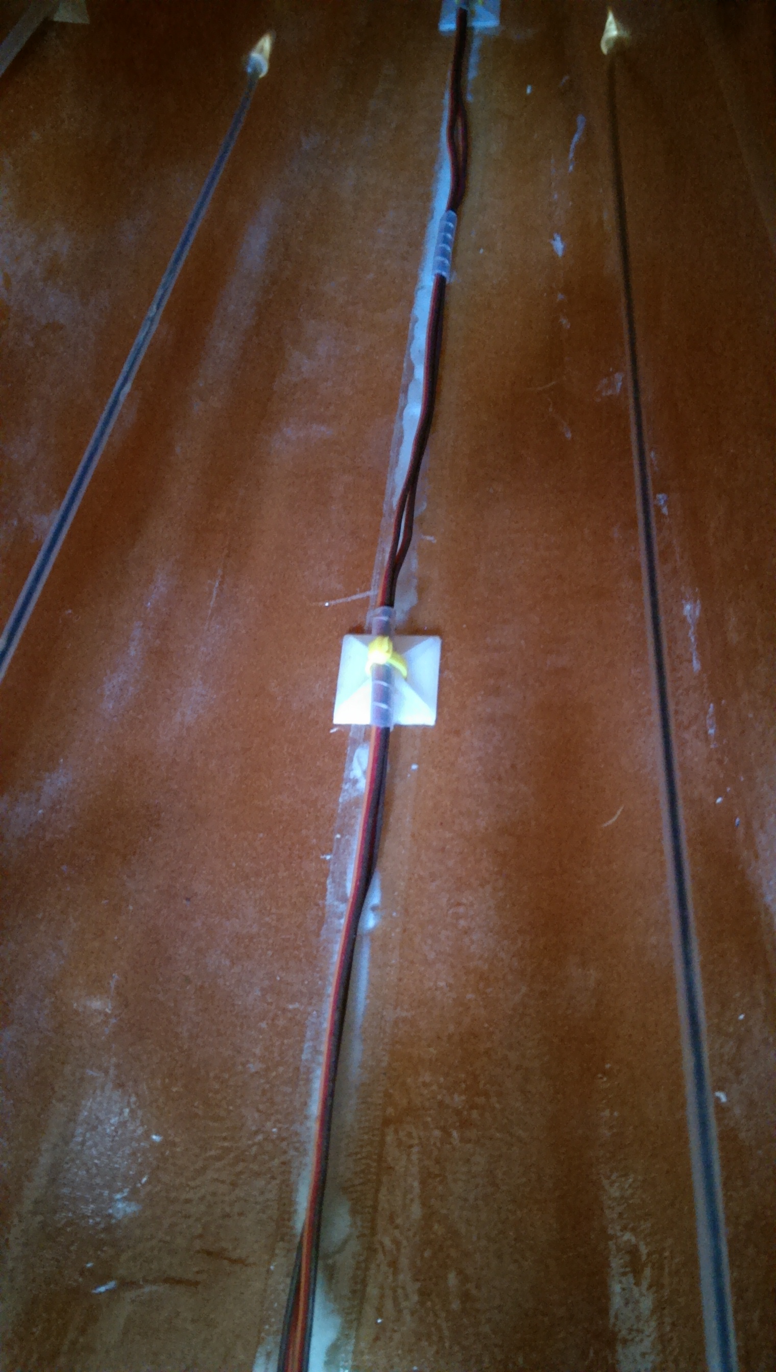

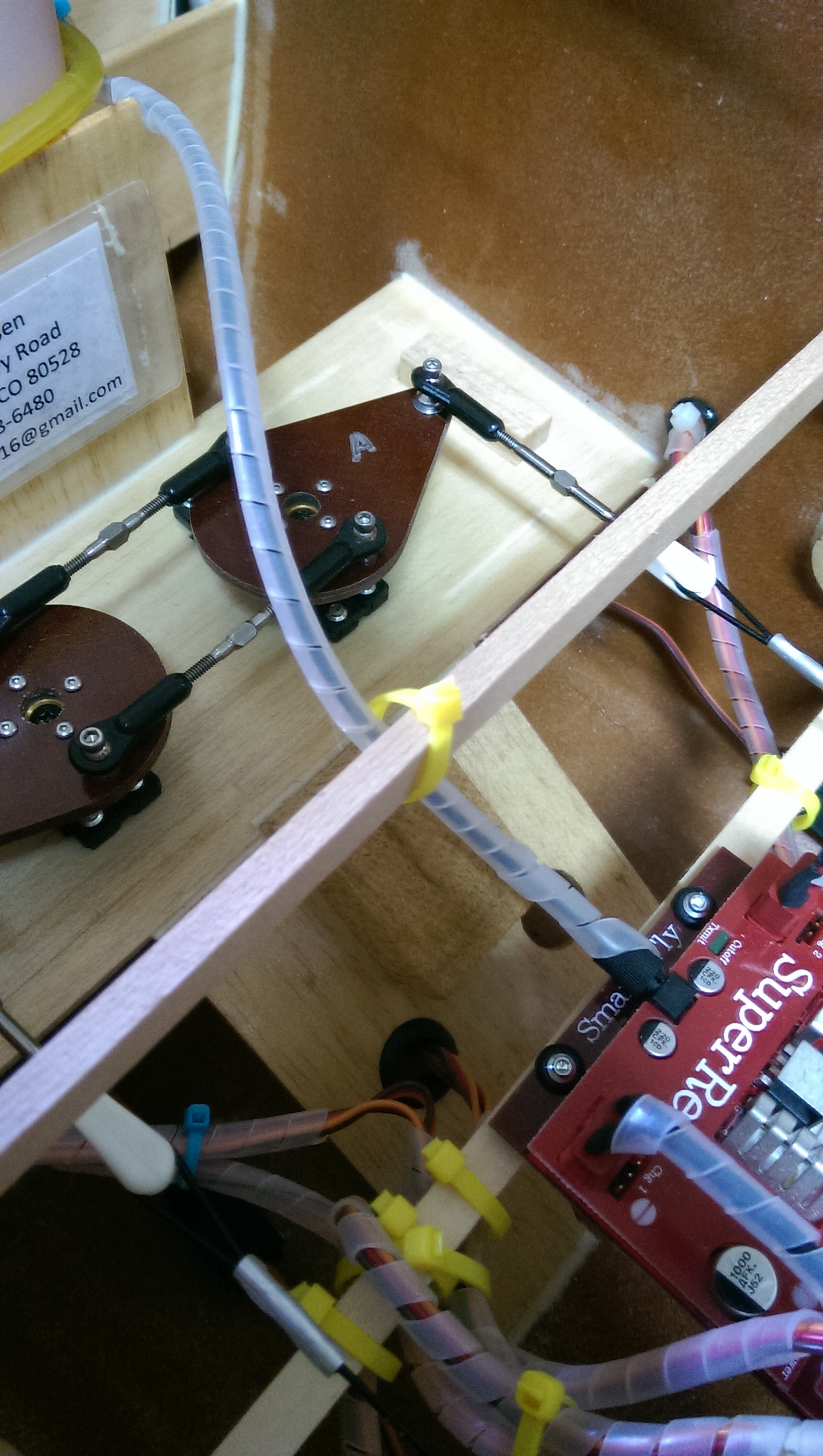

Does anyone have a tip for getting the elevator servo wires away from the pull-pull wires? I noticed my wires had some rub-marks from rubbing against the pull-pull. Eventually, the insulation will fail and short the wire, which would probably lead to a total loss...
I'm thinking of biting the bullet and opening the covering in the tail and somehow tie the wires up. Any better ideas that don't involve surgery?
Put some spiral wrap around the wires, put the wires in a bundle. After that, then zip tie it to a hardpoint away from the pull pulls, that is what I do. IMAG0051.jpgIMAG0052.jpgIMAG0050.jpg
njswede
Yes, but the problem is that it's rubbing all the way back at the tail, so I'd have to open the fuse to reach it.
