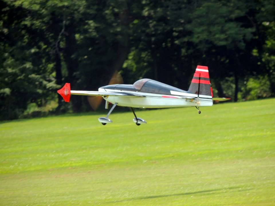

By the way.... I remember reading somewhere that the Aerobeez 50cc planes had weak landing gear. Well, I deadsticked mine yesterday and ended up doing a VERY had landing. Not a scratch on the plane. @AeroHeadTW was standing next to me and was ready to bring out the garbage bags...
