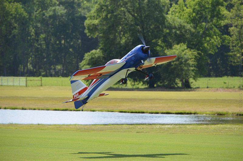

Looking good Gyro!!
What size prop are you swinging there?
D-Man
It's a 24x9 Xion CF prop. Just ordered a 23x10 Xoar Electric to try,
Ken and I were exploring some higher winds, the 189kv I got appears to be a little too high with the ZTW Gecko's power... My goal is to get the watts near the recommended 5200 range, maybe 5300 or so with good throttle management.

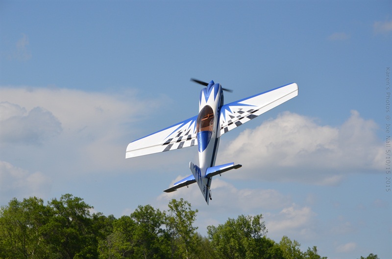

Great detail work on the plane Gyro. Love the painted control horns and the extra white covering on the bottom. I also love what Aerobeez did with the wheel pants.
