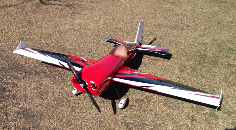

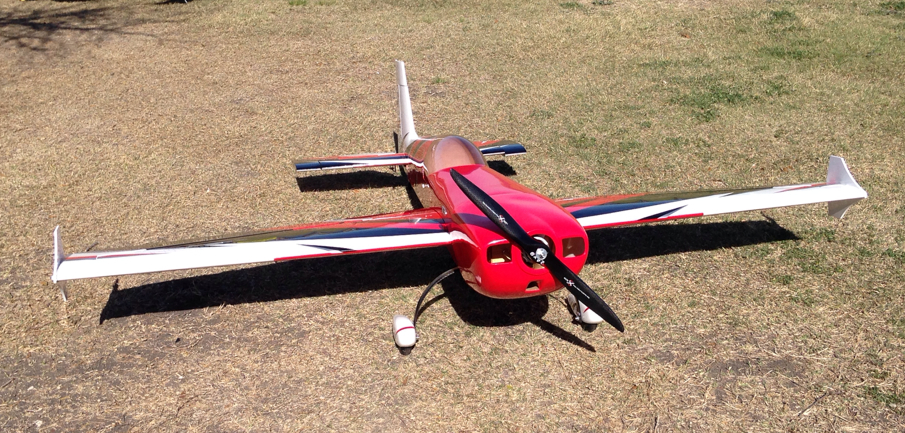

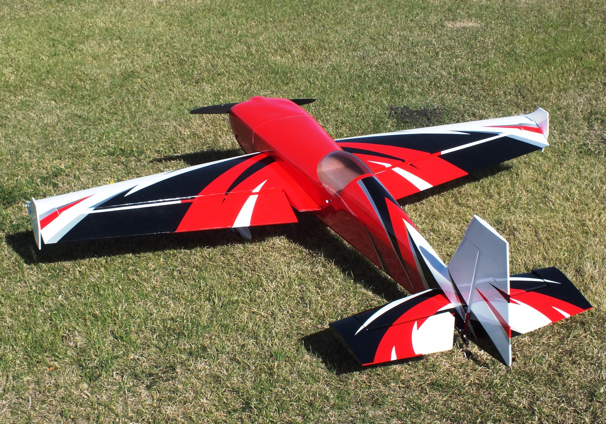

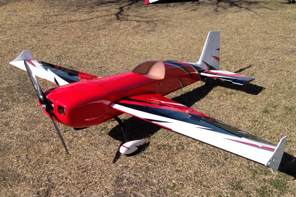

Maiden complete:
Tail heavy, needs spinner and flight packs moved forward.
Prop needs balancing.
Covering peeled a pinch, easy to fix.
test motor on 195kv was obscene, 135a / 6000w on 24x9. Punchout was.... Speechless.
Good thing Ken doesn't recommend this high of a KV for retail...

Sounds like you just got one flight
Correct. Brian did the maiden because it was so windy today.
Plane flew well and looks amazing in the air. Once we get the CG right and the prop balanced, it'll be a winner for sure.
