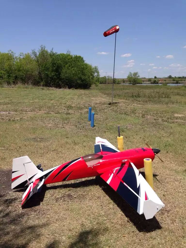

Went out today on a windy afternoon and got some more flying in on the 90 Extra with the DLE55.
She flew great... I really like the gas performance. Needed about 2oz of weight added to the nose with my setup. If you're using LiIon or LiFe batts, mount them up in the cowl on the motorbox and you won't need any extra weight.

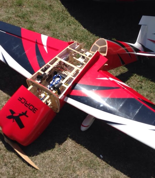

Well, every airframe has a life span, some sooner than others:
This was the first 50cc size plane I built with a 16oz tank in it, and it's definitely the last.
I ran out of fuel and deadsticked AS I was coming around to land. In the strong winds, I didn't have enough altitude to dump the nose and pick up speed, so I landed flat from about 35ft.
The motorbox broke and the fuse split behind the rudder tray. The landing gear and mounting block are fine.
I repeat: the landing gear and mounting block are fine. Aerobeez built this planes gear to survive those less than perfect landings, and this one would have if the forward speed was more than 5mph.
What a sad day for such a fun plane!

That doesn't look so bad... All the same, I know the frustrations of a crash, especially on a fairly new plane.
tell me you are going to repair it!
Doubtful. The motorbox is toothpicks, and the fuse is pretty damaged where it split... Lots more damage than the picture posted shows. And of course, it'll need a new cowl and canopy.
I'll probably put the wings, stabs, and rudder aside, and see if a fuse is available from Aerobeez later this year, we'll see.
