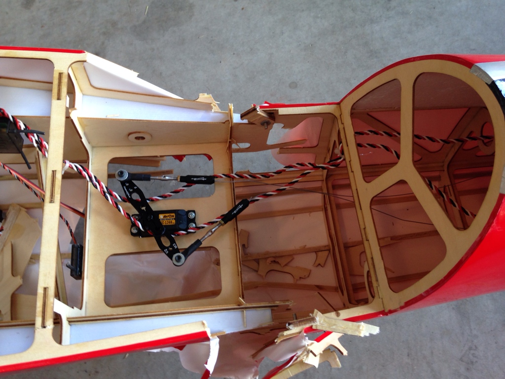

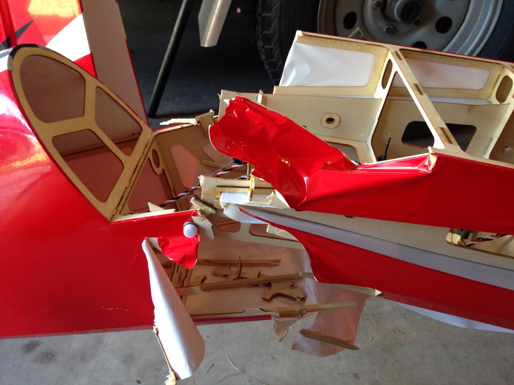

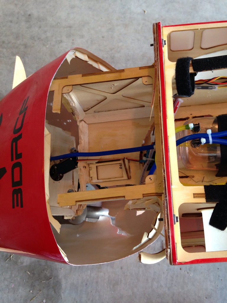

I talked to [MENTION=504]betoperez[/MENTION], and we might see this one fly another day. [MENTION=2215]Aerobeez[/MENTION] has cowl and canopy in stock. Hmmmm....
Humbeto will definitely have some work to do!
ImageUploadedByTapatalk1398205110.481605.jpgImageUploadedByTapatalk1398205117.442617.jpgImageUploadedByTapatalk1398205124.508134.jpg
FlyMike1
Sorry to see that happen. BUT Gorilla glue and duct tape will fix that babe.. Do I see a new avatar picture in one of your pics? :) Sorry, feeling frisky when this happens to someone else. When it happens to me it feels like the world just ended LOL
I can try. Very sure it will fly again.
Next time use your timer, and if you reset it by turning off and on your transmitter then check your fuel tank before you go up again.

I landed twice during the flight to adjust needles, and really should have stopped and refueled versus flying past the timer (since I was on the ground and stopped for a few minutes) and mentally managing the time.
If anyone can fix it, Humberto can. I'm so grateful to have a skilled friend nearby!

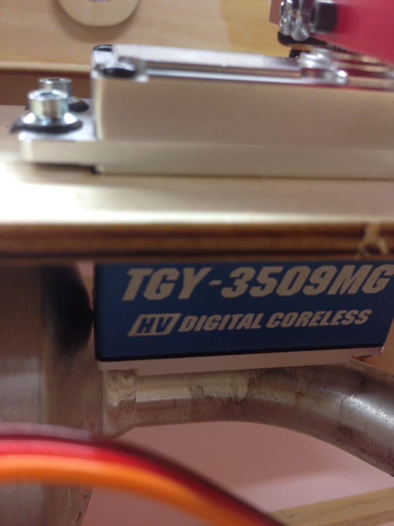

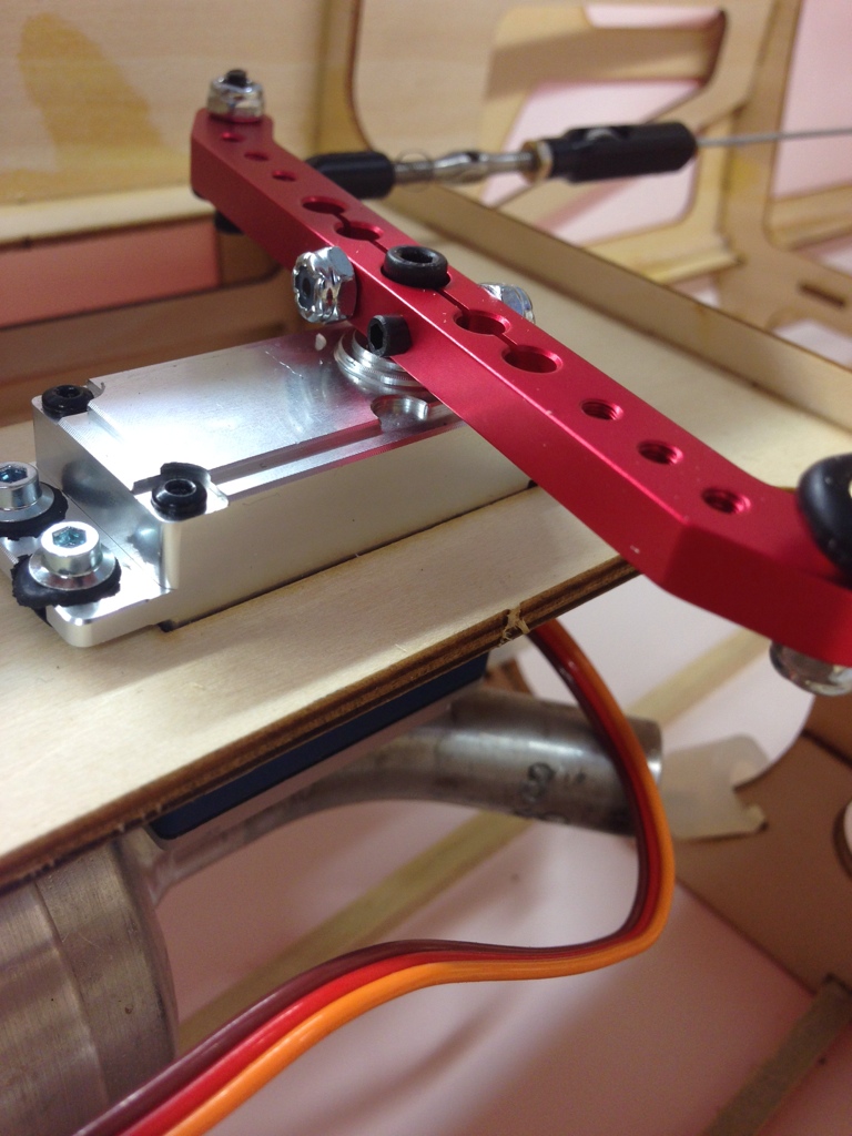

All this talk got me motivated to work on mine. Just hit a major snag. RE2 won't fit with the existing rudder servo location. I can run the Pitts muffler I have already and call it good or attempt to modify the rudder servo up. I don't see a place to put it in the rear for a push pull. Not sure the cables will take the servo being elevated.
My links/cables were installed on top of my rudder arm, so I suspect that you'd be ok to raise the servo while leaving the links underneath as shown in the picture
