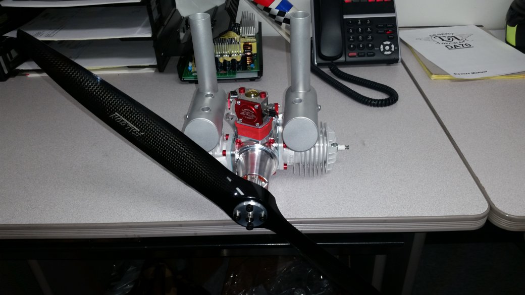

I needed exactly 1" standoffs for this engine, so I ordered up a set of SWB 1" standoffs with bolts. I should have a good 1/8" of clearance between the cowl and spinner. Also, I found out that the included RCGF 55CC plywood template is an exact fit for the DA70 mount, so I'll be using that. We're not that far from liftoff!!

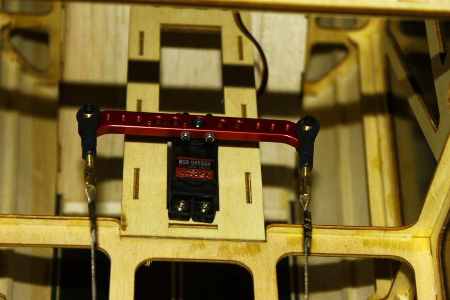

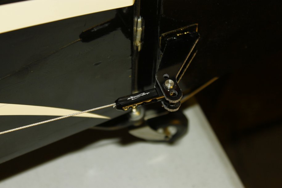

Okay more progress for tonight. Still waiting on parts, but at least I could get the rudder cables hooked up.
The Secraft easy connector made the rudder cable setup a breeze.
Got the cable as tight as I could, then I fitted the grub screws in place (there is a brass tube that goes inside) and tightened them down. Final tensioning is done on the servo end.

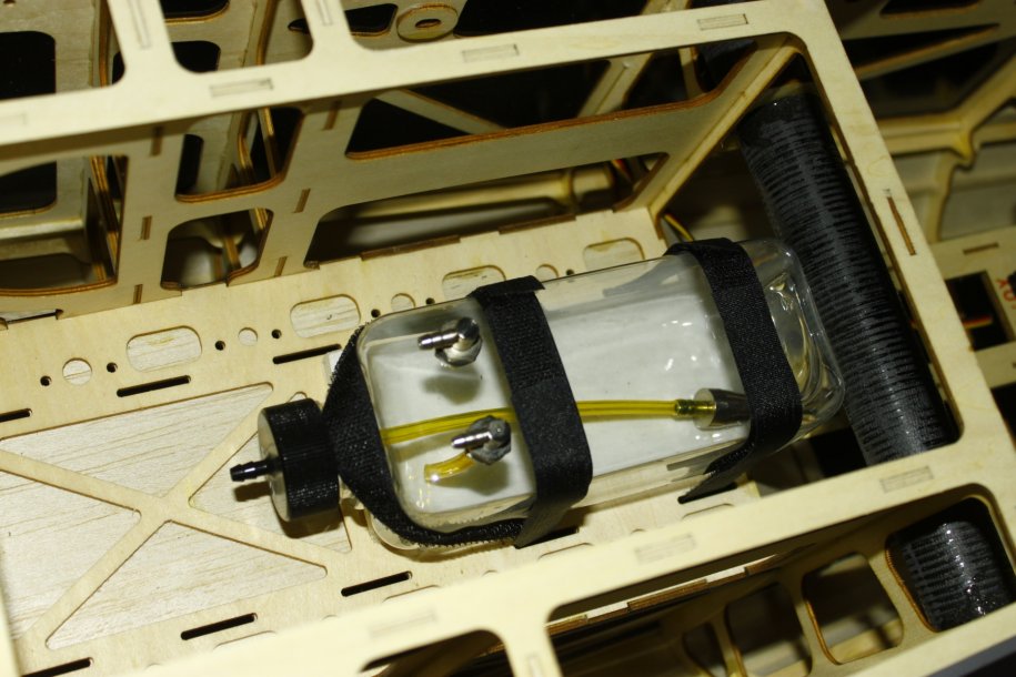

Fuel tank installed. I like to wrap a strip of velcro around the front and butt the rear against the wing spar. Keeps it secured in place.

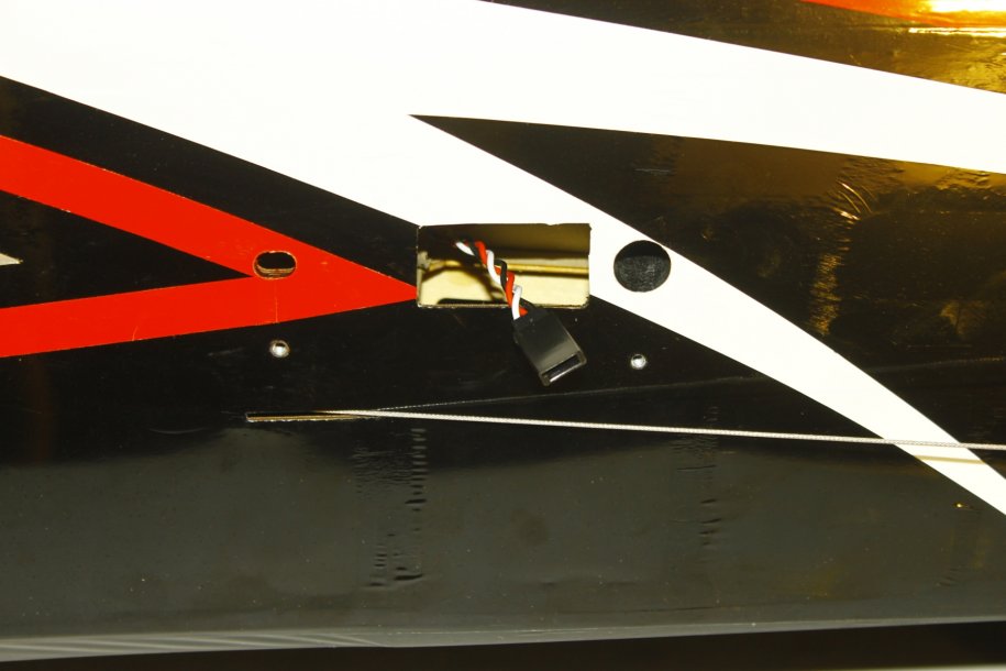

Also ran the elevator extensions through the fuse. The pre-installed tube and pull string makes this job simple and easy.
