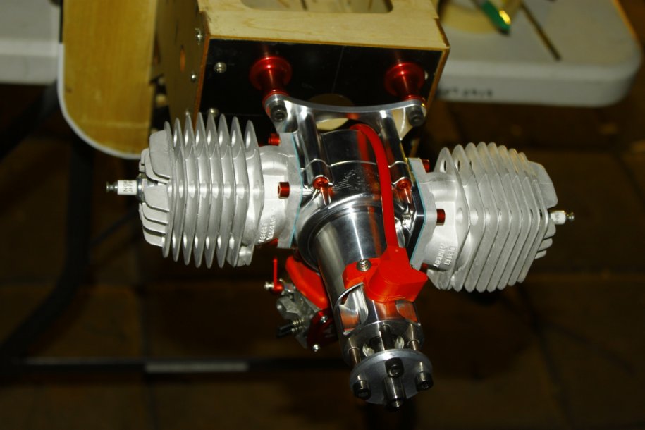

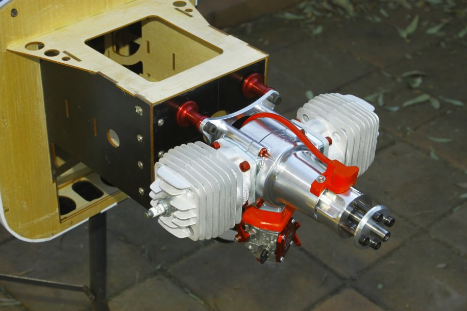

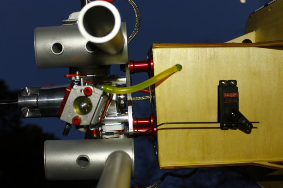

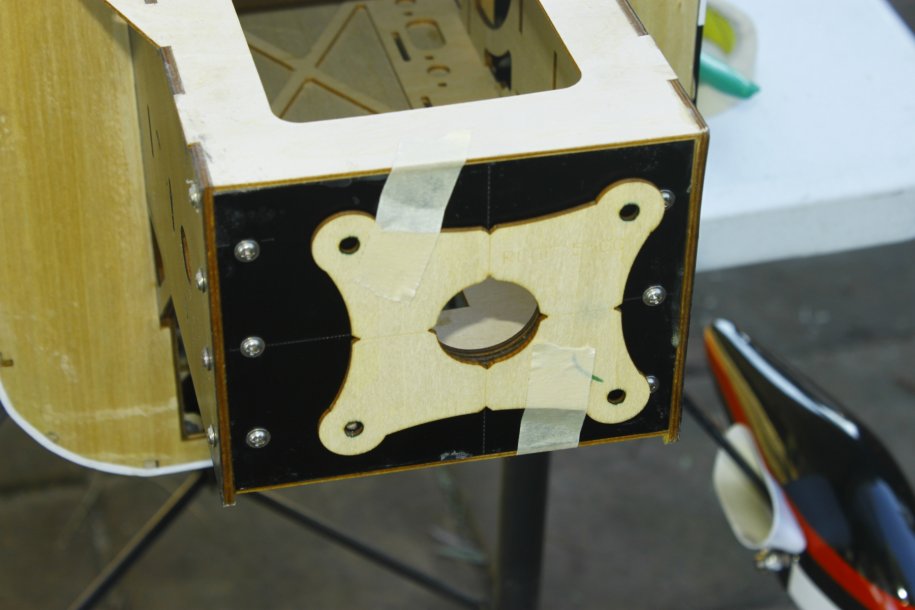

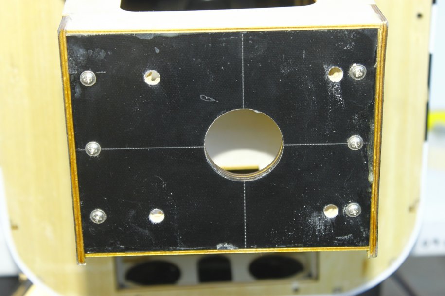

The RCGF55 template was almost a near perfect match for the DA70, I did have to ream one hole slightly (that could have been my own doing though).
Test fitting the beast.

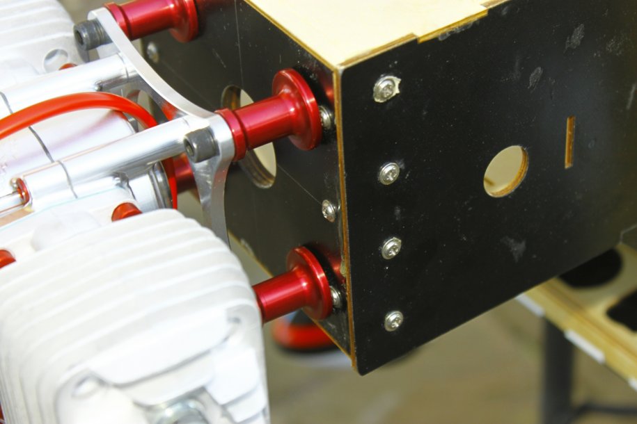

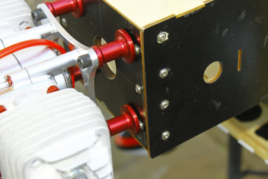

I did run into an issue with the SWB mount being too wide for the pre-installed bolts in the firewall, so I countersunk the 2 bolts that were in the way.
Bolted in place now.
I got the tank plumbed up and decided to test run the engine. Just like a DA, started on the 4th flip, idled perfectly. With the Hitec HSB-9465SH servo controlling the throttle, she revs as fast as I can move my thumb!!!
Electric like would be the appropriate response, I'm sure with the Falcon 24x9 it's gonna be a screaming setup.

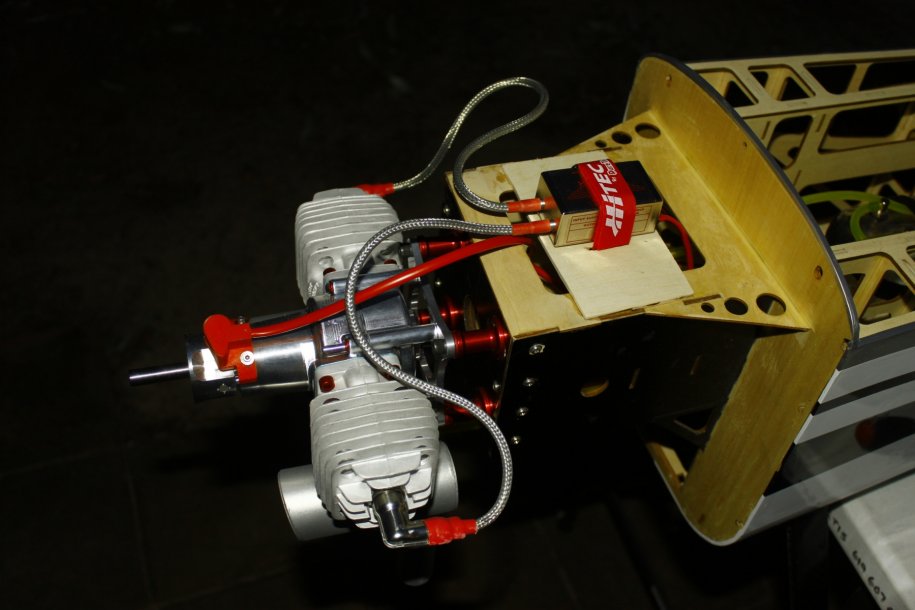

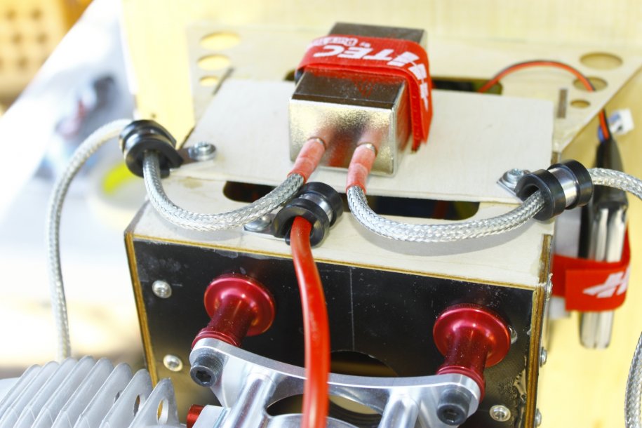

Cowl back off, I decided to make a mounting plate for my ignition to sit up top. Some velcro and a Hitec Velcro strap hold it in securely.
Underneath, showing the 9465 and the throttle linkage. Red loctite the bolts and screws in this area, especially on the linkage.

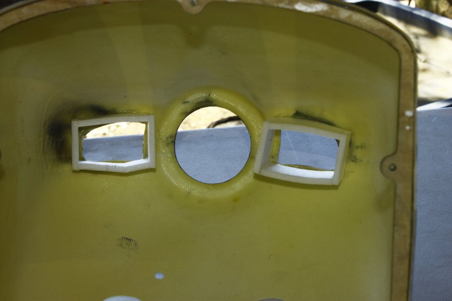

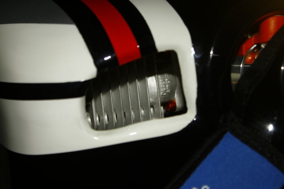

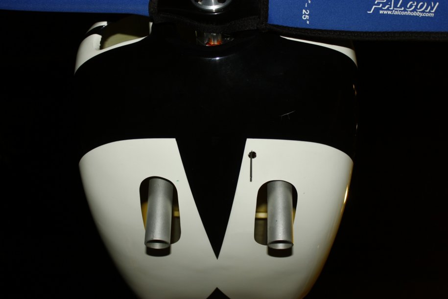

Scariest part of the entire build was cutting the cowl correctly, but I think I got it just about perfect. Slips right on and off, should be plenty of cooling as far as the cowl goes, I did open up all of the vents on the bottom of the airplane as well.
Shiny!!!

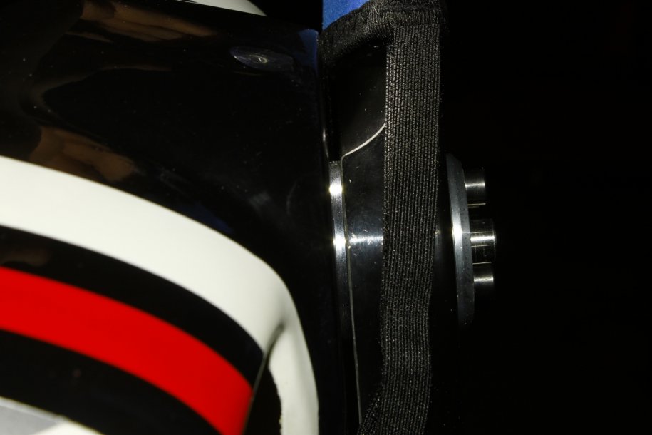

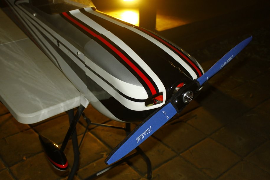

I like a tight gap. I did wind up having to use the small shims the SWB 1" standoff kit included to get the correct spacing.
Baffles installed in the cowl. They are made of 6mm depron and will melt to the correct shape against the cylinder heads. I have used Depron baffles on everything and so have buddies of mine, these should work great.

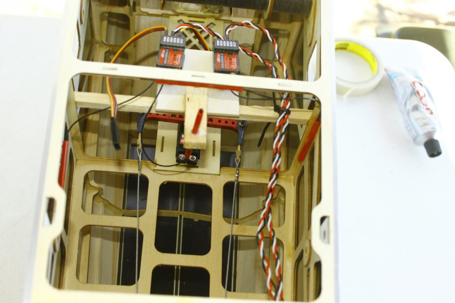

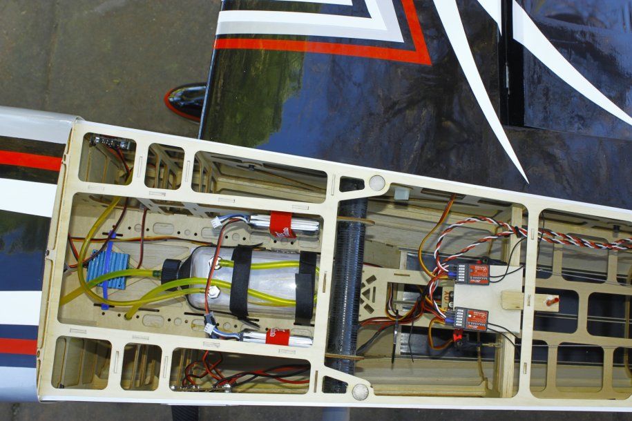

Back inside, I made a mounting plate for my Maxima 6 receivers, and used red tubes to route the antennas.
Ignition pack in place, I can always move it inside of the fuselage if this turns out to be too far forward, or too hot.
Cable clamps in place, I have some split wire loom coming that I will fit everything inside of.
The CG is at the front edge of the wing tube.

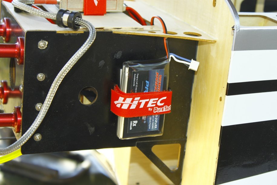

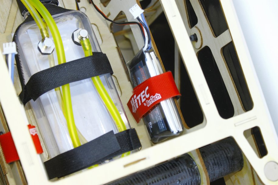

This is where I wound up placing my flight packs, it seems to be the perfect location for them!!!

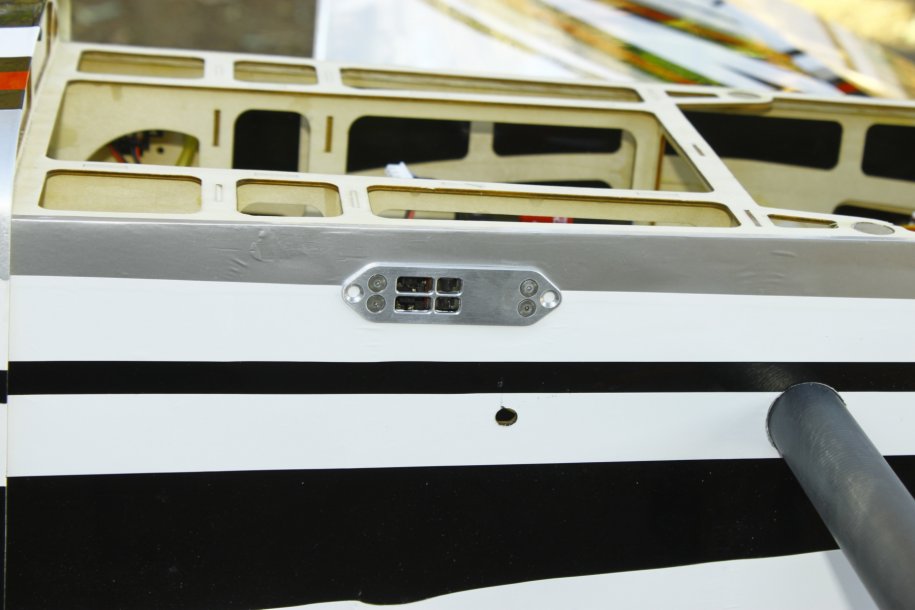

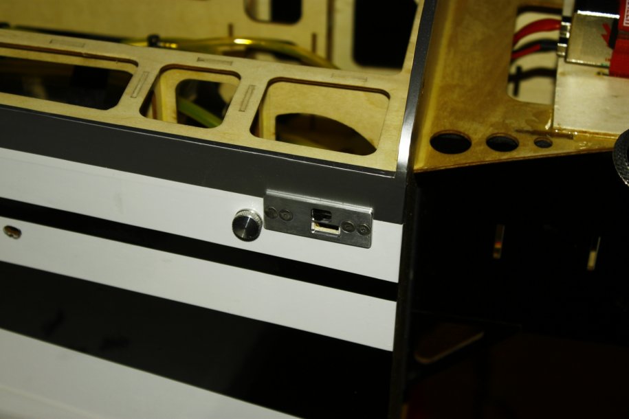

I waited until the very last step to place my rx switch because it depended on where I placed the receiver batteries. Because of the plywood structure inside, I did not need the outside bolts to secure the unit, the 4 inside ones clamp up against the plywood. This makes the switches sit more flush with the mounting plate which I like better.
Final tiding up of the wires.
View attachment 50787 View attachment 50788
View attachment 50796 View attachment 50797
Shiny!!!
