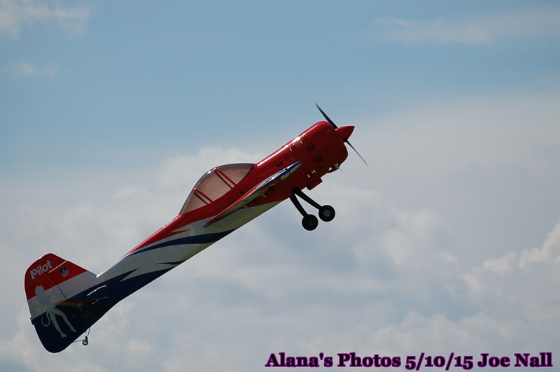

So my thoughts on the plane after the first few flights:
1. Slippery! She's really fast and slices through the air nicely, even in wind.
2. Insane roll rate. The big ailerons and big deflection roll the plane very fast.
3. Excellent precision. Very easy to track exactly where you want to go.
4. Easy knife edge. I was doing both slow and fast KE without any mixes....
So almost zero coupling with a very slightly forward of neutral CG.
5. Harrier stability was good.  Upright wasn't as locked in as the big 92" AP edge, but I blame that on the wing tips that are factory installed. The tall rudder does help tho, and inverted is amazing.
6. Energy maneuvers were also fun. Not as insanely violent as a few of the other planes I've flown, but definitely aggressive and easy to enter.
